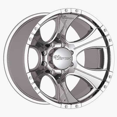

Decided to go with these Dick Cepek DC-1 15x10 polished aluminum rims. I'll eventually upgrade to 31x12.5R15, or after I go 3.4, at least 32x11.5 with a minor bj spacer/ome coil lift.

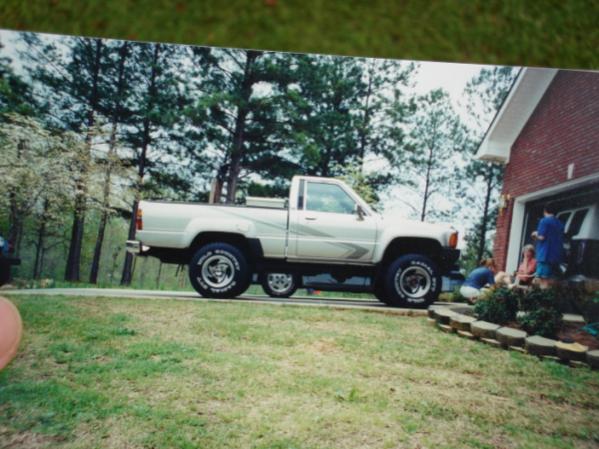

this is the only pic i got but it's from the side....you could always go 15x8 rims...up to you though
anymore pictures?
this one didn't give me the view i was looking for
