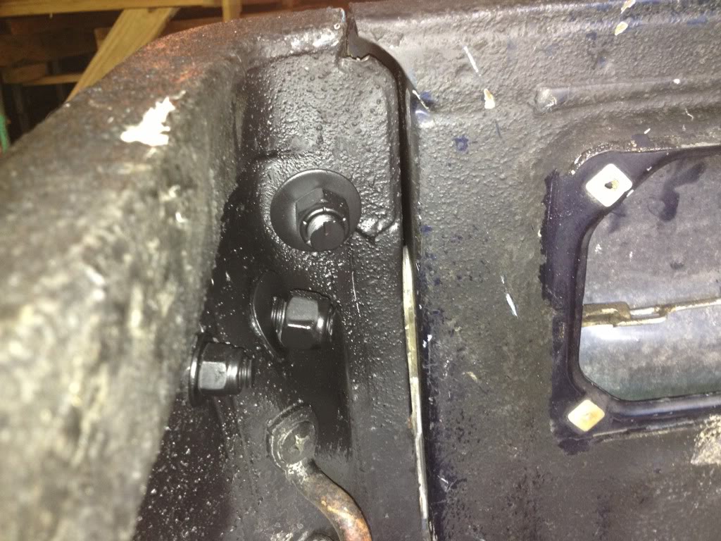

1. First I took of the license plate, because it does not fit in that location and that's where I want my Jerry can to be. Grind off the brackets until smooth and paint the area to prevent rust. ( as shown in the picture below.)

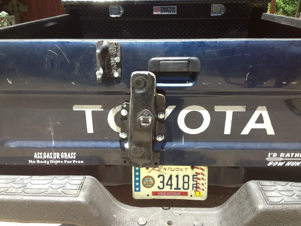

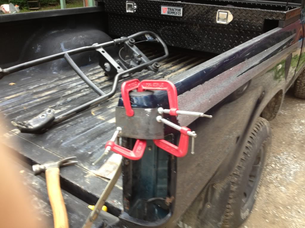

2. Remove the passenger rear light assembly and clamp the tire carrier I the desired position ( as shown below)

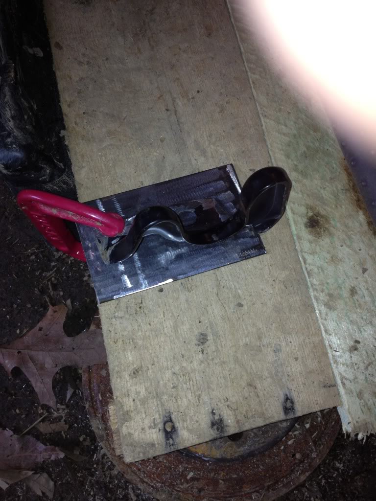

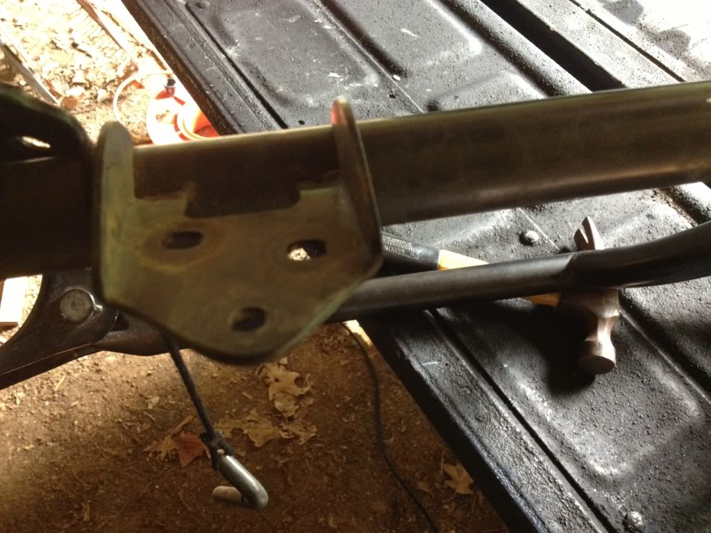

3. Drill holes to fit bolts. ( this is where we will countersink) countersinking is where you put a nut on each side one goes directly behind the plate located on the inside of the corner panel then another one goes on the inside toward the bed side of the truck and the last one goes on the outside of the bolt ( on bed side of truck) you will have to choose which ones to counter sink I got 3 out of the 4 bolts countersunk ( the more you countersink the stronger your gusses will be) here is a picture to help clarify countersinking

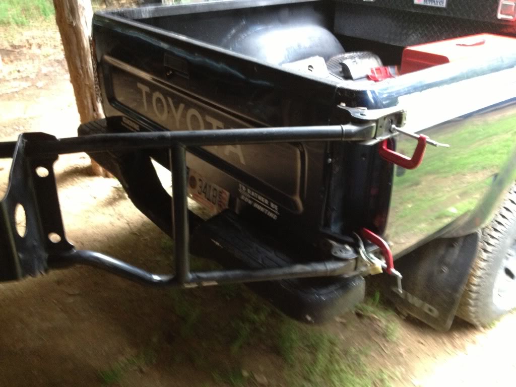

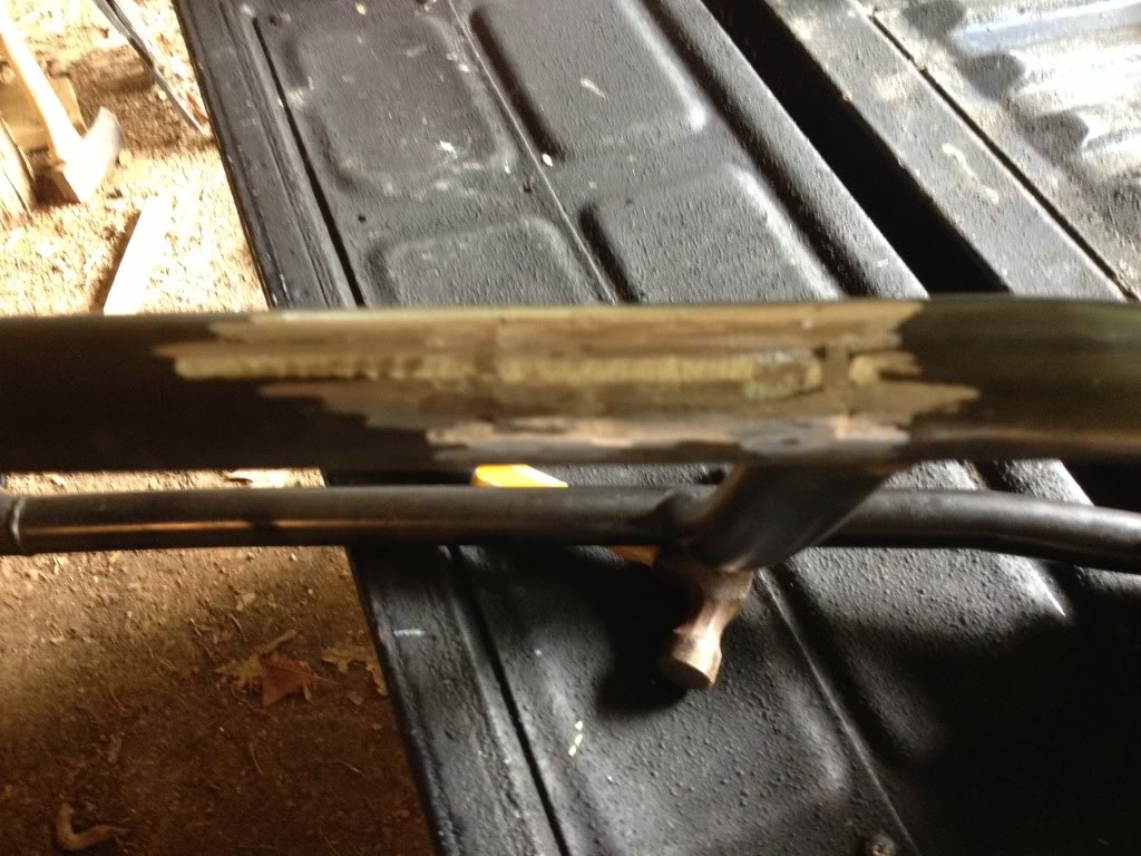

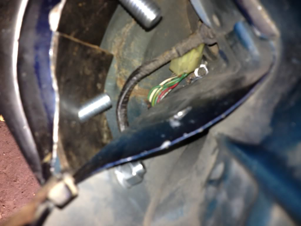

4. After the holes are drilled take off the tire carrier because the corner panel is not load bearing yet. Now comes the fun part molding the 3/16" steel to the corner panel. I started out on an anvil and with a hammer I mimicked the bend of the panel. Once it was close I clamped it to the outside of the corner panel and softly hit it until it perfectly fit. Here are a few pictures to better explain it.

Once the plate is molded you can place them inside the corner panel and clamp them in so you can take a pencil and trace the drill holes then pull them out and clamp them down and drill the holes ( start off with a small drill bit and work up to the according size it's a lot easier)
5 now that you have all that done. You can clamp the carrier and the plates to the truck and start countersinking. ( when you put the nuts on don't let them cross-tighten on you it's not easy getting them apart again.) once you have it all bolted up you can start working on the tailgate

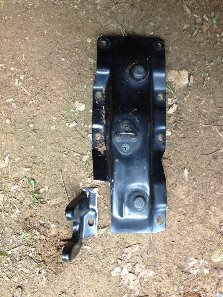

6. The tailgate part is pretty easy you will cut the bracket as shown below
Next you will place the bracket on the carrier and close it to mark the holes that need to be drilled I used 3/8" bolts on the tailgate.

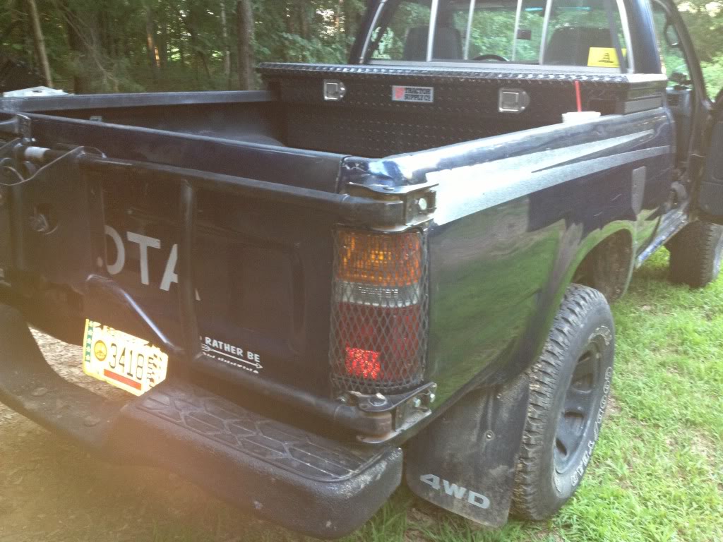

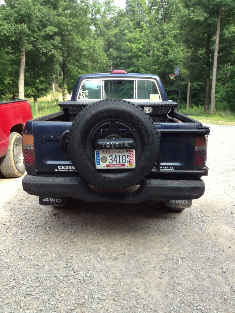

Here are some pictures of the finished product:
