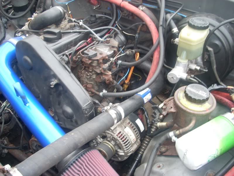

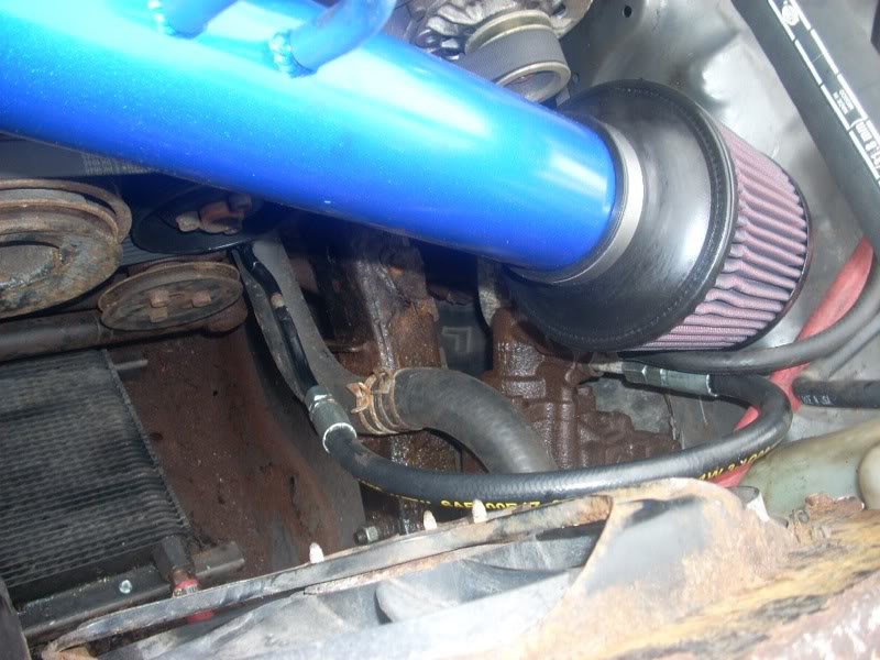

Well the progress is getting slow ($$). I Pulled it out of the garage today and took some pics. I have been putting all new brakes on the front and still have to do the back. I need to run a line to the back brakes then I will be able to drive it. While I was at it I put on some manual hubs.
I broke the crank breather at some point so oil is spraying out the side of the block when I run it, and I have a little coolent leak that I can't find. I will deal with it a bit later. have to stop at the wreckers and get the breather hose.
I bought some Tremclad flat black and am going to give that a go for the truck. You can see in the pics the Por15 I put on the spots that I know these trucks rust at. It runs very good now. Still need to do the exhaust but that will probebly be the last thing I do.
82yota, let me know if you are in the area and you can come check it out. Make sure you bring yours as I would like to see it.
Heres the pics.

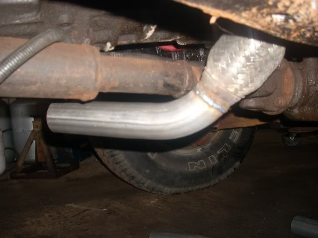

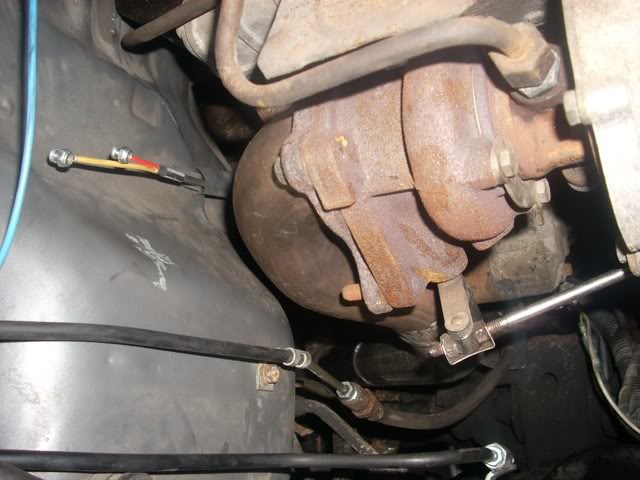

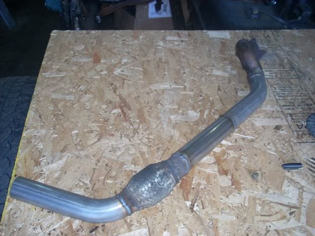

Well I got most of the exhaust done yesterday. At lease the hard part. I just need to get a muffler and straight back.
