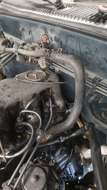

So, I'd made a temporary power steering line for mock-up purposes. Thought it'd survive a couple thousand miles at least... nope! It exploded while I was bedding in the new brakes the 1st time. The crooked Dorman pulley made the new pump's life hell, but the failed hose finished it off. Got to wait for RockAuto to take their sweet ass time to send me a replacement. Summit, on the other hand, overnighted me a new brake rotor (despite me telling them a week would be fine). Huge difference in customer service there! The PS line was my fault, as I'd used a hose with too little of pressure rating. Ordered up the Fragola hose I'd been planning to use, anyway. I should've used my own advice and ordered a custom hose with a bend >90°, but for the sake of time, got a built-to-stock 90° hose. It works, but it won't last as long since it has to bend pretty harshly. I also ponied up & got another Trail Gear billet TC pulley.
So here's a pic of where the hose blew out. This thing blew the diesel fuel filter o-ring out twice in a row, requiring 2 top-to-bottom Hotsy baths. Then this happened 32 miles later, requiring a 3rd. At least things shouldn't rust any worse for a while 😂

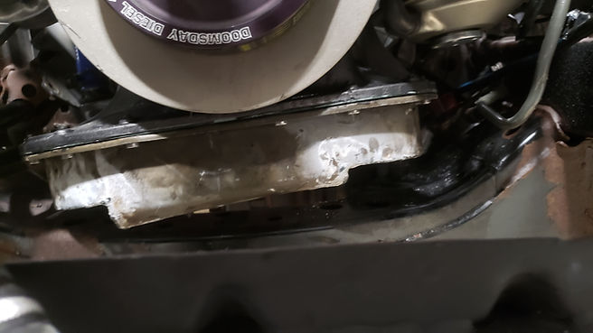

The oil pan could have been the catastrophic ending of this whole build. The new motor mounts settled very quickly, the the pan began to smack the frame crossmember with any load applied.
I could've modified the frame, probably with less effort. It slopes front-to-back. But with the engine installed, modifying the pan was the only option. I smacked it in the middle (possibly not necessary), and cut off each end. I only lost exactly 1/2 quart of capacity with this mod, to my surprise.
This is just a front shot of the pan - the motor mounts weren't attached in this pic.

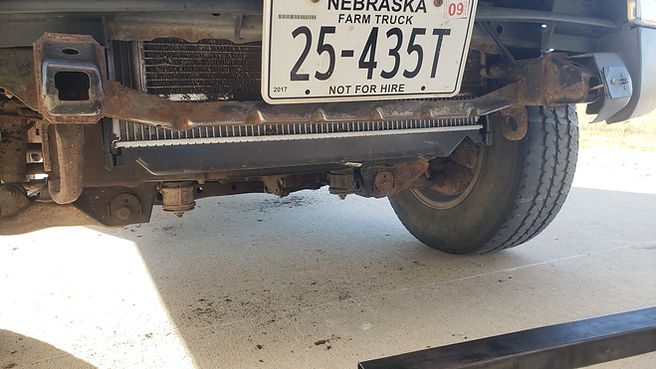

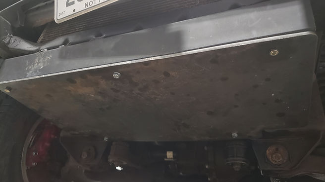

Next, I had to address the lack of a front skid plat. The radiator hangs down in harms way, and I very nearly ripped the brand new unit right off on my first off-road outing. Instead of buying an expensive factory rust-prone replacement, I simply welded a 2x3x1/8 tube to the rusty bent crossmember.
I'd have preferred an 1/8" skid plate, but I've had a 1/4" slab stuck on my plasma table forever, and it's beginning to rust, so I decided to use a bunch of it up. I ran bolts/nuts where I could, and used nut-serts in the other spots.
And here's why I need some beefy protection - this thing with the rear e-locker, even with stock tires, is a BEAST! Look at what it effortlessly crawled up once the rear locker was engaged.

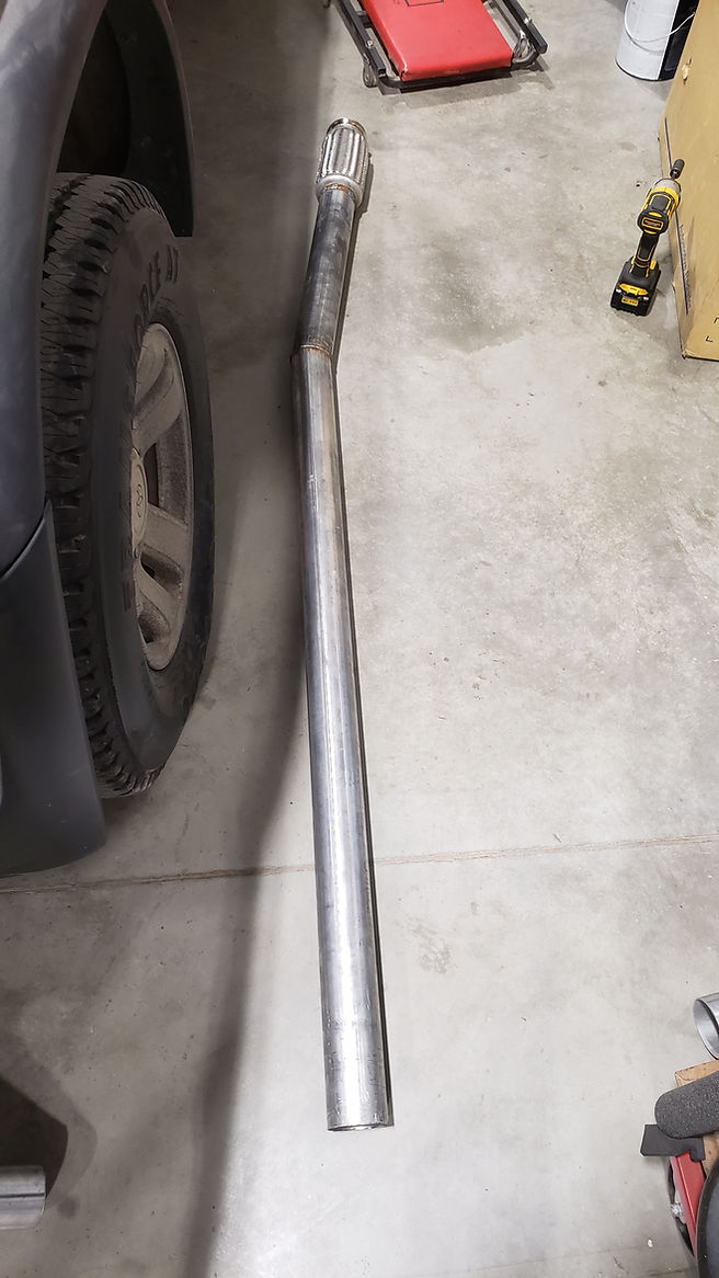

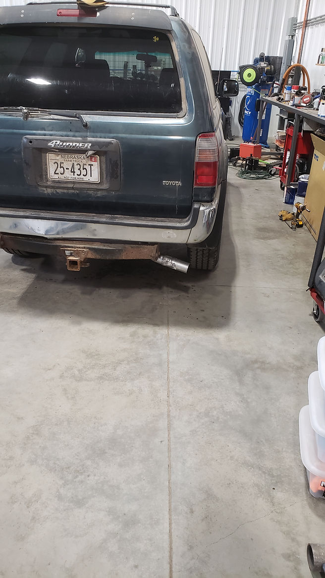

As long as we're on the donwpipe, let's address the whole exhaust system. I ran a 3" turbo-back system. I would not recommend this unless you have the room. For future 96-04 swaps, I'll use a 2.5" downpipe. I had to use a BFH to clearance the DP from the starter, trans dipstick, and swaybar bracket. I used my own 2.5" to 79mm Holset v-band coupler, a cheapo amazon stainless 90° (you want 16ga, not 18ga), followed by a generic steel 90° from Summit, and a v-band at the end. This is my "downpipe". The rest of the exhaust is 2 pieces.
I welded a cheapo amazon flex pipe (highly discourage these, despite how enticing $16 appears) to a straight piece of 3" pipe roughly 7' long. I only had to make 1 cut in the middle to angle it about 8°. This is the middle piece.
The rear is from a 2000's 6.0L 2500 Chevy. It's supposed to be 3", but it's more like 2.75". But it has a great bend to clear the axle and point the exhaust out in the general direction you want it. I will eventually cut the tailpipe and re-aim it to look a lot better. I coupled the 6.0L tailpipe to the intermediate pipe with a slip-over clamp after having my local exhaust shop flare the 6.0L pipe. I think a Duramax tailpipe would work better. But they're Ø3.25".
The sound of an OM617 is very uniquely its own. It's not a Cummins; it's not an International; it's not a CAT. The closest thing I can think of is a Detroit. Keep this in mind when building your exhaust system:
-2.5" will support more power than this engine will make
-The larger the pipe, the lower the tone
-The smaller the pipe, the louder the exhaust
-3" is generally a PITA to snake by the starter
-These OM617's have an annoyingly loud idle heard from the motor (not exhaust)
I love how this one sounds in the cab (hate how loud it is by the hood). I need to do a drive-by, as I'm thinking the tailpipe probably doesn't sound that great blasting past you on the highway (or maybe it does?). Tailpipe idle sounds great tho. The open air filter and 3" system generates more turbo noise than exhaust, from what I can hear inside while driving. All I hear is turbo noises 😍

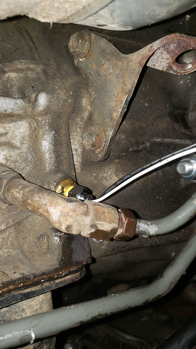

I removed the trans temp light since I installed an aftermarket temp gauge in the original sending unit's place. More on that in a second...
Another dumb thing that I hate - the A340 has an actual temp sensor, not just an on/off switch for a light. If you plug into your OBD2, you can read the trans temp! But the idiot light doesn't come on till 300°, which is 50° after your trans was already dead, anyway. Why pay to install a sensor but not give us a gauge to read it, Toyota?
Here's how I installed an aftermarket Glowshift gauge (part # in pic). It's a better thread adapter than the Autometer part. Use the crush washer, not the o-ring. Sucks that you have to loosen the cooler line fitings to get to it, though. Keep in mind that removing the factory temp sensor removes the fail-safe feature that kicks off your AC if the trans temp ever gets too high.
This trans can safely handle at least 220°. I like to see it at 180, which is the operating temp for ATF. But I'll see it stick at 160 while cruising, and I'll see it hit 200 with a heavy foot and lots of shifting in stop/go traffic. I back off and take it easy once it elevates to 200, for longevity of the trans. Excessive heat only means shorter life (so does excessively cold). The stock torque converter could likely be highly improved upon, but it works! If you're pinching pennies, there's no reason you can't just run it. A custom unit from FTI is on my bucket list, though.

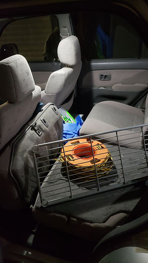

Back to LED's! I'd put them in for your overhead lamps! Here're the links:
https://amzn.to/3NT5jPm
https://amzn.to/3fPX4XG
I like both. I don't notice a difference so far between the 2 brands, so longevity will probably be the difference.
Here's before and after shots:
Here are the same bulbs in the map light slots (99-02 have different map lights). They're blinding, but you'll be able to see anything you want.
The ignition cylinder, automatic shifter, HVAC controls, and glove box all use the same bulb. The cig lighter has a goofy proprietary halogen bulb, unfortunately. LED link here:
https://amzn.to/3hsu2he

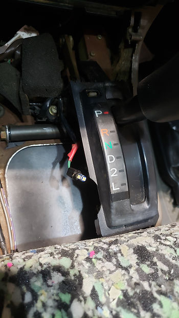

My shifter bulb was burned out and I couldn't see which gear it was in at night. Since the 96-98 don't have the indicator in the gauge cluster, it was challenging to drive at night. Not anymore!

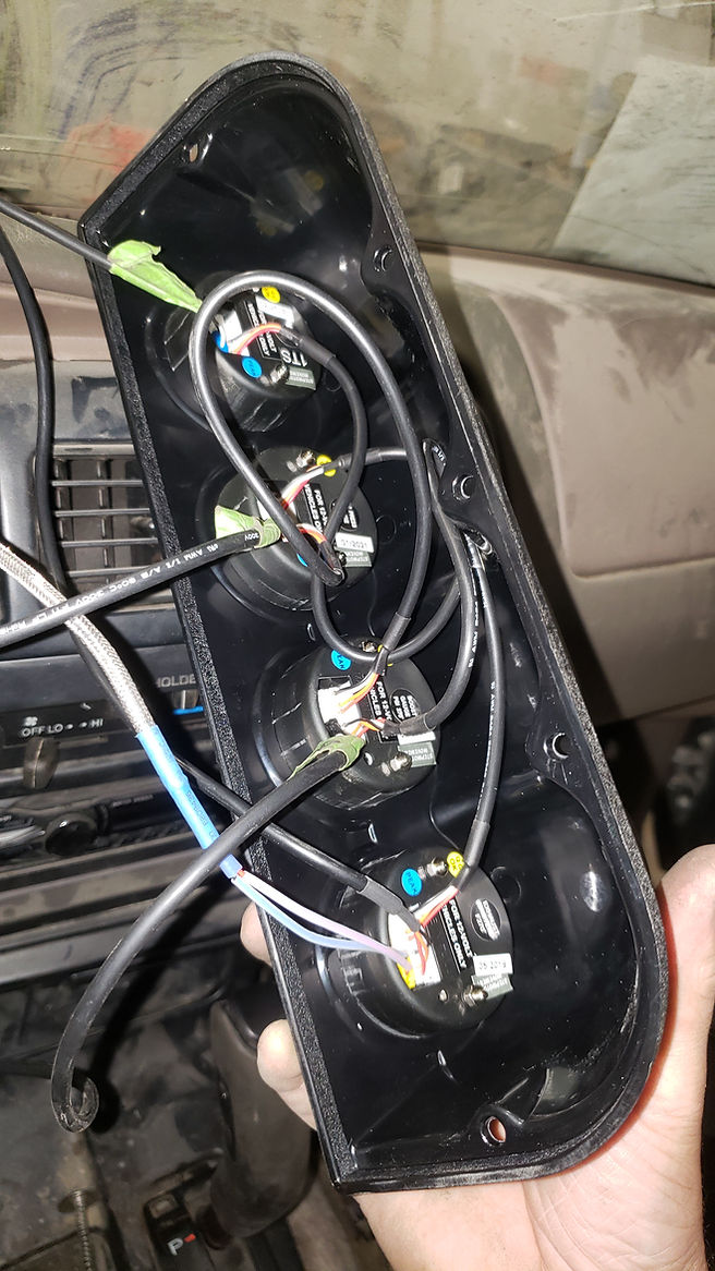

Here are the 4 gauges daisy-chained together, so I only had to hook 1 wire up instead of 4, for each function. SOOOO much cleaner than an AM setup. I put them in a pod to make mounting simple for this cheap/quick build. They have every mount style you could imagine, and at great prices. I actually ditched this solid mount for an articulating pod setup, so I could individually aim each gauge towards my line of sight.

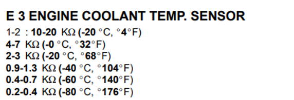

There are actually 2 water temp sensors. The spade terminal unit is for the gauge; the weather connector is for the ECU. I mounted the ECU sensor in the tstat housing, as it's a perfect location for the wiring harness, and the thread is conveniently close to tap out.
The ECU sensor serves several functions, still, in this swap. In stock configuration, it should kick off the AC if the temp gets too high. Shift points are likely affected by it, too.
The gauge sensor got adapted to the head fitting behind the injection pump, with an adapter from GS. I had to extend the wiring harness wire to reach this location, but it reads the temp in the middle of the head, and is easily accessible.

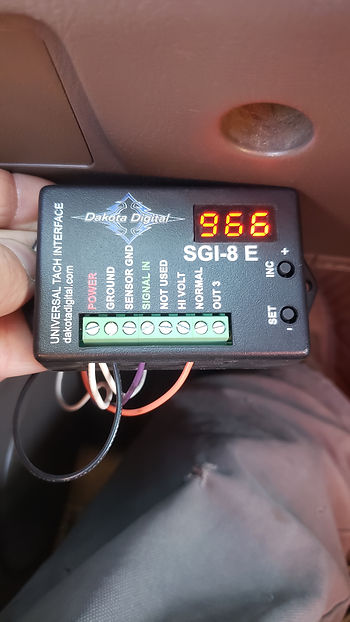

The tachometer is a can of worms... I will say this clearly right here:
I DO NOT ENDORSE DAKOTA DIGITAL.
I had initially been using the DSL1 in my swaps. It worked just fine. Then, DD obsoleted it in favor of the SGI8. I called when the DSL1 was listed as NLA, and the guy on the phone told me to start using the SGI8. I found a good deal on them, and bought a bundle of them. Finally ran out of DSL1's on my last customer's build, and had to use my first SGI8. The signal worked fine until 3000 RPM, then the tach would die. I called tech support for troubleshooting, and this is where my support for Dakota Digital died. In their never-ending quest to consolidate parts, they've taken a $70 module and replaced it with a $110 module with bluetooth and all this jazz that none of us need, want, or will ever use. The guy on the phone immediately scoffs at me for asking for help with an SGI8 module, acting like it's been obsolete for 10 years. He claims he can't even pull up any documentation for it. We get into the troubleshooting, and he tells me this is not going to work at all - it's not for diesel tachs. Well that's pretty damned funny... it's called the "UNIVERSAL TACH INTERFACE" - says it right on the module. I informed him that Dakota Digital told me to start using the SGI8. He told me "no we didn't". It was at this point that I was ready to slam the phone. I gritted my teeth and tried to get some technical troubleshooting points. All he could offer was "just push buttons and try different things".
THANKS FOR NOTHING, DAKOTA DIGITAL! I WILL NEVER BUY ANOTHER PRODUCT FROM YOU!

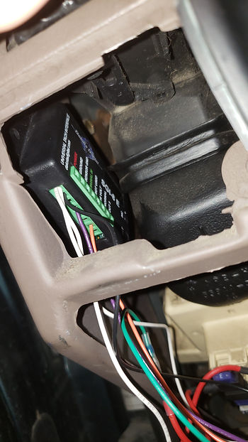

I ended up figuring out how to calibrate the SGI8, and it works even better than the DSL1 ever did. Too bad they had to obsolete them. Honestly, the bluetooth adjustments would be great, as I have this thing hidden way up inside the dash, and adjusting was a PITA. A correction factor of 966 with an IN of 6? and OUT of 10? (of course I lost my pictures of the IN/OUT settings... comment if you need them and I'll dig the module out and read them again) got the tach working perfectly using the AD230 alternator output. It is buttery smooth.
Hooking it up is a breeze - you give it 12v with the key on RUN, ground it, send the AD alternator's "P" to the Signal-In, and the Normal Output goes to your gauge cluster tach input. I piggy-backed the Glow Shift gauge power to eliminate a splice/butt joint connector. I used a simple add-a-fuse to pull my 12V from the fuse panel.
Some tape-on velcro makes mounting and removing simple.
If the battery is disconnected, it still retains its settings. I wish the GS gauges did this. I could not imagine pulling the dash to reprogram the tach module every time I disconnect the battery.

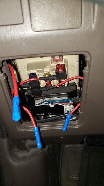

As for connecting the rest of the gauge wires goes, it was extremely simple and convenient with the existing 4Runner fuse panel. The tach module and gauges get 12V in RUN. The gauges need constant 12V to keep their memory (this could potentially drain your battery over long periods of time). And my OM617 Wiring Harness needs power with key on ACC, to shut the engine off.
The gauges also need 12v when the lights are turned on, to activate the dimming feature. This was easily done by removing the plug from the dimmer switch, removing the hot wire going in, and crimping a new spade terminal over 2 wires. This makes it look factory (you know, cuz people are totally removing your dash at car shows to look at your wiring connections &#128579 and it makes for a strong, solid connection.

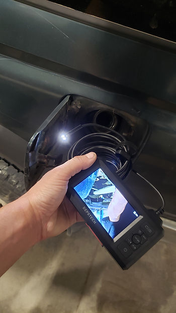

While I was in there, I did get a chance to use my new endoscope. I was able to see some awesome looking crosshatching still intact. And I made sure I got every last piece of debris vacuumed out to prevent destroying my engine. Had I stopped after I'd initially vacuumed and thought it was sufficient, I would've most definitely destroyed this cylinder/piston. I put the probe in and found several huge chunks of washer.
I also got to use the endoscope to find an obstruction in my fuel filler neck. I had plugged it to catch debris when I was modifying it. Apparently one of the several towels broke off when I removed it, which luckily just clogged the filler neck instead of going into the tank and clogging the pick-up tube. It paid itself off just with this first use!

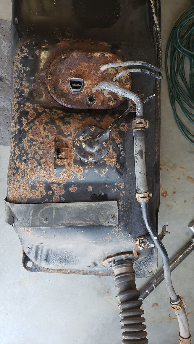

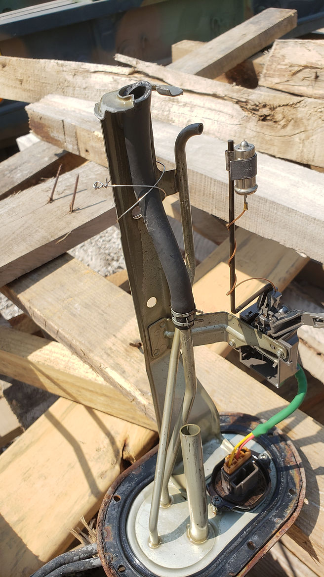

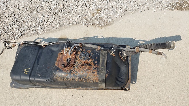

Modifying the fuel tank on these is pretty straight forward. Removing the tank and filler neck sucks, though.
There is a plastic shield that must be removed to get to the filler neck. I used a 7/16 socket on the backside of the plastic clips to release them. They are $19 at Toyota, and I haven't found a good universal replacement. In hind sight, I could've probably left all of this in place and modified it on the vehicle. Just disconnect the filler neck from the tank.
The filler neck restrictor, from what I could tell, just has to be beaten out to the best of your ability. Make sure to clean all debris out of the tube when you're done. I used an air chisel to open mine up.
To drop the tank, you'll have to pull the carpet up on the rear LH seat and unplug the harness going into the pump. You'll also want to reach in and pop the plastic retainer free, if you can. I destroyed mine form underneath - just another stupid automotive engineering oversite.
Then you can drop the tank. You'll want to drain 100% of its contents. Some had a drain plug, some didn't. Oh joy.

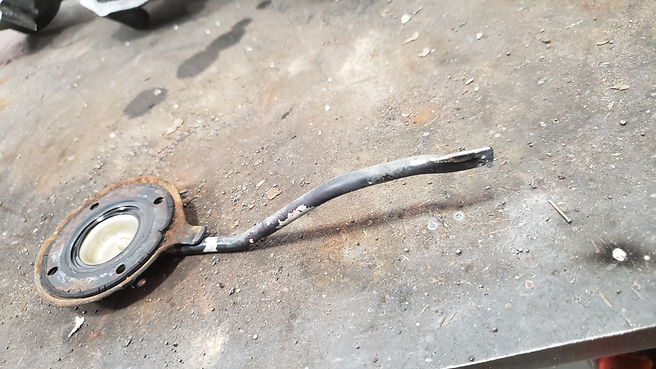

You'll want to remove the pump and rollover vent assembly.
I modify the vent by cutting the line, smashing it flat, and welding shut. Then, I leak test it. Reinstall. A new gasket is probably a good idea if you have the foresite.
The pump gets removed and replaced with either fuel hose or a piece of tubing, to draw fuel from the bottom of the tank. Cut the tip at a 60° angle to prevent the possibility of sucking against the bottom of the tank. It also helps prevent clogging if big debris gets in the tank, and makes for smoother fluid flow, according to FillRite. Mine got cut a bit short here... And I was out of hose. So I will be sure not to ever push this thing past the Fuel Light coming on. I've also done these to where I modified a pick-up sock screen to fit the hose, to retain the filtering and original drawing point.

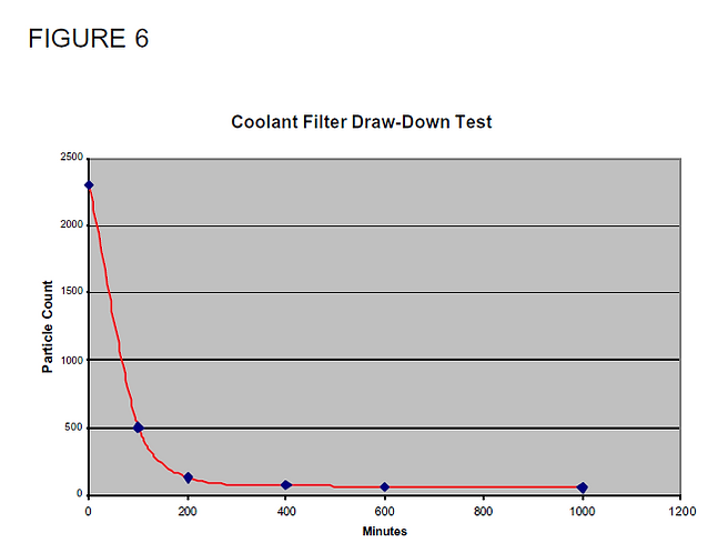

After witnessing chaos in my 855 Cummins, I've become an instant believe in coolant filtration. I'll try to make this long story short... I called Cummins/Fleetguard as well as the local-to-me Baldwin. Baldwin was much more knowledgable. I actually found a major typo on Fleetguard's website, falsely advertising that they had a full-flow coolant filter, which was in fact a by-pass filter. Baldwin is out of Kearney, Nebraska. Their engineer was quick to help me design a full-flow system for my 855 motors to get the huge chunks cleaned up in short order. For engines, like this 617, that are not heavily contaminated, a by-pass setup will work just fine.
To do this, you must install the filter between higher and lower pressure sources. The easiest/most common is before and after the heater core. You "T" the filter head into each line. Imagine an "H", and the filter is the middle of the "H". I simply put a "Y" in the heater hose outlet coming from the head, running it to the filter inlet (so much for that pretty 1-piece made-to-be hose &#128546. I put a "Y" after the heater core outlet, routing the other side to the filter outlet. This allows coolant to flow thru the filter without impeding flow thru the heater core, and when the filter is plugged, nothing else will be affected. This also allows flow when the heater is off. The filter flows a max of 2GPM, and only 3% of the coolant passes thru it on each pass. According to Fleetguard, it will only take 4 hours of runtime to filter the majority of the system down. When the filter is not hot to the touch, this means it is plugged, and it's time to replace it. Otherwise, an annual filter change is a recommended service interval. I've seen these go several years without being changed, and while they still flowed, they began rusting and were a bear to remove. I also wonder how long the filter media can last without breaking down when left for years on end. When properly maintained, engine rebuilders say the inside of the coolant cavities on engines with coolant filters are shiny clean.

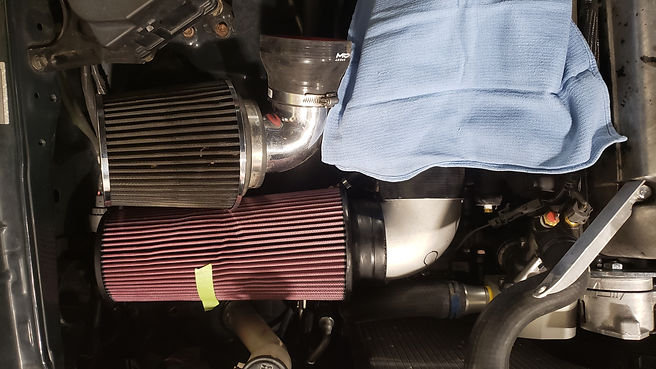

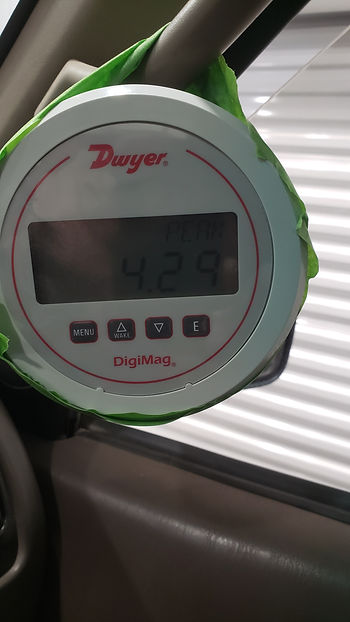

I'm getting very technical about designing a couple different air intake systems for several different specific vehicles/engines. I invested in some top quality equipment so I can measure the vacuum an air cleaner causes. 15" h2o is where I draw the line, to give me tolerance for a dirty filter.
I slapped on my cheap universal Spectre filter to get me up & running. I couldn't measure it's restriction with the plastic 90° elbow, so I ordered a cast 90° that I could weld a bung into for my gauge.
I'd assumed the Spectre was restrictive, so I ordered a massive 12" K&N - the biggest I could fit - but much to my surprise, the max vacuum I could pull with the Spectre was 4", even with being very dirty.
I'll return the 12" K&N in favor of something smaller, which will make building a cold air intake/water shield so much easier & better.
I've ordered a bit larger K&N filter to replace the Spectre. I'll update when it gets here. Going to build a box for it so it's a true CAI.

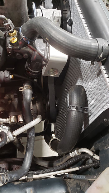

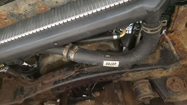

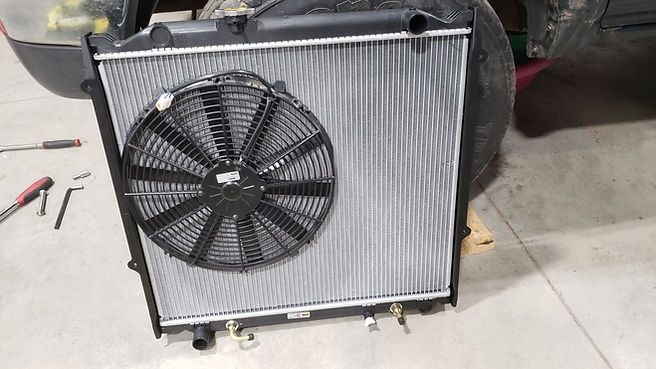

The cooling system is very simple. I used the stock radiator. I used a single hose for the radiator Inlet and 2 hoses for the Outlet. I had custom thermostat housing fittings made to accommodate the ~1-3/8" hoses.
I've requested that ICT Billet makes a 1-3/8" coupler, but they haven't responded to me. Please ask them yourselves, and I'm sure they'll eventually do it. I'm using their 1-1/4" splicer, and it leaks if you don't have your hose clamps perfectly tightened.
I use my favorite 16" Spal fan: https://amzn.to/3X3Eah1
Tucked up into the far top LH corner to dodge the accessory pulleys (this pic isn't accurate - I had to move it all the way up). I had to attach it prior to installing the radiator.
I'll cover the fan controls in my wiring post.

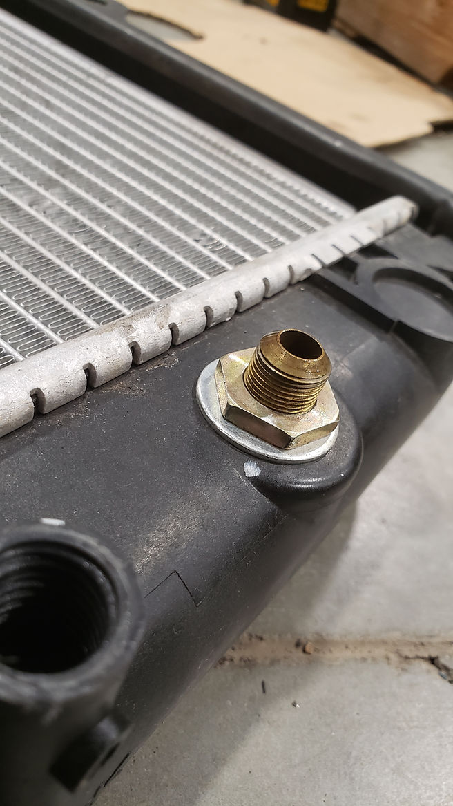

Installing the radiator was tighter than a *****. I found the trans connections are compression fittings, and you could probably convert them to AN hoses, if you wished. I believe Jeeps AW4 cooler lines were actual pressure lines. Toyota did it super goofy and ran pressure lines about 8" off the trans, then ran 2' of low pressure rubber hose. The lines are on the low-pressure return side. But the chances for a leak are scary, as your trans would die a quick death if one popped off.
Anyway, I had to remove the RH compression fitting to get the rad in, as it wouldn't otherwise clear the AC compressor.

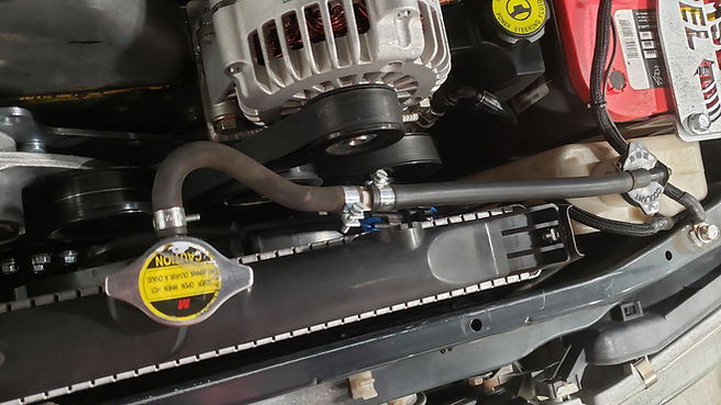

The overflow outlet is in a TERRIBLE location. I was lucky enough to find this perfect shaped hose somewhere on the 4Runner, to keep it out of the serpentine system.

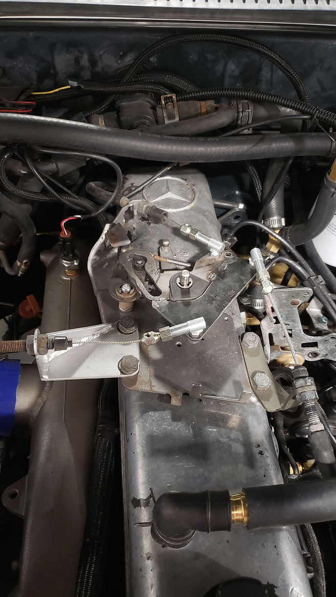

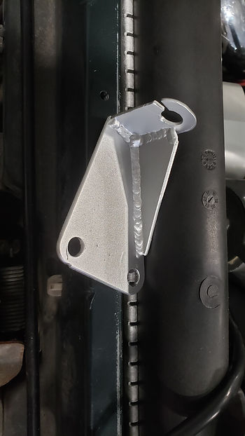

Throttle bracket attachments
The throttle cable has been a bolt-on affair for 5 years, now. It doesn't change.
The line-pressure cable from the trans has to be at rest at idle and fully pulled at max throttle. You don't want to move the STOP lever to gauge where WOT is - you want to use the throttle pedal. Yes, you'll get 2 different results otherwise, because the throttle cable pulls thru some plastic bushing, whereas the STOP lever is hooked up directly, bypassing the plastic bushings.
The cruise control also needs to have no tension at idle and full pulled at WOT.
I used Lokar throttle cable ends to accomplish this. It's not the ideal setup to last 300k miles, I'm sure. But if I get 30k out of it, I'll be happy. To make it ideal, I'd add some stiffeners to the line pressure tab, reclock the cruise module to aim straight at the throttle bracket, rebuild the whole assembly with new bushings. Or better yet, throw the whole works in the trash and design something simple. But since the throttle lever must move backwards for emergency shutoff, it makes things extremely complicated.
I leave the throttle at rest and the cable at rest, and I draw the arc that the cable makes across the bracket. Then I repeat this with the cable and throttle at full extension (WOT). Where these 2 arcs overlap is where I drill the hole for the Lokar. The Lokar has tons of adjustment built into it, so you can fine tune everything. I did have to add some additional material, which I simply cut out on the plasma table and TIG'd on.
This is literally all I had to connect for the cruise and automatic trans to function. The ECU stayed in the vehicle, which controls cruise. Nothing else was needed (no cam or crank or TPS sensors).
When I engage cruise, I can let off the pedal quickly and feel the cruise module sucking in the slack. While this is happening, the speeds drops a bit. This won't be the case in my Tacoma since the throttle cable actually routes to the cruise module, which routes to the throttle. It'll be simpler, cheaper, and tighter/better.
