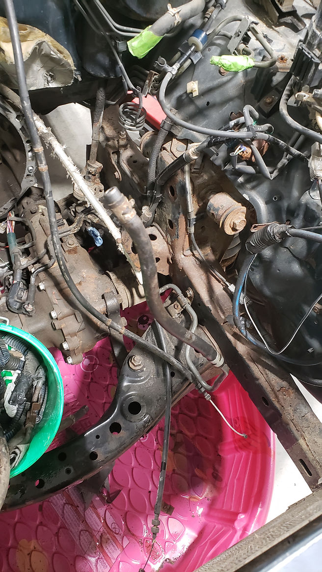

The removal of the 3.4 is a bit of a pain. Make sure you remove the torque converter bolts and leave the TC on the input shaft when you pull the engine, as to not damage the pump/seal or drop fluid everywhere. The most critical part of the engine-pull is to completely disconnect and save your wiring harness. The harness plugs into the ECU behind the glove box, as well as the BCM right next to it. Although over half of the harness will not get re-used, there are some very critical parts of it that will keep your truck from working if you remove it. This is more sever with automatics than the manuals, but A/C is one feature that is controlled thru this, as well as cruise control. The harness unplugs with quick connectors everywhere, so DO NOT CUT ANYTHING!!!
I will break down the wiring modifications at a later point. I'm still working thru it myself, right now. The good news is - if you buy a truck that's already been gutted, you can buy new harness plugs from Toyota. Automatic's have different ECU plugs than Manuals. Once I determine the minimum wires needed, you'll be able to build your own simple harness, if so desired, as the factory harnesses can be sold for over $200.
The fuel tanks on these didn't always come with drain plugs, WHICH REALLY SUCKS!! Mine had the tank replaced at some point, with a cheap aftermarket unit without a plug. I did my due diligence to drive the 4Runner down to empty before beginning the swap, and only had 1 gal left in the tank. To remove the fuel, I removed the fuel pump solenoid (located below the fuse panel and behind the trim panel (4 10mm bolts)), put the supply line into a bottle, and fed the blue/orange wire with 12v from the battery. This manually powered the pump and quickly spit out the rest of the gas. I then added 1 gal red diesel to the tank at a time to slowly dilute/purge the rest of the gas out. Adding 3 gallons all at once would dilute it less overall. Keep in mind that after putting the red diesel in the tank, it only took 5 seconds of the pump running to see it at the supply line. That's pretty fast! I pumped 3 gal. total of red diesel thru. Once I get the rig back outside, I will drop the tank, remove the fuel pump since it restricts fuel, modify the filler neck opening, and dump the red diesel out to replace with hwy legal fuel. For now, though, the fuel pump makes effortless work of priming the engine and removing all the hidden air. Mating the 617 fuel lines to the 4Runner couldn't be much easier! 3/8 for the feed and 617 cigar hose for the return. The 3/8 feed flare may cut thru the hose long-term, so either re-doing a bubble flare here, or getting a flare-to-barb adapter is probably a better solution.

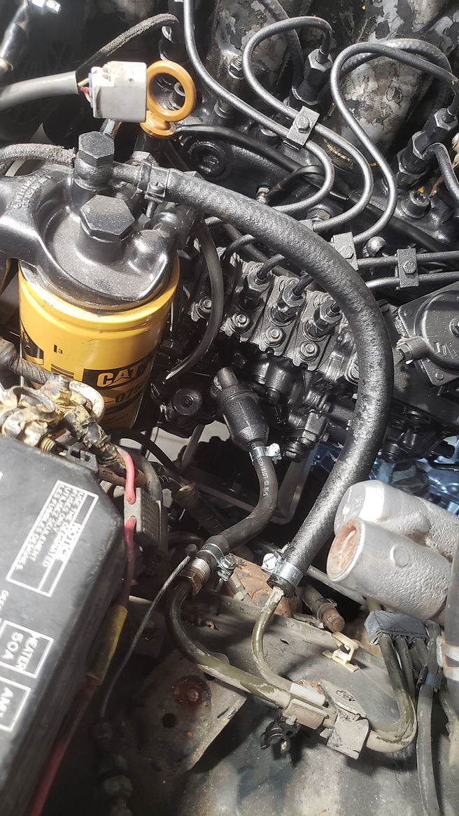

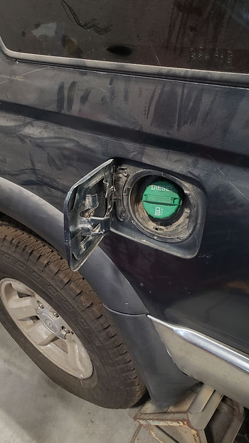

Another fuel system modification is to add a proper vented diesel cap, like Stant 10819D. The gasoline caps are sealed so the vapor can be sent thru charcoal canisters, etc., before being released wherever (in the case of this 4Runner - INTO the frame! Probably why it's rusting there). You'll need to seal the vent line either in the engine bay, or better yet, at the tank.
While the engine is out, several things need to get cleaned up in the engine bay. The power steering lines will get modified/cut down for our TC pump going on the top left of the engine. I cut the return line and added (1) 90° bend to point it in the general direction of the reservoir and added a bubble flare. Some new 3/8" return line, and it's as easy as that! The pressure line gets 2 special fittings + a -6AN hose. ICT Billet F06ANPSM1615 and Allstar ALL48210 convert the Jeep XJ TC pump and the Toyota outlet to -6. A 43" hose, preferably with a bend greater than 90° at the pump and straight at the box gets it done. I try to always route hoses so they touch nothing other than the isolating clamps holding them, otherwise they will eventually chafe thru, whether it's in a month or a 10 years. Since I'm not adding a lift/bigger tires, I don't see why I should need to add a fluid cooler since there wasn't one from the factory. If this was a manual truck, I would simply use the auto-trans cooler as the P/S fluid on the return side, as the line sizes are the same. Although all 3 radiator manufacturers I've spoken with said they'd void your warranty if the P/S caused a radiator failure, all 3 said that it should work fine as long as you're not sending the high-pressure side thru.

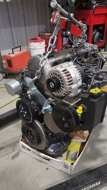

I do everything I can to the engine before installing it. Obviously the rear hoist mount and motor mounts. These motor mounts are slotted so you can decide how much radiator fan clearance you want vs. how much valve cover removal clearance you want.
I put the oil filter relocator, manifolds, ALDA Delete if applicable, alternator/PS/AC/vac pump brackets and accessories on but I leave the serpentine tensioner off. I leave the turbo off since it gets in the way of the starter and motor mount. I use an old spare valve cover since the chains would otherwise destroy my nicely painted cover. Make sure to get your flexplate on 100% (or flywheel/clutch), and you should be ready for installation. I leave the rubber isolators off the motor mounts to give me those couple extra inches to get things lined up. The radiator and serpentine tensioner/belt won't get installed till we're sure things are not coming back out again. You will have to remove the trans x-mem bolts or remove the x-mem completely and have the trans/tcase on a mobile jack as the assembly gets shifted roughly 71mm towards the rear. You'll want to uncouple both driveshafts, too. In my case, I went ahead and welded on my trans x-mem extension, only to later find out that the rear end of the pan was sitting on the heads of those (2) 10mm bolts. I dropped the x-mem to remove them, only for the pan to then rest on the extension bracket. I can't space the trans up as it'll shove the oil pan down, and it's already at min. clearance from the frame x-mem. So, I'll either have to drop the trans x-mem or notch the pan. I'll just modify my x-mem to work for this project, but if this swap becomes popular enough, I'll likely just fab a completely new x-mem since this thing is so crusty and disgusting anyway.

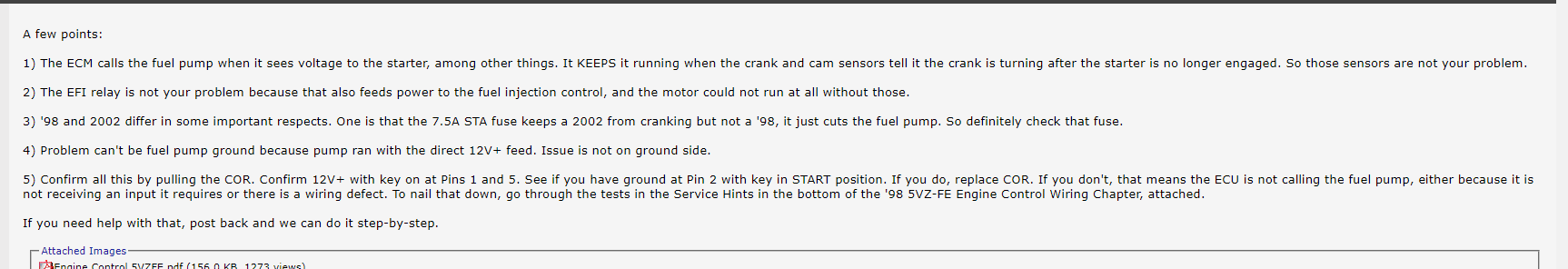

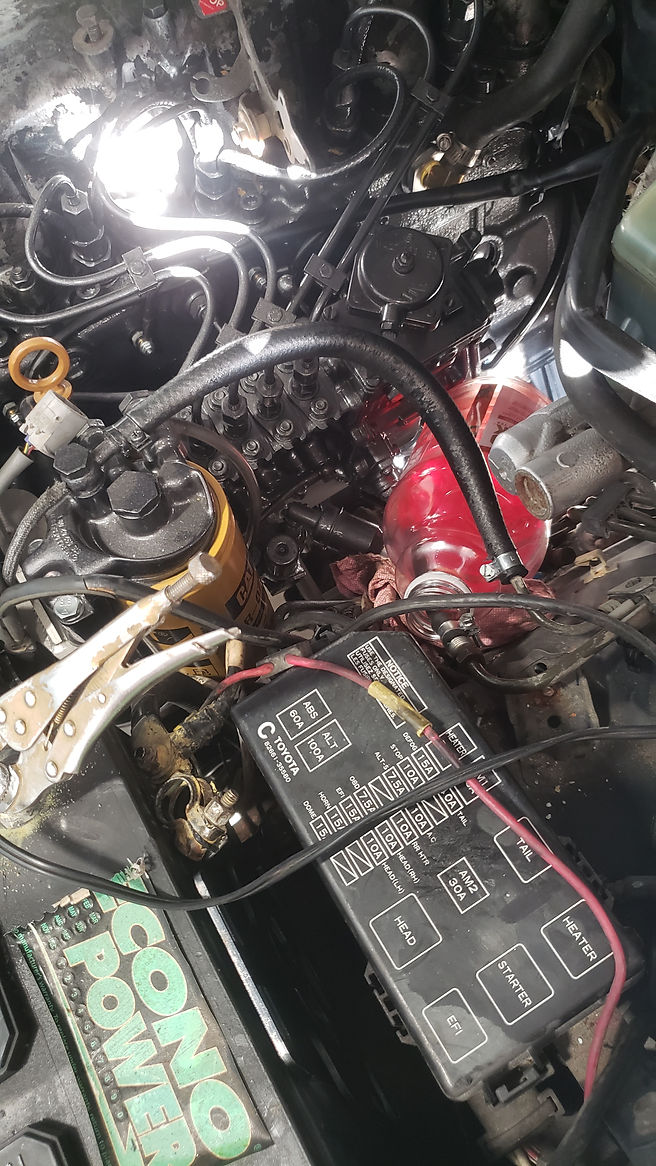

After beating my head against the wall for the past 9 days, I've finally got the wiring sorted out to where the 4Runner will start. I feel at this point as if I am nearly intimately familiar with the 4Runner wiring. The bad thing is - the 4Runners and Tacomas changed wiring throughout the years between 96-04, as did they for auto vs manual. The problems I had, in case it helps anyone is, was my AM1 30amp fuse was blown but wasn't visible. My ground wire going to the neutral safety switch came loose. My BCM master harness plug was not fully seated. And I forgot I had stolen the 10amp fuse from the STOP for a different project. And on these, with the STOP fuse blown/removed, the security lock for the auto shifter will not release. So now, my shifter works as it should, the key fires the starter, and as far as I can tell, all of the non-5VZ related functions will work. I am going to remove the sensor for the AT temp idiot light and replace it with an actual gauge. I'm not using the oil pressure idiot light since my new gauge also has an idiot light. And because Glowshift, for some very stupid reason, does not offer their water temp gauge in 10-color White Elite, I'll be adapting the Toyota sensor and utilizing the stock gauge. The gauges on the 84-95 are so unreliable that even with my sensor disconnected on my 86 and 87, they would both randomly move the needles sometimes. Sure hoping this 97 is more reliable.
At this point, of course Glow Shift is back-ordered, so I'll be waiting on them and the custom Meziere fittings before I can actually fire this thing up and drive it. Going to finish everything else I can in the meantime, though.
After deciphering all the wiring problems, I spent the rest of the afternoon installing the old oil filter/cooler setup from my rock crawler Yota. It's been around since 2012 and I know it works, so I've repurposed it for this rig, for now. Once I've gotten my testing done on my stock-pump-Yota's liquid/liquid heat exchanger, I'll possibly be adding one to the 4Runner to test its capacity with the 7.5mm pump. If I don't go that route, then I'll probably re-do this air/liquid setup to tidy things up, as it's all crammed in there very crudely for now just to get it going sooner. One thing I've learned from making tons of cutsom hoses is: Summit's reusable hose-ends suck! Only plan to install them once, because reusing them creates an extremely high chance for a leak. Even when installed the first time, they like to leak. I stick to Fragola, now. Yes, it's expensive, but they don't leak.
Found this extremely helpful post while troubleshooting my wiring issues. Posting here for future reference.

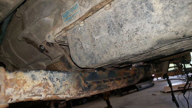

Lots of updates to upload on here... So the trans x-mem is not straight. It actually humps up from the factory. So, to combat the problem my x-mem bracket was inducing, I flipped the factory bracket and stacked 2 of my brackets (3/8" thick total now) and that fixed my problem for the height (didn't prep real well so it looks like poo but oh well)
. Now to address the oil pan rubbing, I did have to notch the factory x-mem. I'll be offering a weld-in notch piece if this gains popularity. So now, I can drain the trans pan without removing the x-mem. As for driveshafts, I royally screwed up by not marking where they sat bone stock. I moved the trans back ~71mm, but I also bumped the trans up. So although it still doesn't make perfect sense to me, 3-1/8" appears to be how much I need to modify the shafts based off the grease mark on the front.

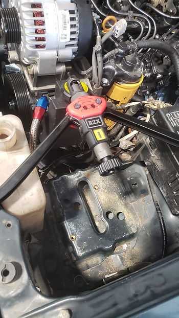

So the AD230 fit without a lift, but I could tell that it'd be hitting the hood once the engine started rocking, so I notched the hood support. You'll either need a 1" body lift or a hood support notch. The AD244 will be even worse.
I'm running a Ford vacuum pump with the large ~5" GM pulley since the Ford 4.1" pulley didn't give enough belt contact. It works great! I haven't had any issues with braking.
I'm also going to switch to flanged hex bolts for the water pump pulleys moving forward after having a bad day getting a button head out. Here you can see the extra clearance the button heads give, which is why I've been using them. But I have plenty of room for my fan here. Speaking of which, my favorite 16" Spal fan fits! But I'll go into depth on that more once I get it all wired up.

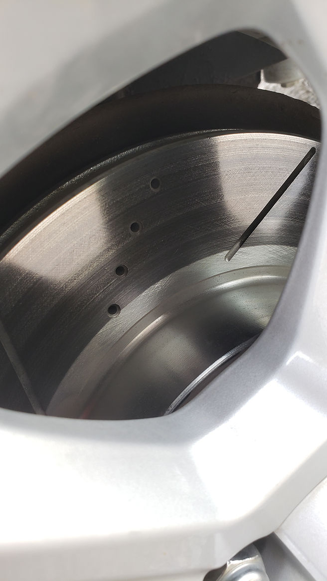

Got the Powerstop 231mm Tundra Brakes installed. Went out to bed them in, which went relatively OK (sucks doing this in traffic, though). Stopped to make sure they were stone cold before heading back to the shop, and they were blued and cool. Had a straight, no-stop 8 mile stretch back to the shop. When I began to turn into my driveway, I noticed I had not power steering. The Summit Racing stainless braided line blew right out of their AN hose end. The Dorman POS pulley put the first knife in the pump, and the POS Summit hose finished the kill. I doubt either of them are willing to step up and pay me for a new pump!
The plan all along was to build a DIY Summit ps hose, test it out, and copy its specs to have a custom Fragola hose made during the Final Phase of this build. I knew it was a risk that it may explode, but I banked on that not happening in <300 miles of shakedown runs.
When I got out at the shop to inspect the carnage, I also noticed the brand new rotor was already about to dislodge a big chunk off the perimeter. I'll be warrantying these, as well. They do have a 3 year 36k mile warranty. I plan to use as many of those miles in the next 3 years as I can.
4Reigner is now down for the count while I perform all of the aforementioned work. The p/s system should shine with a new Fragola custom-made-to-spec high-pressure hose, a new pump, and a new Trail Gear billet pulley.

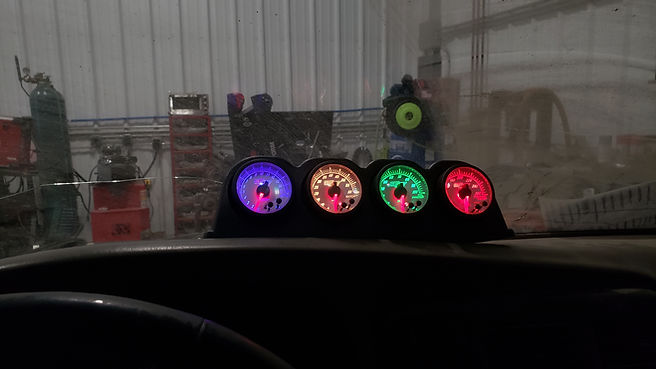

I realize this build is centered around the first-ever A340/Toyota Automatic OM617 Swap, but I want to point out that since I'm not yet offering this auto kit, all of you 96-04 guys will be running R150's/W59's for the time being, and with the manuals, all of these shifting issues and gearing issues and interior shift stick placement are non-issues. The manual OM617 swaps in these should be a PIECE. OF. CAKE. I want to just quickly mention the gauges and readings I've been seeing. Knock on wood, everything has been a non-issue there so far, so I haven't even really thought to mention them.
Coolant - The gauge reads anywhere from dead middle to the cooler side. Can't ask for anything better, here! The 16" Spal fan runs all the time - I've never seen it kick off once it comes on. The engine warms up to operating temp within 2 miles, which is even quicker than the 5VZ I replaced. I'm running a 185/175 thermal switch for the fan.
Voltage - I don't have a voltage meter. Pretty disappointed Toyota didn't have one in the SR5 cluster.

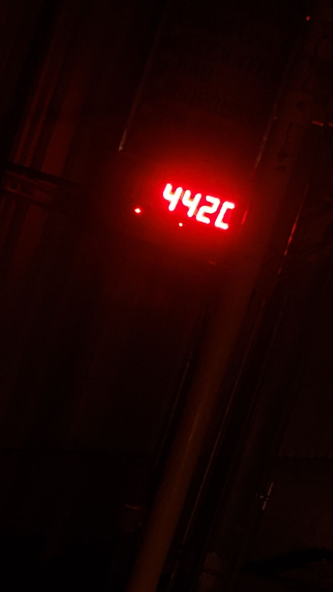

Pyrometer - EGT's were ice cold with the aftercooler sticking out of the engine bay, so I know I have plenty of capacity there. With the hood on and no scoop, I see EGT's creep up to about 1100° when getting up to highway speed, but then they settle right back down to that 500-800 range.
Boost - My secret turbo is a touch on the larger side, so it runs low boost at hwy speeds, and it takes a little big longer to lite off, but it absolutely makes this thing scream passing people on the hwy. This would be the best turbo I've found to-date with a higher stall speed, some better diff gearing, and better shift points. If I was on a budget doing an A340 build with all the factory parts and tire size, I'd simply run my HE221 7cm², which would compensate for everything else being a bit off.
Oil Pressure - This engine has great oil pressure. It runs at 90psi under load, at operating temp, and 20psi at idle.
Trans Temp - Surprisingly, the temp has barely gotten up to 160° during normal driving. I saw it get to 180° during the maiden voyage before I'd gotten the trans topped off and it was probably about a quart low. But 220° is safe for this trans. So I'm ecstatic about 160°. Things to note here are - Toyota's temp sending unit was not just for an idiot light - it actually read the temp, which you could read if you had a Scan Gauge or OBD2 scanner. How asinine, for a vehicle to have the diagnostics in place but not let the operator see them! Apparently the ECM would shut off AC if the trans temp got too hot. I replaced the factory sensor with one for my gauge, so, that feature won't work now, obviously. And the idiot light supposedly doesn't come on till 300°, which is also asinine, because your transmission is 100% smoked at 300°.

Brake upgrade time! Any time I'd hit the brakes above 15mph, the steering wheel and entire suspension would shake violently. I got in the habit of manually down-shifting to mitigate this, which is good now that I have to for the diesel driving, anyway. But I needed brakes... Did some research and found a 2001 Tundra brake package fits. The smaller brakes can fit the 4Runner 16" wheels, but the larger 231mm package requires 17mm wheels. The brake price difference was negligible (they were both expensive), so I went with the bigger ones, even though I hated the idea of buying yet more wheels/tires since I have tons of 15's kicking around.
I got Powerstop's 2nd best package for $350 with a bunch of discounts and promos. Found some primo 5th gen wheels for $200. Got some NOS tires off craiglist for $420. Had them mounted/balanced, got them back, threw the first 1 out of the truck and weights came off, so back they went to the tire shop. The idiot didn't even wipe the wheel at all - just tried taping the weight on over top of brake dust and dirt. They're good now, though. I'll be burning off my excessive supply of tires in the rear, hence why you'll see my pictures with weird wheels in the back.
The swap was completely painless. Somehow, all the hardware came right out, even the brake fittings, and bleeding went smoothly. I went to bed the brakes in, getting that nice blue color on the rotors, and one of the rotors began showing a casting flaw. This led to some major down-time (2 weeks). Eventually got the bad rotor replaced and with 600 miles on them now, they are freaking awesome!! Hands down, should've done this the first day I bought this 4Runner. I can damn near do a stoppie.
