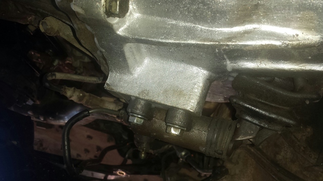

Flywheel: I brought the 3vz flywheel to a machine shop along with the spacer from the 1uz torque converter that had the center bore and bolt pattern for the flywheel. I had them bore out the bolt pattern and center bore to match the spacer so the 3vz flywheel will fit on the 1uz. I also had them take off 5/16 from the back of the flywheel where it bolts on so it moves closer to the engine to help with starter engagement. For all that plus a flywheel resurface it was 130 I believe. I used the 3vz clutch. I have a friend that has this same setup and he used the original 4runner throw out bearing. Mine was not working for some reason so I had to use a 3.4 tob. It’s a bit too much but I think it will work. Took some work installing the slave though.
so ran into issues. clutch is not working. slave is pushing a good inch but clutch is not disengaging. heard that sometimes the clutch rusts to the flywheel and you can start it in high gear to dislodge it. gonna try that. slave was hard to install because the 3.4 tob was a slight bit too big so i had to push the fork a bit to get the slave on. ive tried shorter shafts on the slave so the fork had a little play and got nothing.
update:
got clutch sorted. not sure exactly what happened to begin with. i dont think i disconnected the slave til after the clutch wasnt working but when i did eventually disconect it i was also bleeding the powers steering and after 3 days of bleeding the clutch slave realized i was using ps fluid :/ been a long build. changed that out and now the clutch is working great.

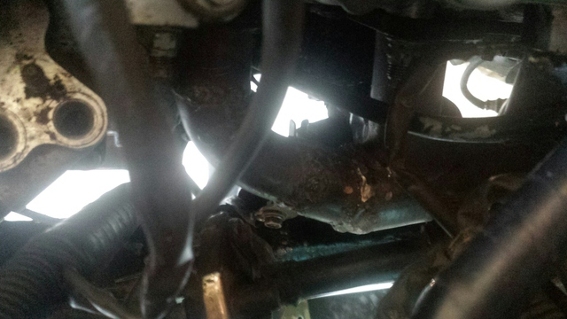

Transmission: got moved back 2 inches to make the motor fit. When 1uz valve cover hits ebrake bolts is where I stopped. You can get a bracket that slides the trans mount back. I believe from lowrange offraod(need to check that). Its basically a 3/8 thick plate that bolts to frame crossmember with slots that allow you to bolt the trans in anywhere back to like 4 inches.
Driveline: ended up being long. Original driveline length it 48 ¼ collapsed or so and im measuring 46 ¼ from trans yoke to diff yoke. I know another guy that has done this swap and he said he used the stock driveshaft somehow even though we have almost the same setup. But mine wont work so im looking into a shorter driveline. A 3gen pickup manual shortbed came out to the right length. 45 ½ trans to diff. unfortunately it was a nasty rollover and has a dent in it so im still looking.

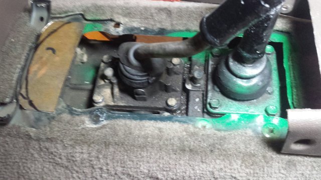

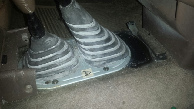

Inside the cab: I had to cut the floorboard at the shifter about 2 inches to the rear and weld a plate on the front to make the rubber shifter seal boots work.

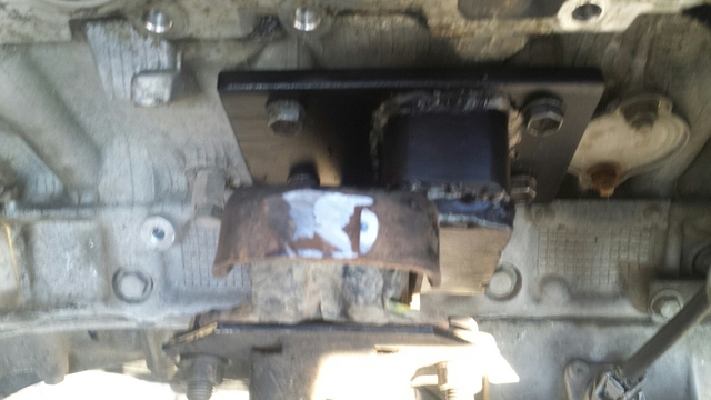

Motor mounts: ended up being about 2 ½ inches tall using the original 4runner rubbers to mount too.

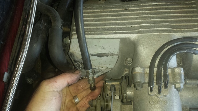

Fuel line for 1uz is on opposite side as the hardline for the truck. I got a 3 foot steel braided -6an line to fill in the gap and connected it to the 1 ft rubber hose coming off the fuel rail. Was a challenge finding the right fittings because I couldn’t find the right info on google. A lot of people just cut the fitting and clamp a hose on. If you don’t want to do that the fitting size is m14 1.5 inverted flare. i currently have the hardline m14 1.5 inverted directly into the -6 an hose on the one end. it screwed on but i doubt its going to seal. we will see. stock hardline fitting(m14 1.4 inverted flare, male) to 6an female seems to be holding up. no leaking. you will also need to run a return line back to the fuel tank. I used a male nipple 6 an to 6an inside tank up through the top of the fuel pump hanger plate. Tied that to a 6an female to 3/8" barb 90 degree. Make sure you don't get the nipple inside too close to the edge. It still has to fit inside the hole in the tank

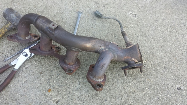

Exhaust: I used ls400 manifolds. Cut the flanges to the cats off and they fit except at the steering shaft. I cut and pie cut the tubing from the first cylinder til it missed the rag joint/ steering.
ugly from here but i used pieces i cut out because budget

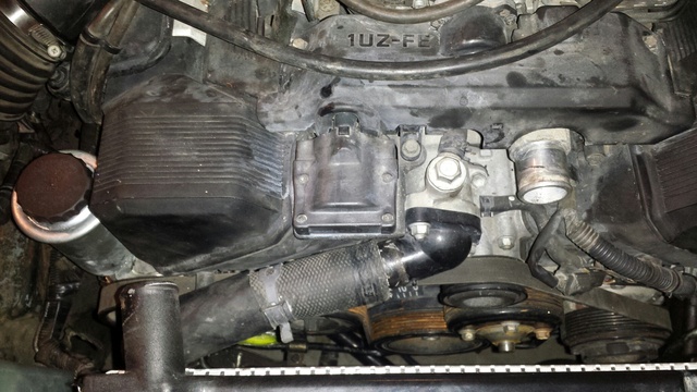

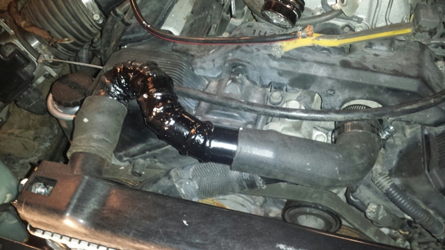

Coolant: using 4runner radiator is a bit tricky. Obviously you cant run the mechanical fan if your already pushing the trans back to make room upfront unless you push the motor way back with some other modifications. There is not quite enough room to run a radiator hose between the radiator and pulleys and theres not enough room to run a hose down the drivers side of the motor so the one hose has to run over to the pass side from the middle of the motor then down to the bottom of the radiator then back to the pass side and 90 in. one of the lexus hoses will get you over and down, then I used 1 ½ exhaust pipe and welded a bead on the end to keep the hose from slipping off and used it to join a couple hoses. The top was a tight fit and weird angle so I used 2 hoses and some pie cutting on the exhaust pipe. As for the heater hoses I was able to make those work. Youll have to figure them out. The small hose coming off the thermostat housing can be capped.

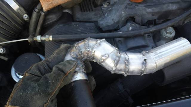

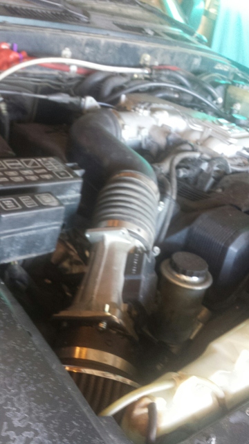

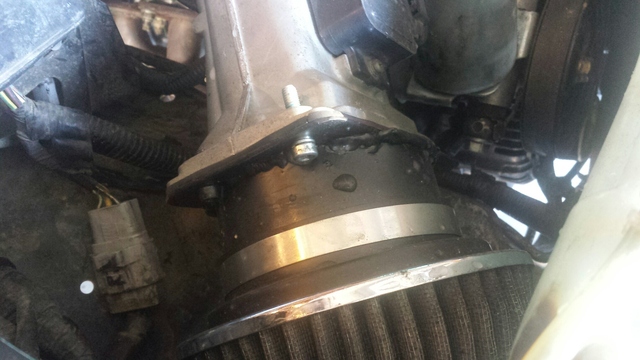

Intake box: air box wouldn’t fit without extensive mods. I had an extra cone filter some 4 inch tubing and some plate. So I made an adapter and bolted it to the afm tube. 4 inch was tretching it. Had to use allen bolts but I got it to work. Battery will need relocated.

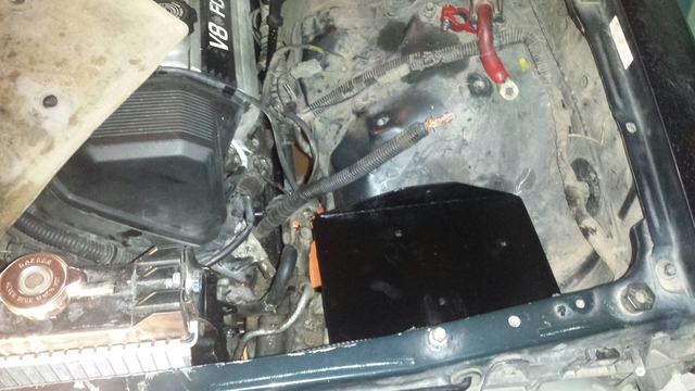

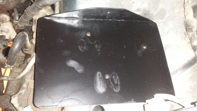

Battery relocation: 4runner has battery on pass side. Lex/1uz has battery on drivers. Air intake made the decision easy. Had to move the battery to drivers side. Made a battery tray. welded some nuts on the bottom and ran bolts up through into it.

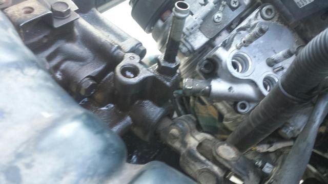

oil filter: oil filter hits frame rail where im at. i bought a summit oil filter relocation but they used straight fitting coming off the block off plate. i have a regular 90 and a 2 piece 90 on the way. the 2 piece 90 is 1/2 npt to 5/8 barb which i need 1/2 npt to 1/2 barb so its gonna be some work getting it to fit the hose if i even can. I ended up getting 5/8 hose for the 2 piece fitting.
Power wires: fuse box in engine bay needs to run to battery that is on the drivers side now and its only about 8 inches long. So I cut the wire off of the plate that connects the abs and alt fuses and ran my own wire and just used a terminal to one of the bolts. The wire I ran to the fire wall. I also have a 2/0 power wire for my amps I ran to the same spot on the fire wall where I installed a battery stud. From the battery stud I ran a 2/0 wire to a fuse right before the battery, then to the battery. starter power wire runs to battery now that its on the drivers side but it’s a bit short. Threw in a fuse and added about a foot of wire. Alternator you could run into this same fuse but since the alternator plug wiring and oil level wiring are grouped with it I just ran it toward the firewall where I put my post
Psteering: cant remember on this too much. I believe I used the 4runner ps lines. I bent them but now I need them moved back in the direction they originally were so you might not need to even bend them.

yeah, i originally ran the v6 rad so i had less then 2" clearance. i ordered a 10" with 2300cfm figuring the cfm would keep me covered but now that im running an aluminum rad i had to push it forward so i have more room. picked up a taurus pull fan for stupid cheap. gonna fit that. also have the ls400 push fan if i have too. if i need the push though im assuming i have something else wrong. everything is new though. new red fluid, new metal waterpump, new rad cap, new rad, new t stat. i did find out the fan i had was shorting out somehow. running slow at times but ran good when stopped lol. for a while anyway
