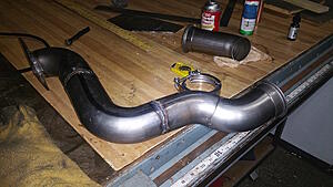

Got the downpipe done & installed, here is a pic of it before the welding was finished and it went in.

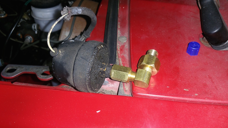

Here is a photo of the Toyota oil pressure sender with the two adapters applied to it, ready to be tightened into the 617 (I have a placeholder bolt in there now). This is a 1/8 BSPT (Toy pressure sender) to 1/8 NPT adapter from mcmaster, followed by a 1/8 NPT to 12mm 1.5 elbow adapter from mercedesdiesel4x4. i wasn't able to source a 1/8 BSPT to 12mm elbow, so two adapters were required.

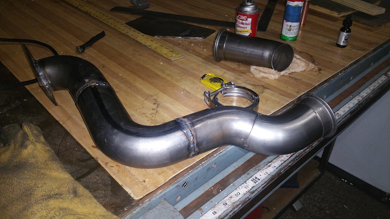

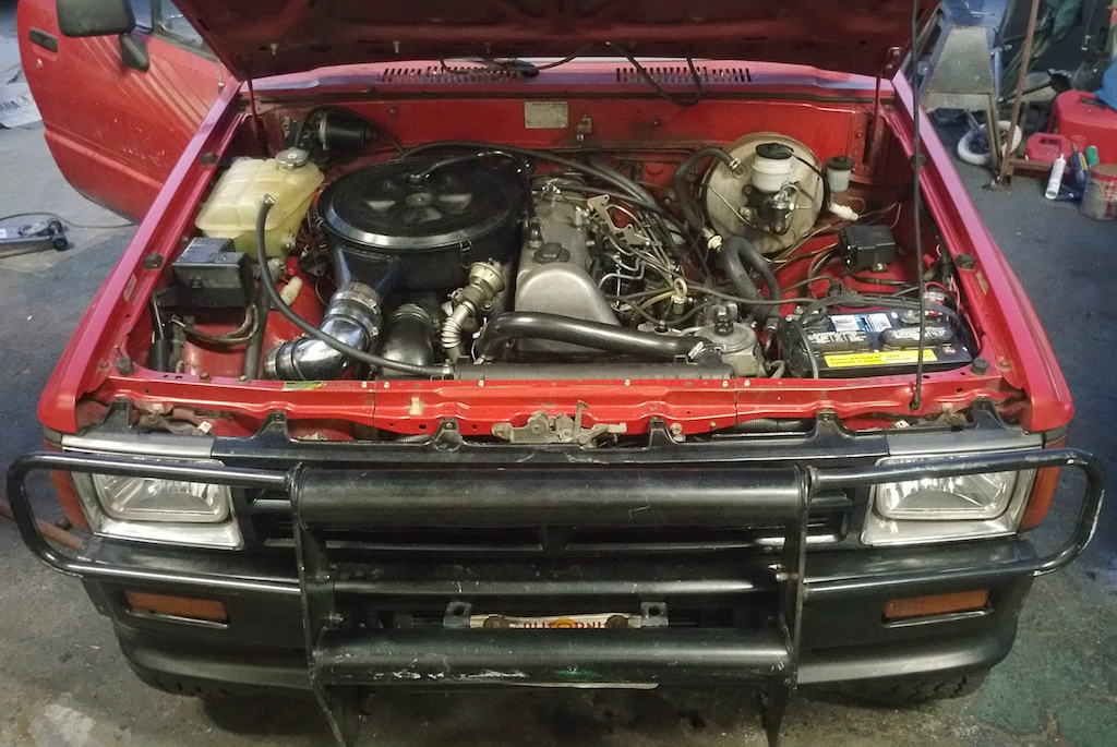

Well here it is for now

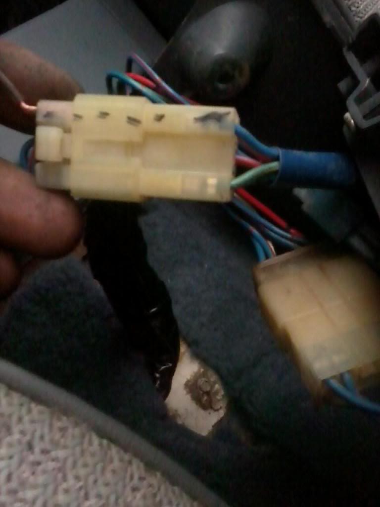

I see you got it fixed but here is how I bypass all safetys
Running a ground wire from this wire on the plug, the blue wire to the place on the pic below elminates a lot of problems.
Ground to center consloe mounting tab.
The ground wire bypasses the following safety switches. Cover Top and Door Lock Detections switch. Your window will roll up with top off. This is on Page 12-23 of the Haynes Manual where the key is to the botom of the page.
Haynes "L" for Blue, "R" for Red. Key is pointing to wire.
