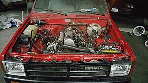

I am staying away from modifying the block at all, and on that note the om617 has a plug that holds the water temp gauge sensor. It sits driver side in the middle of the valve cover by the injectors. I removed it and tapped the port for 16mm 1.5 which is the threading for the 22re's water temp gauge sensor.
The toyota water temp gauge sensor adapted into the merc plug

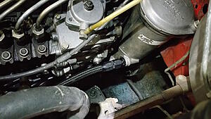

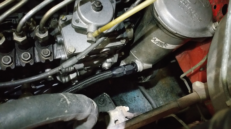

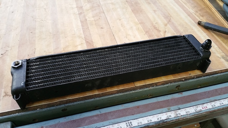

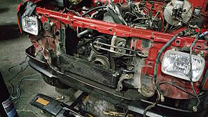

Some pics of the oil cooler install:
Nipples cut off and threaded for 18mm 1.5, showing one of the 18mm 1.5 -> -8AN fittings
The same fittings on the oil filter housing (threads already match 18mm 1.5). Showing with the -8AN hose attached. Thanks Earl!

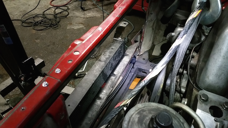

Oil cooler installed. "Lower" hose runs through the front bumper crossmember thingy. Had to cut a small hole to get it to fit. Same for the "upper"
Feeling pretty good about today, I'm pooped. Tomorrow have to re-notch the oil pan, make the transmission mount adapter (been putting that one off), and get this thing STARTED!

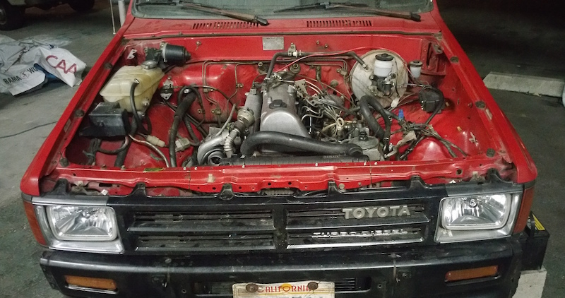

+ throttle linkage adjusted for stops (manual shutoff still works)
+ oil pan remodified and fits
+ power steering done
Driveshafts should be ready for pickup tomorrow.
Remaining to get the motor started:
• transmission mount adapter
• heater hoses
• fuel pickup
• electrical to batt/starter/alt/glow plugs
• a couple of vacuum lines
• fill it with fluids
Other stuff to do before road ready
• parking brake housing mount (oil filter sits right in the way of stock location)
• shifter set-back
• breather routing
• stock gauges (oil pressure + water temp + tach)
• brake booster to vacuum pump
• intake & exhaust
Always more stuff than it seems Even though I know I still have a lot of little things left, it feels like I am on the home stretch.

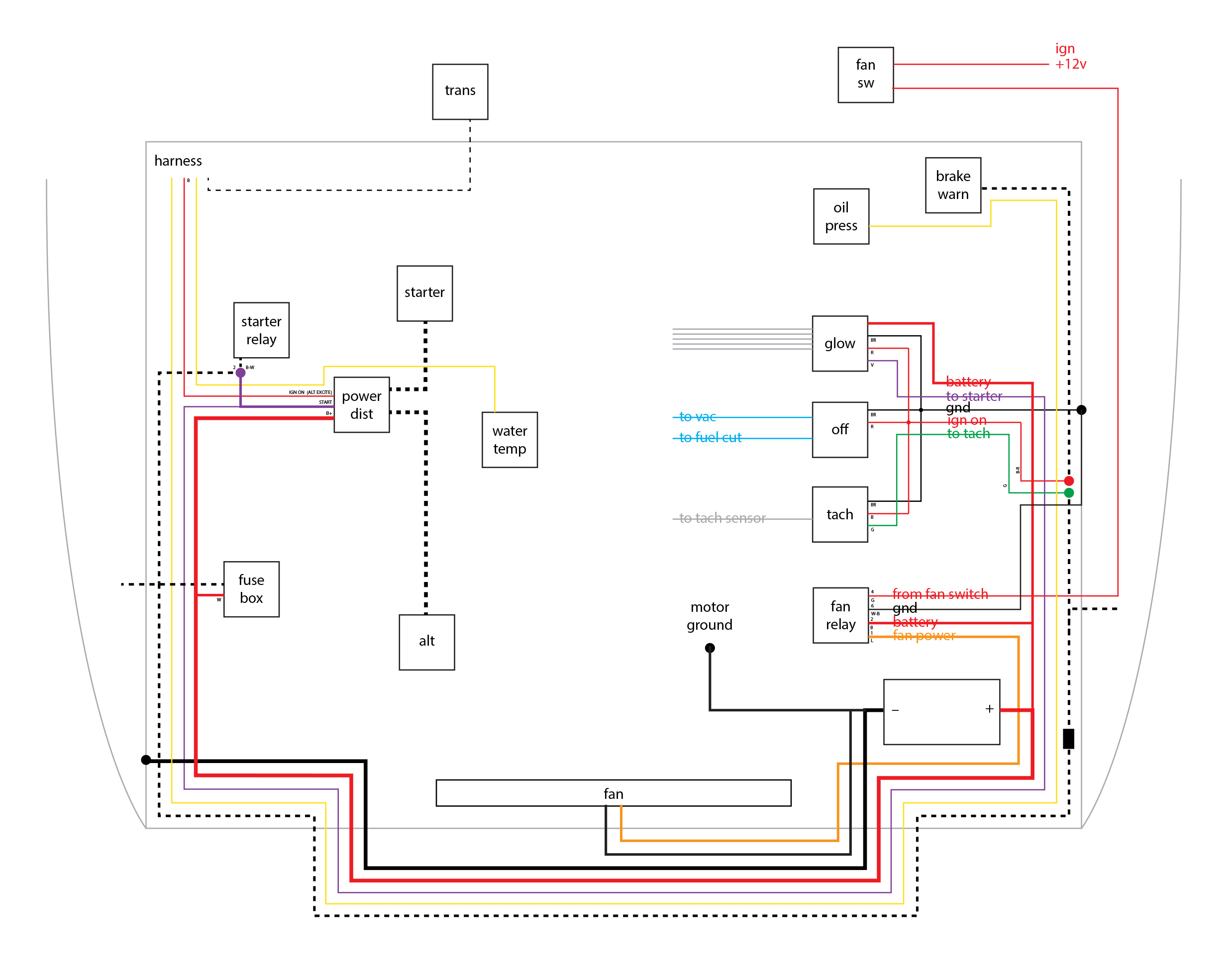

Still getting past electrical
This is my wiring diagram, mostly tested
EDIT: updated high res
Black dotted line = existing harness/wire bundles
Using the stock harness for
• starter relay +12v switched
• ignition +12v switched
• water temp
• oil pressure
• tach wire (MB tach amplifier for signal)
I needed a relay for the pusher fans, so I'm using the Circuit Opening Relay since I don't have an external fuel pump anymore. I am opening the relay via Fc, which used to be for the AFM fuel cut switch. Through the coil I am running +12v switched ignition, which can be interrupted by a switch I had mounted near the parking brake. That serves as a manual fan shutoff so I can turn the fans off while cruising. Otherwise they will be on anytime ignition is on. I do plan to add a thermo switch later as another interrupt. Still need to test this.
Not pictured in the diagram, I also wanna drive a small relay with the glow plug warning lamp +12v to close the ground to the check engine light... meaning the CEL will appear while glow plugs are charging. The violet wire in the ecu harness is for CEL. If you ground it, CEL comes on.
By using the stock toyota water temp sender and oil pressure sender, the stock gauges work in the cluster. Plus that means I don't have to do any wiring back there. Gauge signals are patched in near where the ecu was, I believe it's the end of the combination meter harness.
EDIT: forgot to mention. The "off" in the diagram is the alda vacuum solenoid pulled off of the merc near the driver side fender in the engine bay. Give it +12v switched and it closes its vacuum ports. I split a small vacuum line off of the brake booster line, which goes through the solenoid and then to the fuel shutoff through the other port. Key off = no +12v to the solenoid = solenoid opens = vacuum gets to the fuel shutoff = truck turns off with key off. Tested and works
Might as well also explain the glow plug relay wires from its pigtail. Brown is ground (black in diagram), red is +12v switched, blue is idiot light (not in diagram), and violet is starter relay +12v. Then there is a big red power wire for actually supplying the power to the plugs. With big red to B+ and brown to ground, you can turn the glow plugs on by running +12v through the smaller red wire. This tells them to start heating. When you apply and remove +12v via the starter line (violet), it turns off the glow plugs after a start. Got the info from the video earlier, very helpful.
Anybody know how much current the Circuit Opening Relay is rated for? Can't find any info. The part number is Denso 85910. Need it to drive about 12A (6A each pusher fan)
