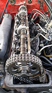

EDIT: Also be sure to check your timing chain stretch. Excess wear in the chain reduces IP and cam timing which reduces power, even a few degrees will make a 617 feel sluggish.

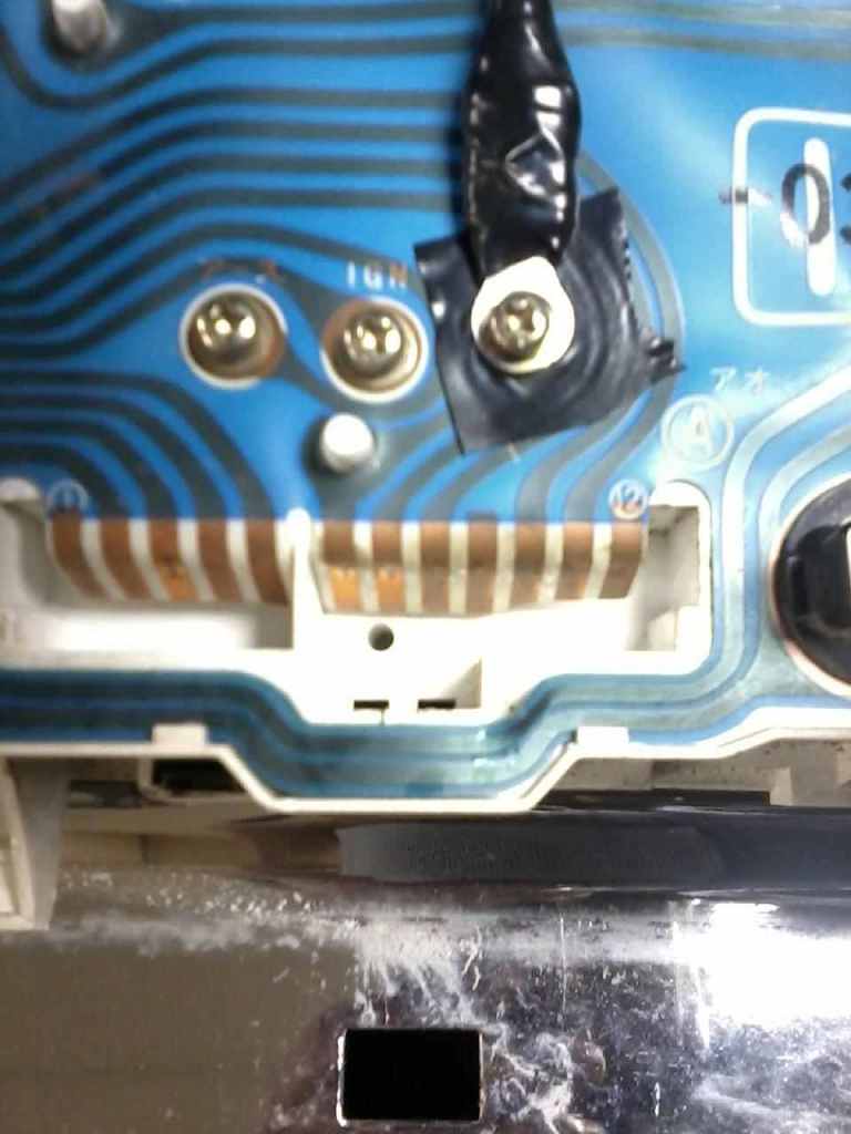

To get your factory tach working, below will make it work. To adjust the tachs, in the SR5 gauge swap thread, there is a picture of where and how to adjust it, I can find it later for you later if needed. I am only guessing but I as long as you run the wire to the negative side of the MB coil, everything should work as far as the tach goes.
Copied from my thread..
Starting on my tachometer and what is needed to get the tachometer working.
I then ran a wire to the negative side of the coil, on a carburator coil it is a little different then a standard coil you are most used to seeing. This truck didnt come with the SR5 guage so I added it. If your truck is not Plug and Play like some are, you need to run a wire from the negative side of the coil to the little "p" to make the tach work.
Then what I did so as not to short out the electrical run beside it. I placed a piece of electrical tape over the little "p" and crimped a wire to the smallest connector that I could find.
I used tape for insulation and to make my connection to the "p".
Run your wire to this point.

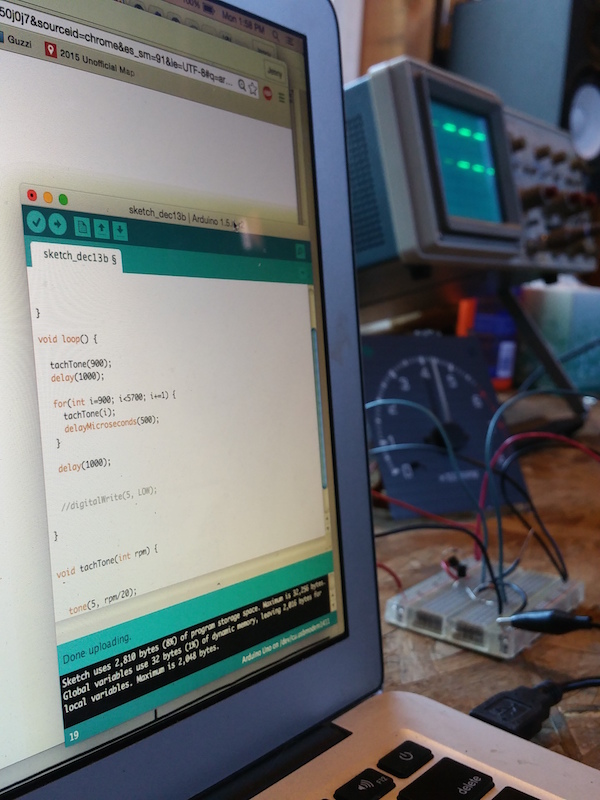

I am able to accurately move/animate the tach with the arduino, but yeah an actual circuit looks way more appealing and trustworthy.
I might end up going with the dakota digital flywheel thing, just whatever I have time/patience/money for.

I am pretty certain I have some significant chain stretch going on. Now just looking forward to getting it to 26deg BTDC exactly. I am going to wait to set the timing properly before messing with timing anymore, was just curious to see if it made a difference, and it did.

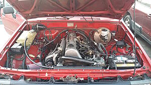

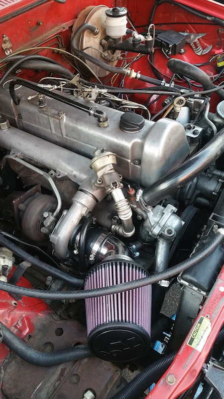

Some pics
simplified filter setup... nice breather routing (temporary until I make an oil catch)
still some tidying & mounting to do but you get the picture
arduino controlling toyota tach
Really starting to dig it!

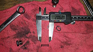

What can I say, Cadin! Your post inspired me to take action fast.

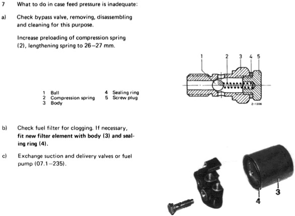

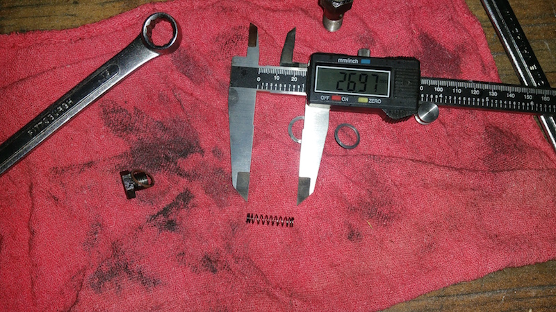

I pulled the fuel bypass spring, and whaddya know
Bent it to near 27mm and reinstalled. It took a surprising amount of force to resize it, and I went slowly and carefully in increments
Butt dyno showed moderate improvements across the board, but I didn't really try pushing it. It seemed to have more idle crawl torque when I pulled out of the driveway and idle sounded deeper and very smooth, but too early to rule out placebo for all of this. it's been rocking the truck a slight bit when warm, so I wonder if it will be smooth tomorrow once it warms up. It also makes me wonder if I need to bring the rack damper spring back into spec as well...
The most drastic new change is that the primer pump is 3X harder to press, and it is no longer spitting bubbles into the line above. No more air in my fuel lines, the bypass spring was the culprit!
per the fsm:

Hadn't taken a pic of the truck itself in a while, thought it looked kinda neat when the rain started

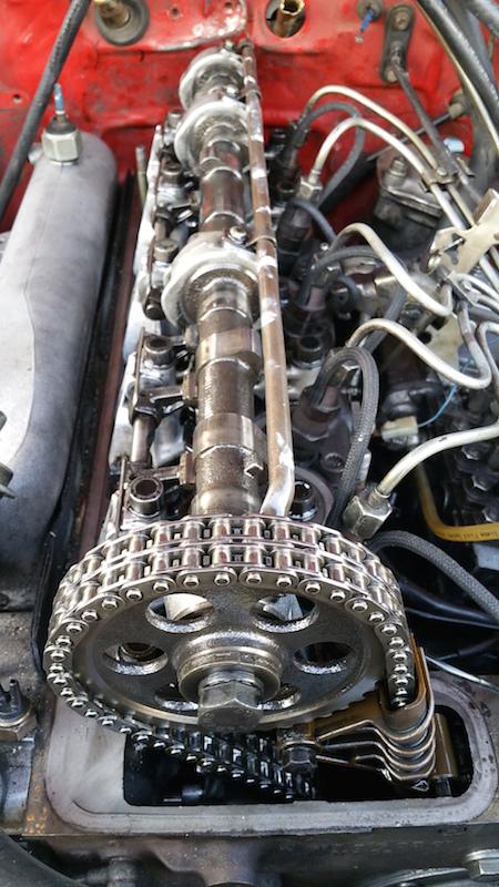

A pic when I had the valve cover off
