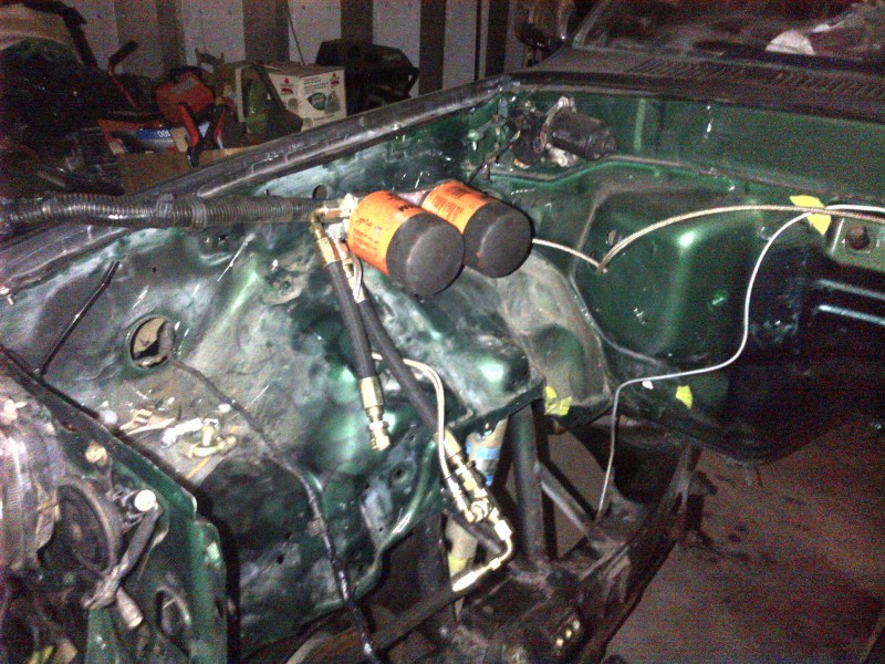

Dual oil filters, I am running a cooler

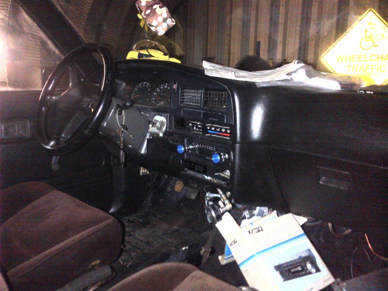

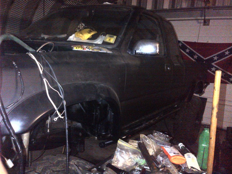

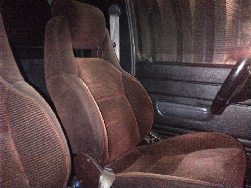

Interior in, painted black, all controls work, blower works

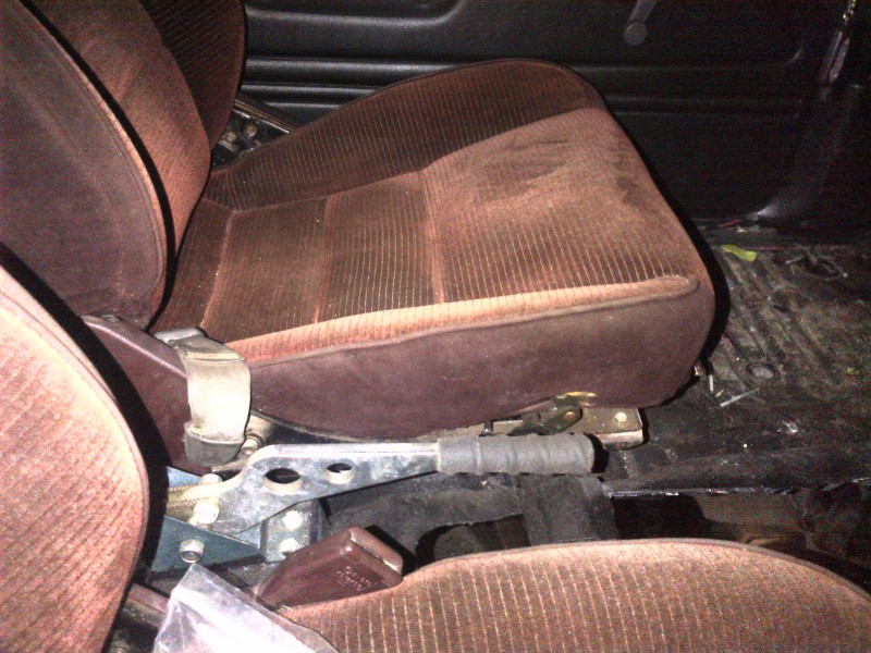

Power seats from a MK III Supra, yea they work

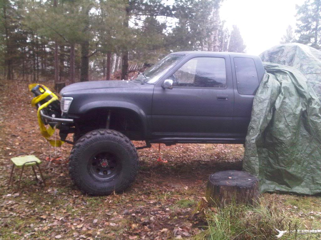

How she sits

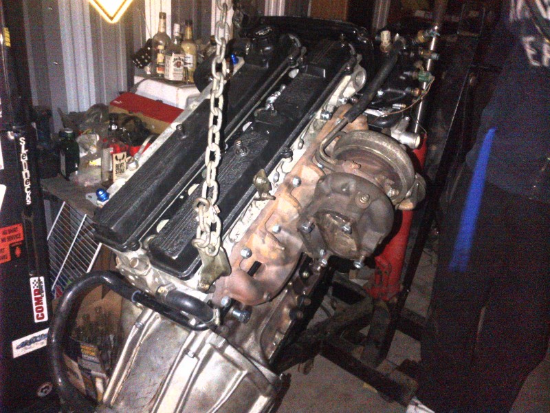

R series tranny mated to the 7M

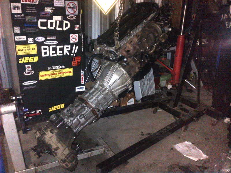

Freshly rebuilt Toyota 7M-GTE

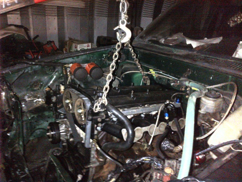

In tha baaaaay

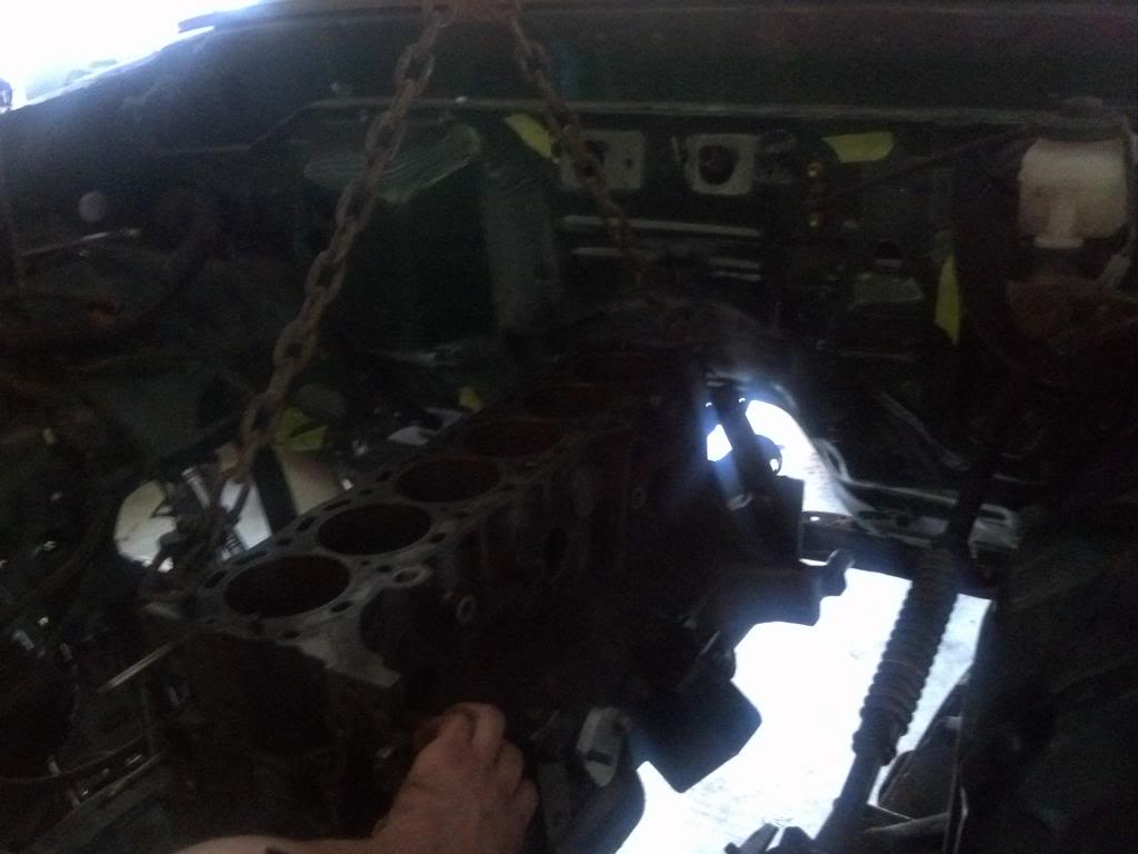

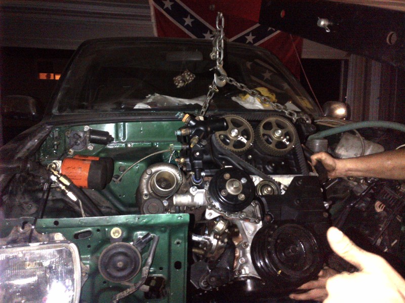

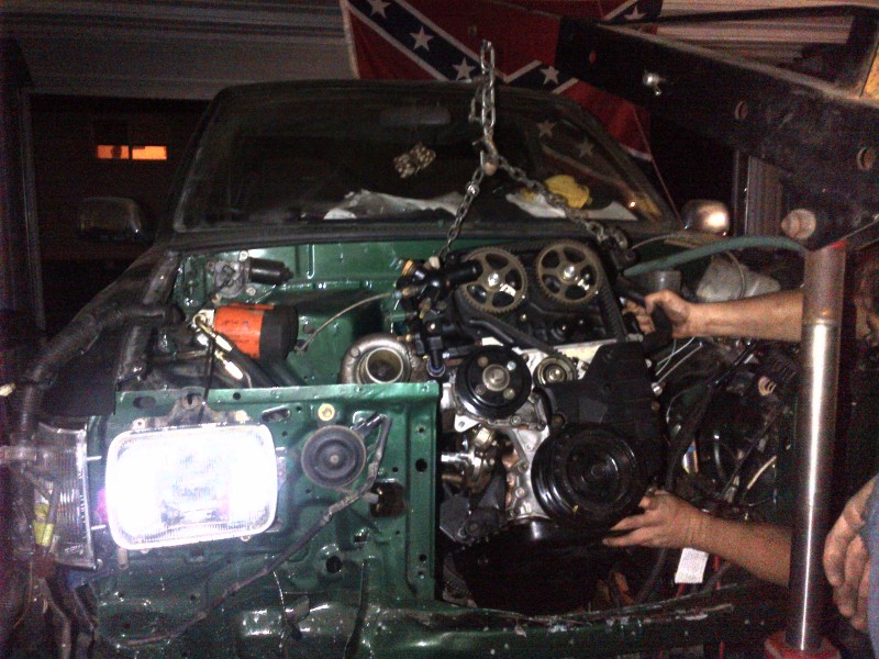

Dropping it in
You have to drop it in with the trans bolted up due to lack of clearance by the firewall

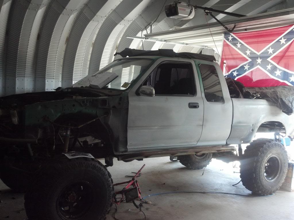

So I bought the truck from a friend who was rocking a built 22RE but wanted to swap in a 1JZ. He solid axle swapped it, bought a cab and box rust free from South Carolina and then ran out of money.
So I bought it from him and brought it to my friends garage. (not my flag)
Here is how it looked the first day I got it

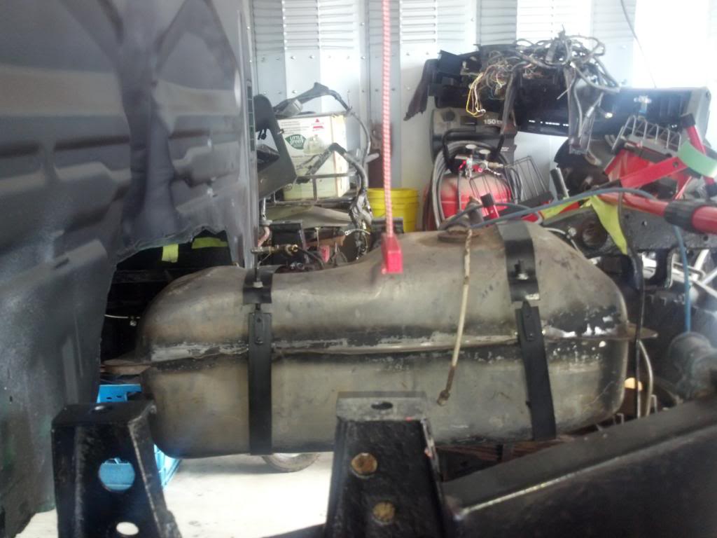

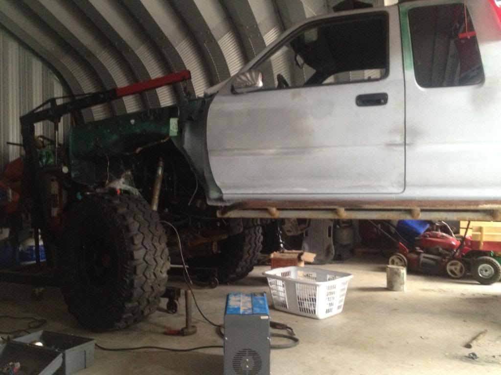

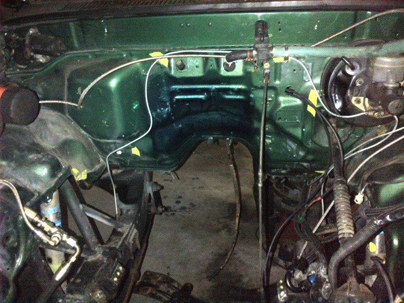

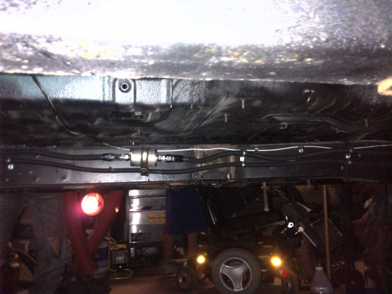

So I began rust proofing the truck and installing the gas tank (PO had hacked off the stock mounting brackets)

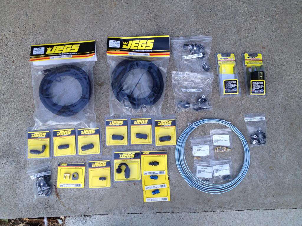

I bought new fuel lines, break lines and Energy Suspension GM transmission mounts for engine mounts.

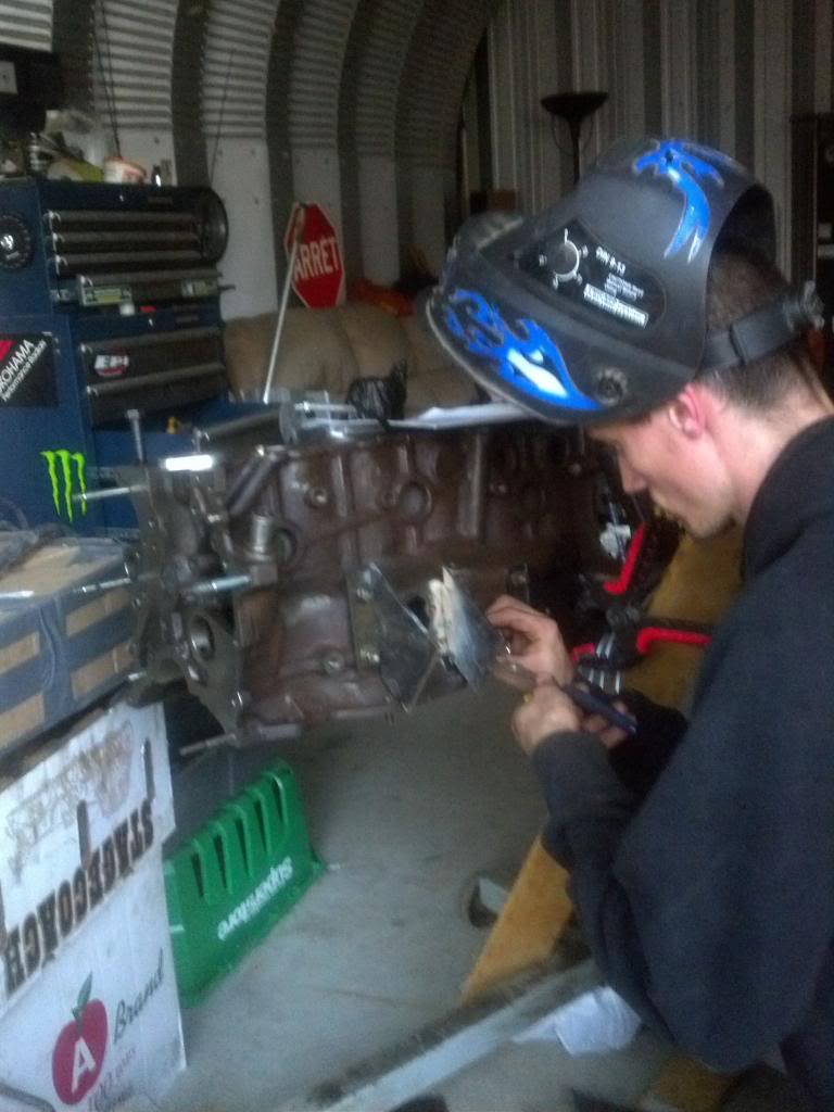

I had to make custom engine brackets

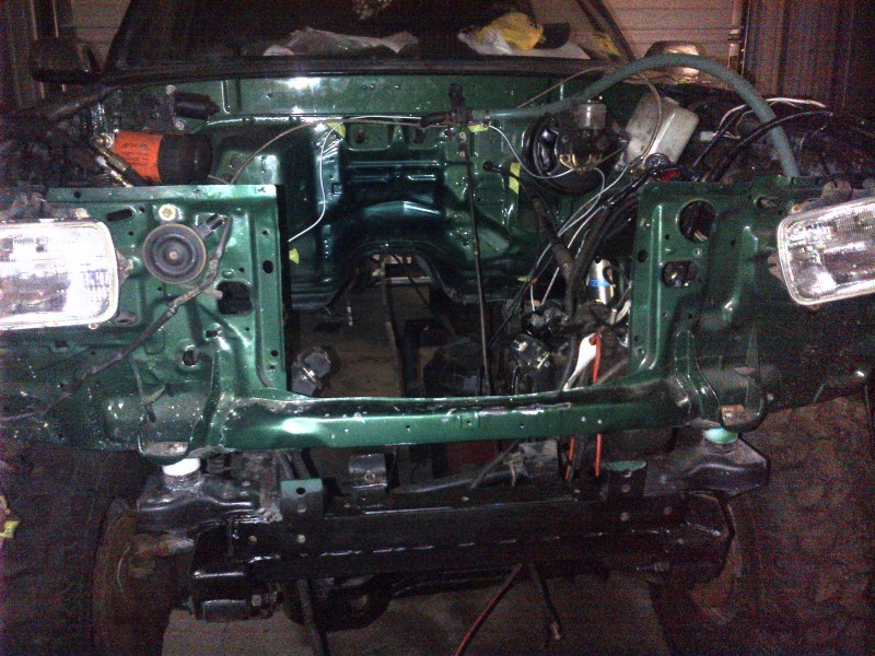

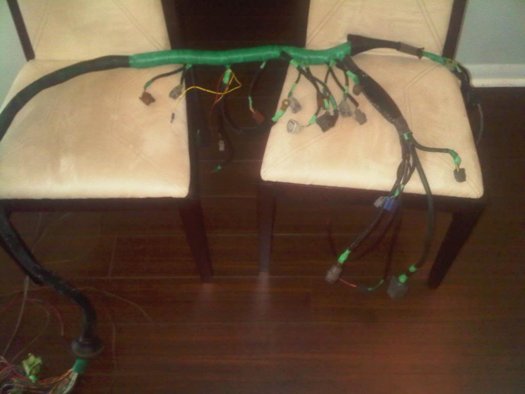

Well My work has rotated me to Down Town Toronto ON for 6 months so progress has almost ground to a halt. There is not much I can do while in a condo. However I did take the wiring harness down with my, stripped off all the electrical tape and loom, removed the unnecessary wires (EGR, VSV and some other random ˟˟˟˟) and re ran the Knock sensor wires with Coax cable and the CPS cable with new shielded cable. as well as replacing some Toyota connectors along the way
THat is a picture taken about a week ago.

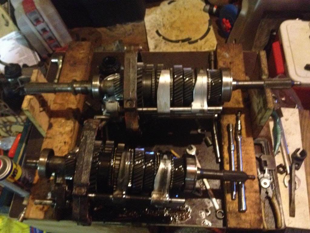

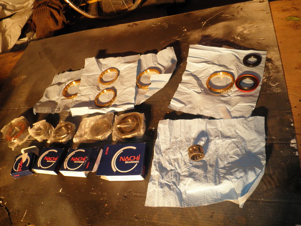

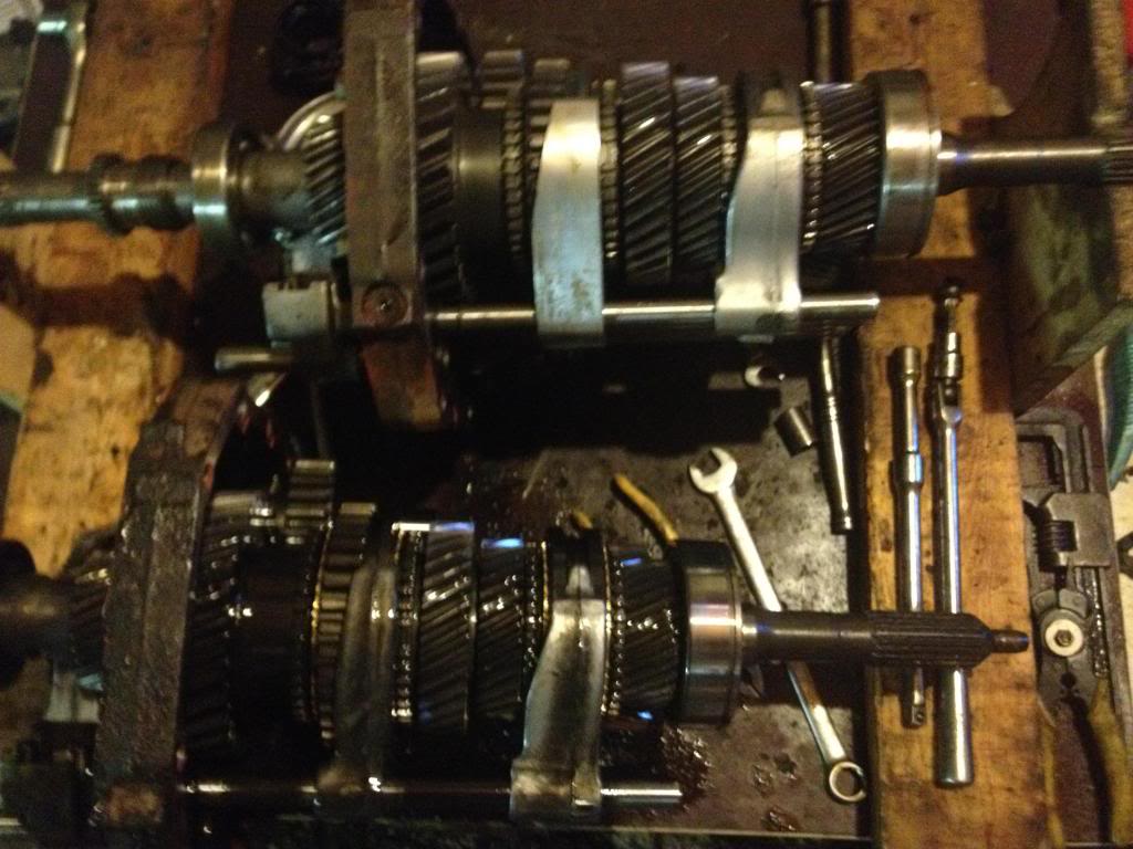

Tranny Info!
I decided to Hybrid an R154 with an R150F
Here are the two transmissions beside eachother

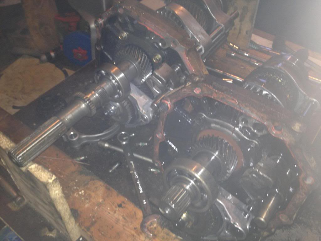

I rebuilt them using the Supra (R154) Input shaft, counter shaft and gears so I could use the R154 bellhousing.
THe output shaft was from the R150F and I had the supra gears pressed onto it. Unfortunately I am stuck with the Chain case for now but shouldnt be an issue untill I start abusing it...oh and get a front drive shaft lol
ANYWAY
All new synchros and bearings

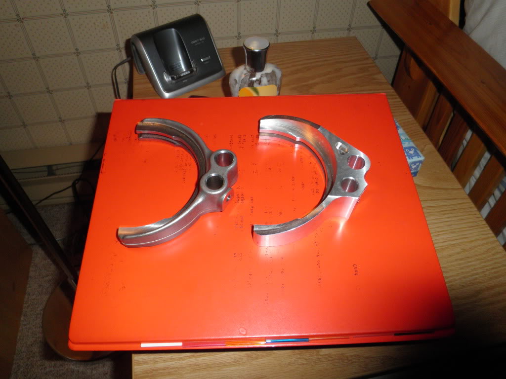

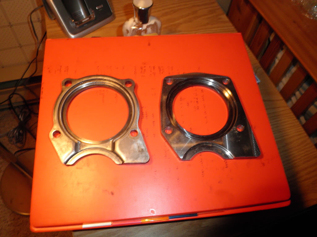

as well as Marlin intermediate plate
Marlin crawler 1-2 Shift fork
as well as the marlin crawler thrust washer (no pic)
