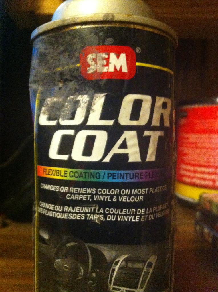

Anyway I purchased 2 cans of the SEM COLOR COAT in a light gray. I painted my front seats, leather boot and trim around shifters, visors, and some other little things. Needless to say the paint is awesome. I'm a big neat freak with the inside of my truck. So I'm constantly wiping it down with armoral or something like that. The paint hasn't showed no wear. The seats look great. I left a little brown square under the center armrest just to show people that don't believe I painted them.
If you paint cloth you must let it dry then once it's dry you gotta brush it with a course hairbrush to loosen the cloth back up. Then your good as new. The SEM paint cost a bit tho. I believe it's around $10.00 a can here in WV.

Once again you gotta clean everything good before spraying tho. I used acetone to wipe my clean. Leave the windows down too. You will smell this stuff for a week straight. I swear to that.
