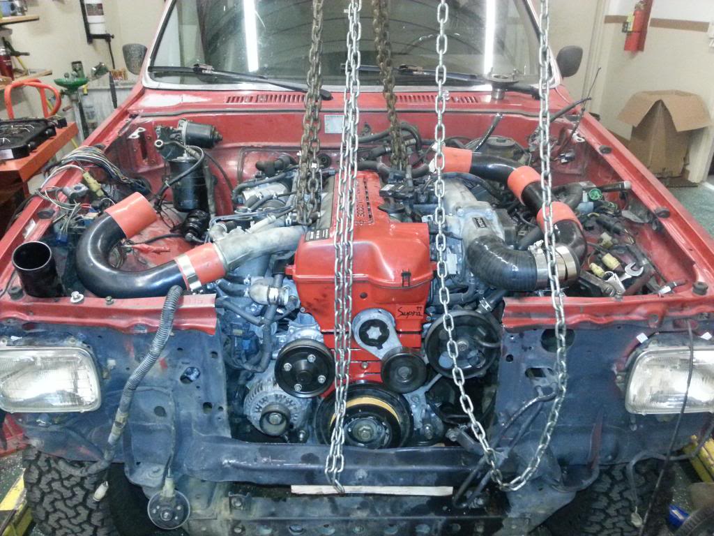

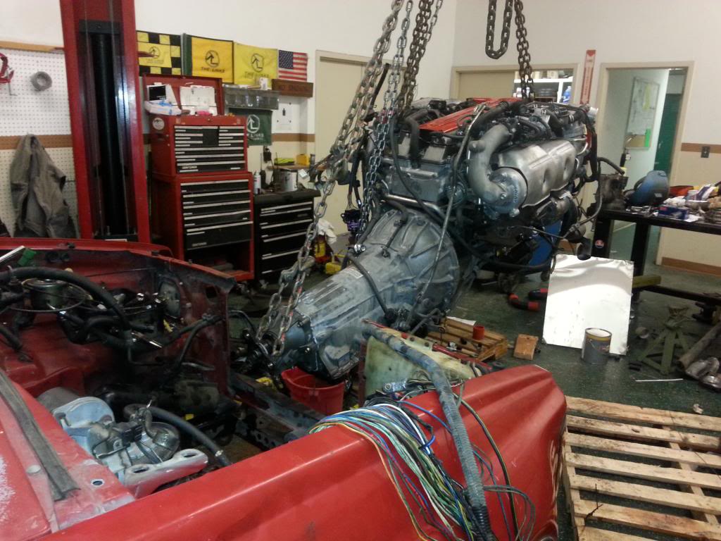

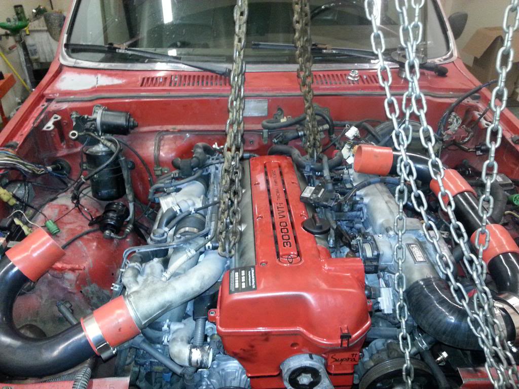

made some progress. i have to install a body lift which kind of sucks but it will solve all of the clearance issues.
pulled old drive train and mounted the 2jz and realized i dont have adequate trans tunnel clearance. with the body lift it will fit fine as well as giving me engough room up front to use a supra radiatior with puller fans.

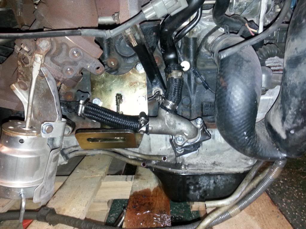

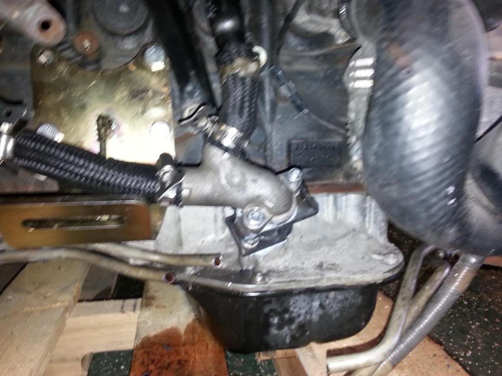

I used Xcessive mounts that worked perfect! the only problem they interfered with the turbo oil drain. I fabbed a 2in. spacer to clear the engine mount. This was a pain in the arse and would pay a machinist next time.
her are some pics.

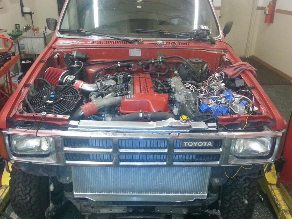

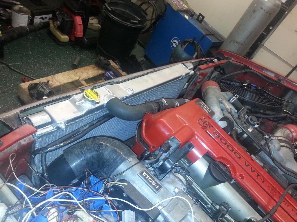

well motor is in. trans crossmember done, intercooler plumbed, fuel lines, power steering, radiator, all of it except wiring and exhaust. radiator is for a supra off ebay and sits behind the grill.Name:  20140412_184022_zps2ca759da.jpg

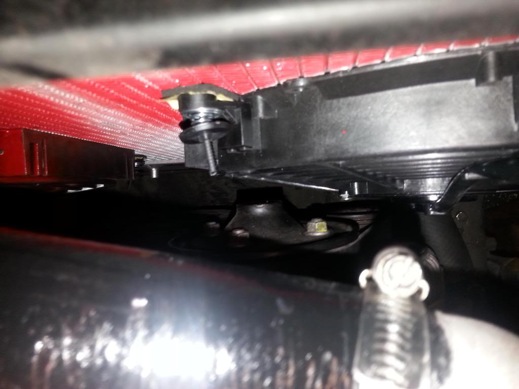

radiator had just enough room for a couple puller fans
the hood will have the latch reworked since it doesnt close with the little loop still there. may have to go with hood pins but i think i may have an idea there.Name:  20140405_182606_zpse8266e92.jpg

i trimmed the back of the grill to get it to go back all the way. hopefully by sunday ill be driving this again. i rode my motorcycle to work this morning in 4 inches of snow and my damn glasses kept icing over.
