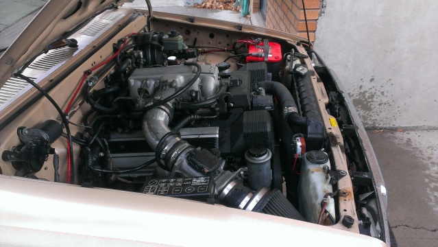

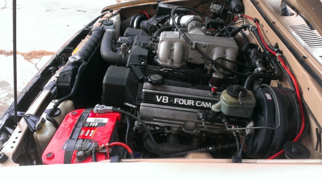

hey guys, long time since i last posted.. so i figured your all deserve a little engine pron
enjoy
