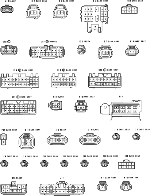

these should help..

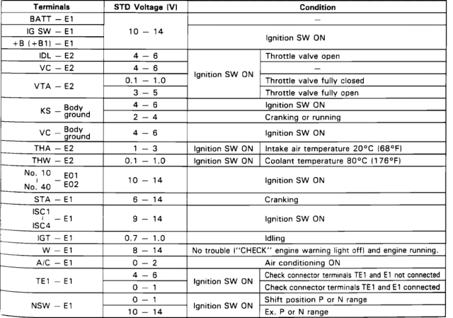

next i would aquire a wiring diagram for the engine control system, that will tell you all the wire colors. o a few more:
see if thes help, if you have a hard time understanding wiring diagrams
i have a good cheat sheet that basicaly tells you what all the little funny shaped lines and dots mean.

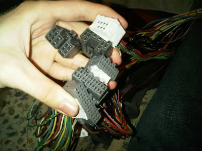

I'm missing one of the 26 pin connectors. I'll get a pic up asap, but I'm sure its the one that has the fuel relay wire in it and the "W" wire.
Old Jul 2, 2010 | 08:49 AM
  #36
highrideTOY's Avatar
Joined: Aug 2009
Posts: 57
From: Meridian, MS/Butler, AL
those are the plugs on the ecu end of the harness. i have no other plugs on the end. the three light grey on the right are the ecu plugs.

there is an emty slot on the ecu? or is there only 3 plugs? some use 4 some only have 3..
or is it just cut off?

ecu has 4 plugs. there are only three plugs on my harness. I can't find anywhere that it is cut. the empty slot is the one that is by itself.
