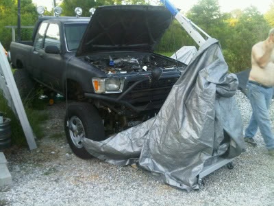

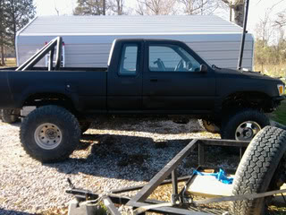

ok heres some background on this swap i'm doing. I bought a 90 pickup with the 3.0L for a $1000. Well come to find out, it had a blown head gasket. I knew the motor wasn't what i wanted, so i started searching for motor swaps on the forums. i found a few swaps using the 1uz. The hp, torque, and mpg all matched up with what i wanted. So, i started gathering parts last year and i am now in the process of putting the 1uz in the truck. feel free to comment or suggest another route to do something. I'm sure there are better ways to do this. This is the truck i started with. I added a 2 inch body lift, so i could fit the motor with less headaches. lol Name:  untitled5.jpg
Size:  25.8 KB i got some 37 MTR's and put them on. Name:  untitled3-1.jpg

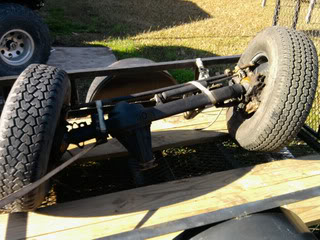

Size:  50.7 KB Well i found a good deal on a toy axle and went ahead and bought the SAS kit as well. this will happen later on after the swap is done. Name:  untitled6.jpg
Size:  26.7 KB Name:  untitled3.jpg

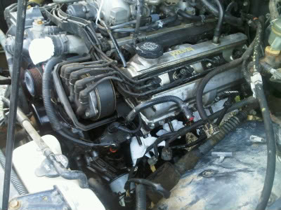

Size:  28.5 KB We tested fitted the motor in the truck last weekend. I only got a few pics of the motor in the truck, cuz it's too damn hot to waste time with pics. Name:  IMG00007-20100620-1924.jpg
Size:  36.1 KB tight fit Name:  IMG00006-20100620-1923.jpg
Size:  38.6 KB Steering Shaft clearance may be an issue. i bought some 2uz headers off ebay. if they don't work I'll take the stock manifolds off my tundra and see if they work better. We shall see. Name:  IMG00008-20100620-1924.jpg

The drivers side header won't fit unless you hack it up. The Tundra Manifolds will work to clear the steering but the outlet will have to be modified to fit.

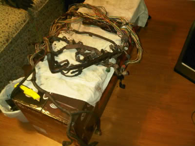

ok i'm working on the wiring and could use a little help with identifying some of these things.
TDCL conn?
ISC valve?
what else can i get rid of? sorry wiring is not my easiest process

tdcl would be the round check connector thats inside the car under the dash. used to plug in diagnostic equipment to.
ISC is the idle speed control valve .. top center front of engine has a hose from the plastic intake connected to it .. used for idle when the engine is cold.
