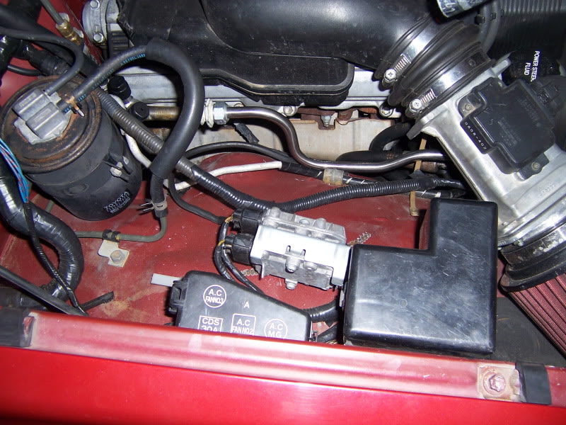

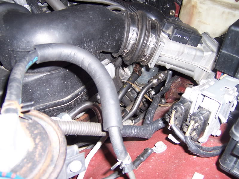

so just a little update on this truck .. The A/C is working now .. its using custom stainless steel lines and the LS compressor everything else is the 4runners stuff.
ill post pics of the lines as soon as i get them.

Nice RMA, this is something most guys avoid when putting in the 1UZ, interested to see how you overcame it.

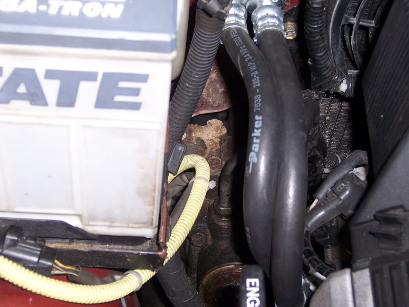

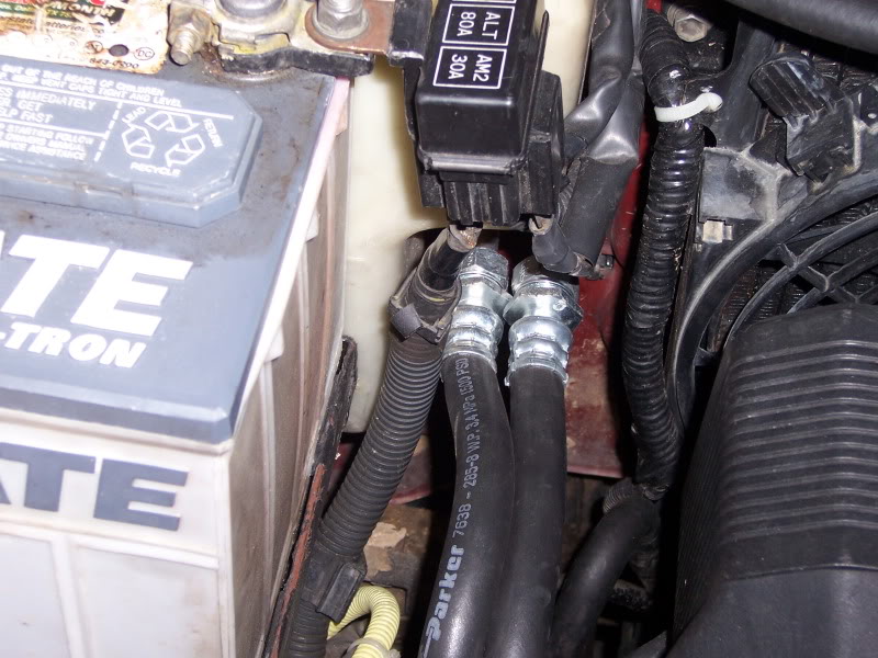

well RB i really didnt do any of the work on the ac stuff besides letting my friend the owner of this red runner use my shop (Garage ) and the use of my small lathe .. he used it to make a small part , a fitting i guess to connect the hoses to the ac's radiator up front. he was having fun while i was working .. this was the first thing hes ever made with a lathe and it actually worked , and he didnt hurt himself
any way heres some pics .

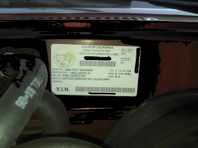

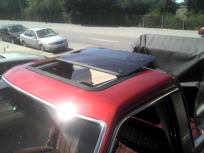

so a little update on this 4runner .. its been inspected by the bar and is now legal .. everything working cruise and A/C ..

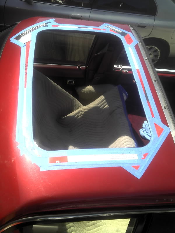

this truck also got a sunroof installed .. we found one off a 2004 range rover at the junkyard and worked fine so far.
heres a couple cell phone pics .. ill post some better pics later .
and for anyone interested the toyota sheet metal is twice as thick as the range rover sheetmetal.

if you don't mind posting, how much was the sun roof?

Nice, it slides. Top notch work, really impressive.

the sunroof was $50 complete with motor.. the switch ,harness and headliner off the range rover were extra .. it was less than $100.
we spent some time at the pick n pull looking at different sunroofs .. the owner of the 4runner was originaly going with a saturn sunroof , but we got lucky and found the range rover , it had 2 sunroofs one in the front and one at the back .. they were both exactly the same .
its nice and is nicely contained the bottom pan bolts to the sunroof and squeezes the sheet metal real good .
my friend cut the sunroof off the range rover and used the range rovers sheetmetal as a template when cutting his 4runner.
hes going to make a headliner out of both the range rovers and 4runners then have a shop upholster it.
ill get some better pics later.
