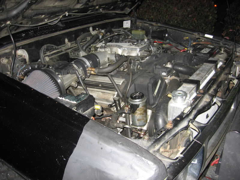

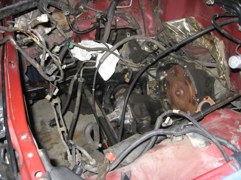

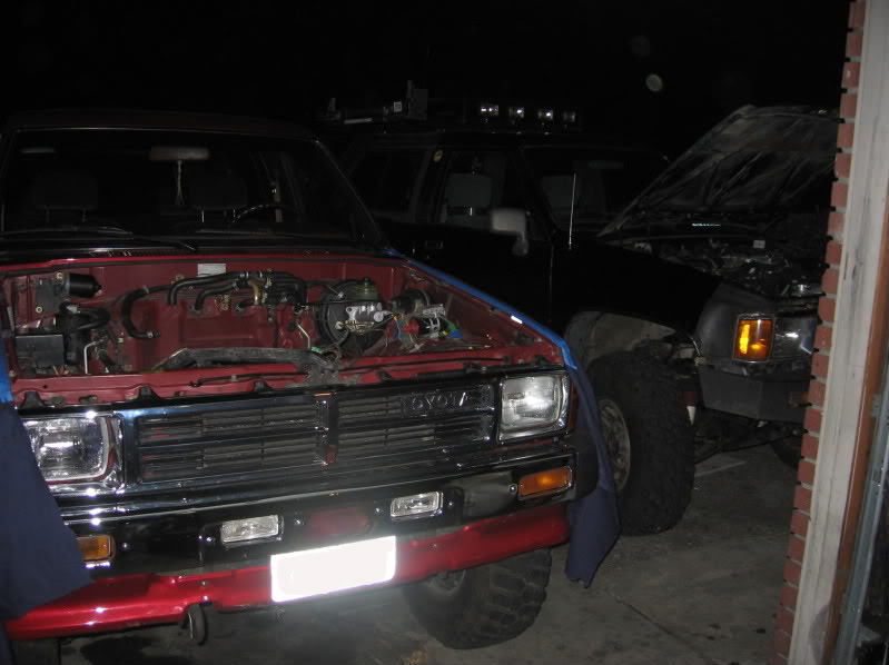

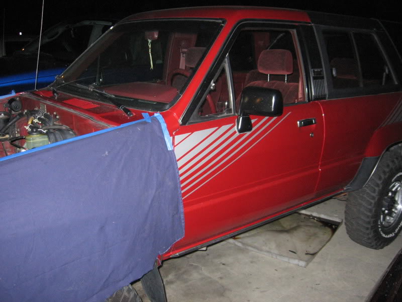

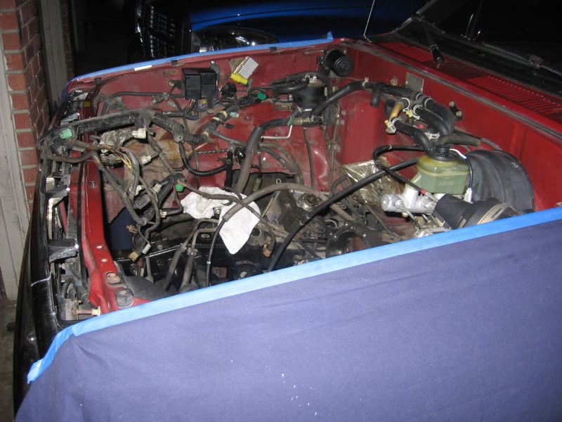

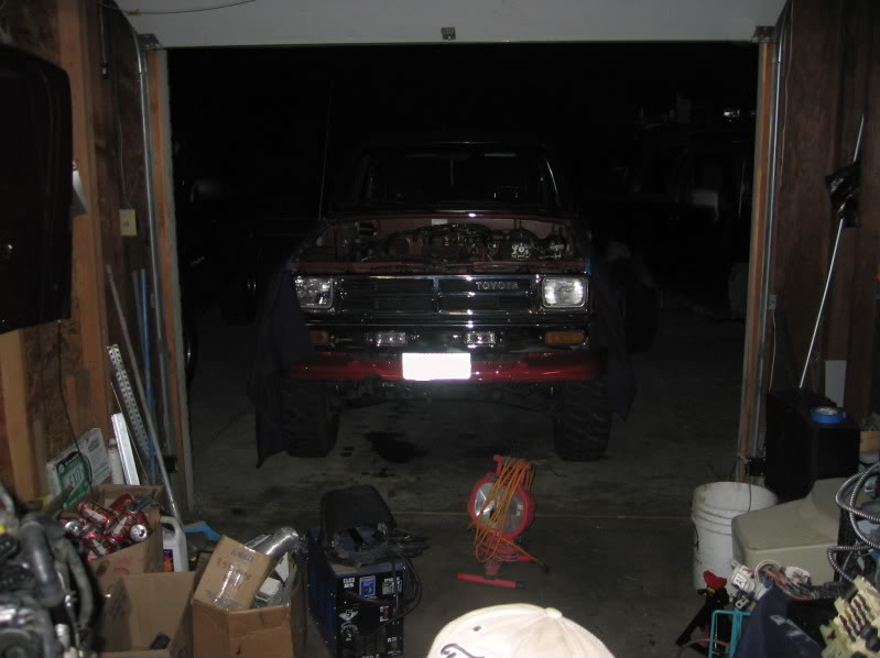

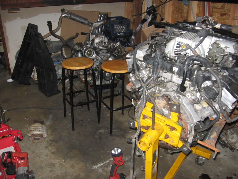

ok so ive started on another swap .. we were waiting for the 3.0 to sell , finally did so now onto this swap.
So the owner of this truck wants to try and do this with out a body lift , so well be lowering the front diff and modifing the sc oil pan .
wants to try and keep a/c and cruise control.

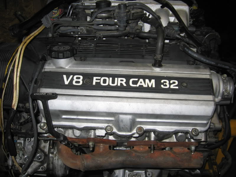

will be using the following
1992 sc400 1uz (modified oil pan)
1992 ls 400 auto tranny
inchworm prerunner adapter
no body lift
DIY wiring
SC 400 cluster
2001 tundra exhaust manifolds
3.0 radiator modified with 5 row core

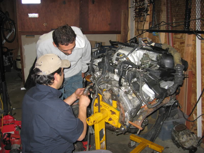

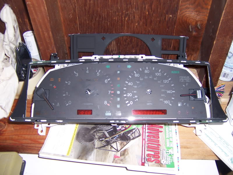

well i didnt get to work on this thing today , but i think my friend did work on the wiring a little today.
here is a couple pics from the other day i forgot to post ..
sc 400 cluster .. trying to figure how to mount it.
its alot smaller than the ls 400 one and fits in the original 4 runner cluster surround.

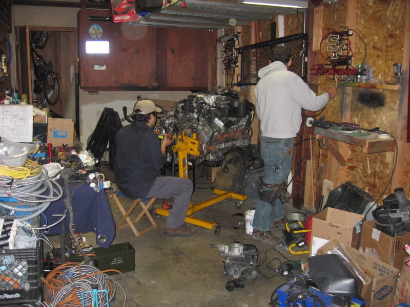

worked on the swap a little today .. mostly BSing ,but some wires did manage to get cut..and some connectors labeled ..
hopefully we can pick up the pace on this thing and finish her up soon.

also nothing really to update except the wiring is coming along..
also I already know that keeping the A/C is almost impossible with this swap .. but my friend really wants to try so were gonna see what happens ..

Scuba these motors can be found pretty cheap , i bought a whole wrecked car for $125 , the owner had started to part it out but then needed to get it out from his driveway really quick.
and the engine thats sitting on the engine stand in the above pick was bought for $200 with the complete exhaust and cluster from a Sc400

I tried to order the prerunner adapter today from inchworm and there website says there backorderd for the adapter.. so i called and it looks like 2 months for the adapter.
man that sucks .. but I guess well just finish everything else up .. .
