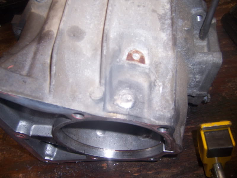

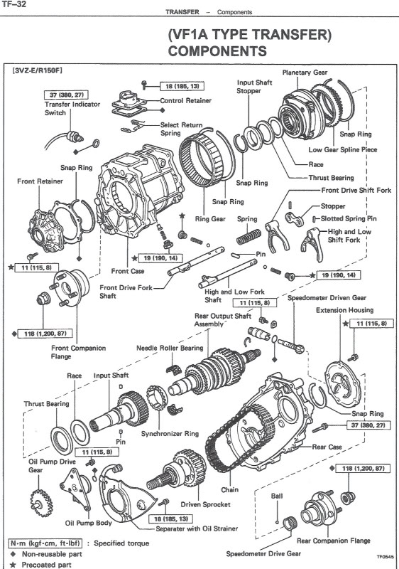

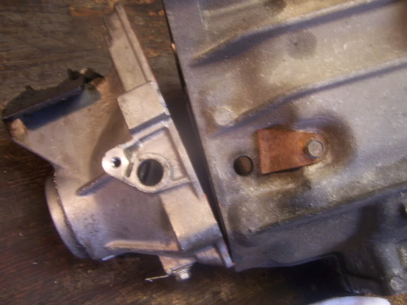

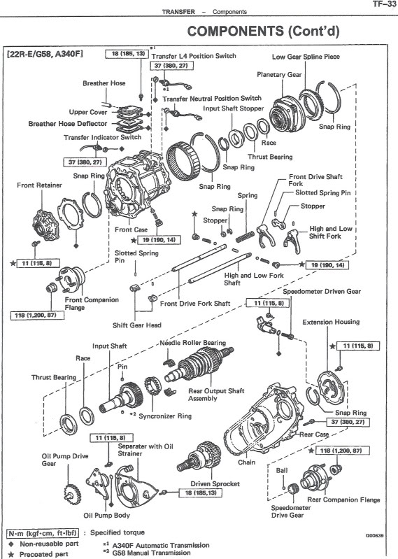

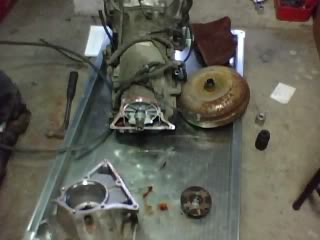

ok so thanks to maniacmotorsports and his thread it looks like we'll be able to continue this without the inchworm adapter .. Not sure it it will work for sure yet but so far it looks really good .
using a transfer case and extension housing from a 1997 4x4 3.4 auto T-100
copied from his thread.
we went ahead and picked up a complete tranny from a 1997 t-100 4x4 auto with the 3.4 for $300 .
started putting the pieces together , nothing major yet .
cut the lexus output shaft to 2.5"
cut down the 4 prong rotor(going to put some spot welds on the inside of the rotor and file them down to fit onto the splined part of the lexus shaft)
enlarge the speed sensor hole on the t-100 housing to fit the lexus speed sensor
need to drill and tap the extra hole on the lexus housing..
here are a couple pics i took with the phone , will get better ones later.

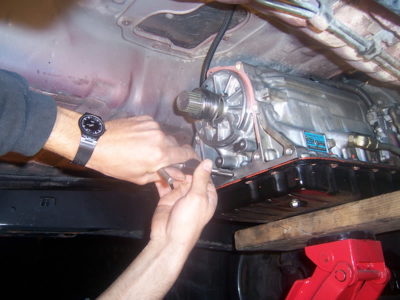

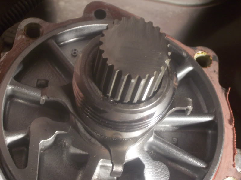

ok got the transfer case installed .. so far so good .
cut down the 4 prong speed sensor rotor .. right down to the speedometer drive gear part
added some splines to the inside .. since we're now using the back of the transfer case to drive the speedometer, all this rotor is doing is providing the 4 pulse signal to the ecu . so the welded splines should be ok .. i hope .
the speed sensor for the 4 pulse rotor .. the holes are not the same .. welded the t-100 hole shut and re drilled in the right spot .. about 3 mm off
the sensor needed a 2 mm spacer to get it right , between the sensor and the housing .
drill and tap the 7th hole , 10 x 1.50 mm
pretty much finished .
The drive shafts still need to be modified , .
this transfer case has 3 switches on it
transfer L4 position switch
transfer neutral position switch
and the transfer indicator switch .
I need to check out the t-100 wiring and see if we even need them , i think we will only connect the transfer indicator switch .. but not sure yet.
we also need to find a speed sensor (on trasfer case for cluster ) not sure if marlins adapter will work on the one this t-100 has.
http://www.marlincrawler.com/transfe...eed-sensor-mci
