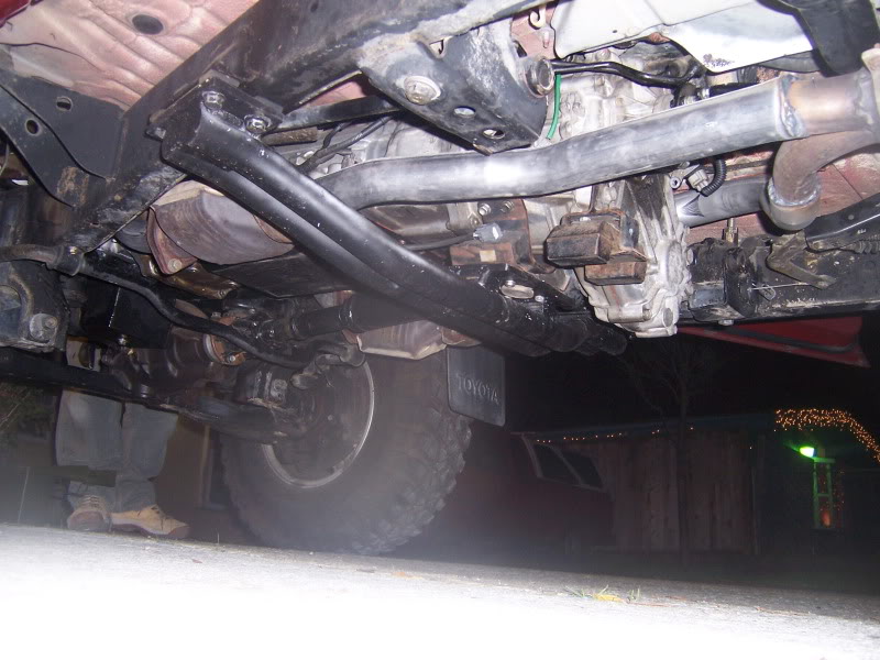

litte update..

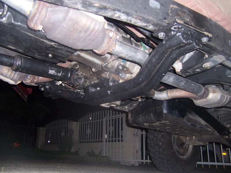

both drive shafts done .. made a crossmemeber form 1 1/2 tubing .. modifiying the auto shifter and the t-100 transfer case shifter.

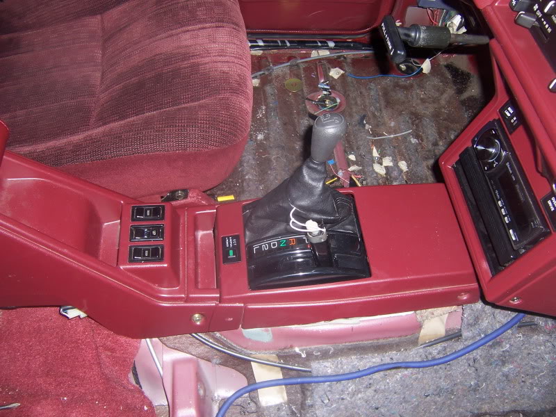

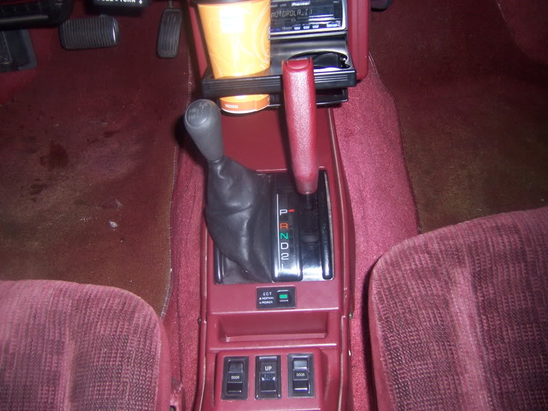

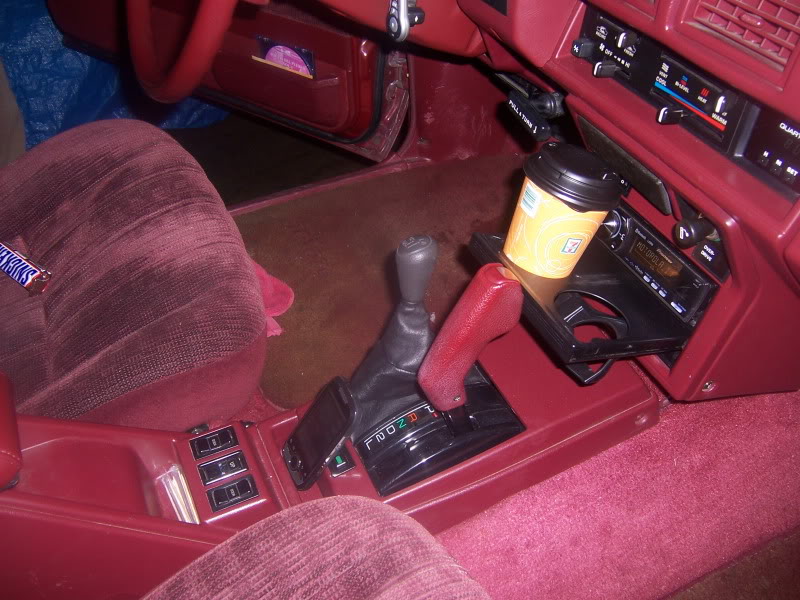

some pics of what were doing to the transfer case shifter.
the original t-100 shifter wasnt pointing in the right direction, so we tried to bend it .. tried to put to much of a bend in it and it broke . .
so bought some 1/2 rod bent it to the shape we needed then welded it back on the shifter, cut some threads on the end of it (12x1.25).
then welded a nut (17mm socket size with 12x1.25 threads , 3.0 motor mount nut) to the inside of the old metal cover for the t-100 shifter .

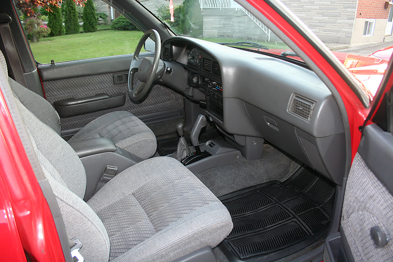

were trying to make something like whats in this pic of the 2nd gen 4runner from canada, but on the first gen.

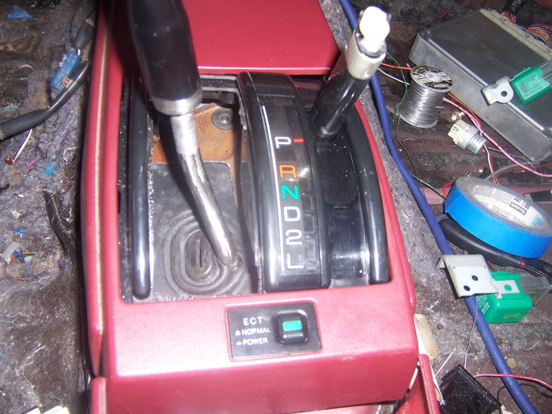

heres a couple pics of the shifter .. its the original 3.0 shifter , but the transfer case handle and parts have been cut off.. the plastic cover has been cut and pieced back together.

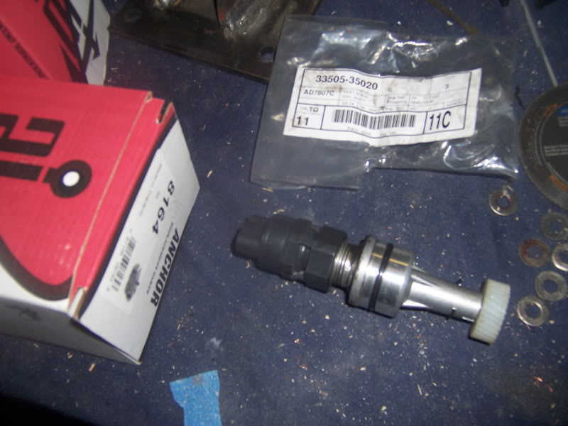

marlins speedometer gear adapter

O/D light was blinking and the speedometer was not working the whole time .. tried to pull codes but no dtc presently stored was what we were getting the whole time .
finally got IAT sensor code.. switched air flow meters with my truck .. truck ran better ... but still the O/D light blinking .. disconnected Marlins speedometer adapter and wow the truck ran way better ..Marlins adapter is wired different than the original lexus sensor .. we originaly switched the wires around to match marlins adapter .. we switched them back and tried the lexus sensor , and spinned it by hand the speedometer was working now .
not sure if marlins sensor is bad or its just not compatible with the sc cluster.

ok so the truck got its exhaust done .. speed sensor fixed .. this truck hauls .. its alot quicker then mine , 31"s ,4:88"s and alot less weight then mine .. big difference it hauls , the truck just goes from the start .. floor it and right away it just jumps and flys ( mine takes a bit before it flies you can feel the weight ).
really the truck just needed to be driven , the other night we were just really cold and not thinking clearly , overthinking things (last post).. its doing great and my freind is just finishing little details up now.
ill get some pics and videos soon , its been raining alot lately..this truck is going to utah on the 19th will be along drive , so its getting driven alot right now to make sure alls good .

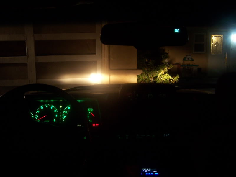

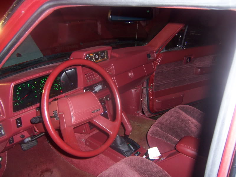

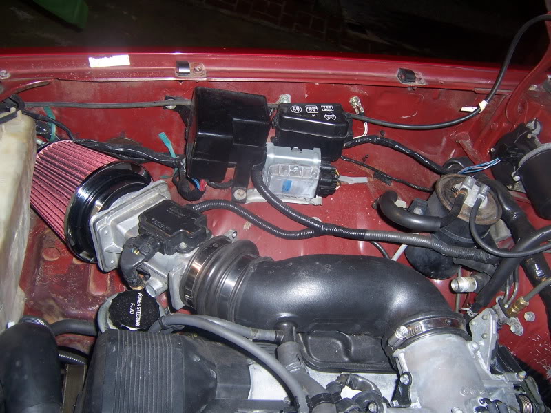

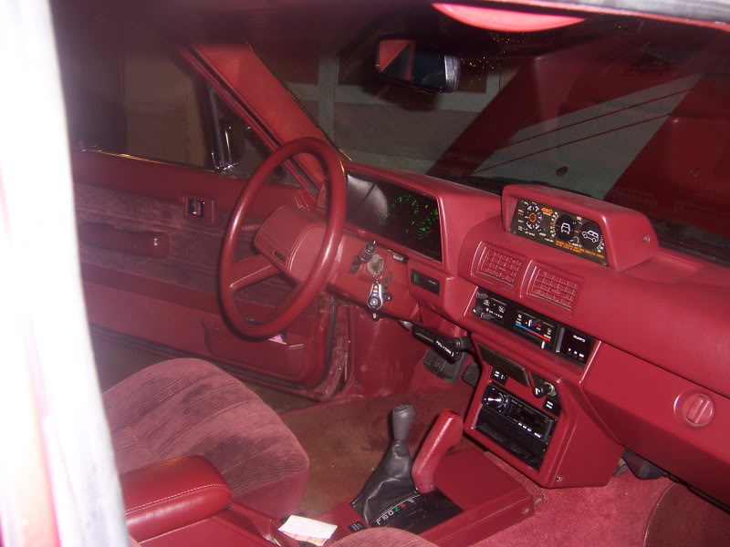

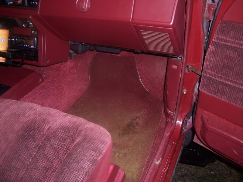

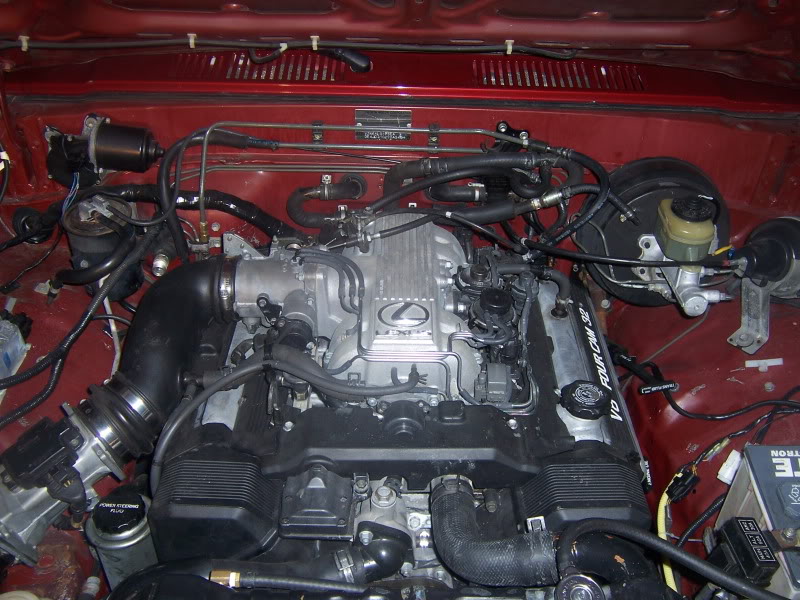

so the truck is done for now .. A/c Hoses will have to wait for a while and thats all that this truck needs now ..
here are some more pics i took tonight ..
no more wires ..

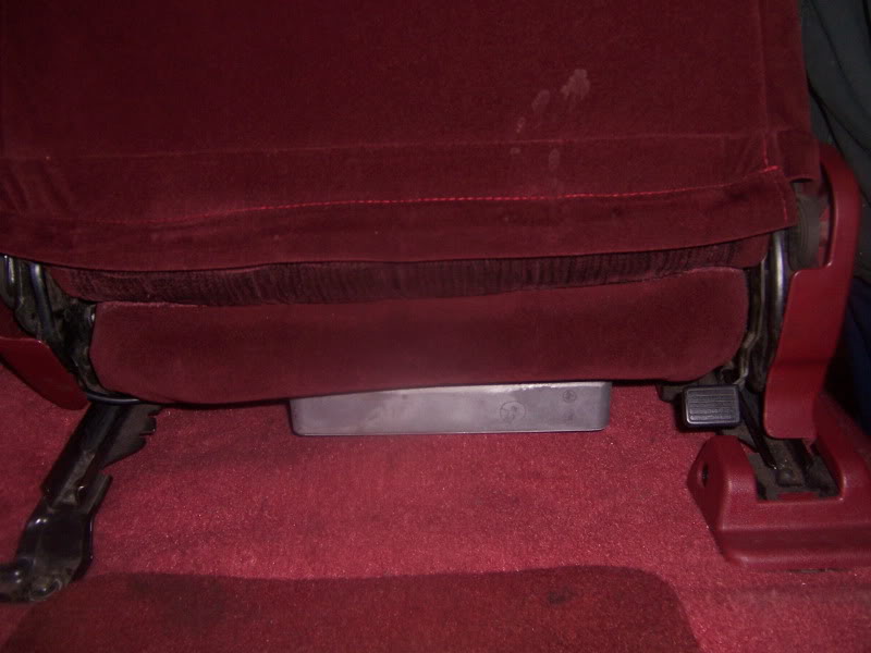

computer under the seat.
seats all the way forward .
custom shifter

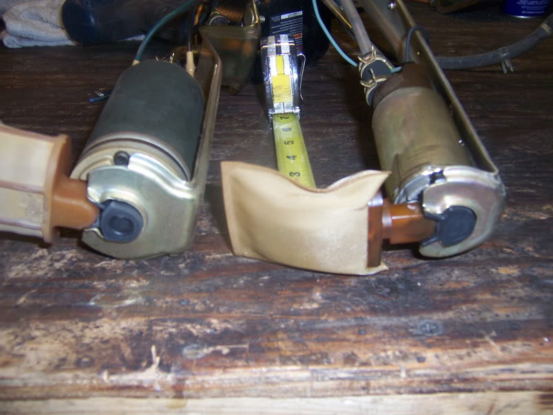

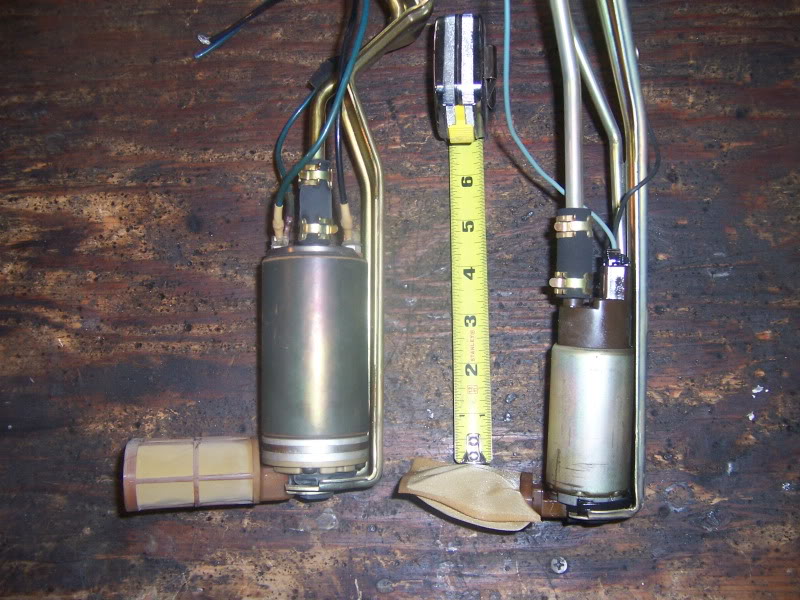

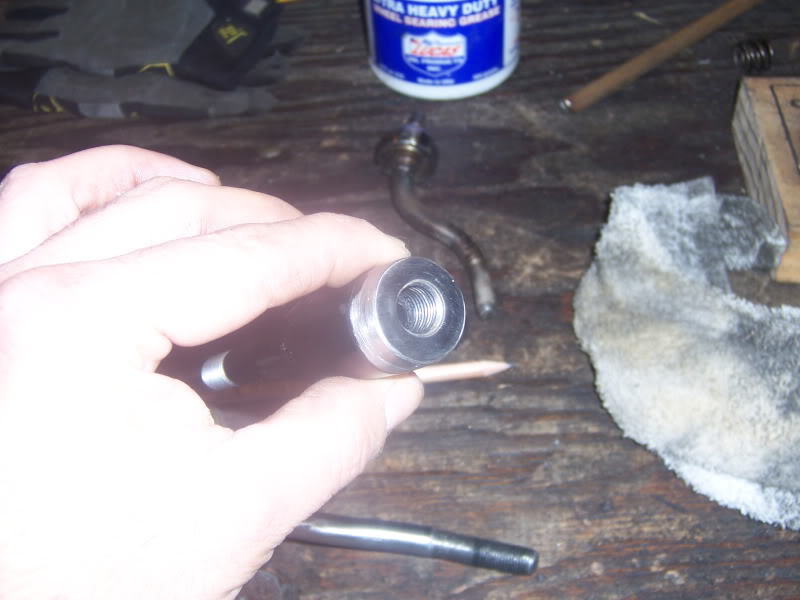

so i just pulled a 3.0 pump and thought id post some pics of the 3.0 pump and the ls 400 pump to show the difference in size and mounting ...3.0 on the right ,smaller one .
