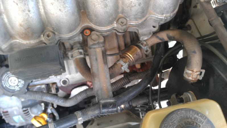

+1 on this solution, I used the 3.4 vacuum hose and spliced in the check valve from the 3.0:
Old Jul 3, 2014 | 07:22 PM
NWLS's Avatar
Joined: Feb 2014
Posts: 69
where did you pick up the check valve from?
Old Jul 3, 2014 | 09:01 PM
aztoyman's Avatar
Joined: Nov 2012
Posts: 1,181
Likes: 180
From: Tucson
Just grab one from a truck that has one or buy a generic one from a parts store that fits the line.
Old Jul 3, 2014 | 09:04 PM
MechanicTony's Avatar
Joined: Aug 2009
Posts: 23
From: Mission, KS
Mine came off my 91 Toyota Pickup with a 3.0 - make sure to put it in the right way or you'll have no power brakes.
