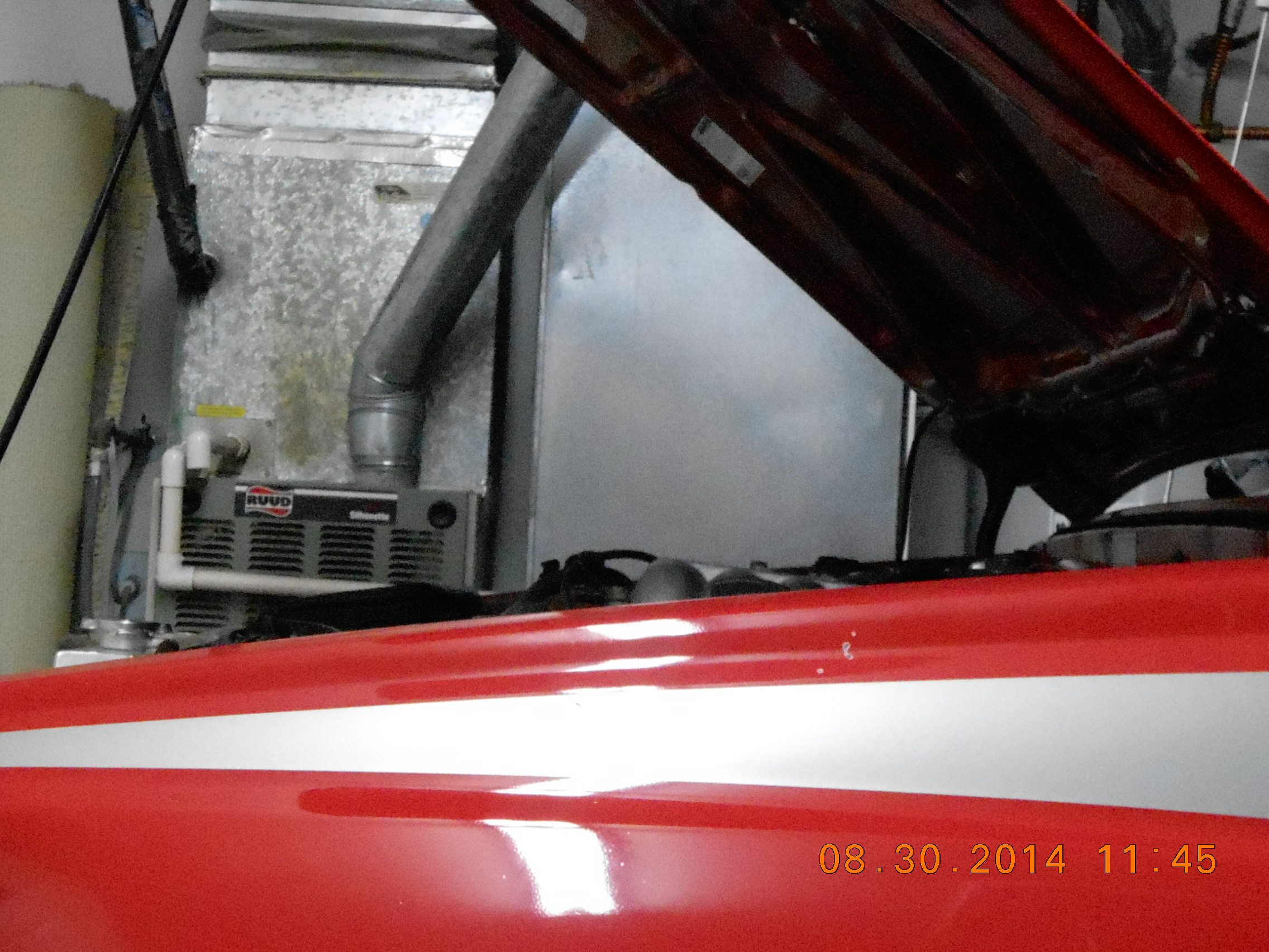

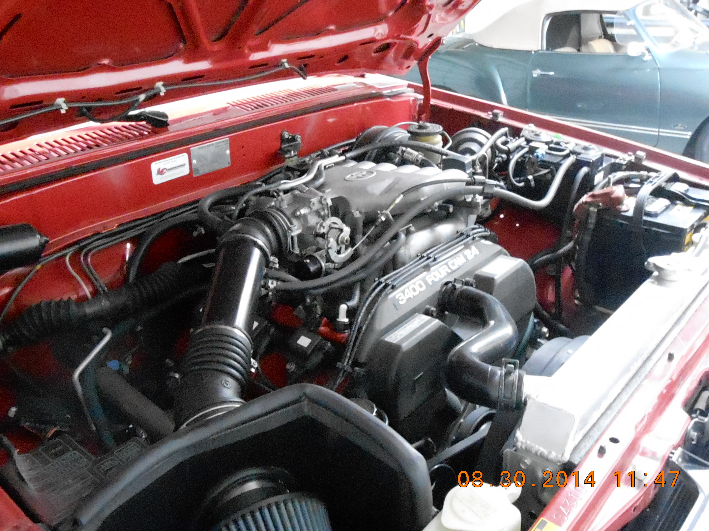

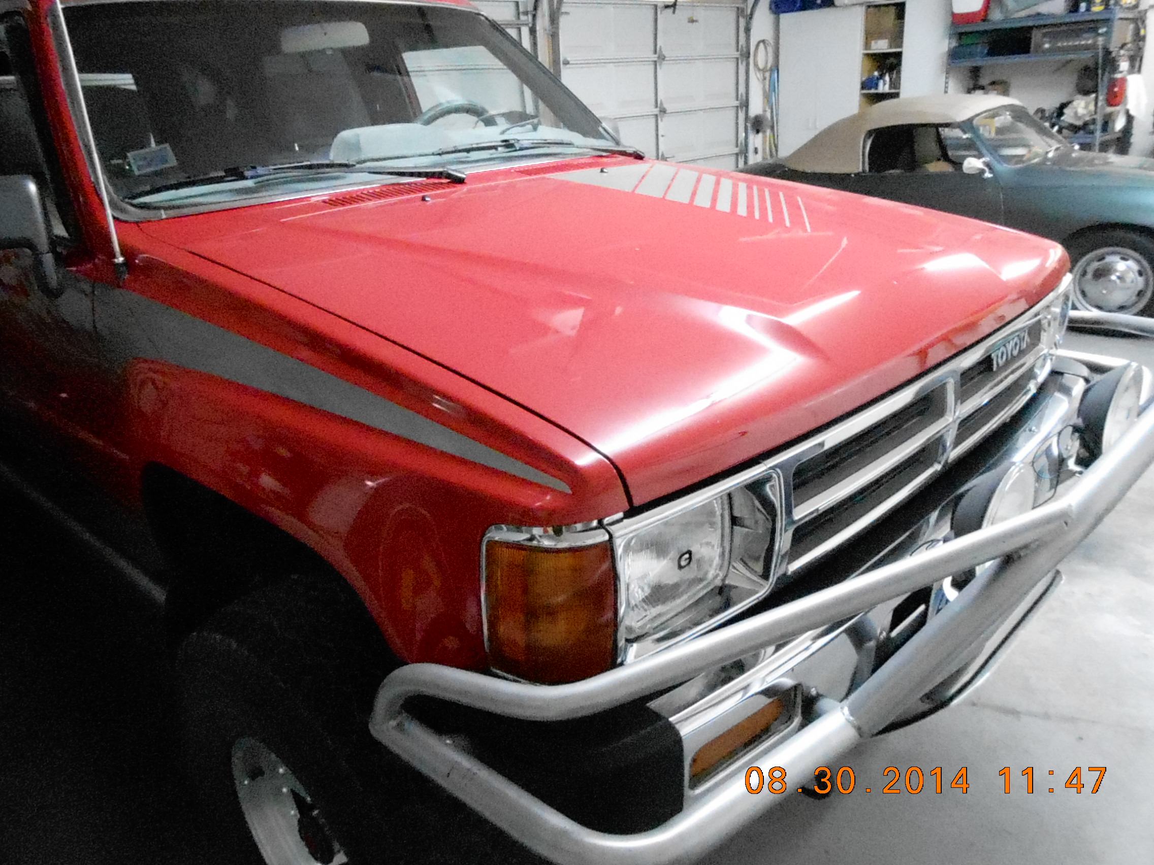

I also have a 1988 4Runner, by mine originally had a 22RE. I already had a 2 inch body lift and a 2 inch drivetrain lift. When I swapped in the 5VZ I ended up using the 1 inch engine lift from 4Crawler. This resulted in effectively being a 1 inch body lift as far as the engine placement-to-body relationship is concerned. The upper intake doesn't look like it clears, but it does.
So, you could go with a minimum 1 inch body lift, or go with a hood scoop. If you are leaning toward the 1.5 inch body lift, that would work.

Amazing!, Thanks a lot for the pics and the info,
your 4r, looks great
clean 3.4 swap
4crawler is the way
