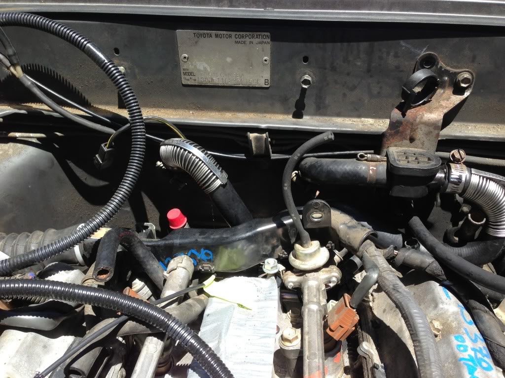

The heater hose in the first picture I see that you have a metal piece in the middle. Is that just to limit the bending of the hose? cause I just bent mine straight down lol with a hose clamp in the middle to prevent a little of the bending.
Old Jun 15, 2013 | 02:26 PM
  #106
Moto260's Avatar
Joined: Feb 2013
Posts: 224

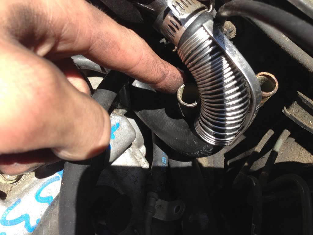

Here's my heater hoses. Those springs they sell at napa for 3 bucks a piece and prevent kinks. Worked pretty well but geeze that's a tough job. Two hoses took me like 4 hours haha. Name:  D6136B2B-70B0-4B38-B926-EFB4BE943AE9-150-0000000AC3D89358_zps4964878b.jpg

So now that these are on. My whole hose pattern is completely different. (Obviously lol). But now how am I supposed to do these two . I'm sure it'll be easier Name:  47FE4E08-AAAC-46F6-A72D-1247C00E0D49-161-0000000B34F92924_zpsfa1b17ff.jpg

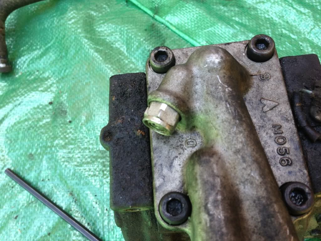

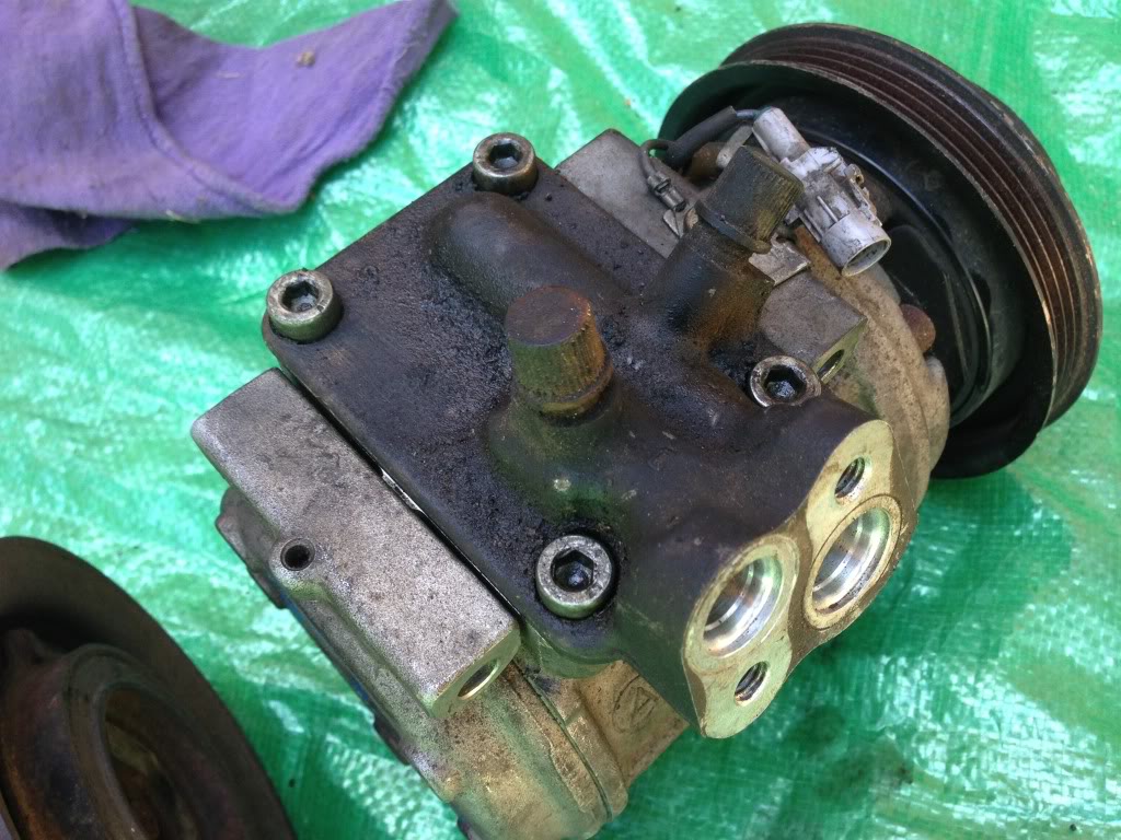

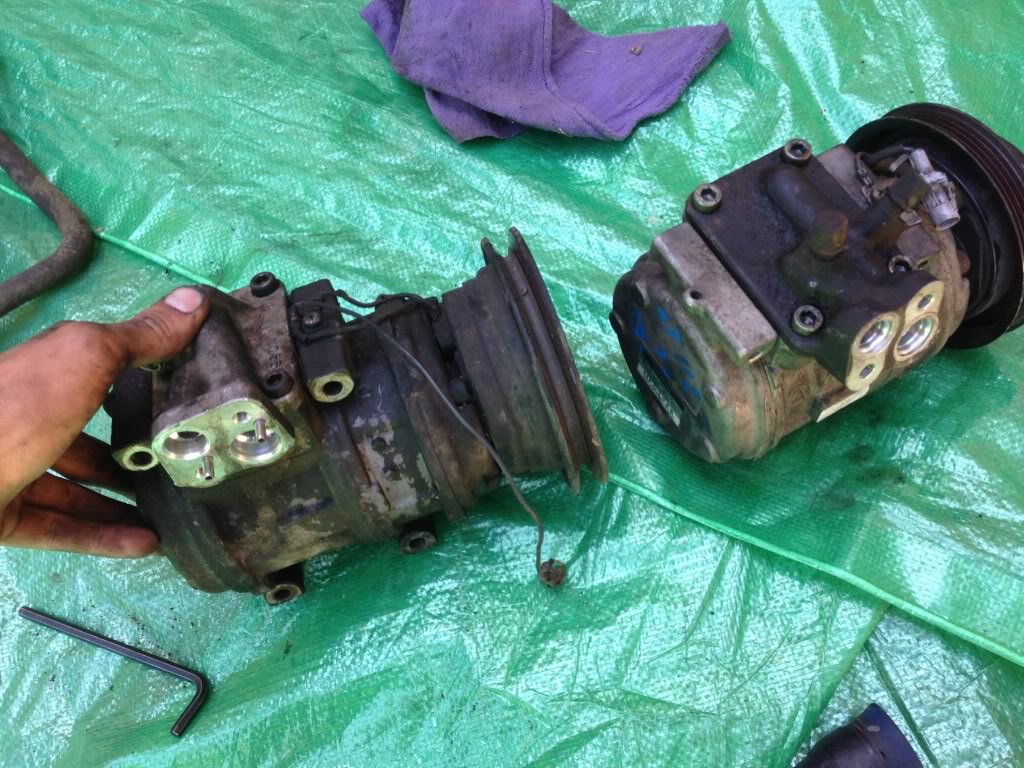

Anyways after that. I pulled my A/c compressor off again cause the a/c lines wouldn't match up. I swapped the tops of them, and put it back on. They're a little different but hopefully it'll work. The gasket inside and hole placing were fairly similar After I swapped them. Name:  060634CB-B8FB-4E13-A70D-105FEA0EA373-161-0000000F3692EE74_zps96d57b69.jpg

New compressor top that I took off. Name:  D8E7096D-3168-4CD7-BC4C-9CF26475B775-161-0000000F2A26D2AB_zps909d264c.jpg

Posts: 224
New compressor with old a/c line top on it. Looks pretty dirty haha. I'd say that's a r134 swap lol. Name:  E4F239A9-9BC0-4657-A53A-580C59A9C961-161-0000000F302772D6_zpsd4ca39fc.jpg

Your heater hoses look great! And the only reason I put that brass barb in the middle of that hose was because when I was removing it from the 3.0, it wouldn't come loose off if the fittings at each end so I got pissed and cut it in the middle lol. That's the real reason hah.

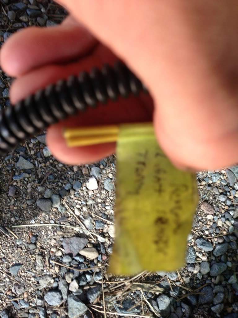

Reverse light switch Name:  135B5133-64DE-48AE-B797-F71573005D33-356-0000002CBE0BAA26_zpsc4011379.jpg

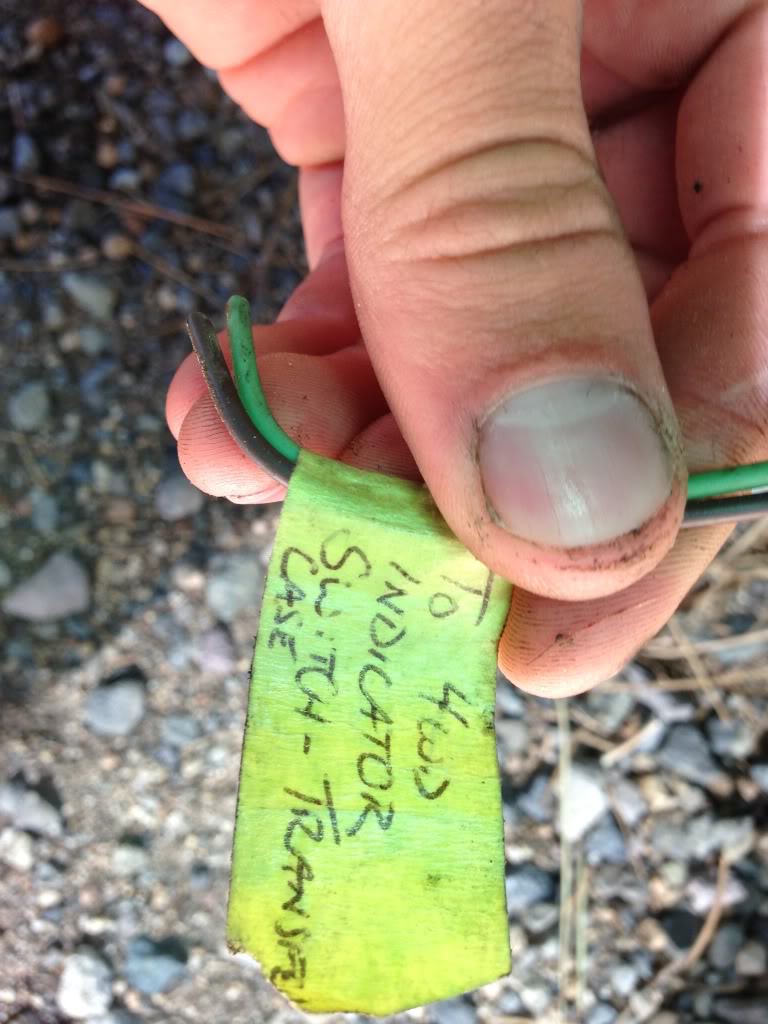

4wd indicator Name:  42146367-7073-4A41-8D20-96AC53EE7BFF-356-0000002CC314C324_zps19cc0a1f.jpg

Ah! Ya so on your old harness, find the connectors that formerly plugged into the reverse light switch and the 4wd indicator (that's probably the longer one of the two identical looking ones) then cut them off your old harness (leaving enough wire to strip and solder the wires that ORS labeled for you) then solder those connectors onto the wires ORS gave you and you should be good to go
