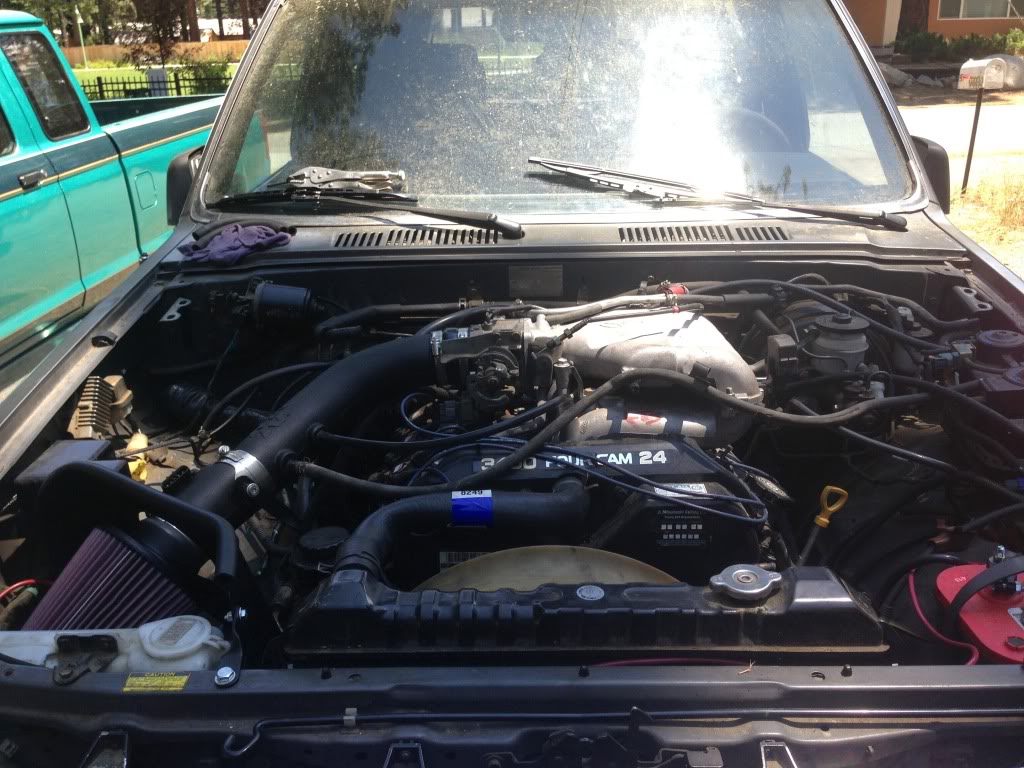

Here she is. Haven't put the hood back on yet !Name:  9E931640-3F7F-4F57-A7C5-AB578F35B857-159-00000007ABB32FA9_zps25231883.jpg

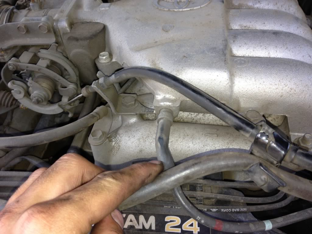

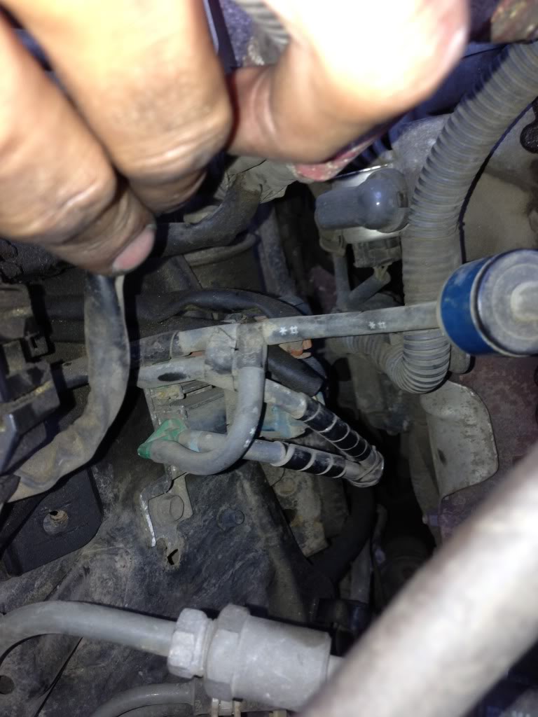

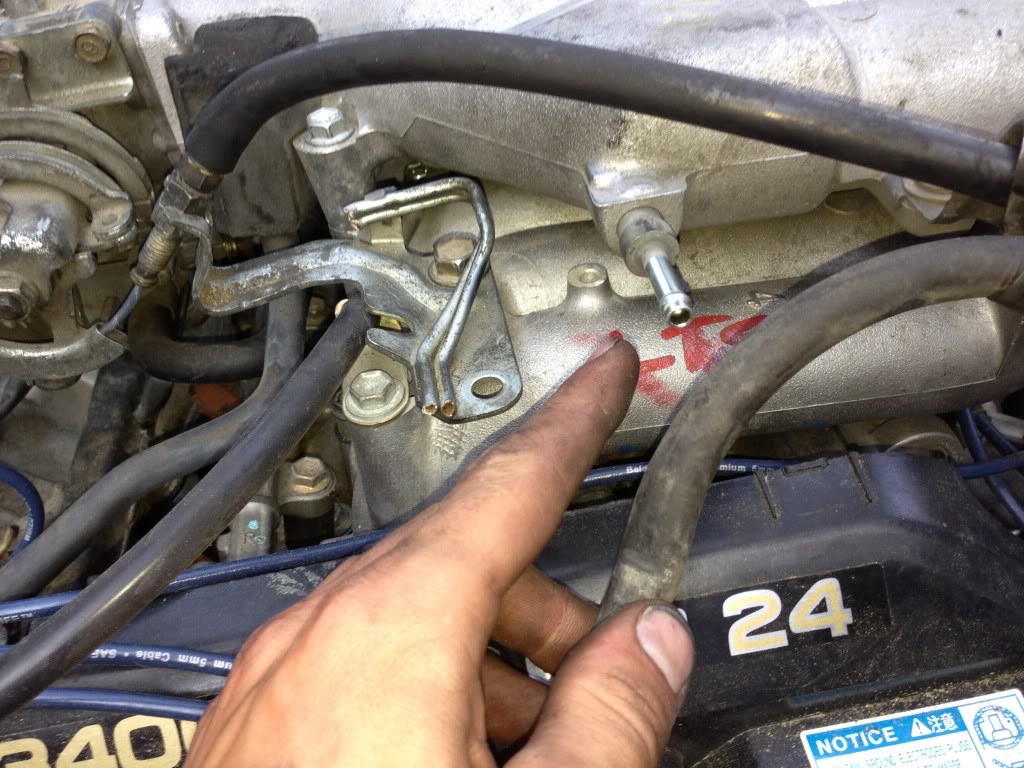

Trouble shooting time. Damn. Thought she was gonna start. No exhaust yet so 2 o2 sensor plugs hanging but shouldn't screw up my starting. I got power. All the lights work. Windows work, reverse lights work, even 4wd light turns on when I click it on. Try to crank her and she just cranks and cranks. Here's what I'm missing and I'm hoping its the cause. Name:  E609A913-9E38-4398-A735-FB91E8661DCB-293-0000001462840B29_zpsf499be7c.jpg
Size:  152.0 KB. This is the fitting directly on front of my upper intake manifold. I have nothing there obviously. I looked at my buddy's 3.4l. And he's got it routed down through a small filter then to his drivers side wheel well where there is 2 plugs and about 4 hoses feeding off somewhere. Couldn't find where they routed. Here's his. Name:  F0D23DB8-12D9-48C4-A5A7-D7C6A049341C-293-000000145937A448_zps010335c6.jpg
Hose feeds down through that blue filter on the right then into that mechanism below it with a few lines going around.

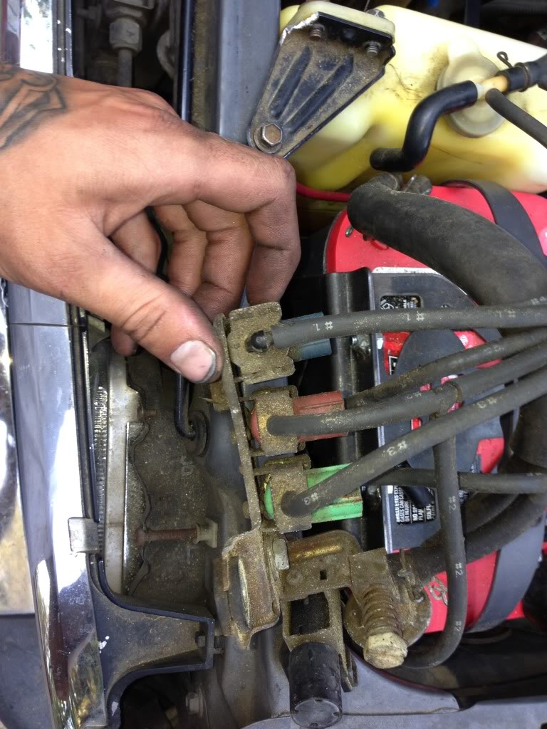

Looks like this- Name:  7BE7573A-48BE-40FD-84E1-19FF6C85C3C2-293-000000145DF2BF03_zps6c982d4b.jpg
Size:  140.2 KB. (this piece is off of my 3.0.). But I have no extra plugs on my 3.4 harness that I'm missing. Any ideas? I saw on a picture of someone else's swap here that he fed that hose somewhere down to the passenger side but I have no idea where. :-/. Almost there

Missed this picture. This is my buddies 3.4l. Hose feeds to that blue filter then down to fender well. Name:  7A5C76CB-85EA-4B73-ABBC-49CE4CBA4303-293-000000145446DD7C_zpscc798dfe.jpg
That port is supposed to be routed through the idle up valve on the power steering hose. The other side of the idle up valve should be routed to a port on the intake between the MAF and the throttle body.

I'm not sure what you're buddy has going on, but that bank of VSVs are for A/C idle-up, AS, FPU, and EGR, and they're not needed with the 3.4...or at least I didn't use any of mine, but if all he has is a filter at the end of that line and it's open to the air, he's got one hell of a vacuum leak and probably getting really bad gas mileage, bad performance, or both.
Old Jul 1, 2013 | 11:18 AM
  #154
Moto260's Avatar
Joined: Feb 2013
Posts: 224
Sorry I'm a little confused.
Wouldn't the idle up air control valve be on the throttle body? Ill have to check around on my p/s lines better but I don't recall seeing a port for that.

On my 96/97 4Runner donor the power steering hose has a fitting to attach a pressure valve that opens when the oil pressure gets too high and allows metered air to bypass the throttle body to raise the engine idle. The 3.0 had a similar system except the valve was on the pump body rather than the power steering line.
For me, because I'm in CA and need it to SMOG, I had to make sure that all the vacuum lines were going to the right place for a 97 4Runner (I had mine SMOG-ed as a 97).
It looks like some of the later years replaced that valve with a pressure switch that was tied into the ECU, but on those applications I have no idea how the idle up worked or what was connected to that port. If you don't have anything that needs to be connected to it, I would just cap it and be done.

That front upper hose is the 4wd ADD vacuum source. Also thats not a small filter, its a one way check valve.

Its not crucial to start. If you're not running the ADD system then you just cap it.
