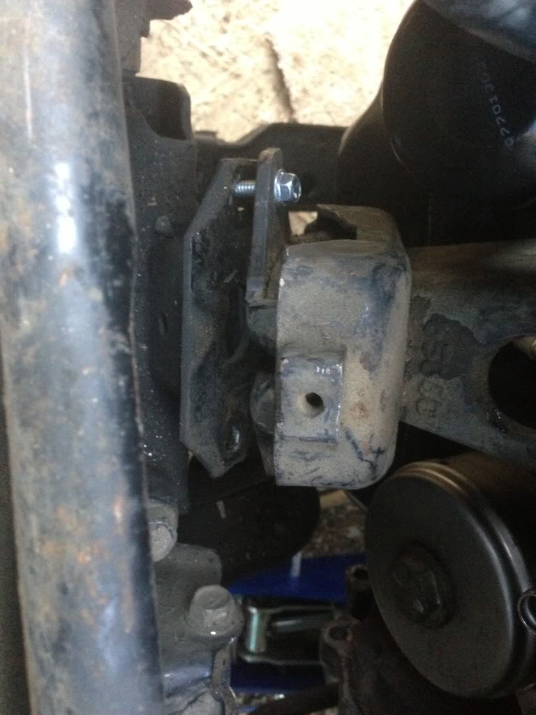

I got the oil pan from ORS, just couldnt get it over the stabalizer bar, now that its over it looks like it'll clear ok once i put it back on. I ended notching my engine mount to clear the spout. Just seemed easiest and fastest. Not the cleanest cut, but it works.

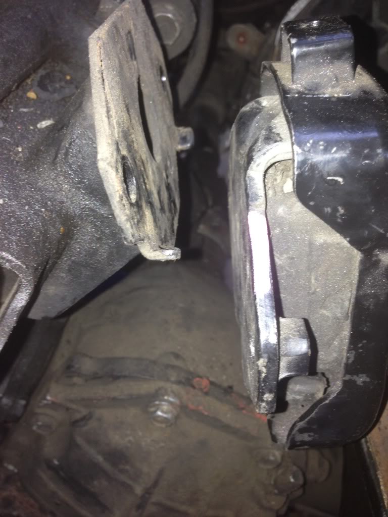

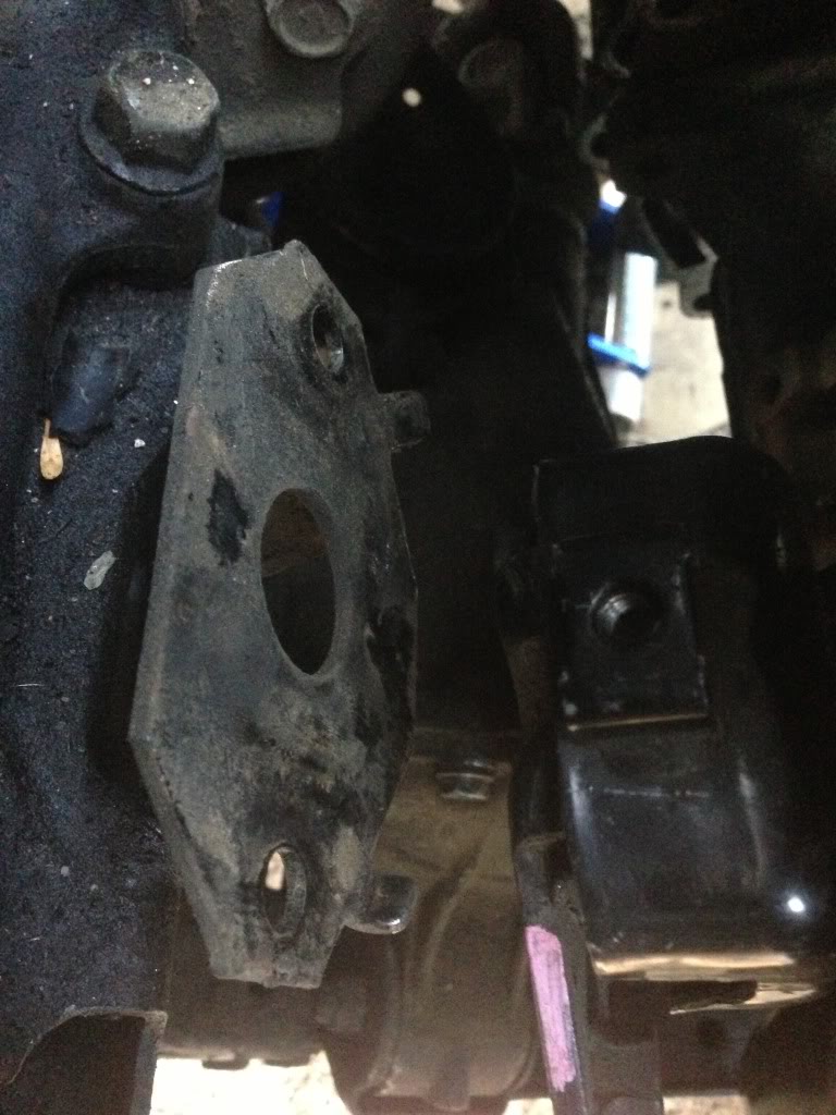

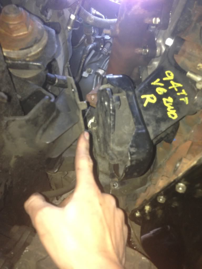

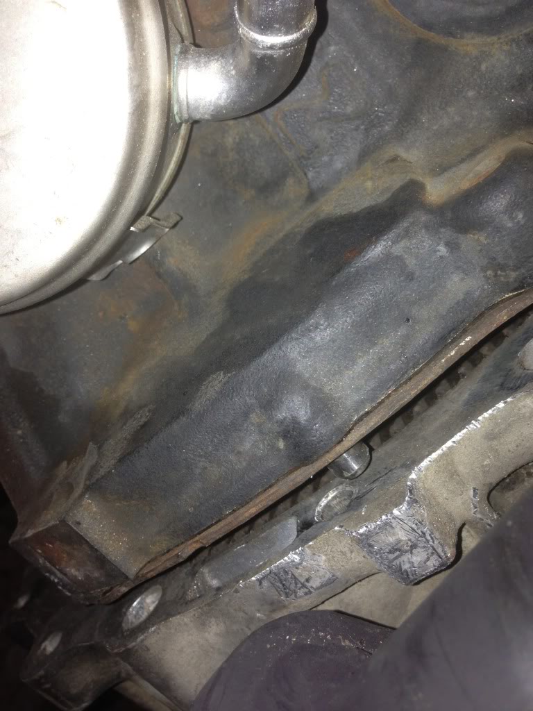

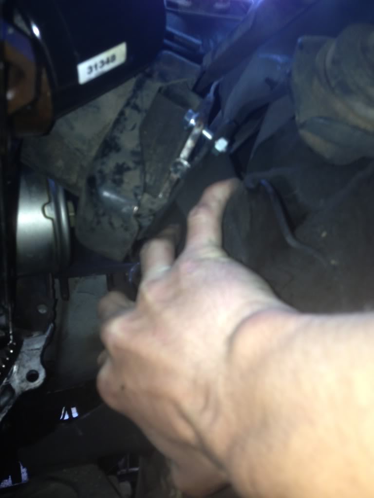

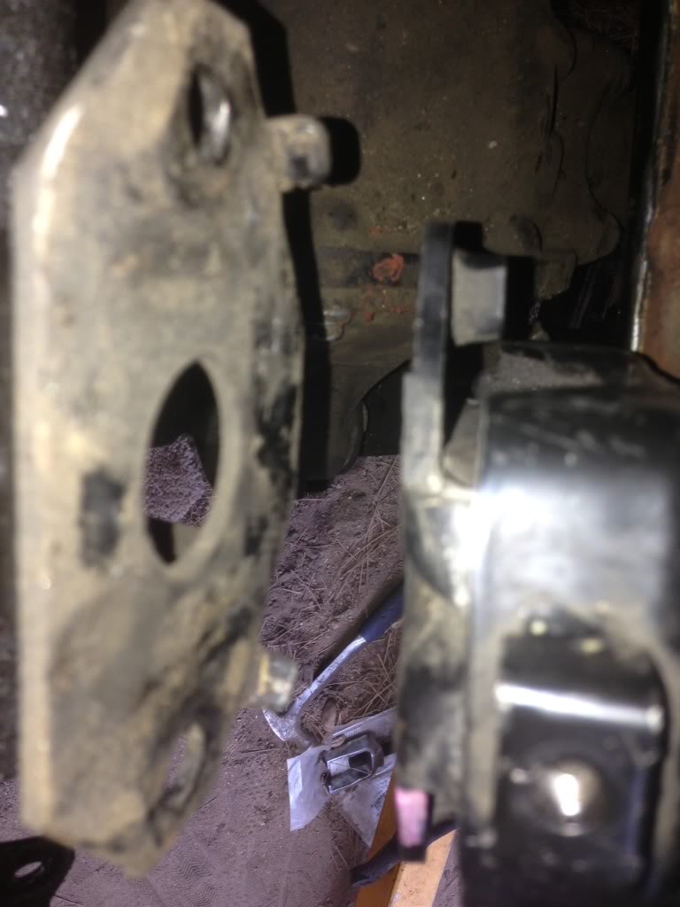

I'm really Struggling with my engine mounts. I feel like they're still wrong. I got them off of a 94 3.0. They look like everyone elses do, and clear my a/c bracket perfect. But i've got a quite the gap between my Engine mount on my block and where it is supposed to line up to my frame mounting holes. [/IMG] I put a small bolt and nut on this Drivers side so my tranny spline wouldnt slip back out of place (was quite difficult to line up)

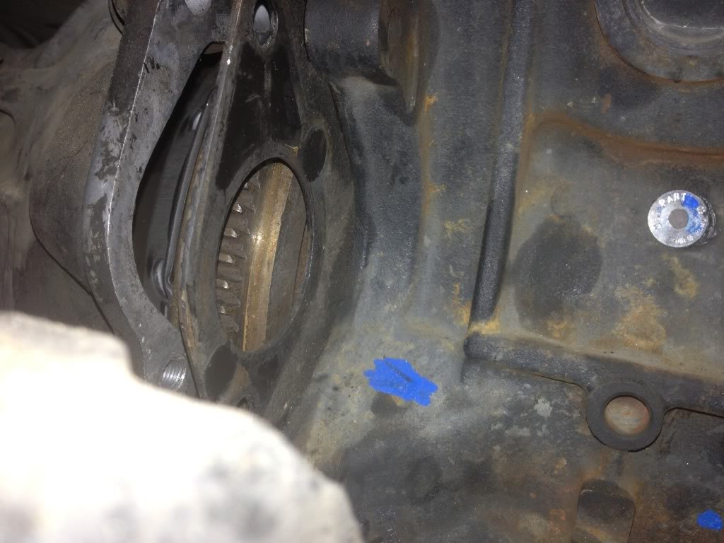

[/IMG] This is my passenger side. There's a pretty big gap, i dont understand why. Makes me question if they're wrong. Here's more pics/different views. [/IMG][/IMG]Back to drivers side you can see that small bolt and nut i put on it just to hold it in place. [/IMG]
Here's how close my tranny is so the spline on the tranny must be in.. I could put my started bolt through and tighten it if i wanted just worried about cross threading. Engine mount that far off stopped me from continuing. This is the left (drivers side) [/IMG] Last one of my tranny. Starter side. [/IMG]
I'm lost as to what to do. my problem is, On my drivers side i still have a little gap between my engine mount. Even with the bolt in holding it. Then on my Pass Side it's about a inch and a half off to bolting on. If i pulled my engine over towards the passenger side, im just going to even out a gap on each side.
Sorry guys. Hope i'm not being too much of a pain in the ass. =/

Old May 3, 2013 | 07:49 PM

Posts: 224
Size:  95.8 KB drivers side has that little bolt. Pass side Name:  732BBCD9-7A21-4552-8096-31E497AD6DCA-141-0000006184FA219E_zps35f8e933.jpg
Size:  103.0 KB. Name:  C3955E06-0C1A-46A8-996B-68BCA045B304-141-000000617FFCD127_zps7f84f033.jpg
Size:  66.8 KB. Name:  2A15354C-9C3E-4674-AE75-8AFA4F90F49F-141-000000618D667ECC_zps1cbbb8df.jpg
Size:  114.6 KB Name:  23559620-CD0D-4C20-A78A-E2AFA774811B-141-0000006179BD3F31_zps1b382332.jpg
Size:  41.0 KB. Tranny. Drivers side Name:  63A52EAA-941C-4DA1-B8EF-DDF29EA8F500-141-00000061742901B9_zps013e6797.jpg
Size:  116.0 KB. Pass side, starter Name:  78935159-DEAE-4F4A-A460-03018446EFA2-141-000000616DE4B88B_zps83e85b64.jpg
Size:  103.4 KB. Name:  AE533260-ADC9-47D7-AEC4-045C041E0883-141-0000006155D38797_zps8e0f45b1.jpg

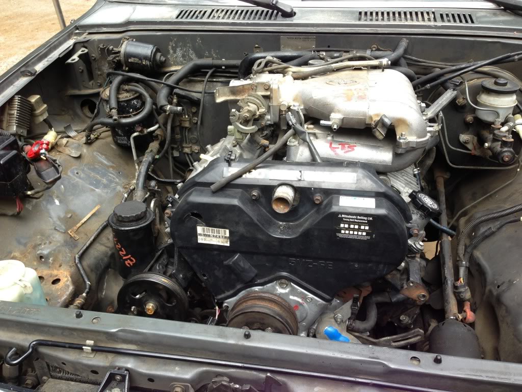

Size:  170.8 KB. Got it in. Lot of wrestling with the engine, lined it up and pulled it out of my transmission about 4 times. Those new 3.0 mounts I got were too small. I ended up taking my engnne out and measuring where they were supposed to line up on my frame. 1ft 11 inches. Put flat edge on both mounts and had 1ft 6 inches. That was my problem Put my original 88 mounts on Had it lined up and dropped in within an hour :-/. Kinda rough that my A/c bracket won't fit without mods now. But ill figure that out later. Also as you saw originally with my 88 passenger side motor mount. There's only a place to put three bolts so I hope that I don't have problems with that down the road. Ill just have to check them regularly(every oil change). Stoked its done, now to my hood scoop and wiring portion.

Wow, it's something like that, that's supposed to be easy, can burn you out quick. Stick with it!

Great work man! the motor mount line up was a bit of a PIA for me as well. Looks great! All your hard work will pay off on that first drive. Trust me!

You can't use 2wd mounts. That was why they were too short. Glad you had your other mounts to use though.
