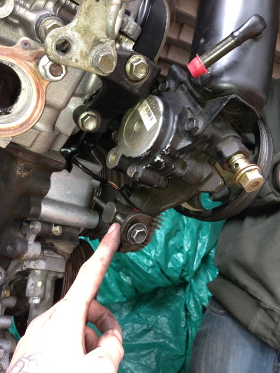

Ok this is my p/s. is this the banjo bolt?? I thought it was the front bolt on the pulley but that's wrong. That's a nut haha. Is this the one I put my 3.0 banjo bolt to? Name:  34A33E4F-F31A-4EFA-BA55-DE1C8C09311B-3793-0000025ADB417043_zps7802d38c.jpg

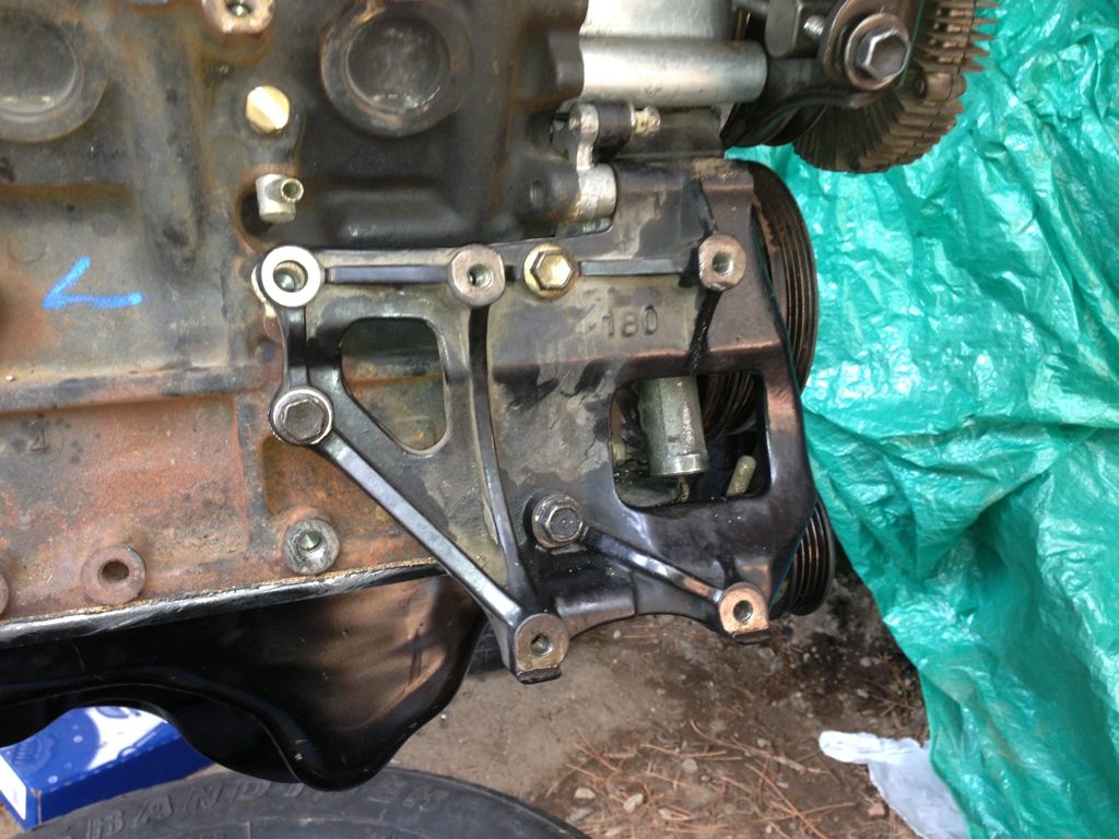

New A/C compressor bracket bolted on Name:  4BEF7D15-6195-4180-9794-E3A61F2F38D8-3793-0000025A91714F3A_zps3287f425.jpg

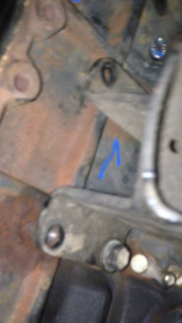

This 4th bolt though has about a half inch gap I didn't even put it on, figured other three Would hold it fine and tried bolting it in other places. That's the only place it'll match up Name:  8B716CA0-38F5-44D7-91BB-F04889C9A79C-3793-0000025A7F62014F_zps1ac0b0b9.jpg

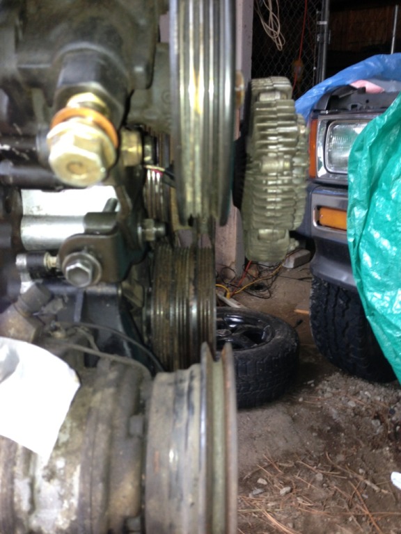

Here's my problem. Real pissed about it. Don't want to spend to much on this bit want my a/c compressor on. This is how it matched up when I put it on. The pulley is off you can see that it's wrong. Can I just get a new pulley out of a 3.4 or do I need to replace the whole damn compressor? Keep in mind it's not R134. If I just replace the whole thing will that be converting it to R134 and killing two birds with one stone? Name:  1506B3E7-2CC3-49C4-A502-48707C0A9906-3793-0000025A9F2A54CB_zpsf4390a68.jpg
Old Apr 15, 2013 | 08:04 PM
  #49
Moto260's Avatar
Joined: Feb 2013
Posts: 224
Any help would be great on that and very appreciative
Banjo bolt is the copper/bronze bolt (up near the pulley) with the hole in the middle and end to allow the fluid to pass through.
The 3.0L motor mount has a "leg" that fits between the block and the A/C compressor bracket.
You'll need the pulley off a 3.4 A/C pump; have you read the sticky "How to: A/C" thread? https://www.yotatech.com/forums/f160...4-swap-251179/

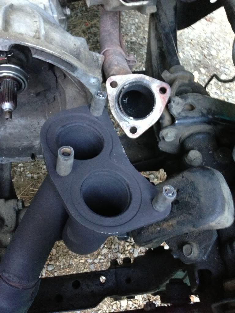

Well got my crossover went to put the engine in and noticed this. Damn

You need the downpipe from a 3.4. I just get the downpipe and cat from the 3.4 setups when I did my swaps. Then the exhaust shop just has to slightly cut and rotate the cat and it all bolts up 100% stock. Only the exhaust after the o2 sensor is aftermarket or "fabricated" on my swaps. Everything else is 100% stock OEM parts.

Alright. I kept looking at the crossover from ORS and toyonlyswaps. And noticed the one from ORS is a complete custom to the one exhaust, spaced that on toyonlyswaps it says this Is a dual tube. Ill probably drop the engine in and once everything else is complete just drive it down to an exhaust shop and see if they'll cut and weld that 3.4 down pipe on. Seems pretty easy, I just don't have access to a welder. Oh well Thanks for the help Deathcougar

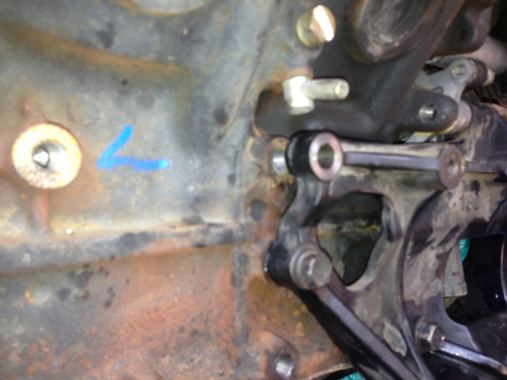

The 3.0 engine mounts will work, but your block has a drain spout on the passenger side, above the A/C compressor mount (that sandwiches the engine mount) and below the copper/brass plug, see your picture below:
Some people have ground a notch into the motor mount to clear that spout, but I would recommend just removing it. That copper/brass plug is there to drain coolant out of the block and that spout is just there to keep the fluid somewhat contained. The 2 blocks I had ('96 and '97) didn't have that spout, so I would rather remove the (pretty much) cosmetic spout than to risk screwing up the structural integrity of the the motor mount.

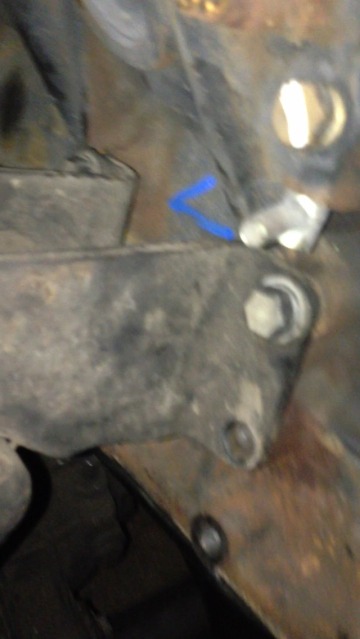

Alright sorry for the crappy pics here but my engine is just hangin in my engine bay. I got frustrated with it took off the A/c bracket put two bolts on the engine mount and just tried to drop it in. Stabalizer bar is making It very difficult to light up. I'm gonna pull it off tomorrow and try again. Any ways. Here's how I put my engine mount. Name:  C8BC6F8F-DE37-4839-890D-C06101165161-141-0000000514C065BA_zps56c19dbf.jpg
Size:  43.6 KB. I only put two bolts in it on top. (Only three have a hole to put a bolt in and the two on the right both interfere with my A/c compressor bracket. ). I only put the top bolt in though.
That top hole is the one that has a space on my a/c bracket. But still with it on there's a gap. And on the bottom hole without a bolt in it. The a/c compressor bracket sits on top of my engine mount. (With my a/c bracket on it throws the bracket out of whack and the pulley doesn't line up.) The bottom left side of the engine mount has knowhere on my block for a bolt.

Its hard to tell from those pictures (a zoomed out shot may be more helpful) but those motor mounts don't look right at all.
The 3.0 mount that bolts to the block shouldn't be flat like those are. And your mounts are too low on the block. The top bolt in the second picture under the drain spout is actually the lower motor mount bolt hole; the upper mount is about an inch below the head and you'll have to remove the exhaust manifold heat shield to get to it.
Check out this thread for a decent picture, but keep in mind he's not using the Toyota 3.0 mount he's using a custom one, but the mounting points are the same.
https://www.yotatech.com/forums/f160...r-side-253654/
