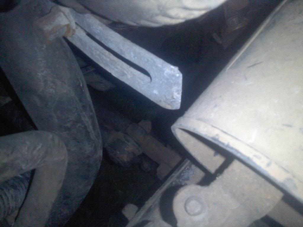

Hey Austin. Can you post a pic of your alternator bracket so I know where to cut it?

here is a front shot of the 3.4 bracket:
so there used to be a tab that bent out toward the direction that i am pointing. after seeing these you should know what to do....
[IMG]
No idea on the oil pan/dipstick drilling....you may have to PM one of the guy's who has done it. I did read ORS offers "dipstick drilling kits" though
