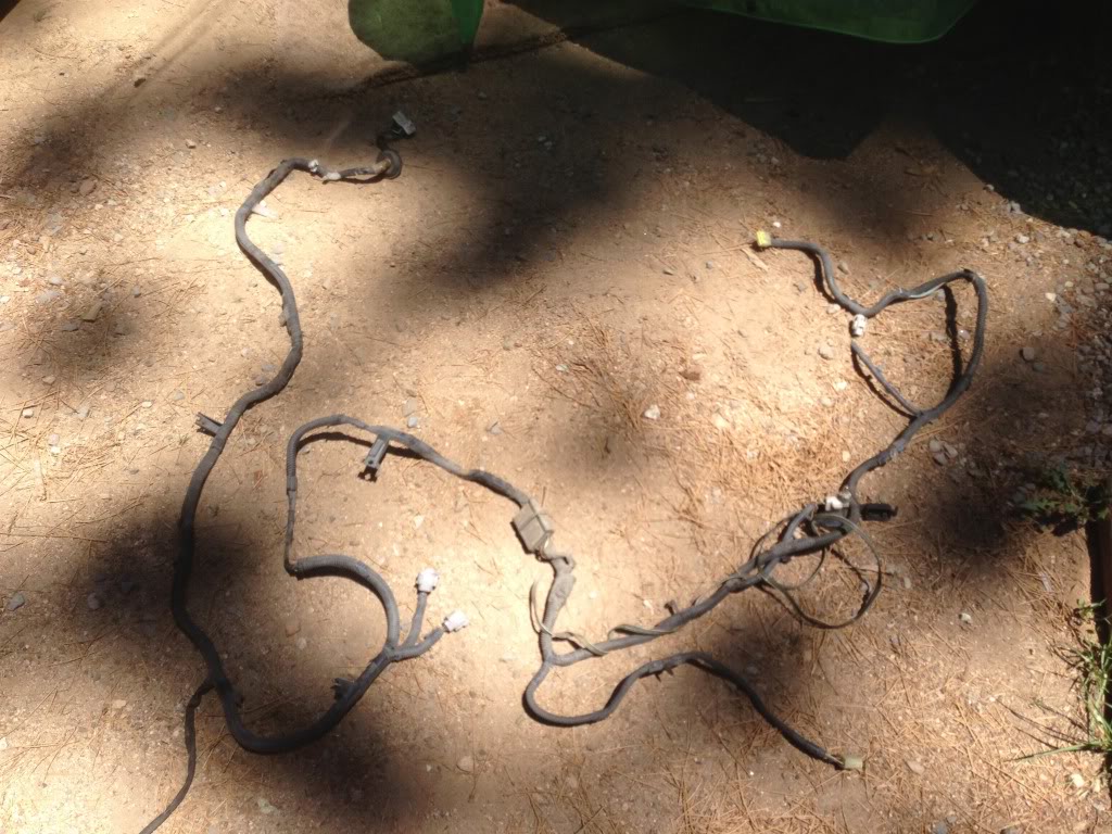

Well its called your transmission harness but its tied into your engine harness already so I think you should already have every connector you need regardless. and i think that ORS should have provided wires for it. If they dont have connectors you can just cut the ones off your 3VZ and solder them onto the harness that ORS gave you but I bet you've got them already. No pics yet, sorry. Worked literally all weekend

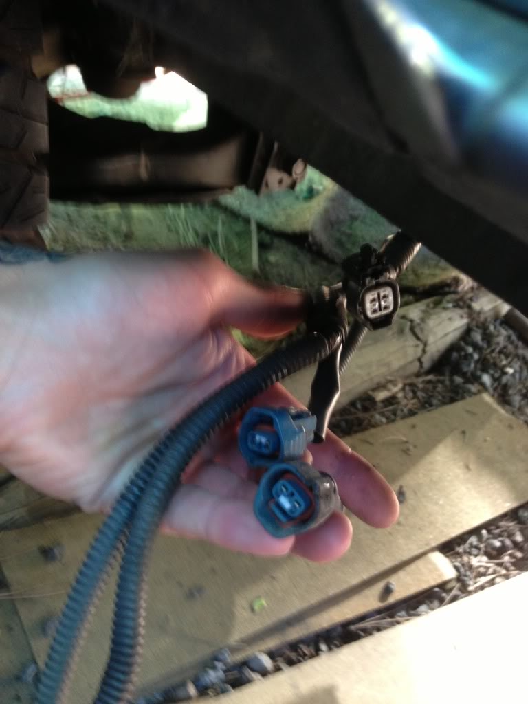

Old Jun 10, 2013 | 03:08 PM
  #90
Moto260's Avatar
Joined: Feb 2013
Posts: 224
That's where the engine harness feeds out by my tranny. Guess that's what you're saying is the transmission harness.

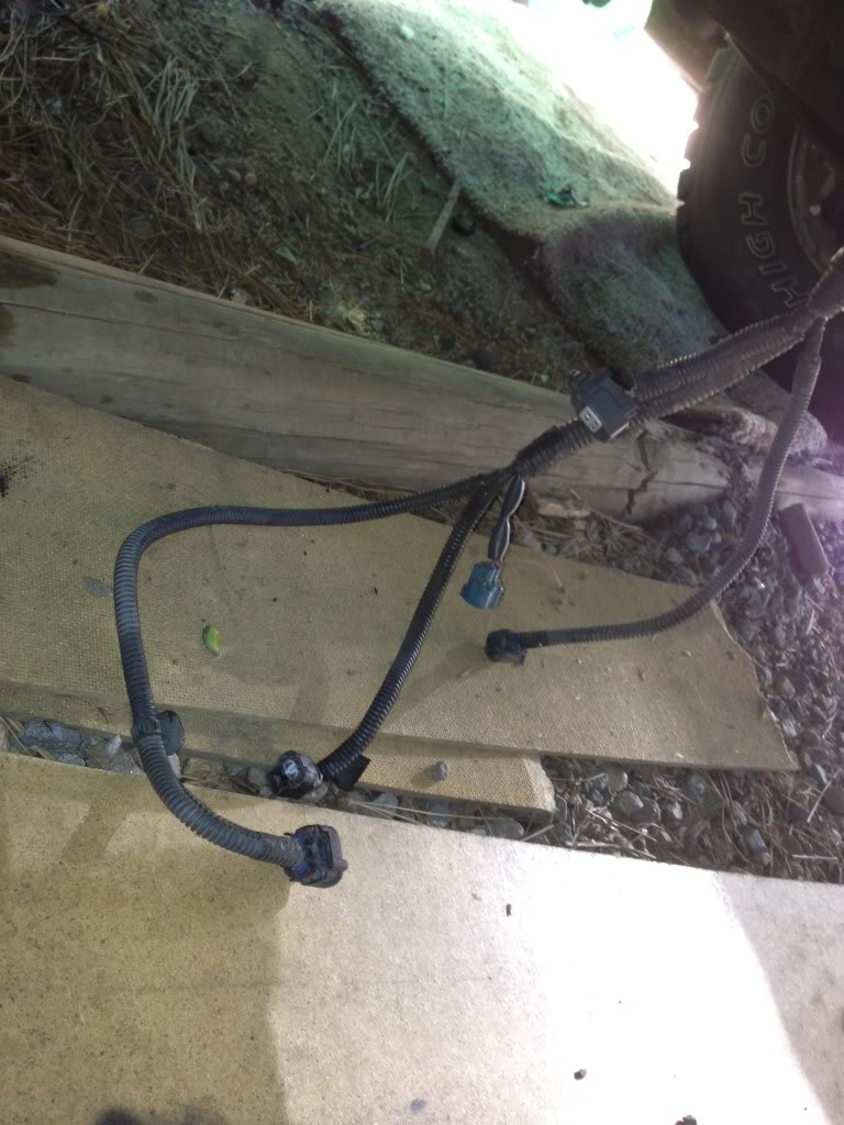

Here's my wires hanging that im lost on.
Old Jun 10, 2013 | 03:09 PM
  #91
Moto260's Avatar
Joined: Feb 2013
Posts: 224

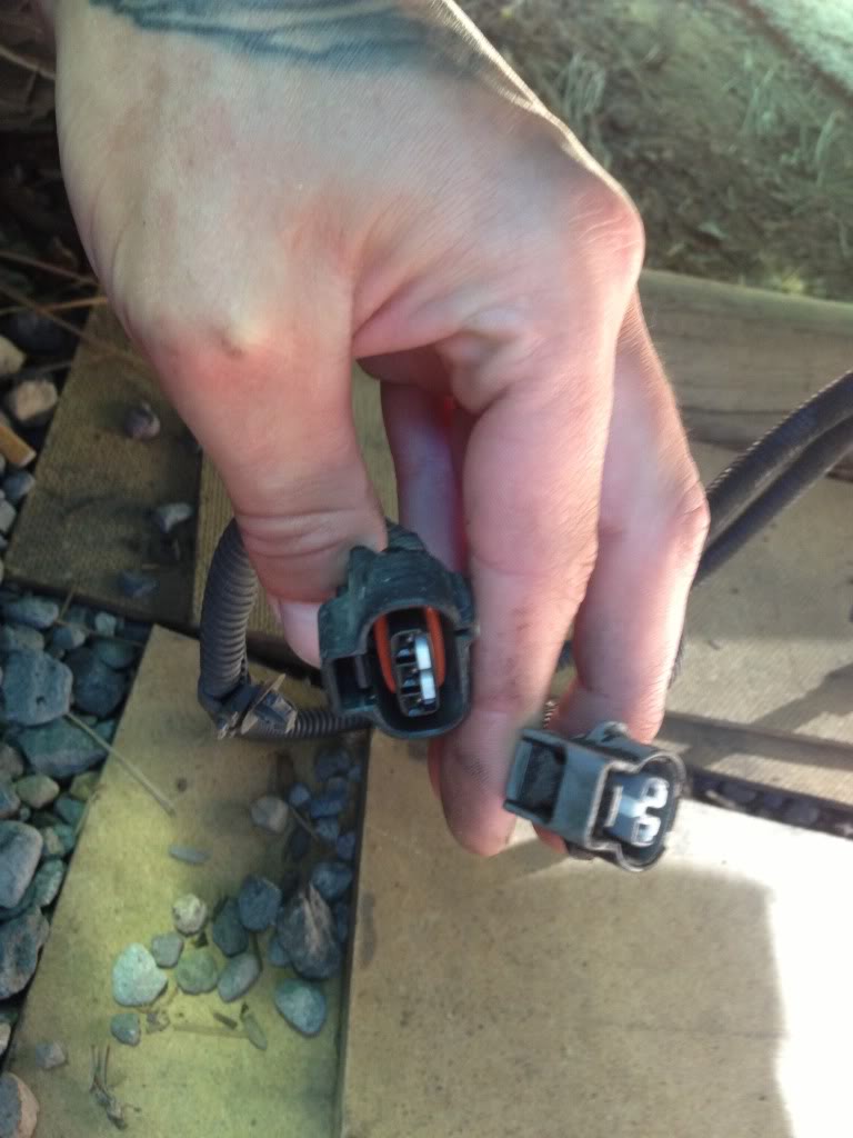

And here's the plugs closer up.

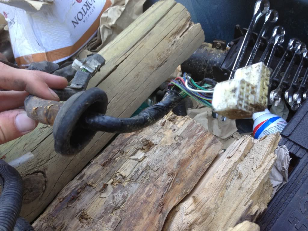

I got this harness when I bought the engine and engine harness. I think it's the 3.4l harness that feeds to your drivers side kick panel and out through fender well by new battery placement. Don't think I need it, but I'm curious about it cause it has two light bulbs on it. Maybe for the rear or front and I thought tranny harness because it has a Uhaul trailer harness wired around it. Yet none of the plugs match up to my engine harness(at least by my transmission). Name:  DFED918F-0421-47A8-8DBD-3A1D605FA3DB-322-000000215D9B2D41_zps6b387a05.jpg
It's got this boot on the end, and these two main plugs got a ton of gunk in them. I don't want to use it just by the look of it so hoping its just trash. Name:  4CE037BF-C1E0-4CE3-8AFB-44DA31534A6E-322-000000214BEE4EF9_zps92906e24.jpg

K the pic with the grommet. That harness I THINK is irrelevant. Dont trash it till your all done. Those connectors on your harness that drops down by the exhaust are the connectors as follows from longest to shortest: longest, looks like a VSS (vehicle speed sensor 3 pin) connector. the next one up looks like your t-case connector that detects your 4wd and turns on the indicator light on the dash. the next two that look identical that you are holding, one is for your reverse light's, and one plugs into the side of the tran's (forget what its for lol). and that shortest one that has 4 pins is your down flow O2 sensor which if you havent already will need to be added to your down pipe (as seen in my swap thread).

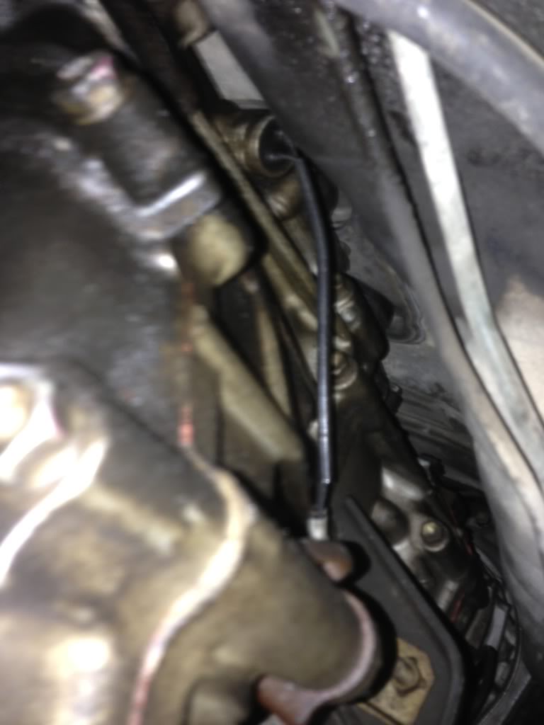

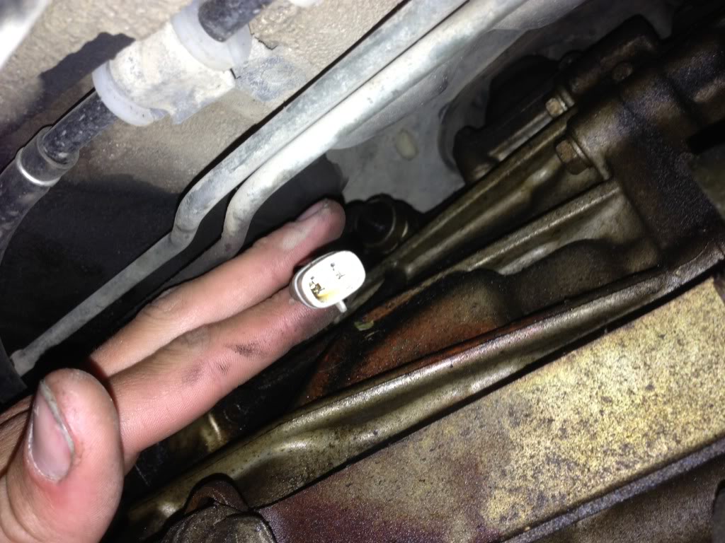

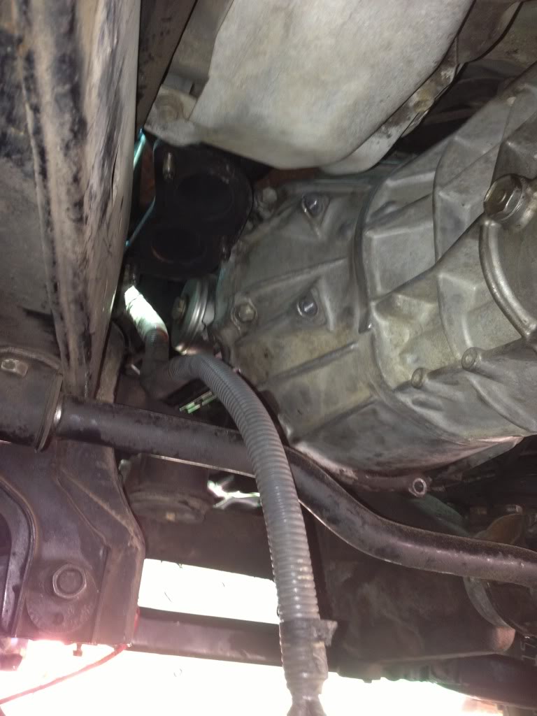

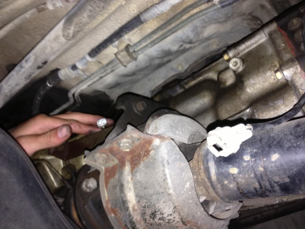

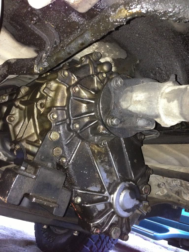

Back of transfer case drivers side Name:  DE70E556-5FA8-44B3-AF16-1CD43BEC369C-119-000000608D03C86B_zpsb20ba410.jpg

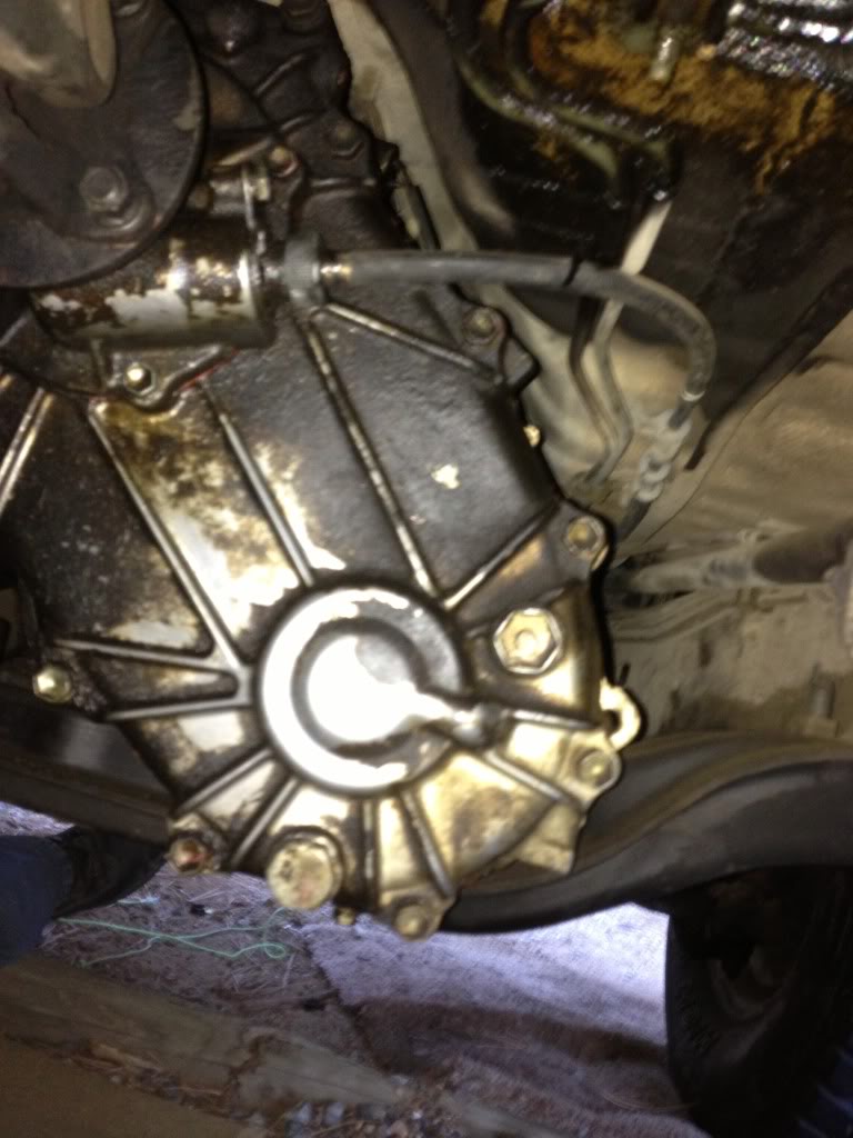

Passenger side back of tcase. (Thatis what I un-screwed in the old thread. its cable driven) Name:  EA513121-0C49-4F96-9C7D-66CEABD4AB81-119-0000006093151840_zps134c770a.jpg
This is on top of my tcase. Two wires and a plug coming offName:  6C4D5B57-D25C-46DE-B67E-51FDBC09D962-119-00000060984C881B_zps9c3a0d4e.jpg
Size:  54.2 KB same off top of my tcase Name:  CBEB7F87-1E44-497C-A261-21F22D894F76-119-000000609F1A1CC6_zps0cbbf02d.jpg

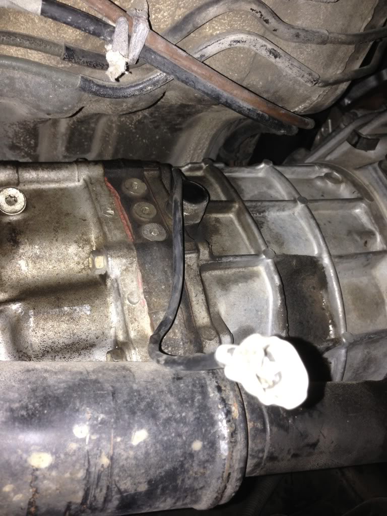

This is the only plug I see coming off of my transmission.Name:  C5F413D0-618D-477C-B249-9B76E16177DE-119-00000060AEE9694A_zpscde88faf.jpg
I thought these two plugs t case and transmission plugged into each other but they're different colors so I'm wrong Name:  303B1C65-5E67-4708-B0CF-E36ED475A8A8-119-00000060B983BA13_zpsf76b4f4c.jpg
And here's my 1 o2 sensor. I pulled off my exhaust and only have the down pipe that connects to my crossover. It has an o2 in it with a plug coming out for before my cat.

Ya man. so it looks to me that you have all the connectors accounted for you need on your drivetrain harness and on your t case and transmission. the only thing though is that VSS that came on your drivetrain harness. I dont think you will be using that but dont lop it off. You probably wont be using that since you've got a cable driven speed sensor. And I understand the busy at work thing. I had to work late last night till like 11 and obviously couldn't get out to my truck in time to take pictures but i will send you them lol. did you order wiring diagrams? you cant just go color for color. what i did before doing any wiring is taped each set of wires that went with each connector and labeled the tape what connector they came from. Im STILL working out some wiring issues myself. Figuring out the OBD2 wiring, SMH so frustrating sometimes. And it sounds like i have a mis-fire which it just started doing intermittently (or however the hell you spell that word). Just can't find time between work, up keep on the yard and everything on the house and my honey do list....

Looking at the pics you posted about the trans, those plugs go into the trans of the donor. Do you still have the stock trans harness the was on your truck? All you have to do is splice the old plugs into the newer harness. Should only be four wires for the trans harness.(Since you have a mechanical speedometer)Plus the wires for the O2's. Two for the transfer case, and two for the reverse lights which should run up and you need to splice into your trucks body harness.
