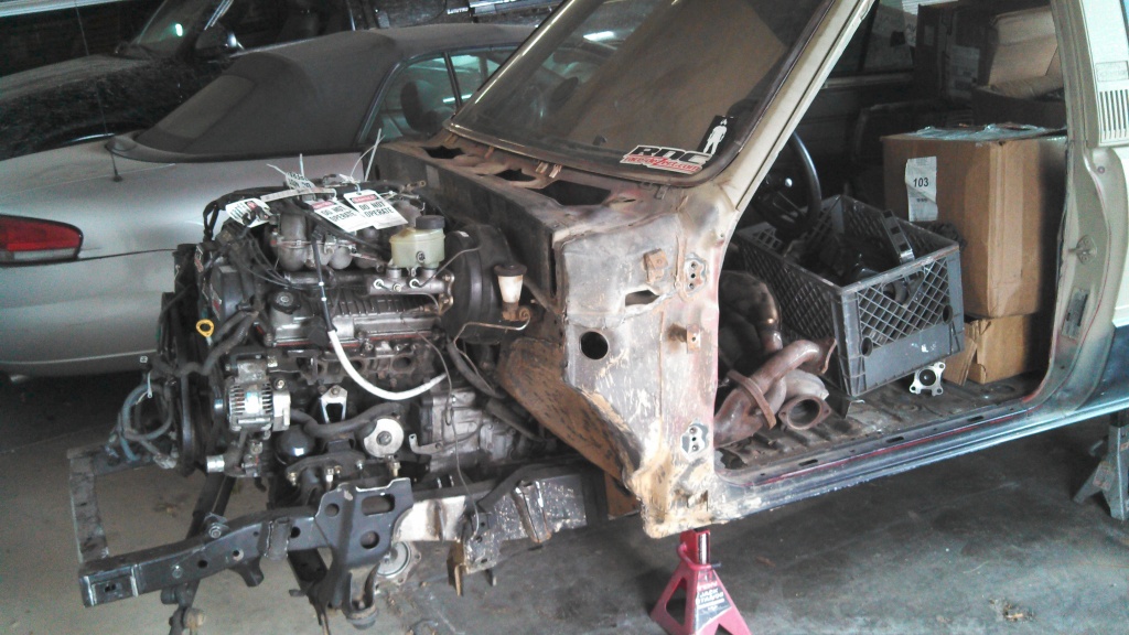

I was lucky to find a local guy that was getting rid of a project truck. He was in the process of installing a 99 3.4 with auto and gear driven t-case into his 87 4runner. I picked up everything he had for a great price.
I have the entire engine, Chilkat motor mounts
Boxes of wiring, the automatic transmission is already fitted with a Inchworm adapter and 23 spline gear driven t-case.

Made alot of progress over the past few months. Built my own frame side motor mounts to have the engine sit below the hood. Installed all of the tacoma wiring, column and cluster. I had issues getting the engine to run. Turned out that the guy I bought the engine from had installed the new timing belt 7 teeth off. Fixed that then had to replace the thermostat. Got it running and now I am finishing the fuel filler neck for the 3.4 4runner fuel tank I am using.
