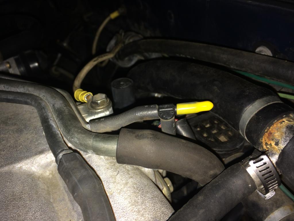

Since you guys have 3.4 swaps like me I have a side question for you. Recently I did head gaskets on my 3.4 engine and I found a vacuum "T" that looked like it was missing a hose. I have looked everywhere and cannot find a random vacuum hose laying around. For now I put a yellow cap on it. Can you guys look at my pics and let me know where this cap line should go to?

Went to the ADD I believe. I've always ditched the ADD setup so I just run and connect those two together.
Do you have ADD hubs?

No I don't. I am curious how long this vacuum line was open. I guess I will leave it capped.
That's where mine goes straight from the factory.
