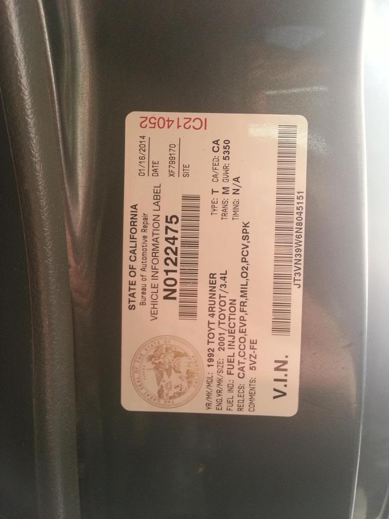

Ok so here's proof of completion:
The only main problem I had was clearing the monitor codes. It is OK for one of them to be set to not ready for smog, but if an engine swap is involved, all monitors must be set to "ready"
The hardest two to clear were the EVAP and CATALYST monitors

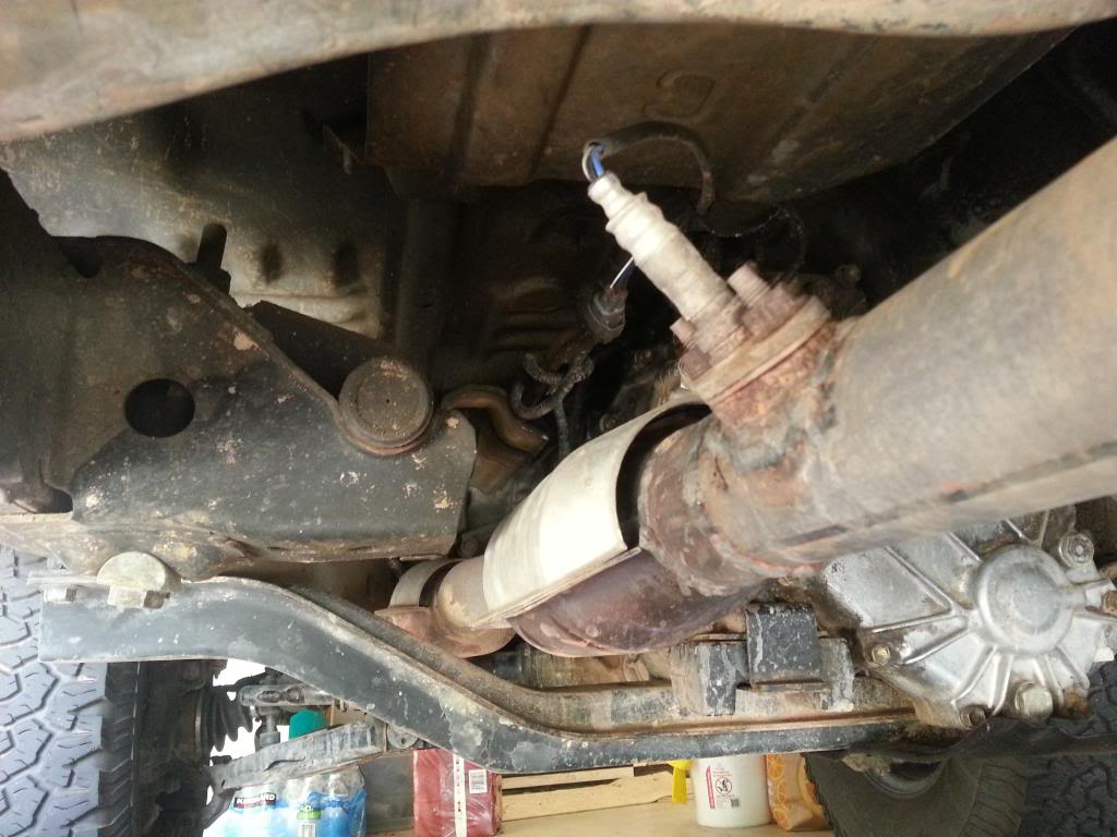

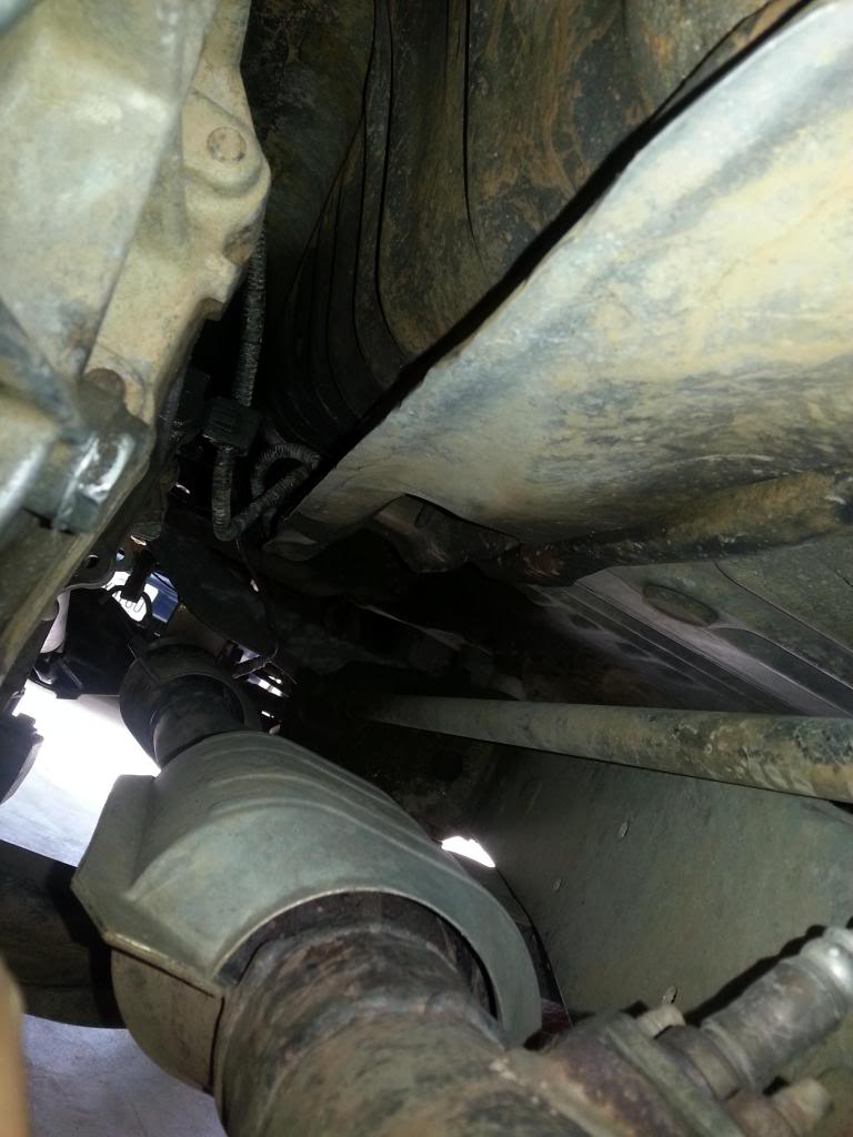

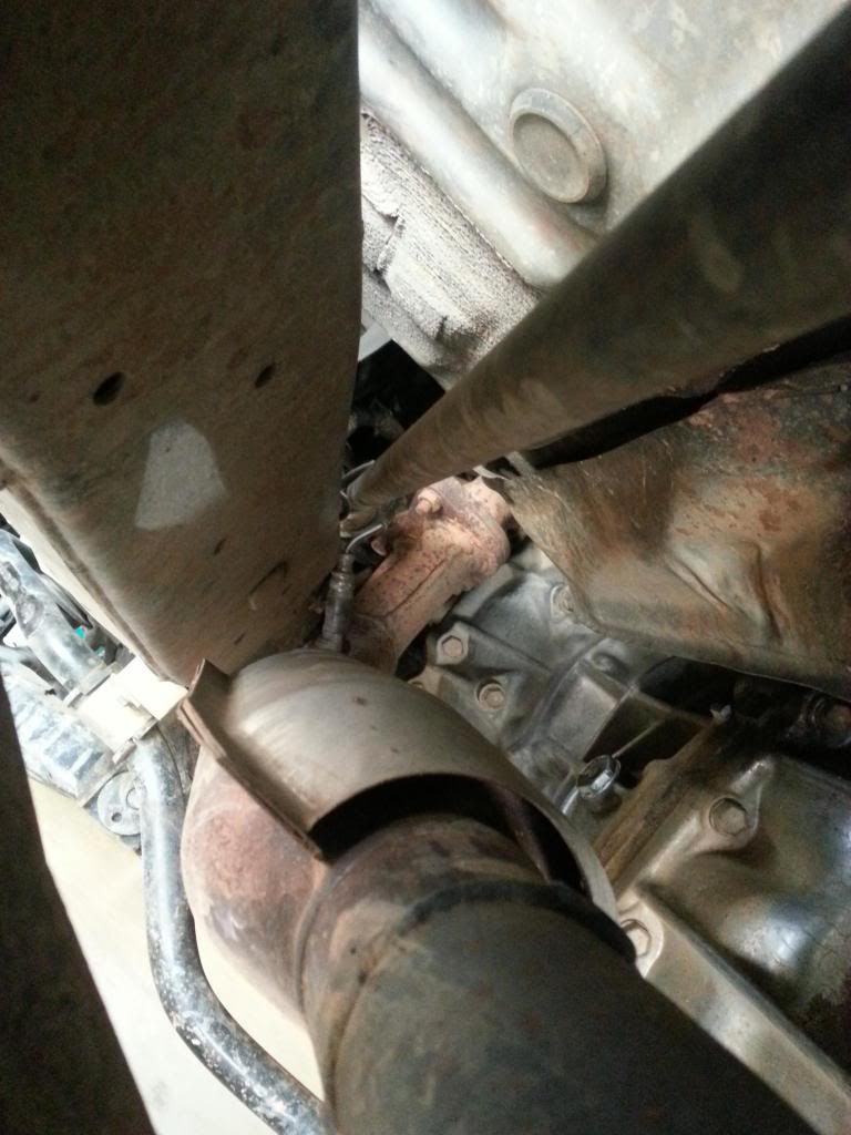

Also not sure if I mentioned or not, the crossover was OK,
as long as the required catalytic converters and O2 sensors are in the correct place.
Here are some exhaust setup pics (sorry if it's hard to see)
Looking forward from rear, behind 2nd O2 Sensor:
Looking forward from rear, 1st O2 sensor placement:

Looking back from the front:
Really it was not difficult to get it approved, only problem I had was clearing the monitors. And the only reason it took so long is because I was lazy and decided to drive it around for nine months illegally until I got caught by a ranger at Folsom Lake and they towed it because it was past six months expired tags.... Sometimes it takes a kick in the ass to get you to finish what needs to get done.
