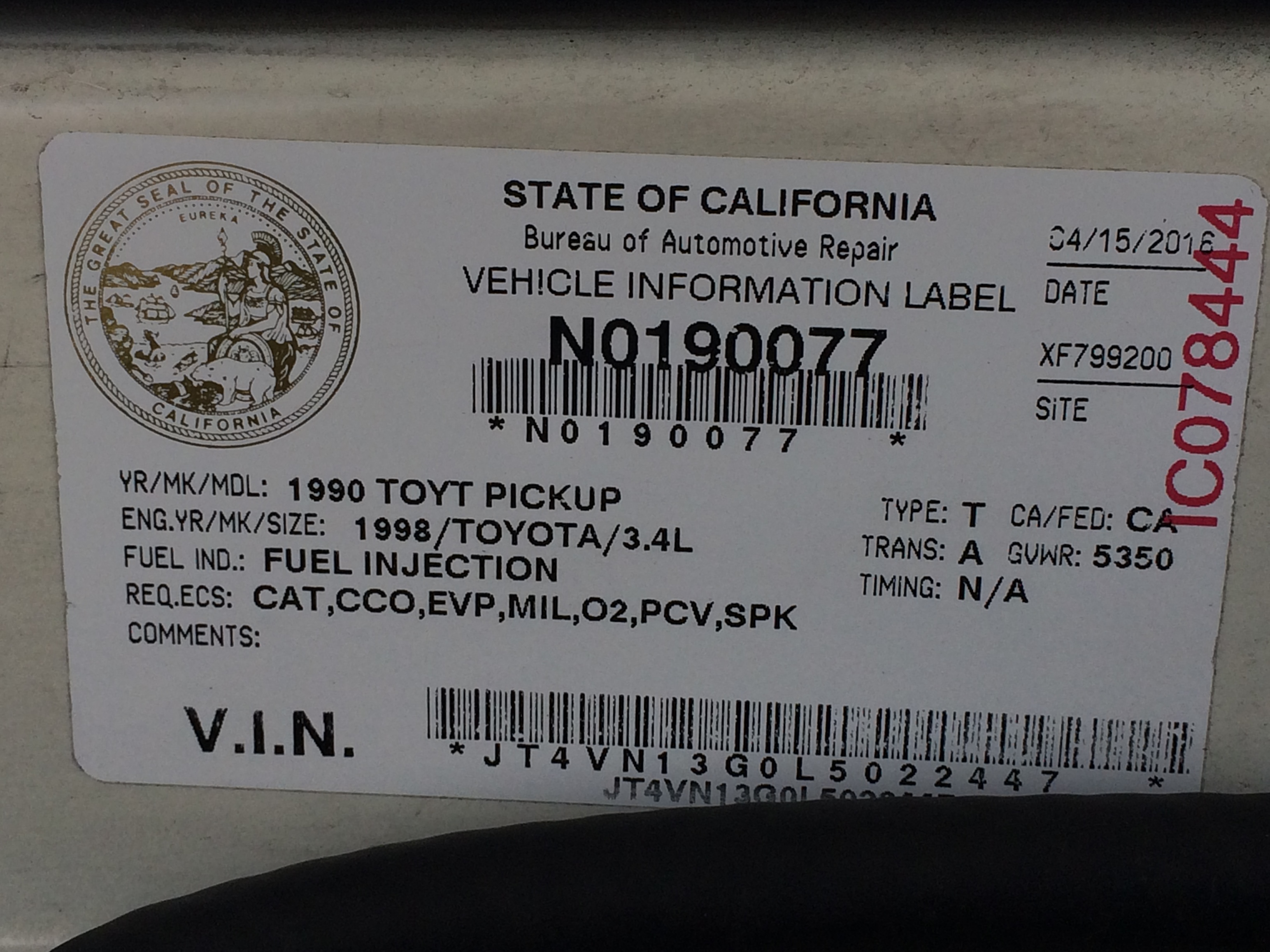

And don't forget the $8.25 for this baby!
I just got mine this morning.
You can do it. If the swap is clean the ref wont even question anything. The guy who did mine said "I had a hard yime telling if this was an engine swap" I guess the message is that if you do your homework and surf many of the posts here you will be sucessful and will be able to keep some $$ in your pocket as well.
You can do it!
You can do it!
where do you get that sticker I will need one for my swap or do they mail it to you after you pass ur appointment.

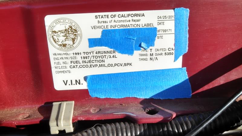

After you pass the SMOG Ref inspection, he'll print out and give you that sticker. He let me apply it wherever I wanted, but it had to be applied before I left (so that I didn't apply it to a different vehicle).
