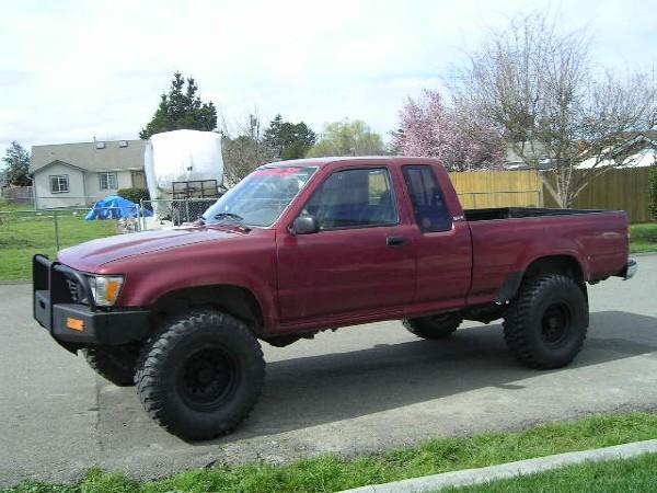

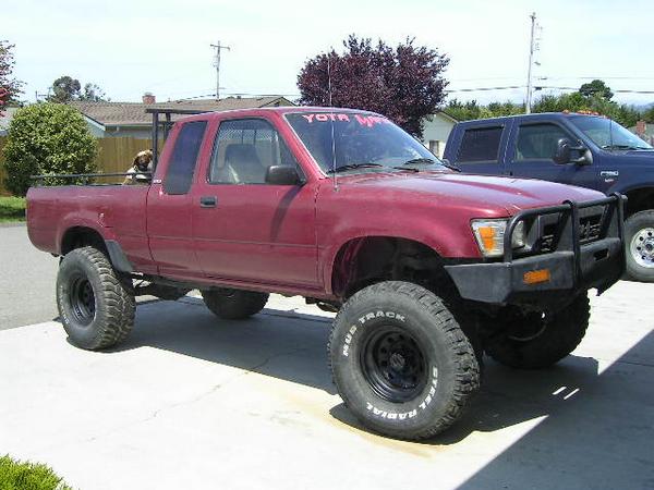

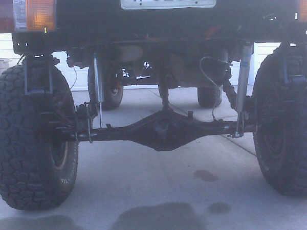

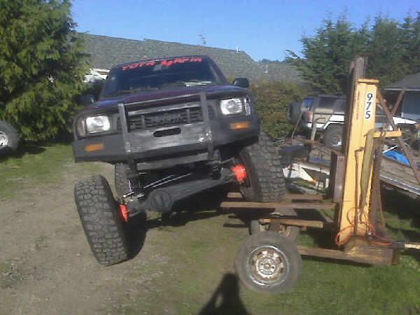

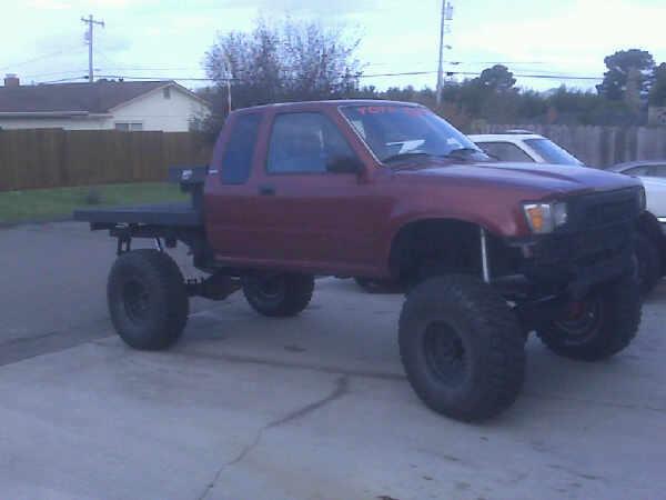

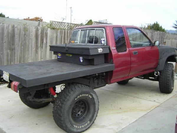

I finally sas'ed my 91 extra cab after selling my old 91 that was sas'ed i always regretted it tell now! Only difference is this one is red and a 3.0 and the old one was white and a 4 banger. The last one i bought built this one my buddy Tim and I built. All parts were ordered from davesoffroad.com they have killer prices and great customer service. parts: trail gear 5" hd ifs eliminator kit, rear 5" kit, creeper gusset kit and 78" sliders. I didn't get near as many pics as i would have liked but many more to come. pics are in stages wish i had pics of it stock it had no dents only minor scratches and 31" at's. You should see where i did the sas its yota heaven!!!!
Attached Thumbnails Timmybuilt SAS-yota.jpg   Timmybuilt SAS-yota2.jpg   Timmybuilt SAS-yp.jpg
Old Nov 16, 2009 | 06:55 PM
pitster33's Avatar
Joined: Feb 2008
Posts: 133
From: Fortuna, CA

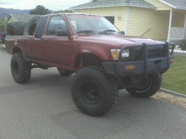

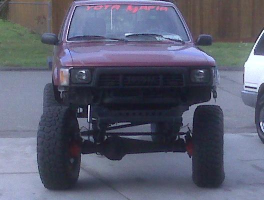

ifs lift and new 35" km2's. then the sas pics has 5.29's front and rear welded front lockrite rear. I also just built a square tube front drive line and I am installing sliders tomorrow.
Attached Thumbnails Timmybuilt SAS-km2.jpg   Timmybuilt SAS-l_773a9e393b46472f8a994f655b3230a8.jpg   Timmybuilt SAS-l_6bceef4dbd0941d3840f55416f843d24.jpg

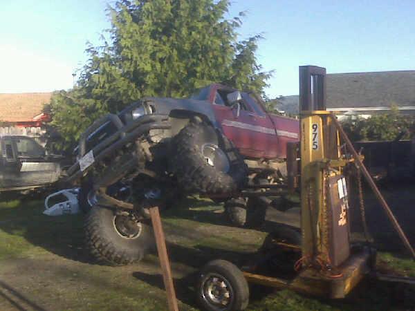

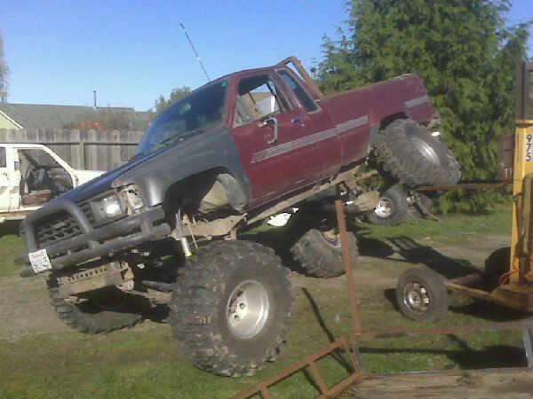

From: Fortuna, CA

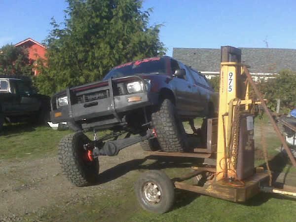

flex sucks tell the springs break in..... sits to tall to should have done the 3" springs. also need to trim body mounts because shackles hit them when flexing limiting flex.
Attached Thumbnails Timmybuilt SAS-l_1d95c697db7141dda8bbd570144192e0.jpg   Timmybuilt SAS-l_9c4055e9e729431295dc31a830ce0ab1.jpg   Timmybuilt SAS-l_6cbc6a9029454e42a99063514120b041.jpg

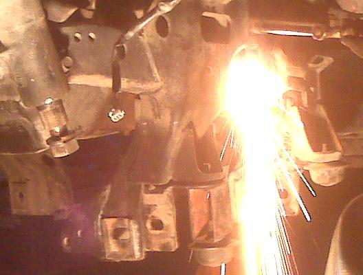

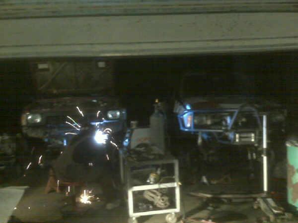

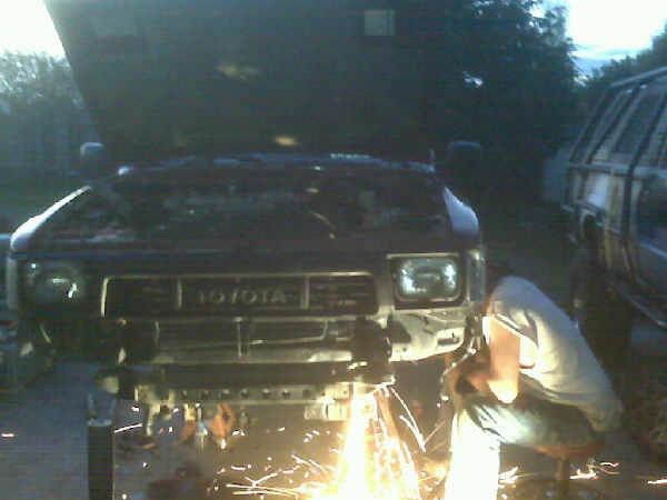

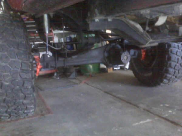

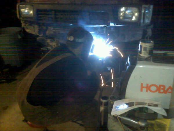

Tim cutting and welding
Attached Thumbnails Timmybuilt SAS-l_2685e908ad63432dbcb89faff570c3d2.jpg   Timmybuilt SAS-l_a1a0cc264ab84197a5e5f5427c367a80.jpg   Timmybuilt SAS-l_f2b08ba93b7f4b0ca4131dedd17e3f66.jpg

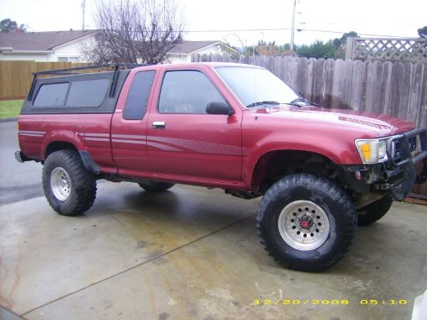

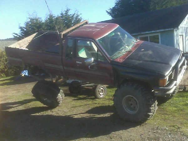

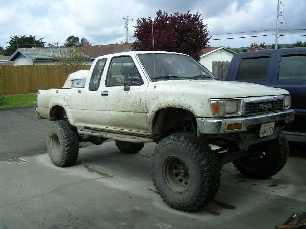

my truck sitting next to my buddies 85 exo'ed runner Tims next big project. It needs new motor, dual casses installed built yota axles and some more stuff installed. Then a pic of my old truck good ol whity.(belongs to a buddy of mine now)
Attached Thumbnails Timmybuilt SAS-l_1da996303fa64b3bb6de3fda8bc3f757.jpg   Timmybuilt SAS-l_b903b2d297b5040023630b99991c970a.jpg

tims yota built a long time ago. he has no computer and made every thing him self. started as a 2wd standard cab long bed now the frame has been extended 9 inches and it has an x tra cab and long bed. SAS done, duel cases, chevy 4.3 swap, 40x18 boggers, 63" chevy springs in rear, 7 in lift springs in front, 3" body lift and lots of other custom stuff! It goes any where and has pulled out most people in humboldt county more than once threw the years.
Attached Thumbnails Timmybuilt SAS-l_2b10bfa67987480dbb78cb2656b28c39.jpg   Timmybuilt SAS-l_5d92b012b7944f60b60cdf99a273c04c.jpg   Timmybuilt SAS-l_28dd11caed8f419b954e4814e3c044b8.jpg

This one turned out a little bit better imo because I fixed the few things about the white truck that bugged me on this one. I got the sliders mounted today and will post some pics of them mounted tomorow. I angled them this time instead of making them a flat step for more protection. Still need to trim my body mounts so my shackles can rotate back all the way and to get more flex.
