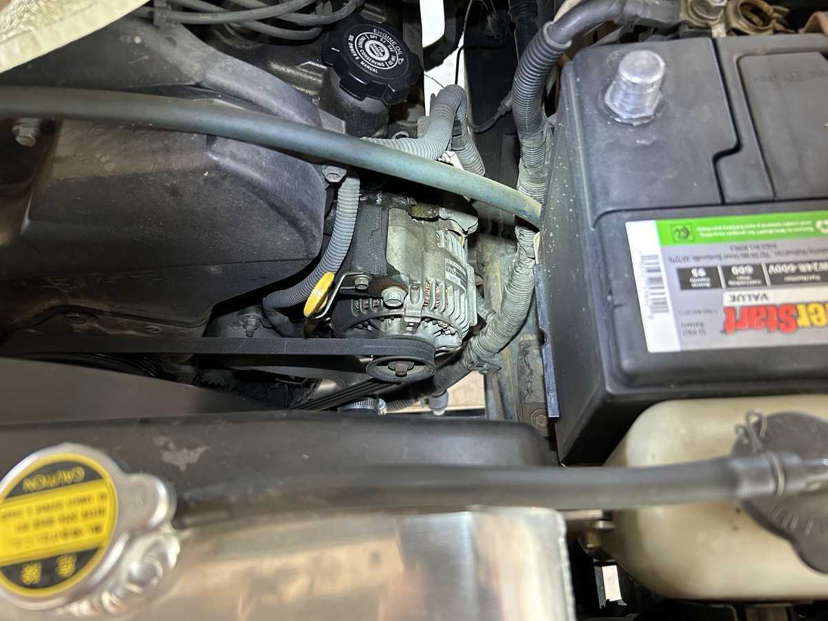

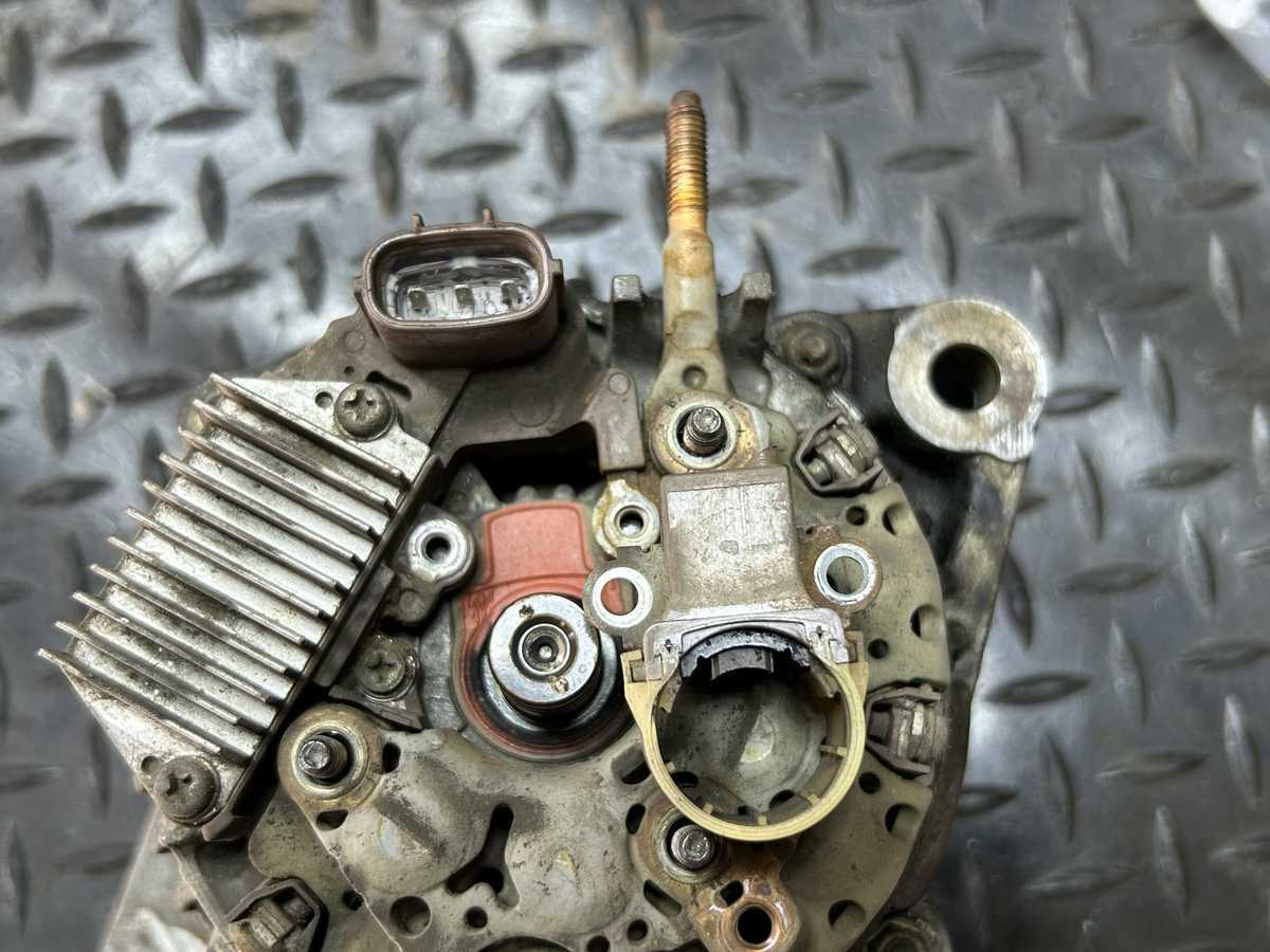

The SAS with the FJ60 flipped housing is working good. Almost 11 years on the SAS and still daily driving it. But just now got a red charging light with only 269,000 miles on the original 25 year old alt.

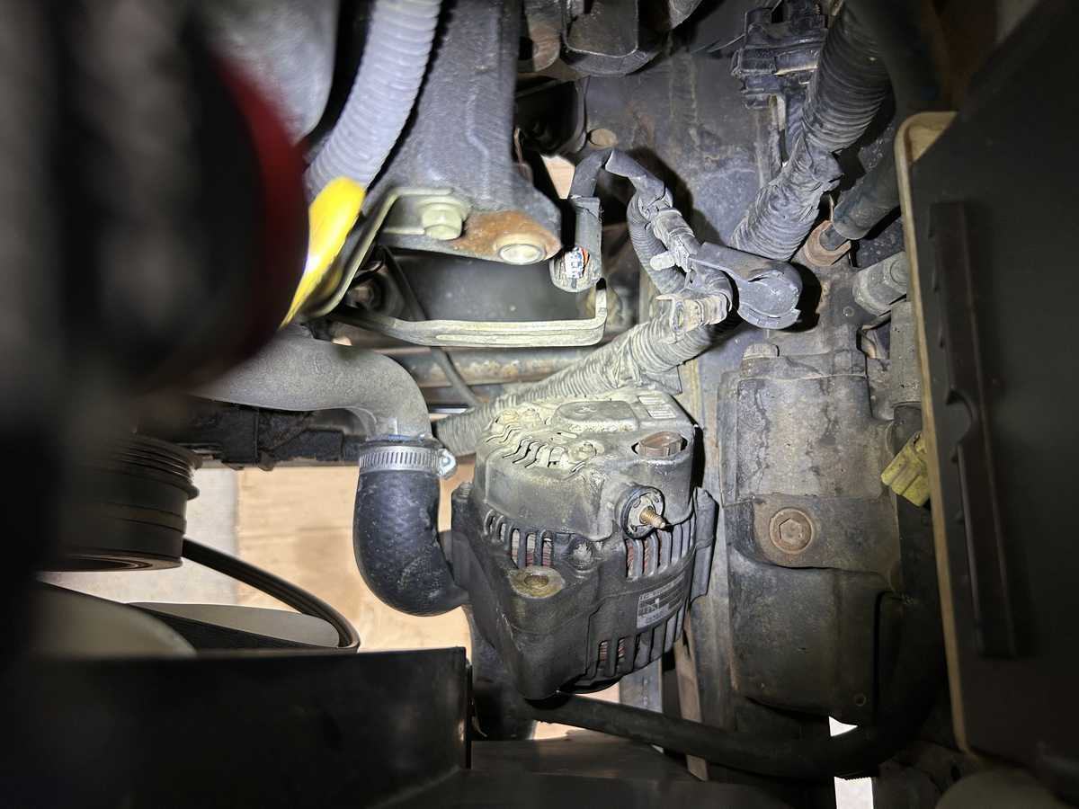

I did tap the alt casing and it started to charge again so that tells me worn out brushes. Of all places, I got the oem part number brush kit on Amazon for about $35 27370-75060 Access to the bolts and wires is good. Battery cable is 1st removed. By the way,,,,Finished the job in just over 1 hour and good now for another 200,000 miles I hope.

No rust on any of the 2001 bolts and removal was easy.

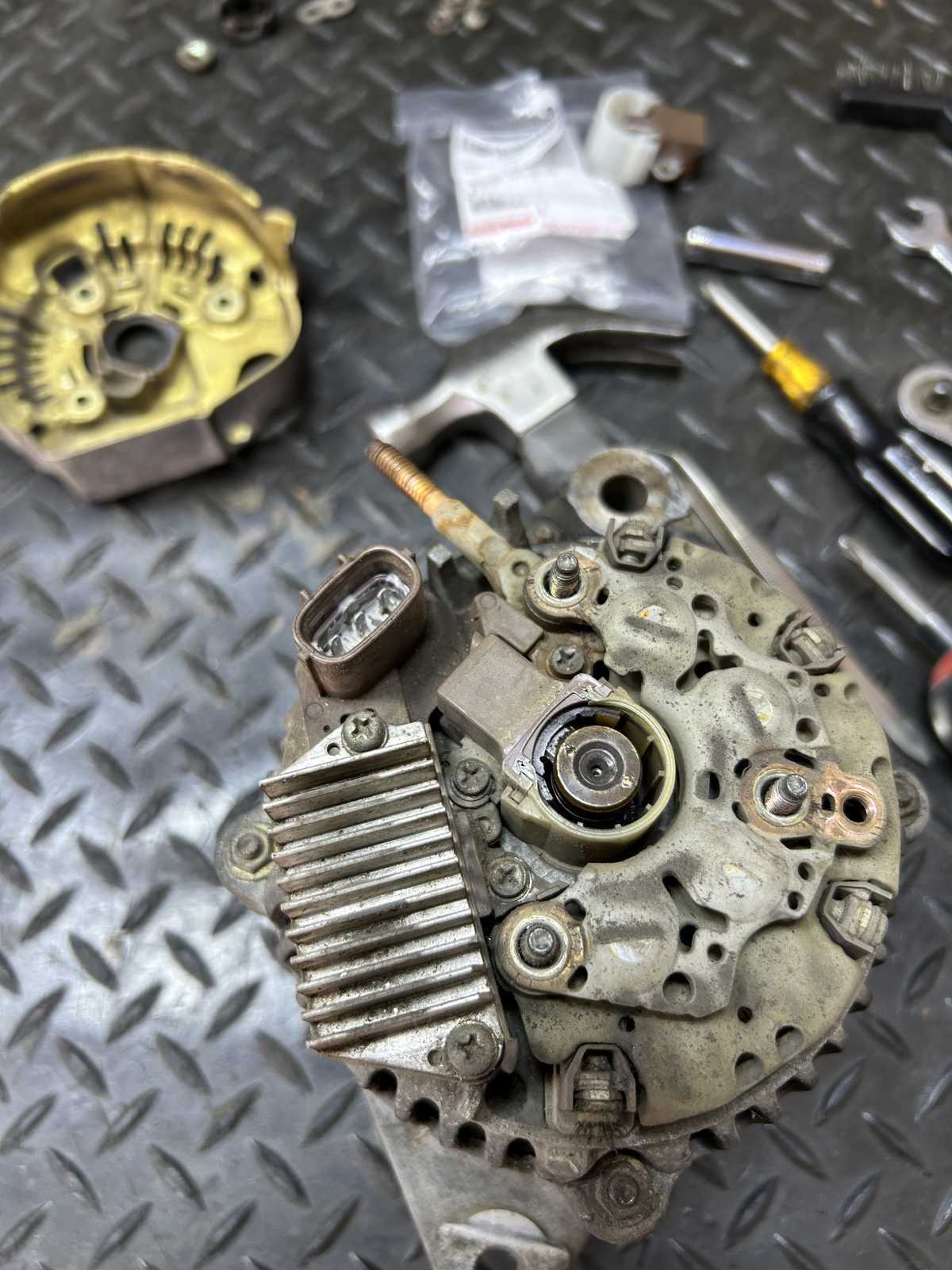

The thin tin cover came off easy and exposed is the brush set. I will remove the 2 phillips and that will fall off.
Old May 17, 2026 | 10:07 AM

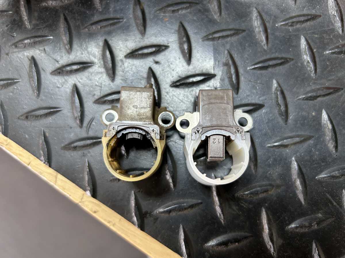

wow....got my money's worth out of that brush set.

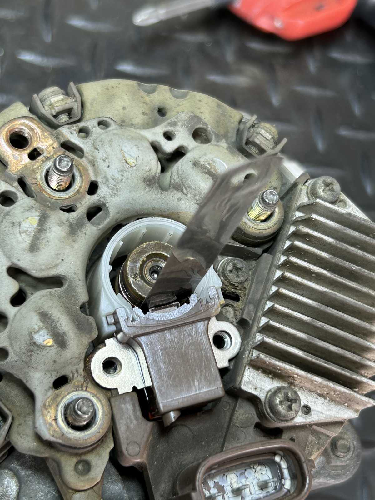

I used a thin .004" feeler gauge to get the inner brush to seat deep down in there. Place feeler in first then slide the brushes down then remove feeler!!

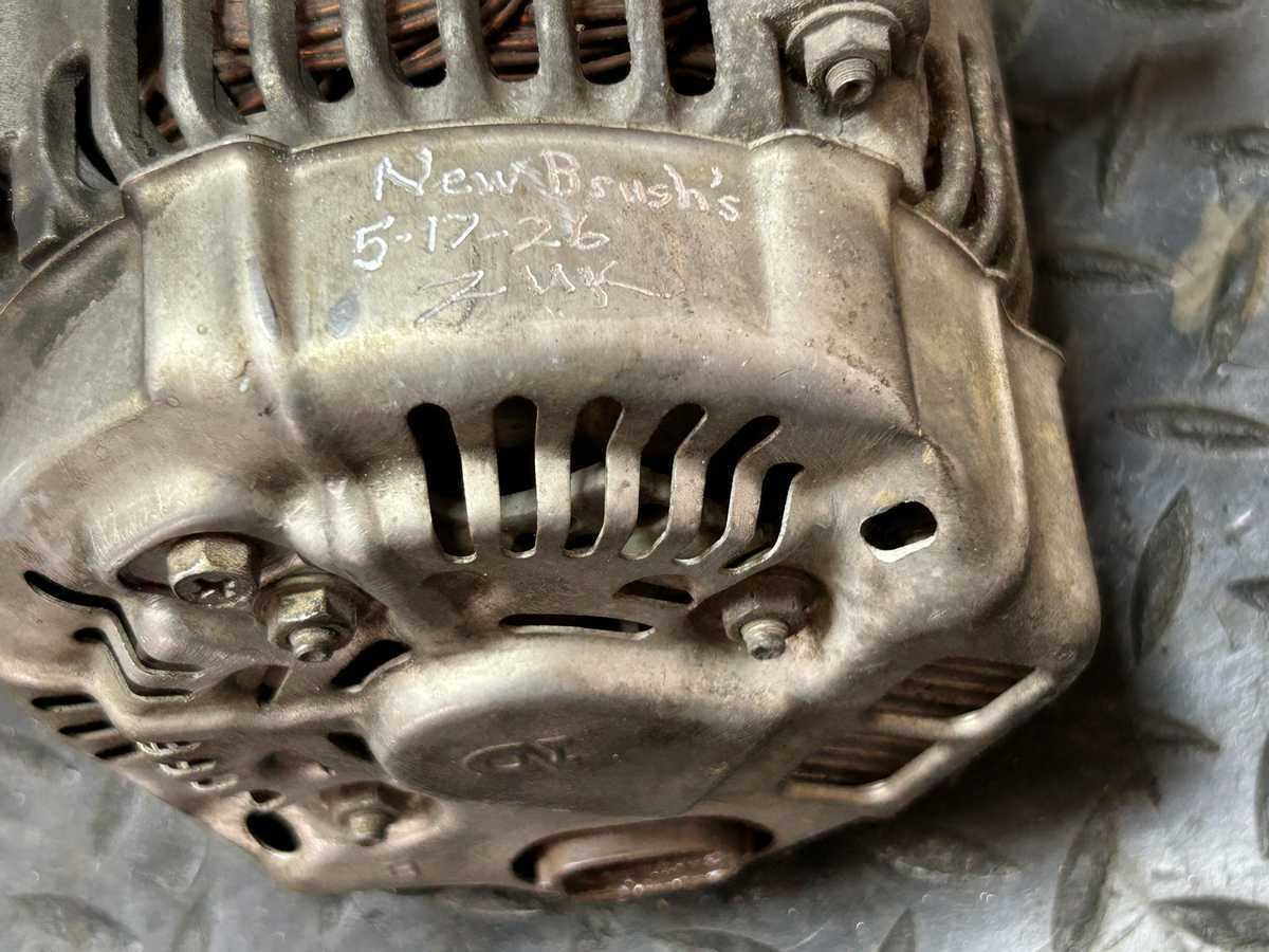

Went back in pretty good.
