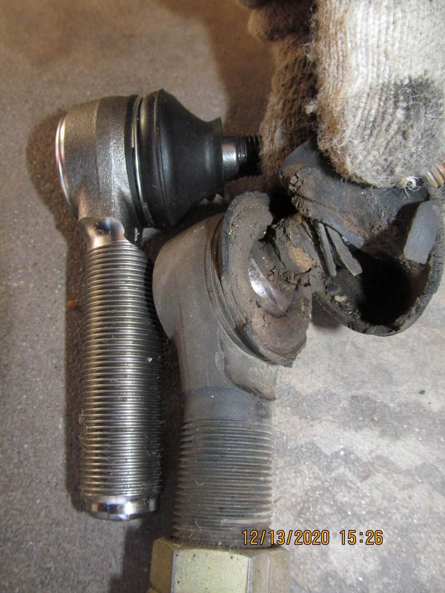

Been just over 5 years that I've been running the Marlin tie-rods on my fresh SAS. When I first got them I thought they were kinda cheap looking and I was right but I still ran them. The cheap plastic boots were tearing almost from day 1. That let dirt and rain in for those 5 years. One of the tie-rods was so sloppy in the ball fit that it was threatening to separate. A call to http://CruiserOutfitters.com and a couple days later I had 4 decent quality tie-rod ends.
The steel threaded rods from Marlin are just fine......don't know if they have the same chinese tie-rod ends or not these days.......
New one up against the one from Marlin.
The CruiserOutfitters 555 brand has a thick real rubber boot. I expect some good life out of these.
I cannot tell you how nice it is to feel the steering wheel tightened up....less wander.....and no clunking over the road bumps. What a difference.
