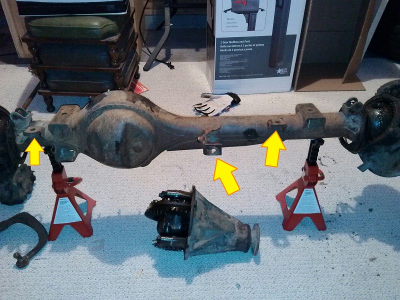

Are these the 3 things I can grind off that are not used in a sas? I will have hi-stear.

Yea, if you feel like it.
Those are from the sway bar, yea? I forget, but I have those brackets anymore.

cut everything cept the perches and shock mounts

and bumpstops

Arent bump stops associated with the shocks?

I already cut off the right 2 pointed to brackets. I didnt see anyone elses sas'd truck with em. I didnt pull this axle so idk what they were for.

Cut off the shock mounts and put knuckle gussets on it so you don't bend it.
