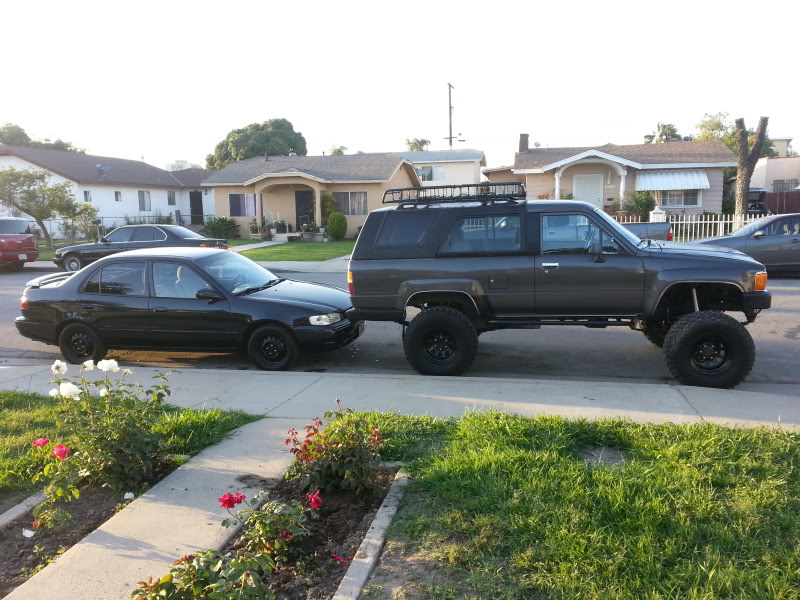

So like i previously said I had the same exact problem with my All Pro 4" lift. One thing I did with my AllPro 4" lift was) add one stock leaf spring to my leaf pack along with the overload leaf and 2 small spacers(all off the stock leafs).
This is what my lift looked like after the 4 inch lift was installed. Brand new springs and still having the rear sag.
I didnt like that major sag issue because I do carry lots of stuff in the bed of my truck from time to time and if I figured it it is already sagging with just the weight of the Hard top, roof rack, and tire on it now then how the heck will it be when I load my truck up with all the camping gear the rear steel plate bumper/tire carrier. Nooo way.... it'll be horrible. So I removed the rear leaf springs. And I took apart my old stock rear leafs.

This is the before and after shots
Before:
and after:
