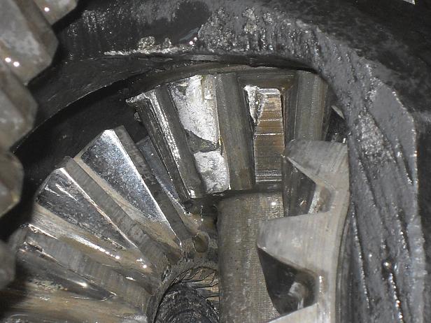

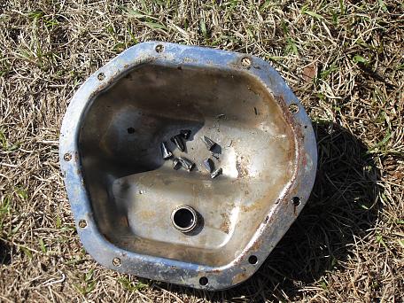

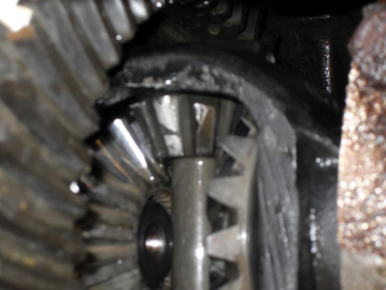

well these are some pics of what it looks like now.
Attached Thumbnails huge problem! 5:38 spline gears in danna 44-sdc10611.jpg   huge problem! 5:38 spline gears in danna 44-sdc10610.jpg   huge problem! 5:38 spline gears in danna 44-sdc10621.jpg

yep get a locker, try aussie they are cheap, well built units and i'm sure they have a number of options for a d44

get a lunchbox locker as long as the ring&pinion are still in good shape jesus!
