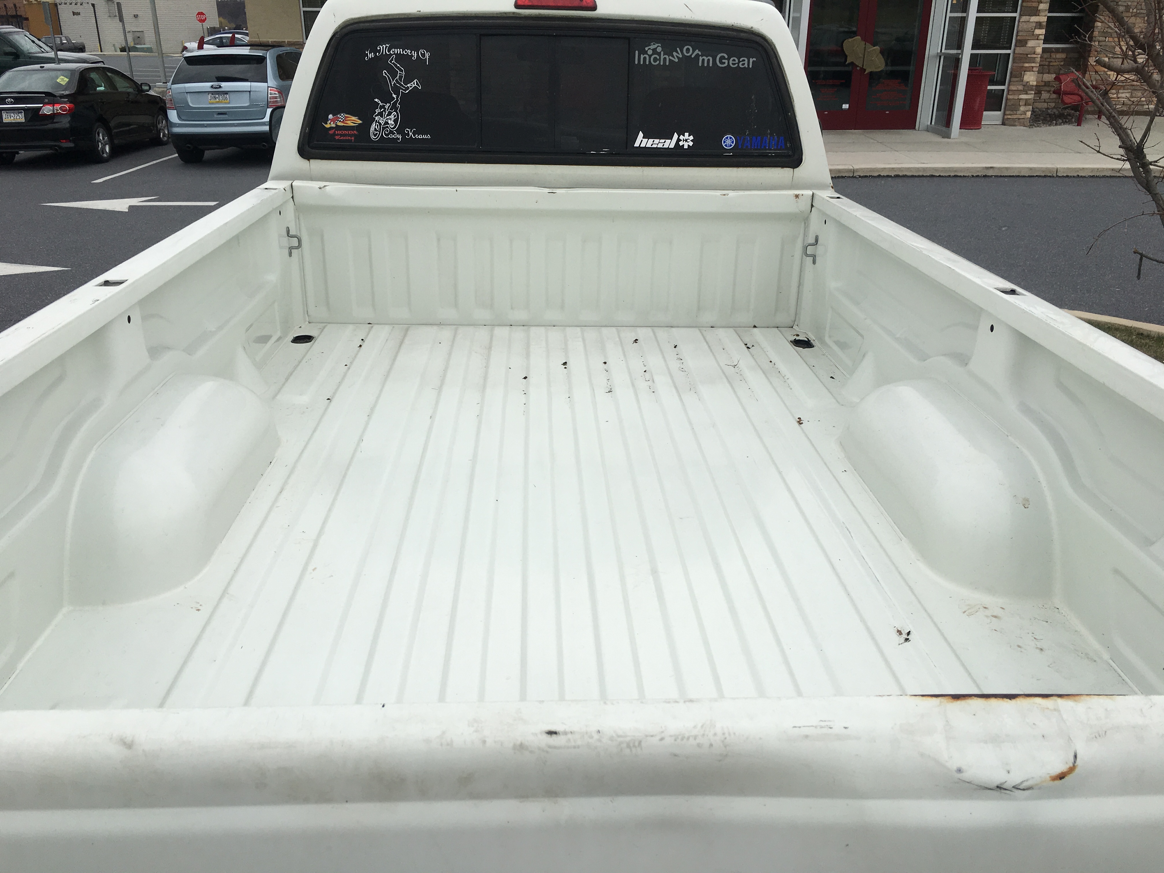

And here are some photos of a clean take off bed i bought!
Attached Thumbnails toyota t100 sas-img_5252.jpg   toyota t100 sas-img_5253.jpg   toyota t100 sas-img_5254.jpg   toyota t100 sas-img_5255.jpg   toyota t100 sas-img_5257.jpg

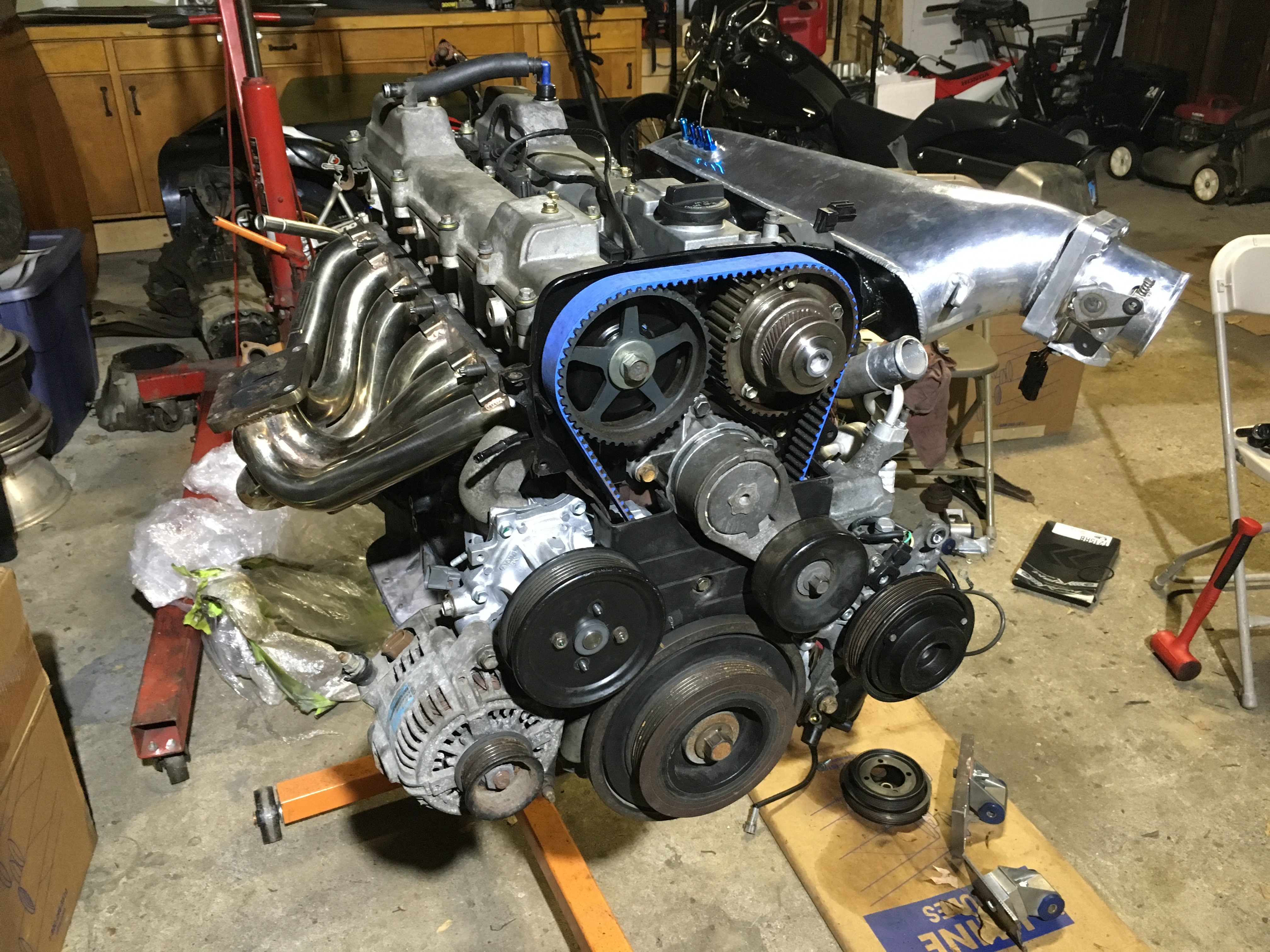

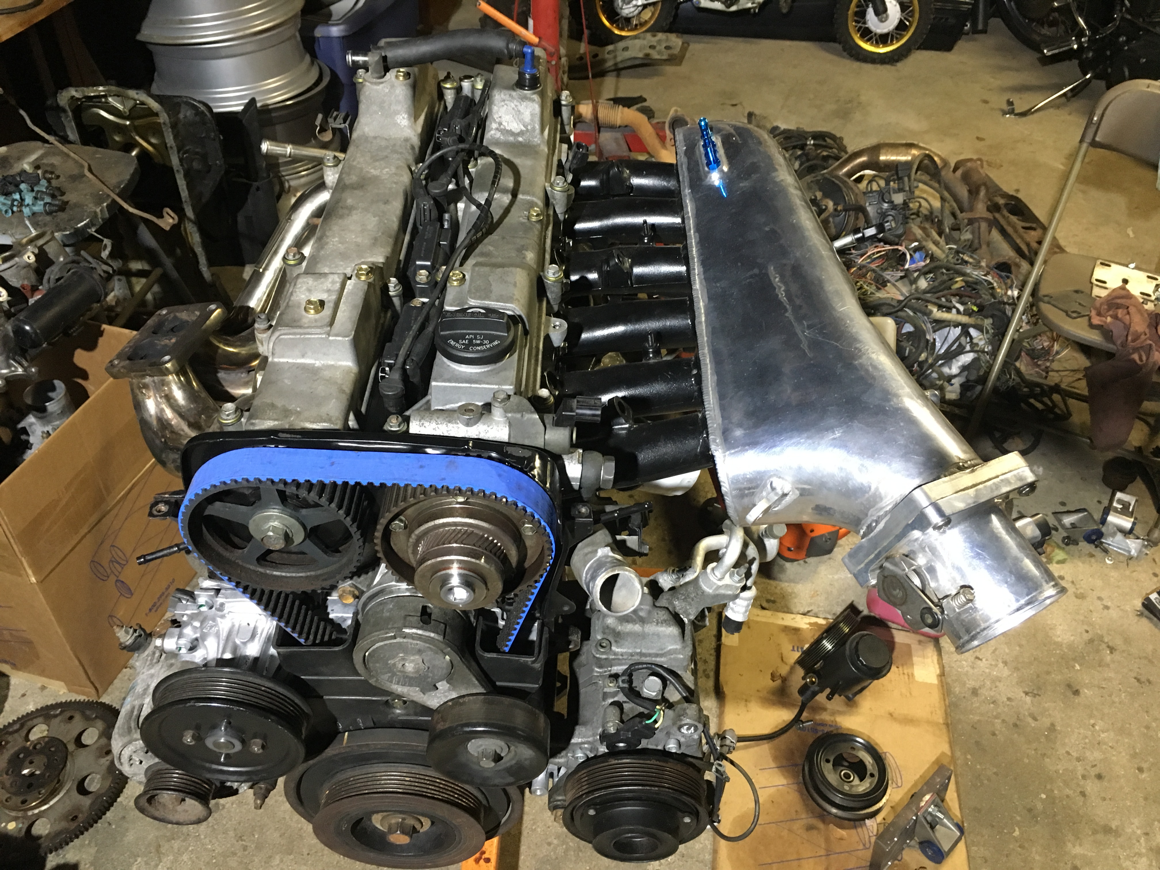

And here are some photos of the 2jz 😈😈😈
Attached Thumbnails toyota t100 sas-img_6871.jpg   toyota t100 sas-img_6872.jpg   toyota t100 sas-img_6874.jpg   toyota t100 sas-img_6875.jpg   toyota t100 sas-img_6880.jpg

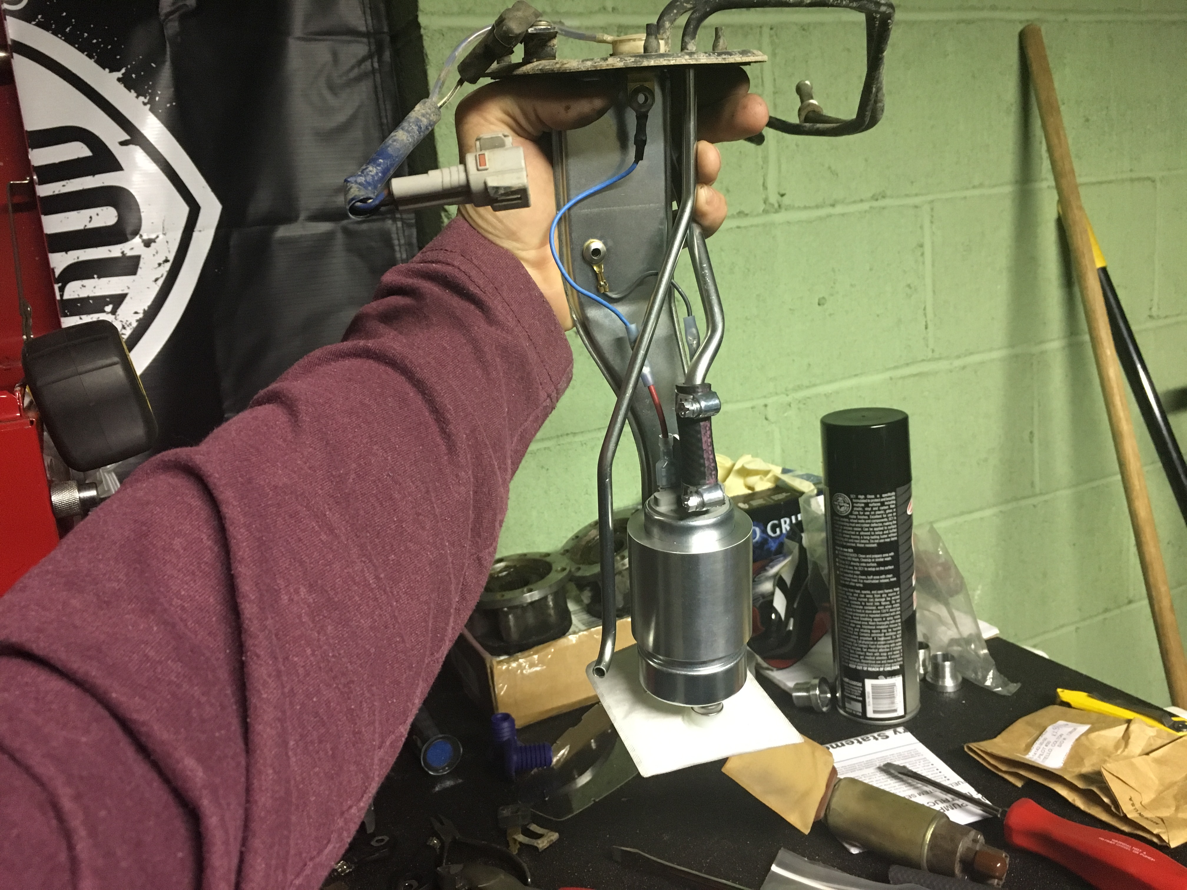

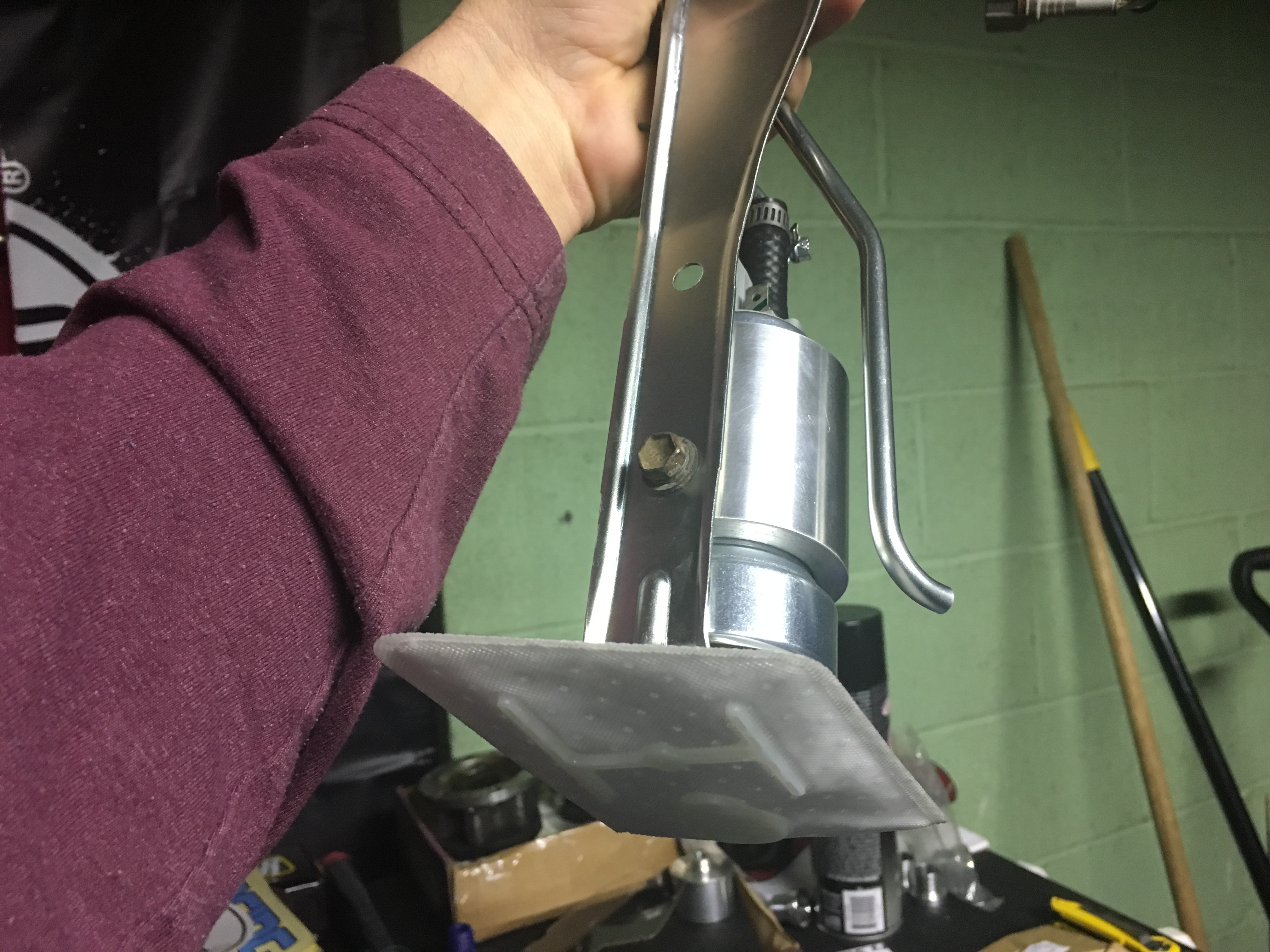

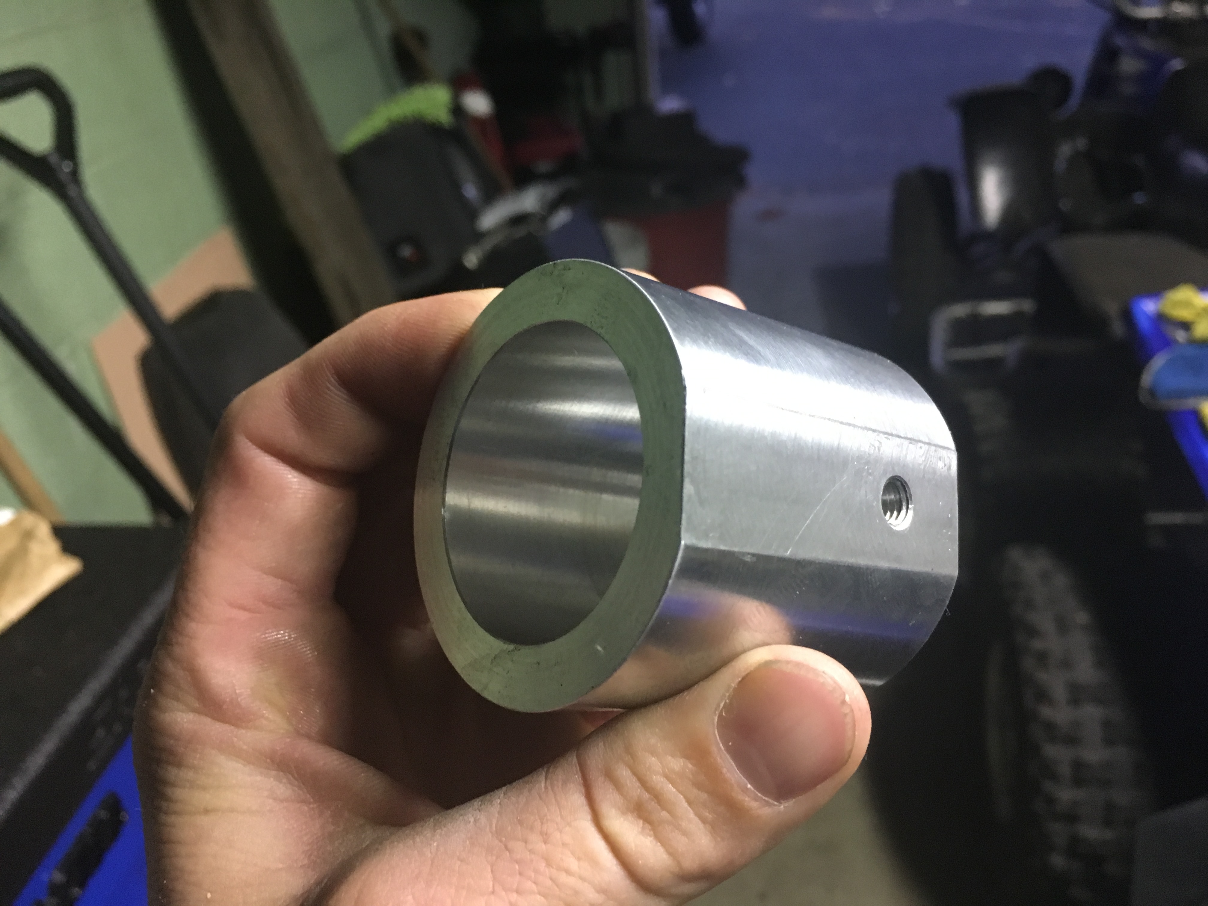

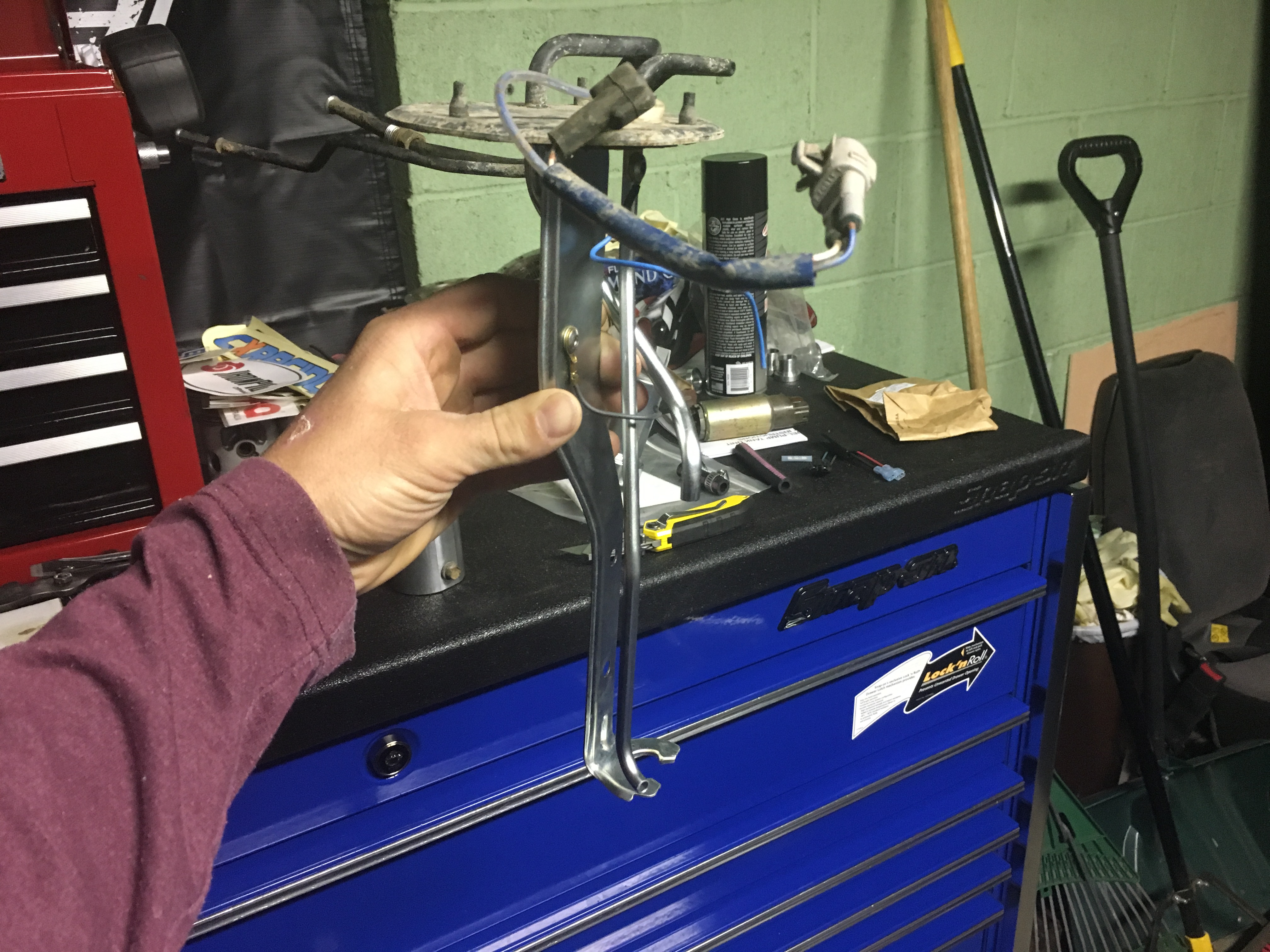

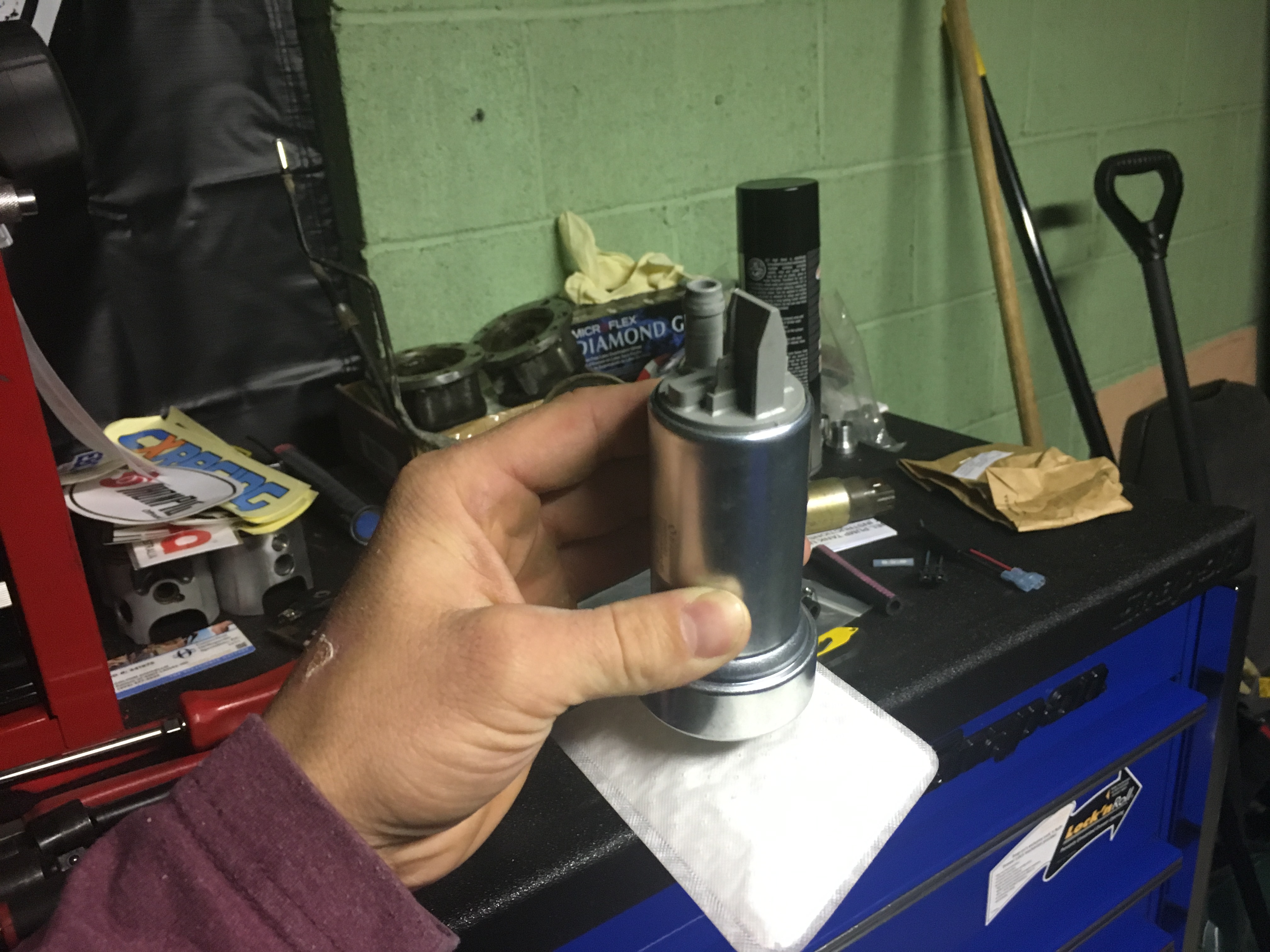

So i got working on the fuel pump today
machined out a collar at work to hold the walbro 450 in place on the factory fuel pump bracket
Attached Thumbnails toyota t100 sas-img_6934.jpg   toyota t100 sas-img_6933.jpg   toyota t100 sas-img_6932.jpg   toyota t100 sas-img_6936.jpg   toyota t100 sas-img_6937.jpg

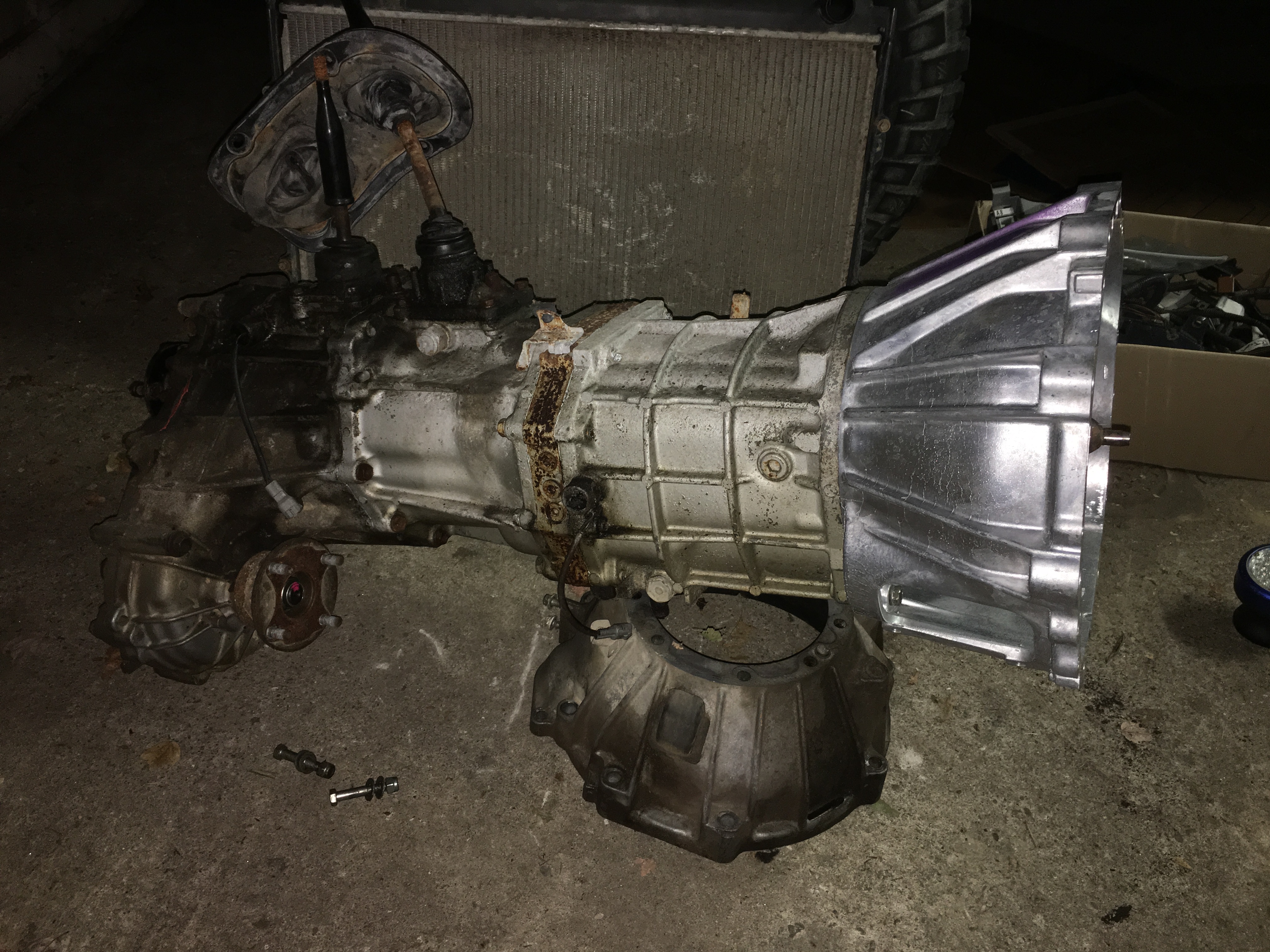

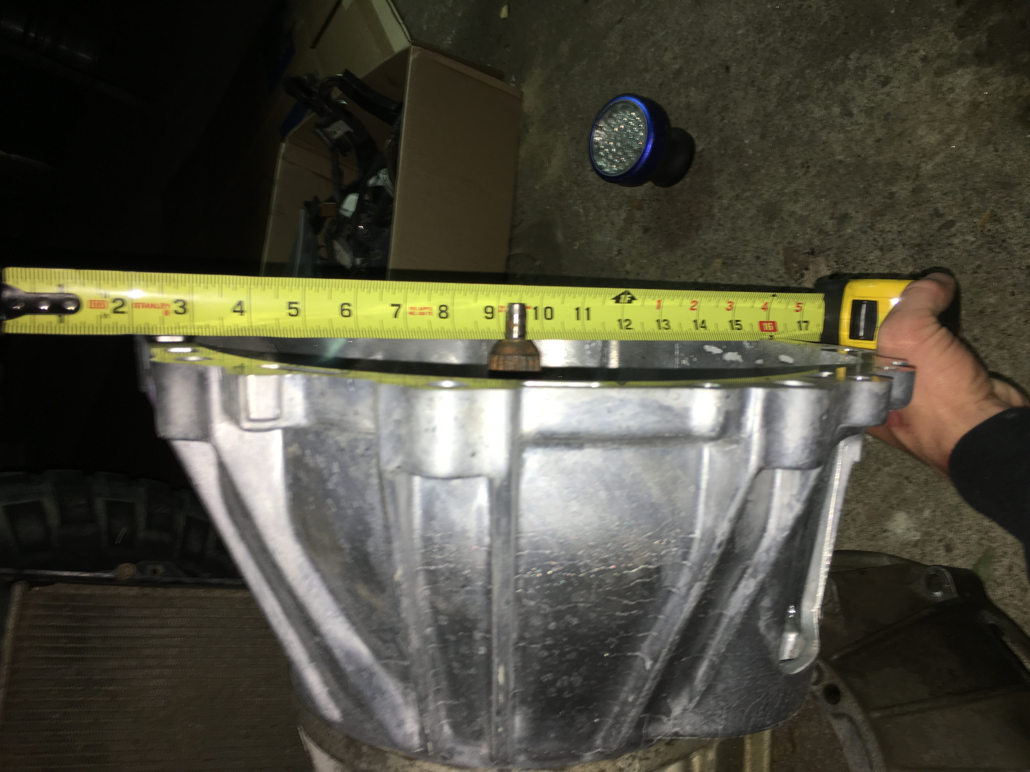

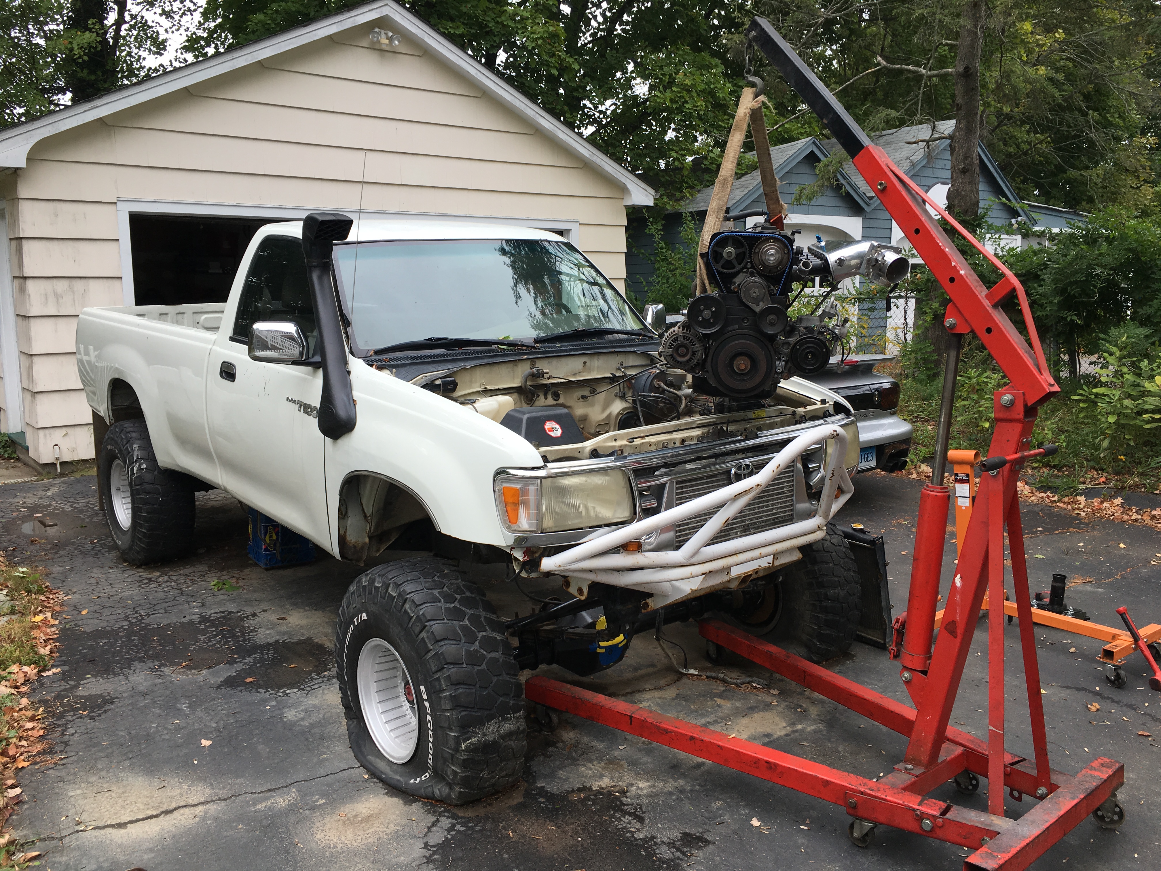

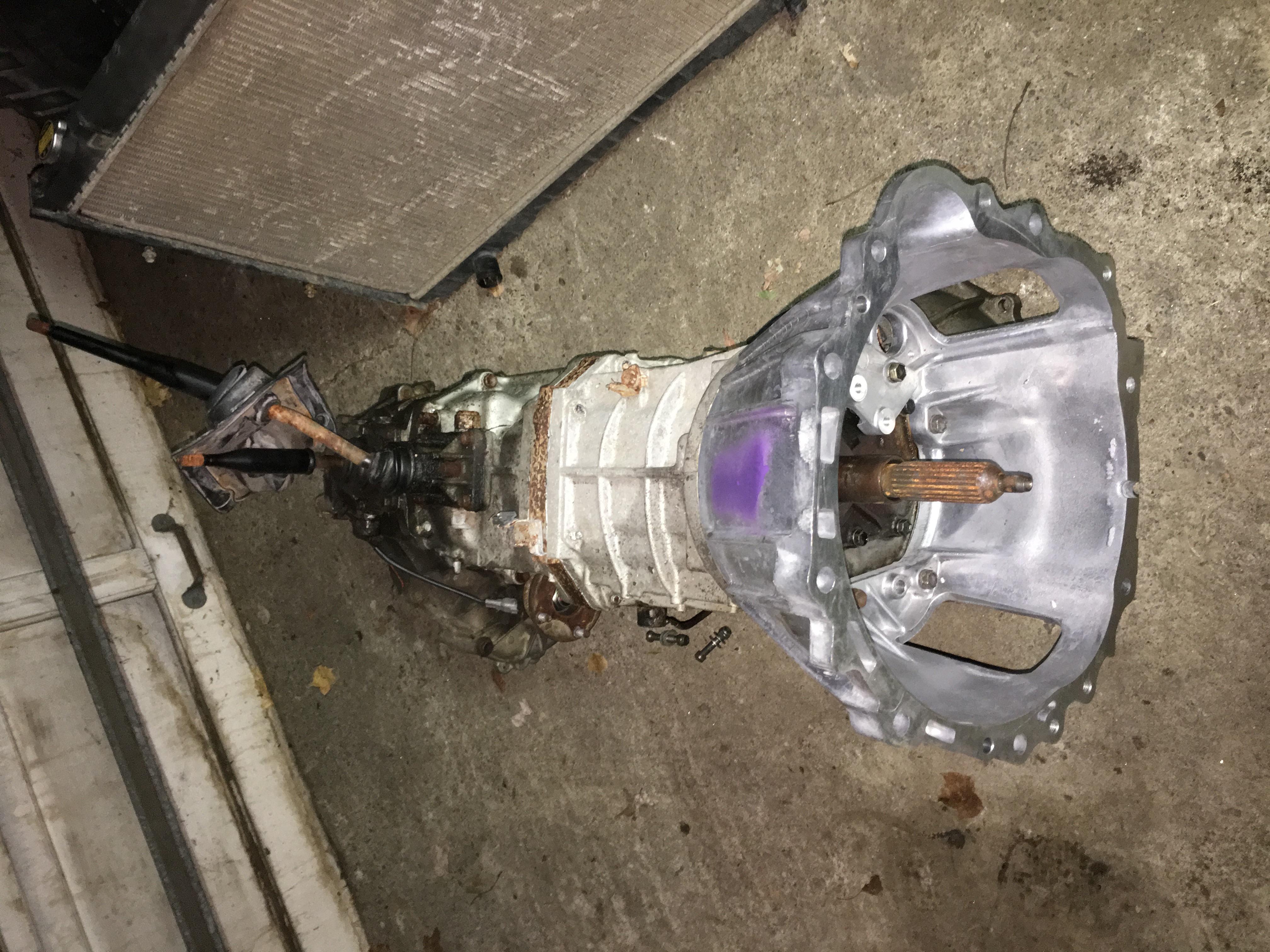

Bellhousing
Before i even started this 2jz swap, i have done a lot of research on 2jz's in general and what i need to do for my best interest. The problem i kept running into is how would i mate a r150f tranny to the 2jz engine. There was a lot of debate on this topic in different forums saying you need to cut and splice 2 bellhousings together or others saying even with the 5vz r150f, the input shaft is still short for the 1jz r154 bellhousing but no one had any real hard evidents that it wouldnt work.
I already knew that the 3vz r150f input shaft is short and you need to cut and splice 2 bellhousings together to make that tranny work but i wanted to avoid doing that at all cost if i could help it. Knowing the 5vz r150f input shaft is longer it was time to do research!
After a solid week of searching the forums and not coming up with an answer i was looking for i decided to call around for some info. I called marlincrawler and told one of the guys what i was doing and he honestly didnt have an answer for wether if there was a way to pair the r150f to the 2jz. It was the same story with a couple of other places i called too. I then took a different approach and called around for some input shaft measurements on a r154 just to see if it was at all the same length as my 5vz r150f. Sure enough i called driftmotion and spoke with a fella named aaron and he gave me some measurements of an input shaft from a r154 he had sitting on his bench. Turns out the r154 and 5vz r150f have the same input shaft lengths!!! So yes, a 1jz r154 bellhousing paired with a 5vz r150f tranny will work with no worries of having a short input shaft with bolting to the 2jz. That means no cutting and splicing bellhousing together just to run a r150f yayyyyyyyy!!!
ordered me up a bellhousing from driftmotion and here are some pictures of it installed on the 5vz r150f
Attached Thumbnails toyota t100 sas-img_7235.jpg   toyota t100 sas-img_7236.jpg   toyota t100 sas-img_7237.jpg

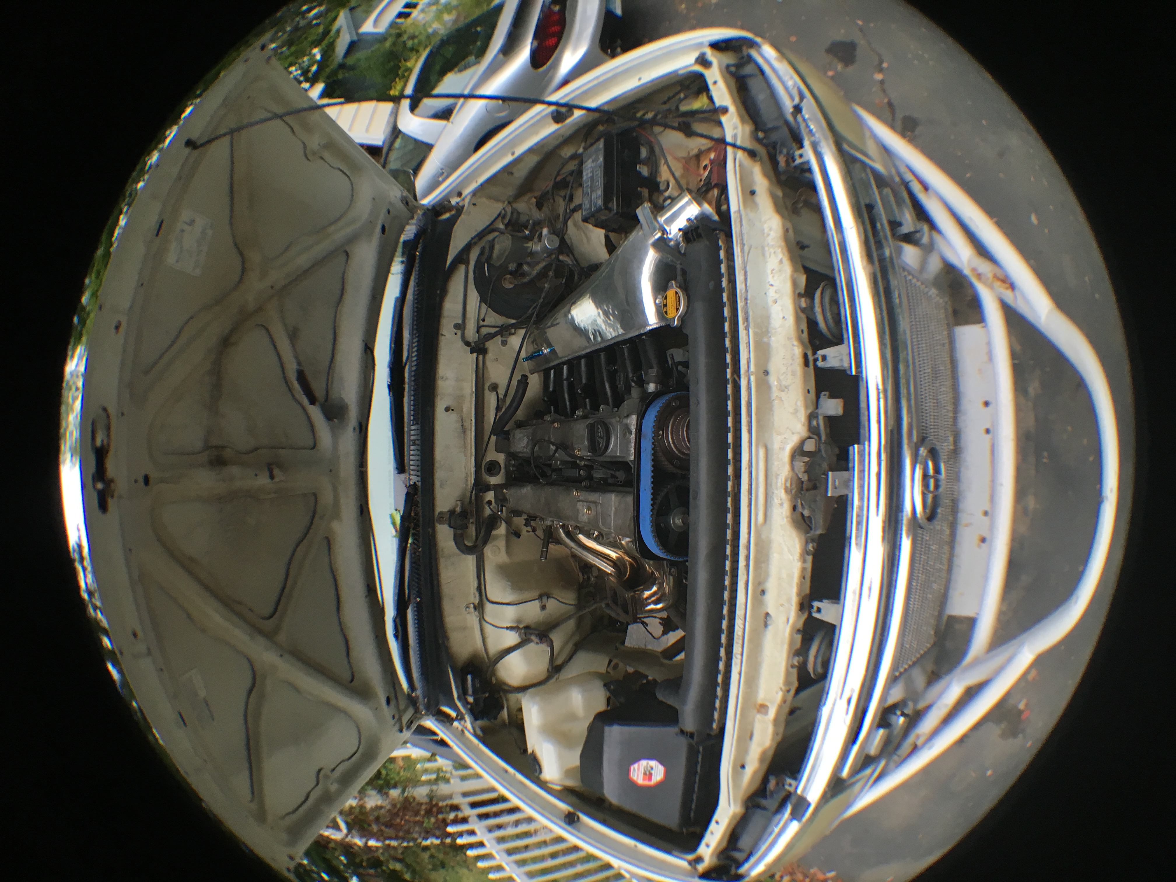

2jz goodness
I haven’t posted up in a while so i’ll update this for anyone interested or even still uses this forum. It’s been over a year and 25k miles of daily driving with the 2J swap and everything is holding up great! Had to fix a few things during the journey so far as all the extra power is finding my weak spots Had to fix the engine mounts on the frame a few times and brace the frame in the back (started to rot from the inside out). Other than that, everhthing seems to be pretty solid. Axles been holding up great to the power (470hp @20lbs of boost, currently running 25lbs so i guesstimate around 500hp now?) R150f took a ˟˟˟˟ in the beginning, had over 300k miles on it so i replaced it with another R150f.
During the summer months of 80°F-100°f the truck did great and stayed cool for the most part. Started to get hot on me a couple times but that was due to one of my radiator fans dying.
Hoping to travel around the country and camp with it this coming year 2020! Still working out all the minor stuff
