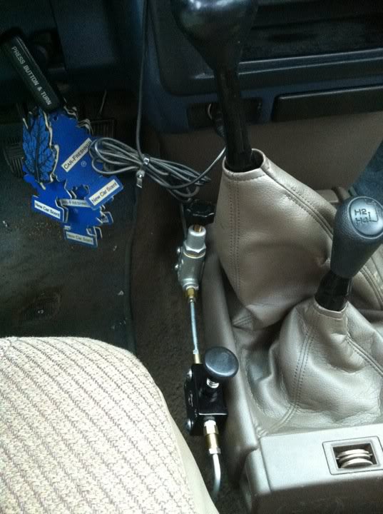

installed a proporting valve and line lock for the disk set up

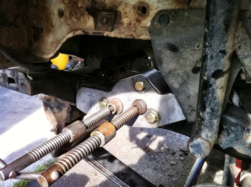

installed marlin's HD steering reinforcement frame plates

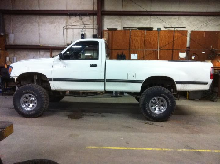

removed the body lift finally

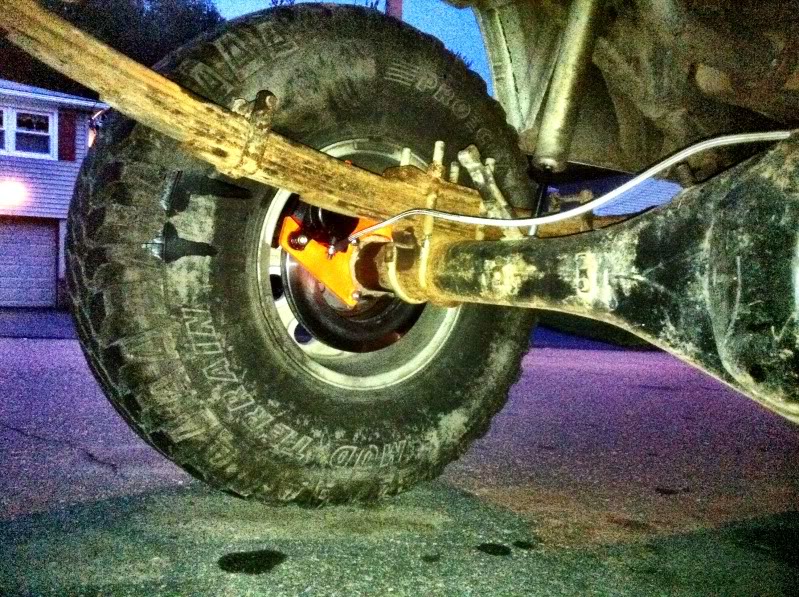

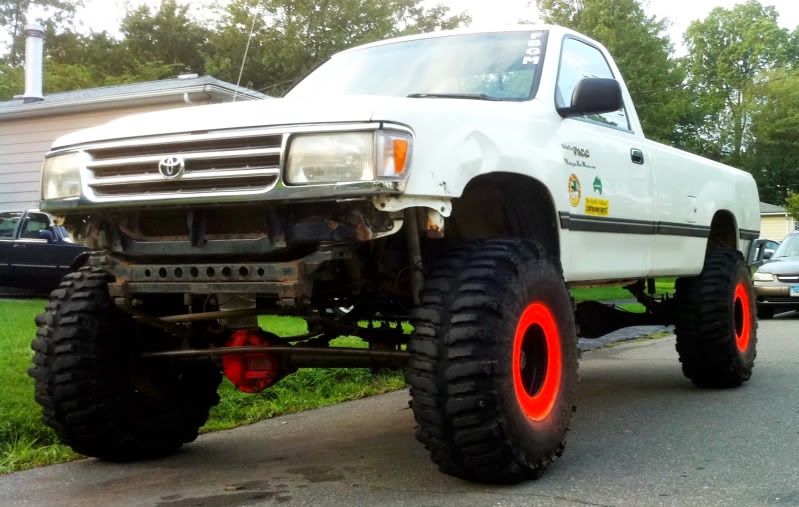

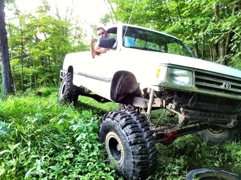

finally bought a real set of tires on some DIY beadlocks there 37" boggers...
decided to paint them florescent orange

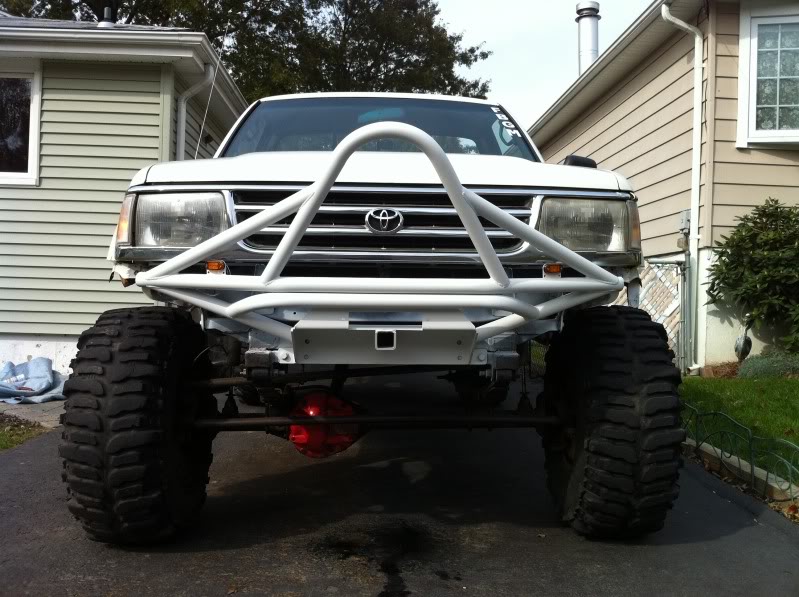

and this is my favorite mod so far!!!! bought the T-G front bumper and modified it to fit my truck

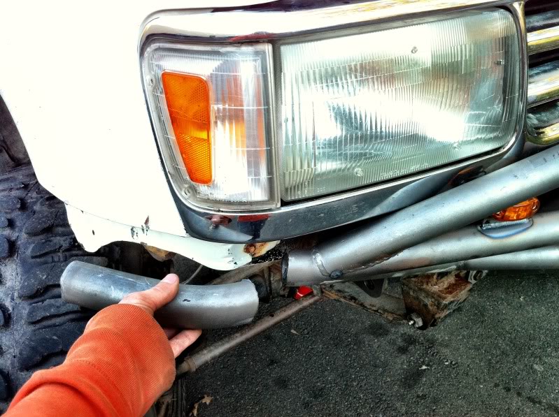

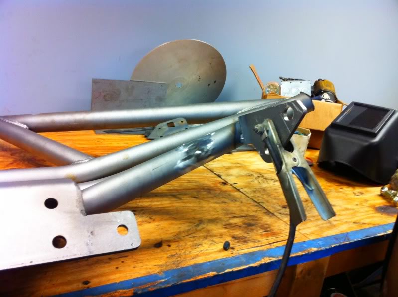

had too cut and relocate the mounting plates
also had to cut the ends off cause the T is wider then the bumper was designed for

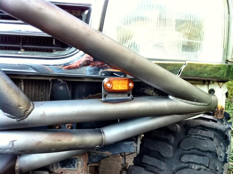

got the weld on blinker kit from T-G for that nice clean look

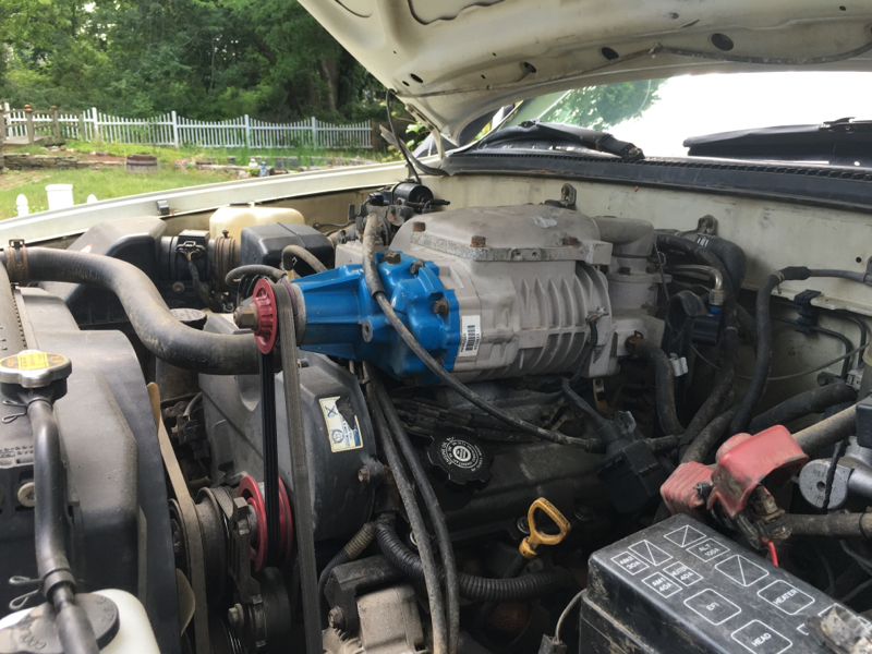

I had an itch for power after the SAS and the 3.4 wasnt satisfying my need. I then hunted down a supercharger and ended up getting a 1st gen. (grey) supercharger for cheap. I rebuilt the nose and replaced the bearings that supported the rotors. I bought URD's 7th injector kit and it was plug and play. Yup that easy to install! Power was awesome compared to not having a boosted 3.4, suddenly i didnt have to down shift going up hills. The torque was awesome.
After adding the supercharger i found myself beating the piss out of it everywhere i drove the thing. Did good 1st and 2nd gear bakers too😉.

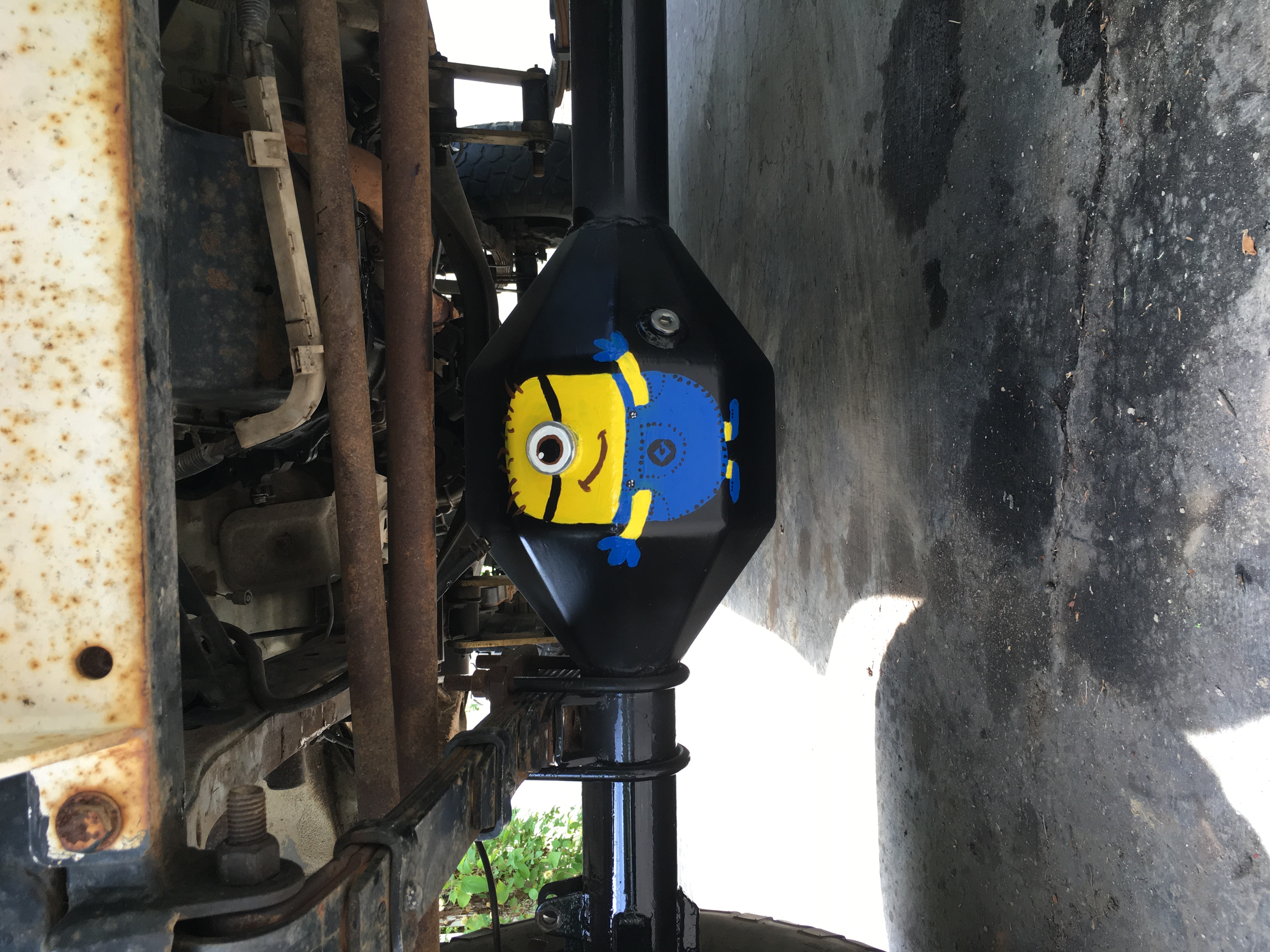

But with adding all that power i kept blowing up my stock 8.4 diff. After blowing up three diffs i was fed up with it and bought an 80 series 9.5 full float rear axle to swap in. I added 1.25 wheel spacers to get the width i needed and did 5.29 gears with a detroit locker. I was already in the middle of building another front axle to swap in place of the dana44 and knew id be going with 5.29s anyways so it kinda worked out instead of buying 4.88 to match the ˟˟˟˟ty dana44.

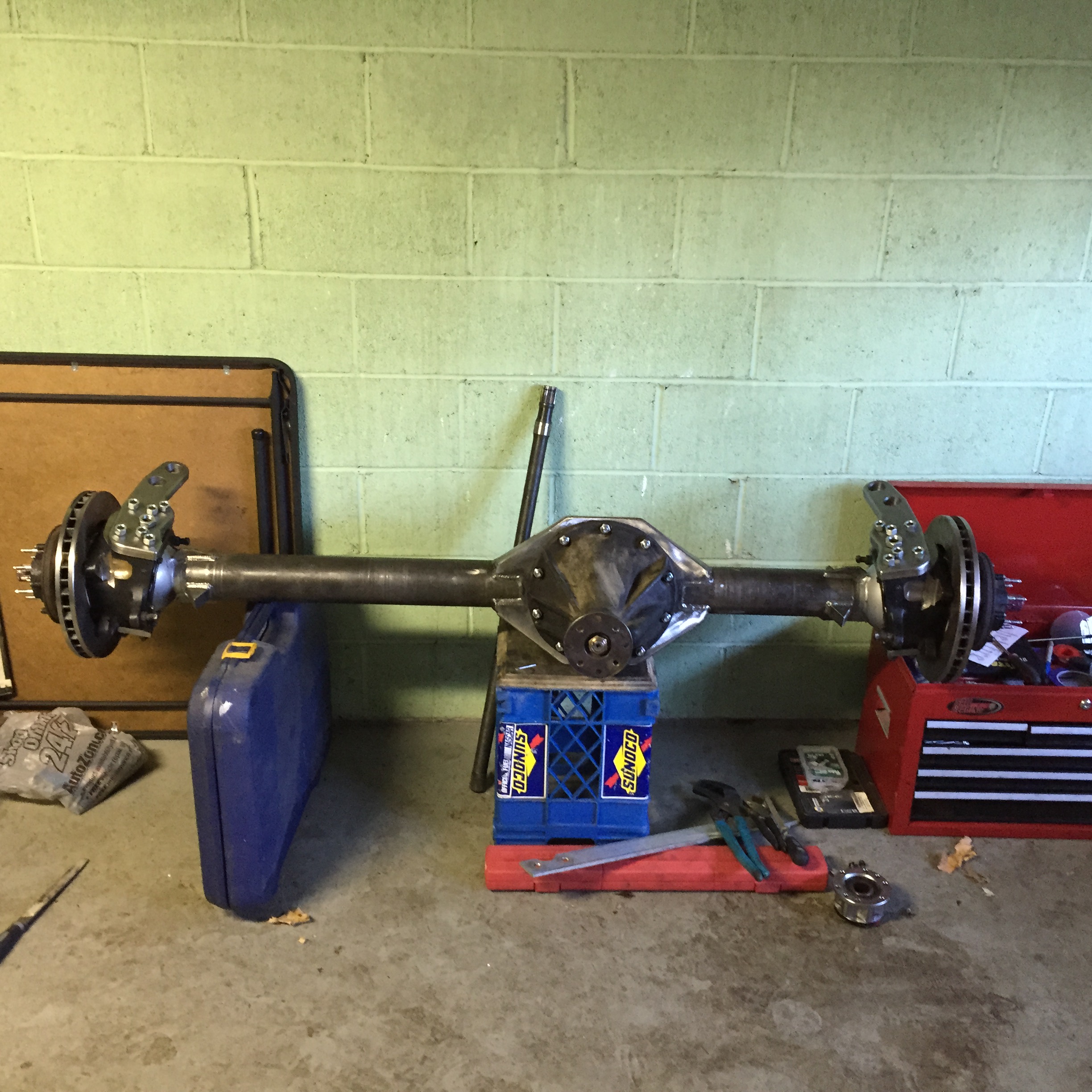

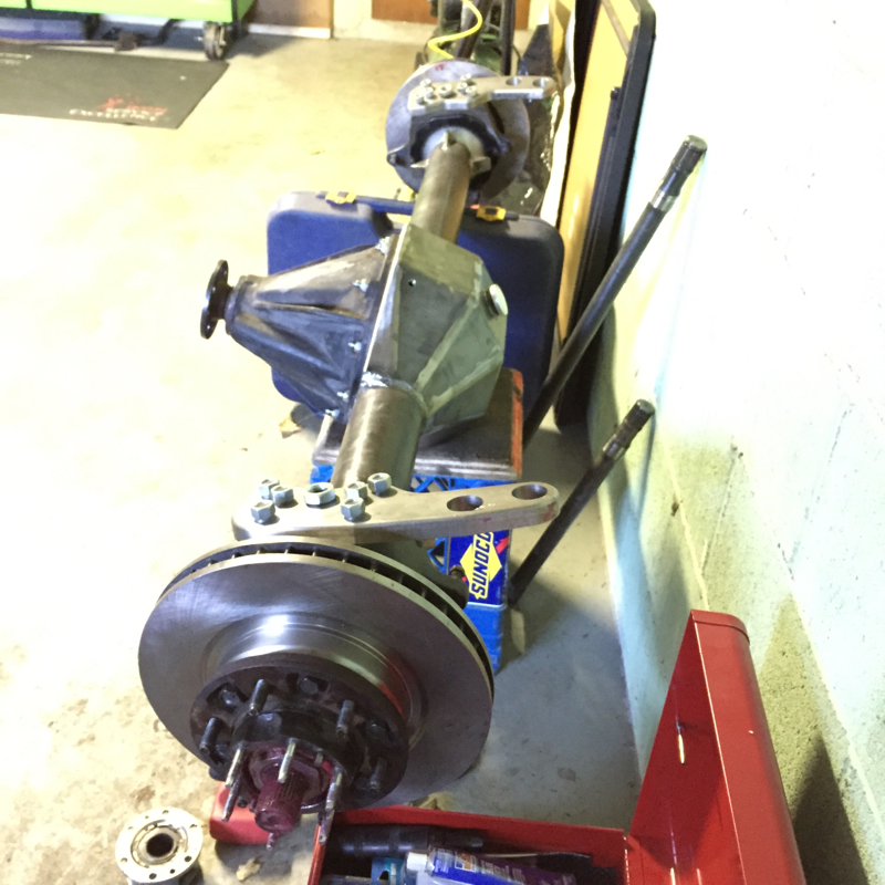

Speaking of the dreaded dana 44 front axle🙄.....i was sooooo tired of snapping axle shafts, u joints, going threw wheel bearings, trying to hunt down axle shafts for a gm dana44 (god damn near extinct), and the fact that i was stuck at the gear ratio 4.88 which sucked! (the highest common ratio between domestic and yota axles is 4.88). Finally just said F-it and spent the money for a custom diamond axle. Probably the best money ive ever spent to date on the truck and dont regret it at all! I wanted something strong as hell but still remain 6 lug. With tons of research and money this is the front axle i ended up with:
Brian made me a full width housing with a 9.5 LC center section and 80 series LC outter knuckles to top it off, i even had him add gussets to the knuckles. He also include some nice chromoly inner axle shafts. I then bought hellfire fab's steering knuckles to keep the steering nice and tucked away and an 80 series 9.5 third member paired with 5.29 gears and a detroit locker to match the rear😁

Here pic with the supercharger installed

The front axle🙌🏻
Attached Thumbnails toyota t100 sas-image-524946644.jpg   toyota t100 sas-img_2902.jpg   toyota t100 sas-img_6167.jpg
