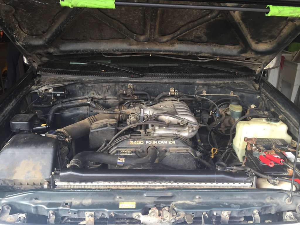

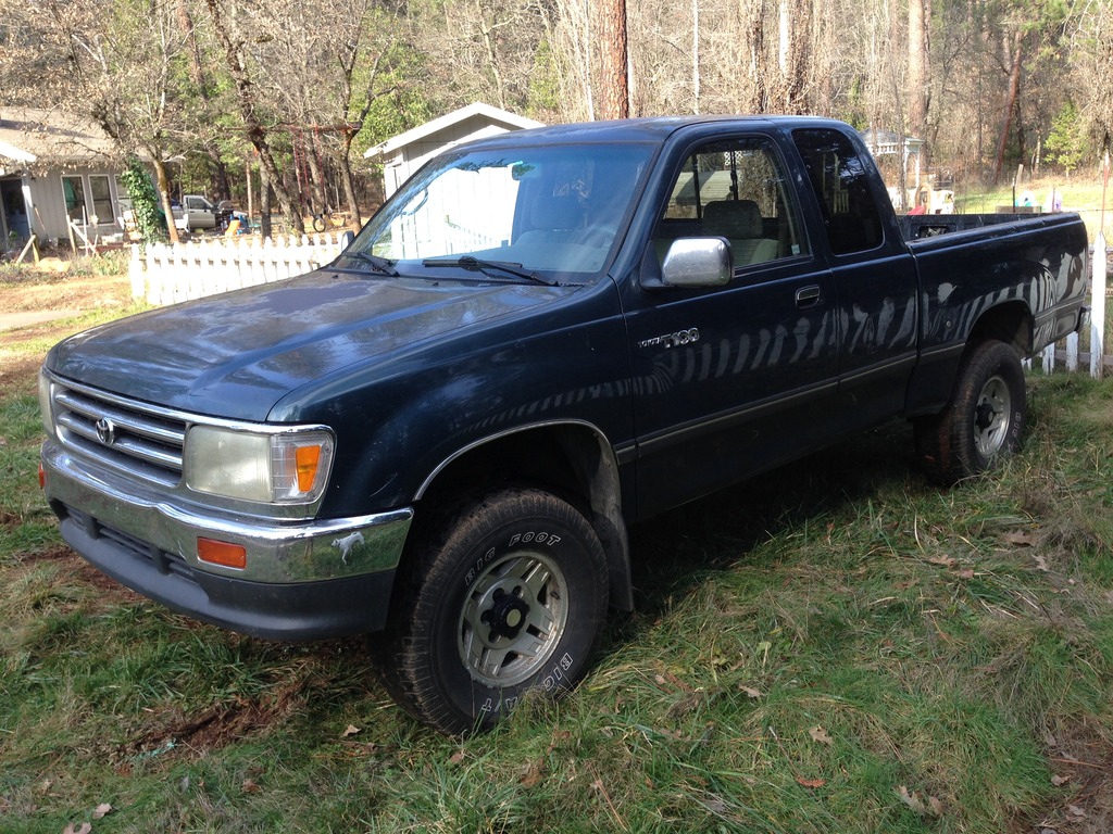

so this is going to be a REALLY slow build because of work and the holidays and 3 kids but i figured i would start posting pictures of the starting point and the parts as they roll in.
so this whole adventure started last January when i was cruising craigs list for toyota parts as always and i found this guy selling a t100 for parts-$500. so i called him up because he was local and he starts to tell me the rear end is blown and they quoted 3200 to fix it so he is selling it for parts. I ask if i need to bring wheels or a come-a-long with me to get it on the trailer if i come look at it and he says no, you can drive it right on in 4wd. he said at the time it had been only out of registration about 3 weeks!

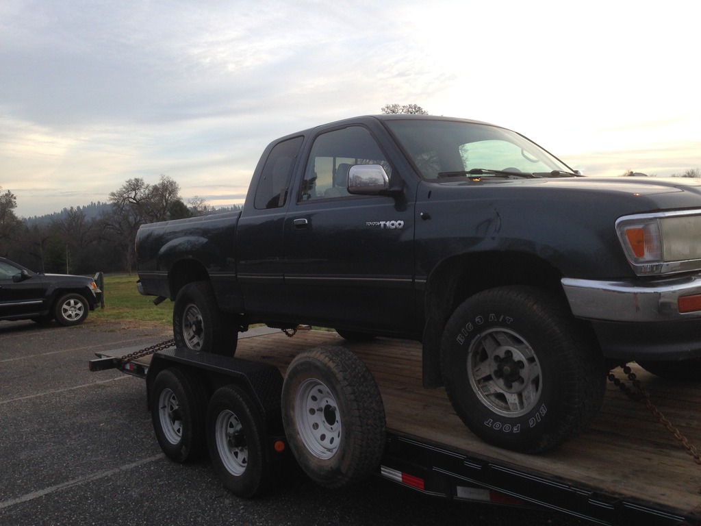

so i show up to a pretty beat t100 with 366K on the clock but she fires right up and goes though the gears and drives around his yard in 4low just fine. so i give him $460 bucks and start to load up:
so it also had some excessive moisture from the tailpipe and i know these are prone to head cracks so i decided to let a friend of mine tear into it and see.
regardless i think it was a pretty good deal. I have always wanted a t100 and i have always loved the 3.4 and 5 speed combo so with some polish it should be a nice little stock driver......

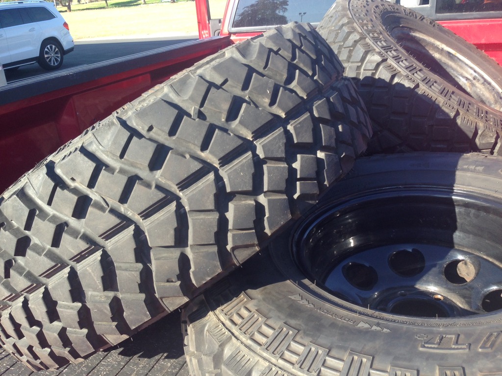

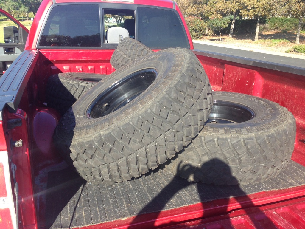

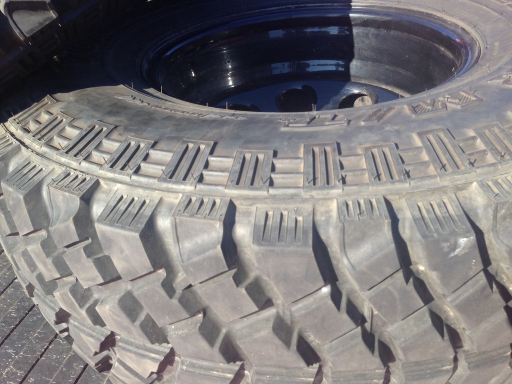

picked these up last weekend for 1100. 37x12.5-R17 yokohama geolandar m/t's and some steel 17x9's with the toy bolt pattern, still need to measure backspace but i can work with that.

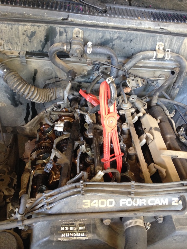

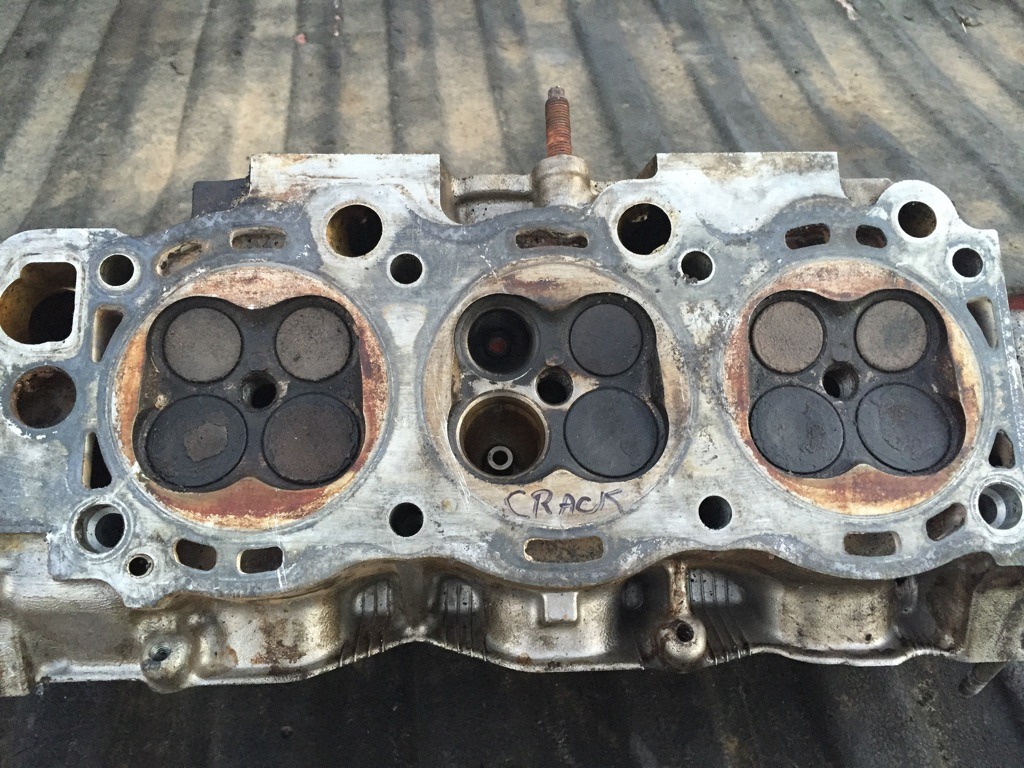

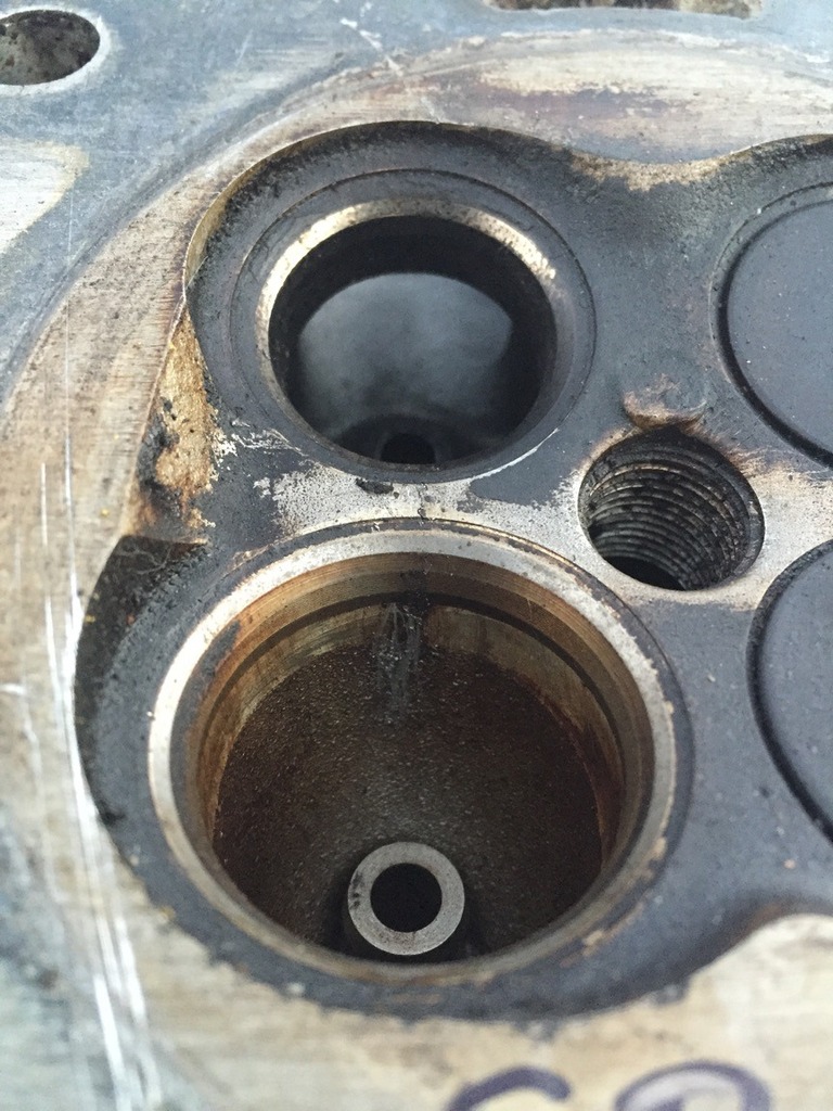

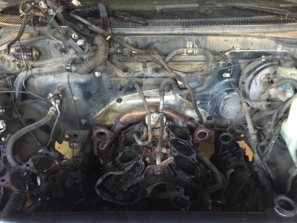

so my friend Ray dove intot he motor and found what i had suspected, cracked head on the passenger side. luckily i have another friend that sold me a good passenger side head for 100 bucks.
File Type: jpg
Old Nov 11, 2016 | 08:09 AM
ryantowry_81's Avatar
Posts: 674
From: Grass Valley, Ca
luckily the compression was still good before pulling the heads so i think the bottom end is still good so we are going to install the new head and do some little maintenance items and button her back up.

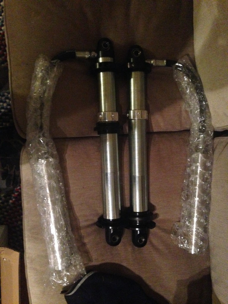

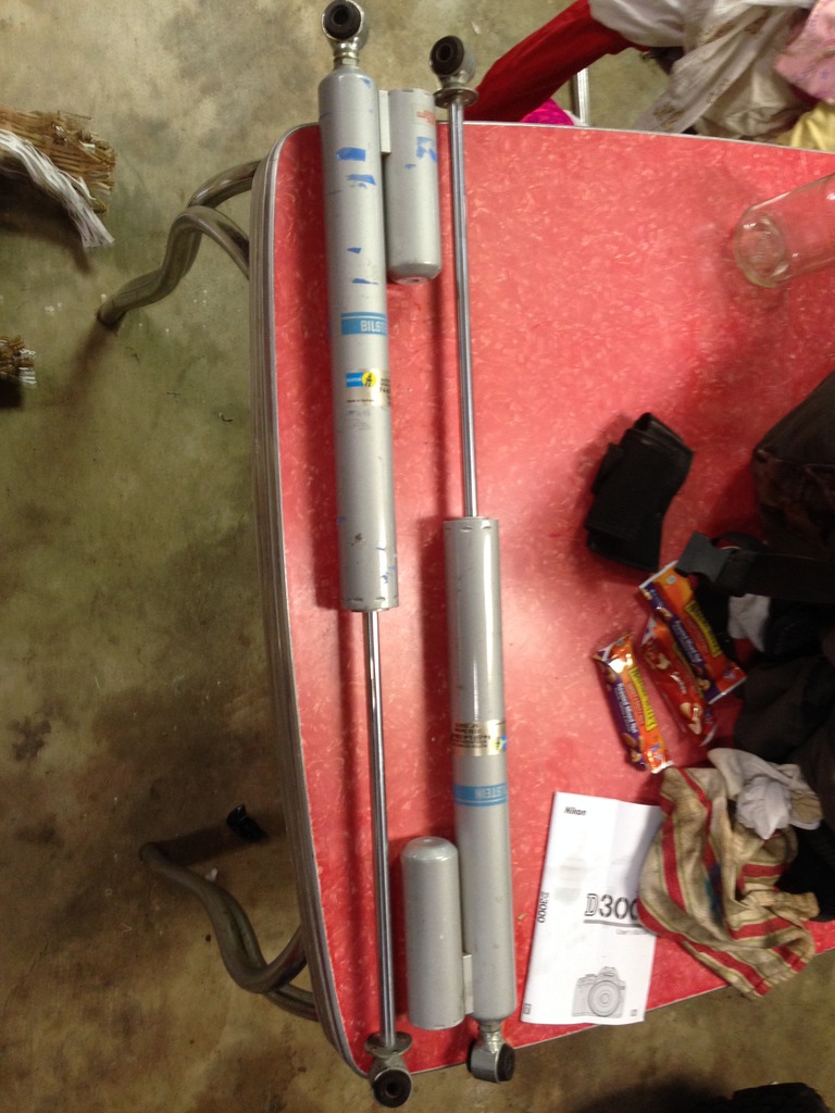

well i used black friday discount to order up my coilovers today!!! :clap: :clap:
went with 2.0-14" FOA remote resi shocks with med/firm compression and light med rebound. most reccomended med comp and light reb but i figure i would like to try a slightly stiffer shock and lighter tender spring to be able to have a plush ride while still limiting some body roll.
I also went with 250/400 springs to assuming a 1085 sprung corner weight, mounting the coilover right over the axle and only leaned in 10º 250/400 gave me a initial spring rate of 154lb/in and initial suspension frequency of 1.160. also a stepup ratio of 260% to hopefully avoid hard bottoming. I was shootiung for 50 % droop, but we will see if i can really get that type of up travel. might need to go softer on the initial and add droop once i get to start fabbing.
luckily daves offroad has a spring exchage program so i can play with them before driving it too much and see if i need to swap.
shocks, springs, limit straps, and air bump cans came out to only 637 bucks!
now need to buy v6 adapter, rear axle shaft to center the fj80 housing and my triple shifters.
might wait on the triple stick as that is the only slush i have in the budget right now incase i need to fix something else i didnt account for. I do have bucketsw i can install instead of the bench, just dont want to.

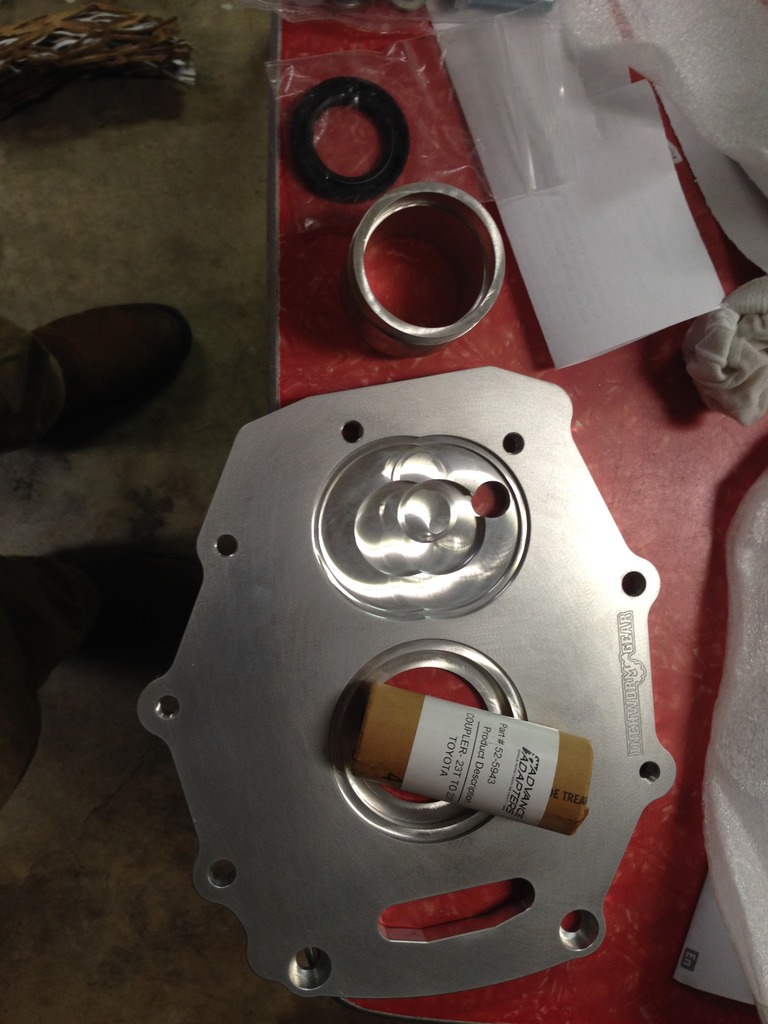

and some parts porn:

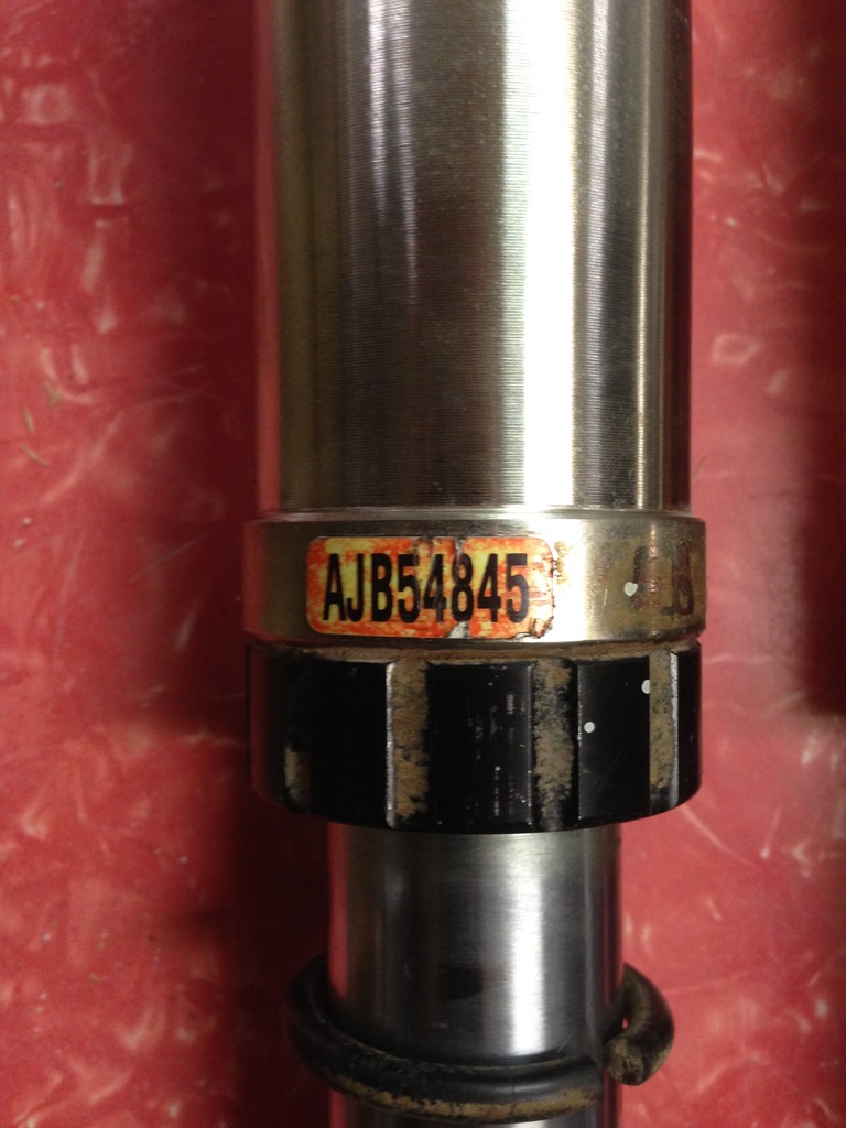

coil-overs

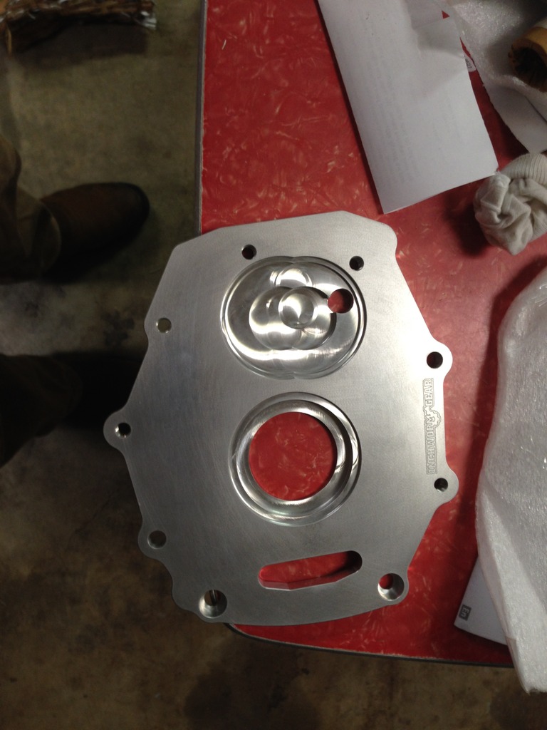

inchworm adapter

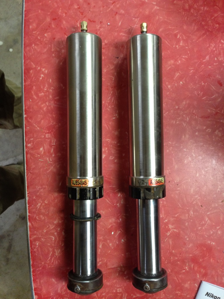

rear shocks

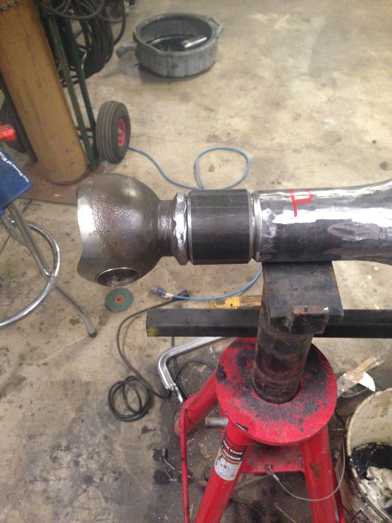

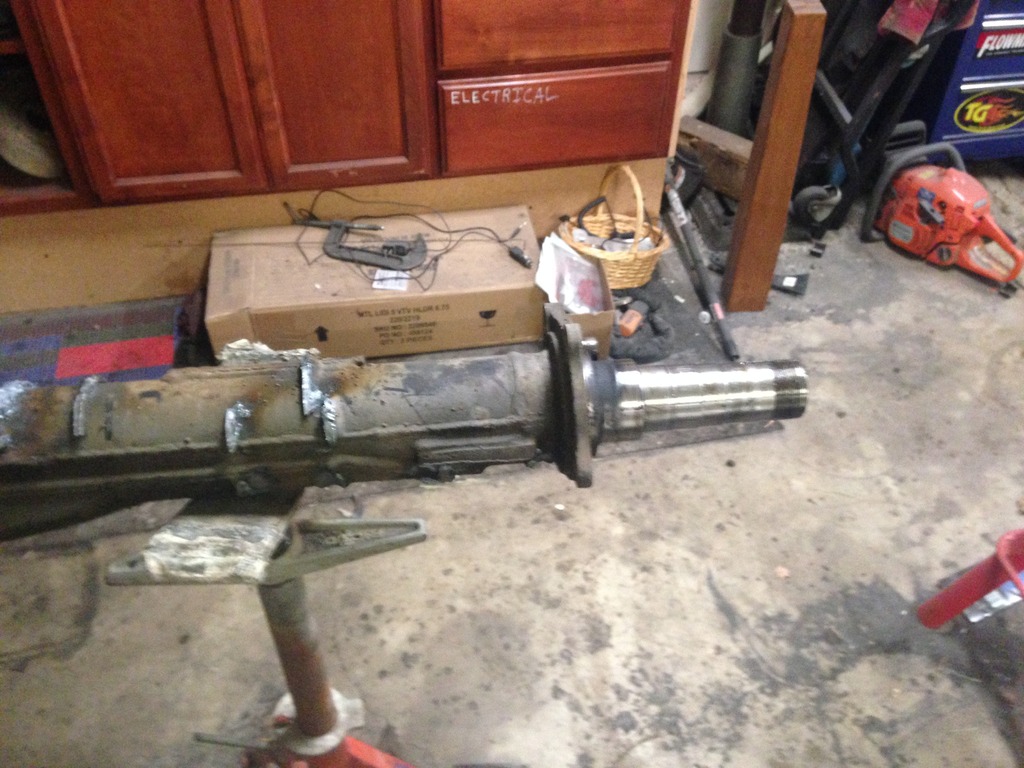

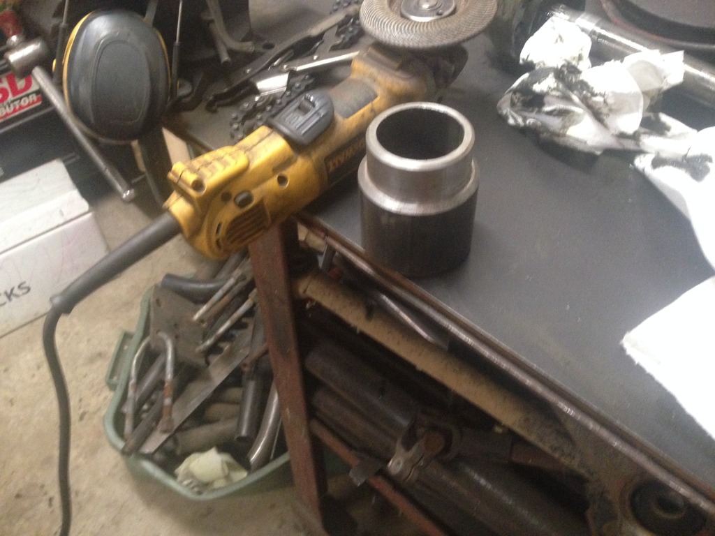

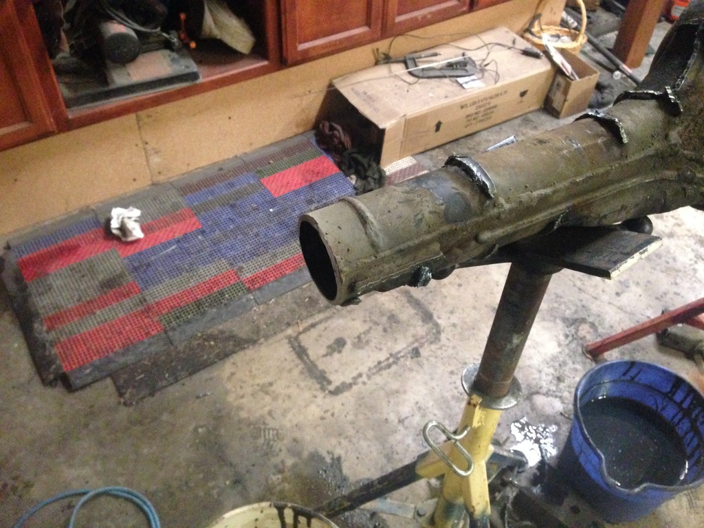

I finally got some time to work on the axles for this thing this last weekend. I started working on a bucket for my tractor but soon got bored and found my self stripping my front axle to widen it. from 12AM to 6:30AM i went from full axle to fully ground down and knuckle balls off.
here she is post plasma with one knuckle off
here is the rear awaiting it's turn

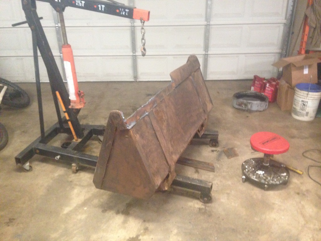

here is the bucket i got bored grinding off the cutting edge

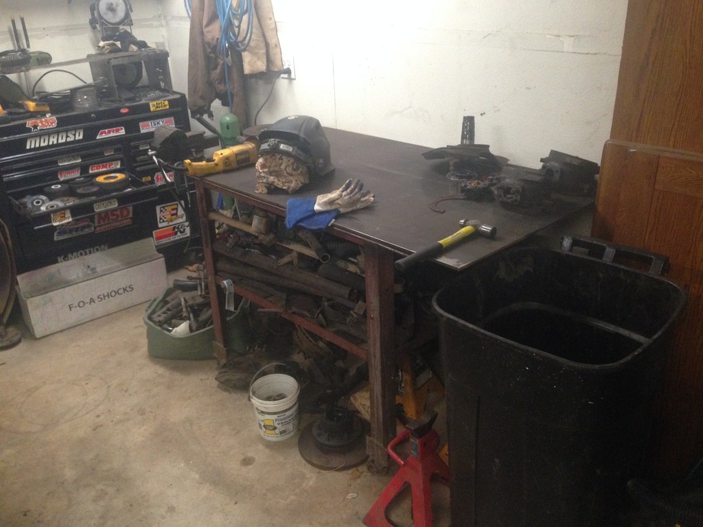

cleaned off welding table to hold the inner axle parts

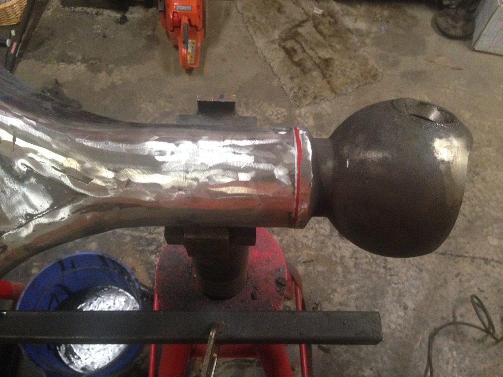

ready to cut off knuckle balls
balls cut off

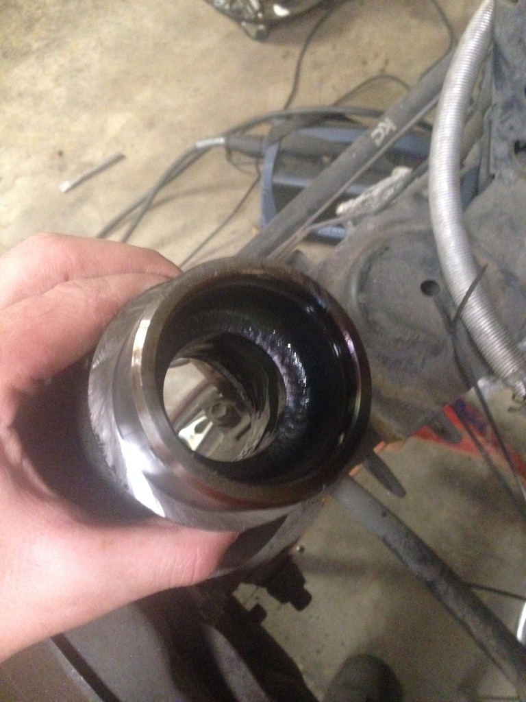

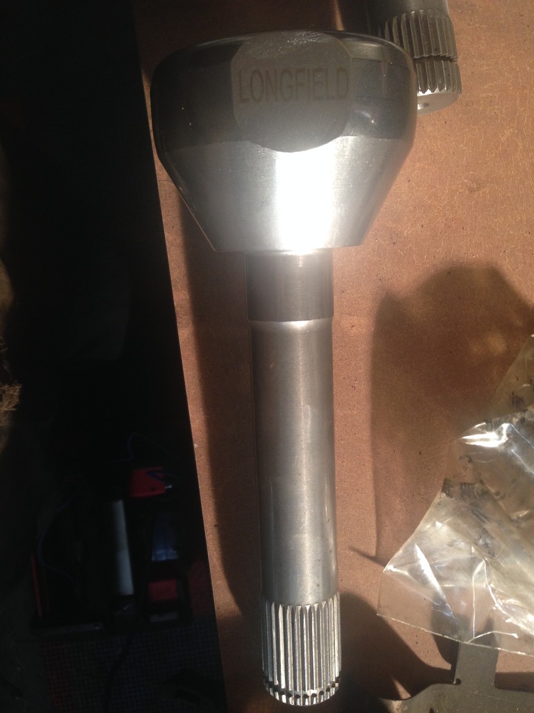

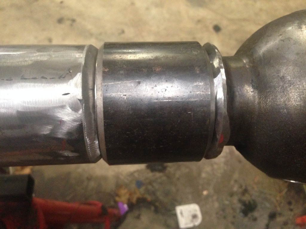

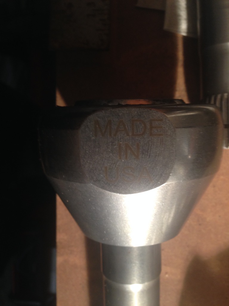

here is the machined spacer from LCwizard to make the custom inner shafts work. I believe they are designed to make the axle 2-5/8" wider per side. I will have to measure after i get it all back together with the shafts in to see. I also plan on adding IFS hubs for the extra 1.5" per side and doing the FROR tacoma brake kit.

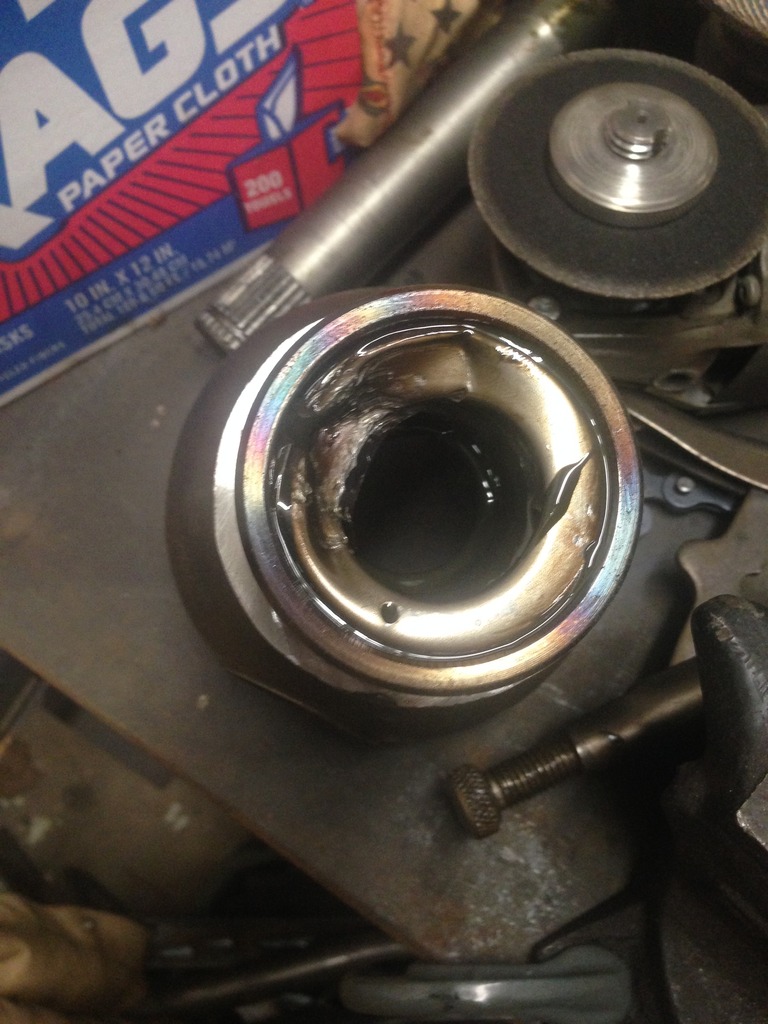

so weird thing is the passenger side has this sheet metal oil dam in it and the other side did not. anyone know if this is a nessecary part or what it is called? I kinda beat the one i have left while removing the knuckle balls. makes me also wonder what happened to the other one?

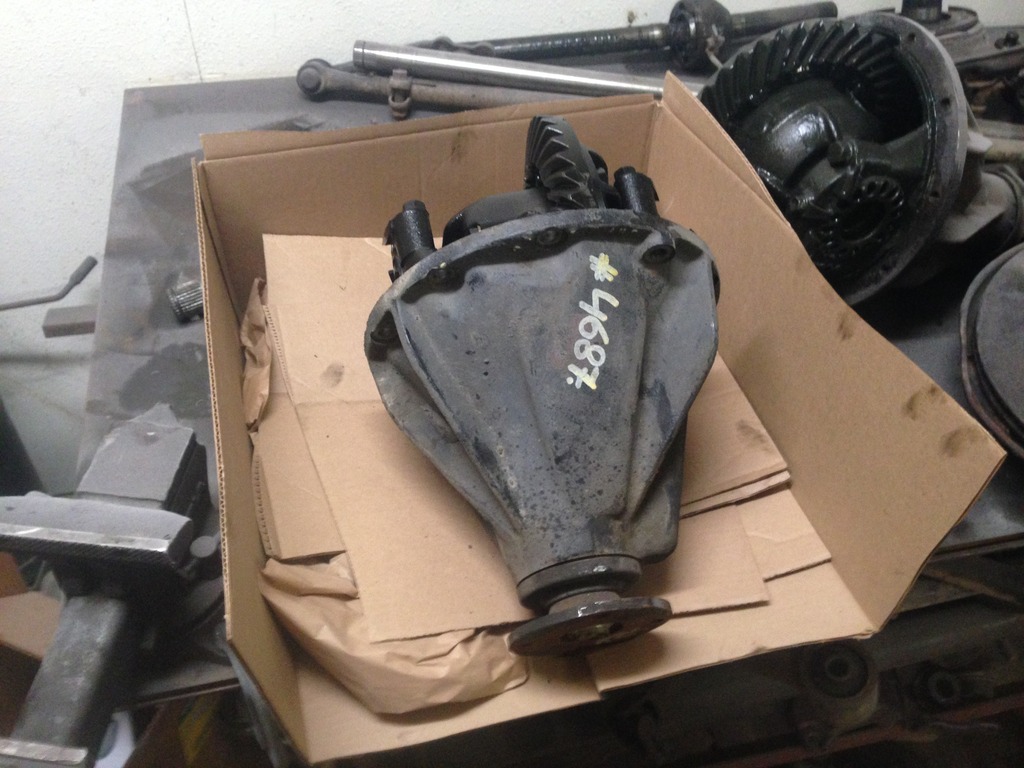

the 9.5" toy differential has about the same dimensions as a dana 60 ring and pinion so i doubt i will ever have to worry about the gears for the type of wheeling i do, and with the bobby long 30 splines and shafts i doubt i willbreak those so i think the weak link would really be the housing itself (which i plan to gusset) or the knuckles/knuckle studs. I think the 80 birfs are bigger and have the potential to be srtonger than 30 spline longs but in stock form i dont believe they are. the knuckles on the fj80 front is definitely not as easy to deal with steering due to the behind the axle steering.

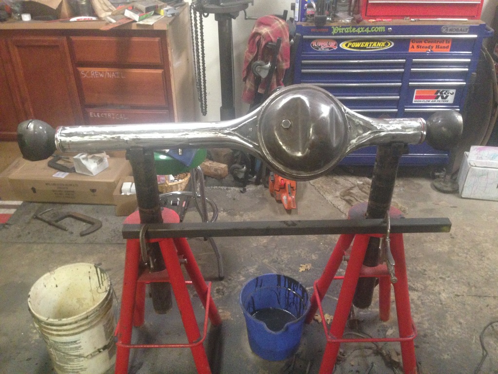

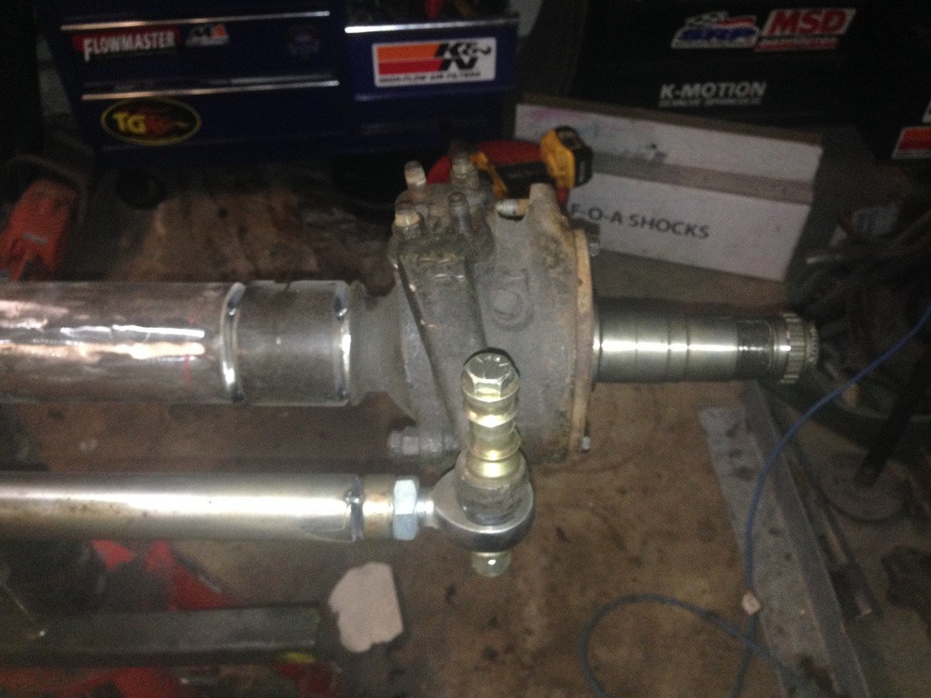

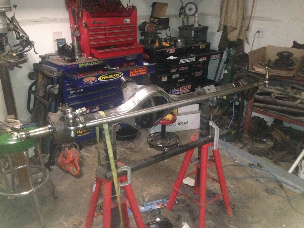

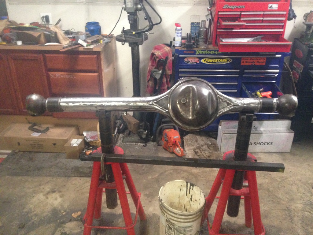

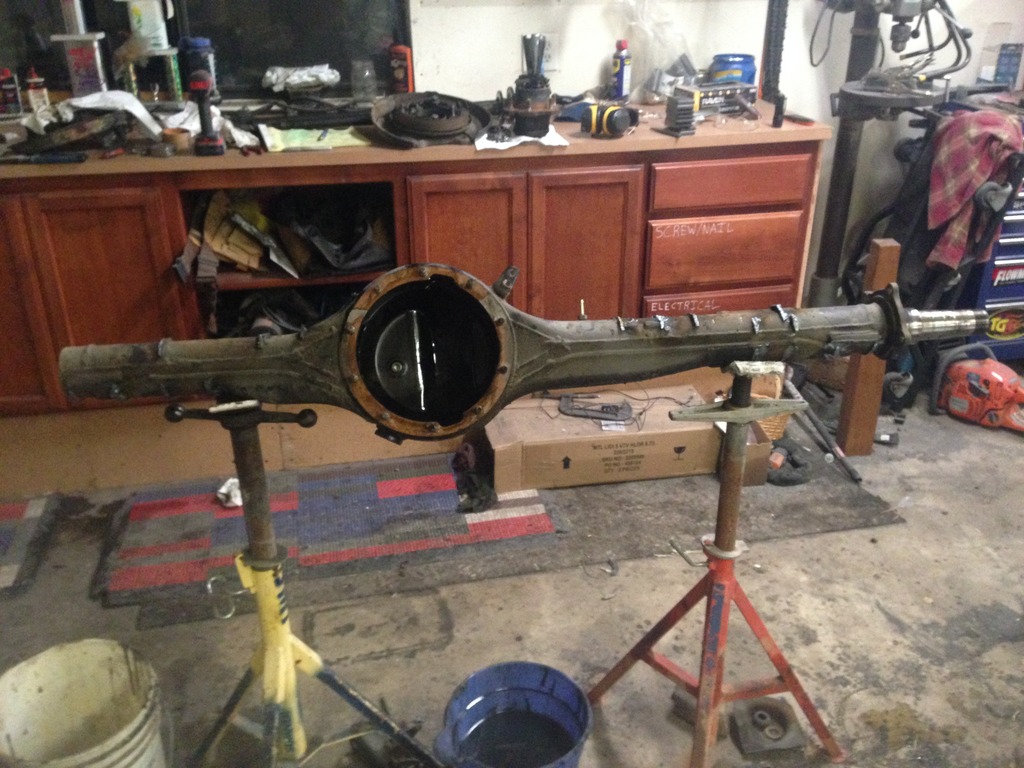

not a whole lot of progress because i only had about 2 hours to work on it but i got the bevel ground on the housing and the knuckles so i could put the extensions in and the knuckles back on to see what the overall width is really looking like.

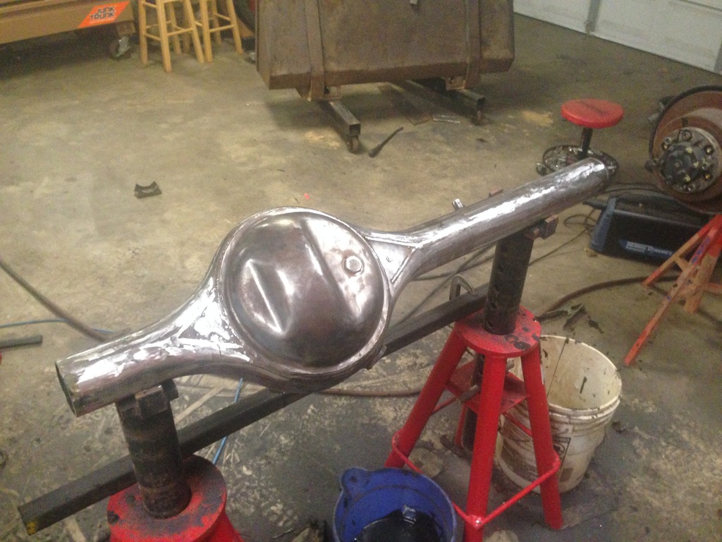

so from CL of trunion axis to the other CL of trunion axis on the housing i measured approximately 54-1/4", and the strait axle knuckle and hub assemble measured roughly 5" from trunion axis to WMS. that would put me around 64-1/4". I have IFS hubs to swap on that should put me at 67-1/4" or a little more if i dive into the tacoma brake swap from FROR or similar.
looks like this axle width should be right about perfect for the T100.
just need to get it all built. my plan is to cut off the diff cover and re install the 3rd and dry fit the knuckles, IFS hubs and axle shafts i have and make sure my measurements are correct then start cutting the rear apart to widen the FJ80 rear to match. I still need to machine the spacer for that and cut the cut to length shaft from nitro.
after i get both those figured i am going to borrow an alignment jig from a friend and get the whole assembly dialed and caster set to where i think it will be and weld everything but the knuckle so i can fine tune later for the front. Rear i will probably just leave the spring perches off for now.

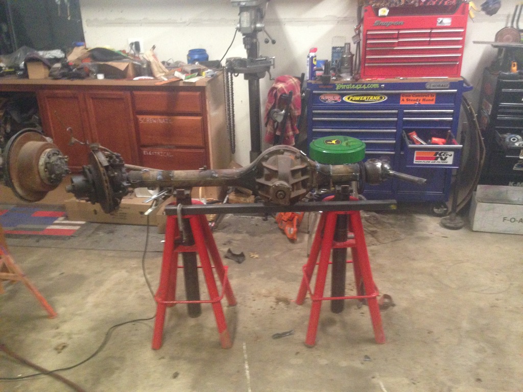

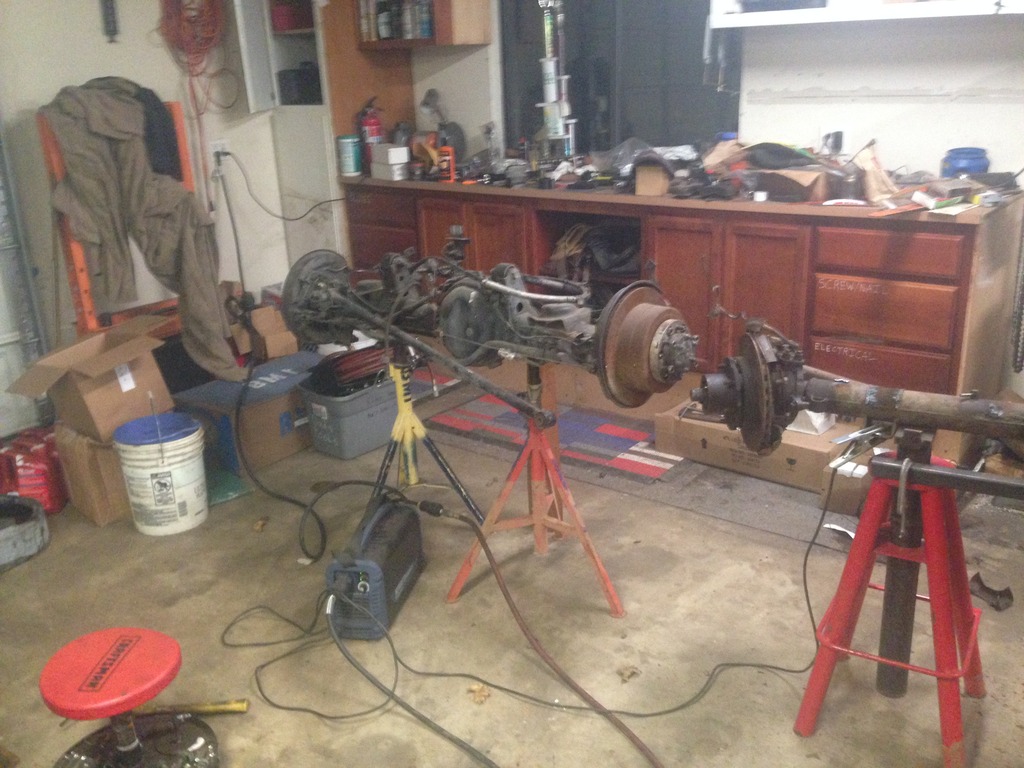

not a whole lot of progress but i did finally get the t100 smoged and registered last week so she is legal for the street. this is a big milestone for me as i havent wanted to cut anything on the truck until everything is ready and i know there wont be any title issues.

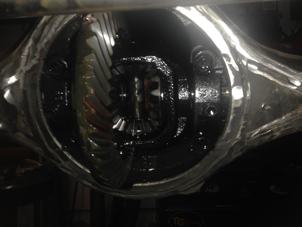

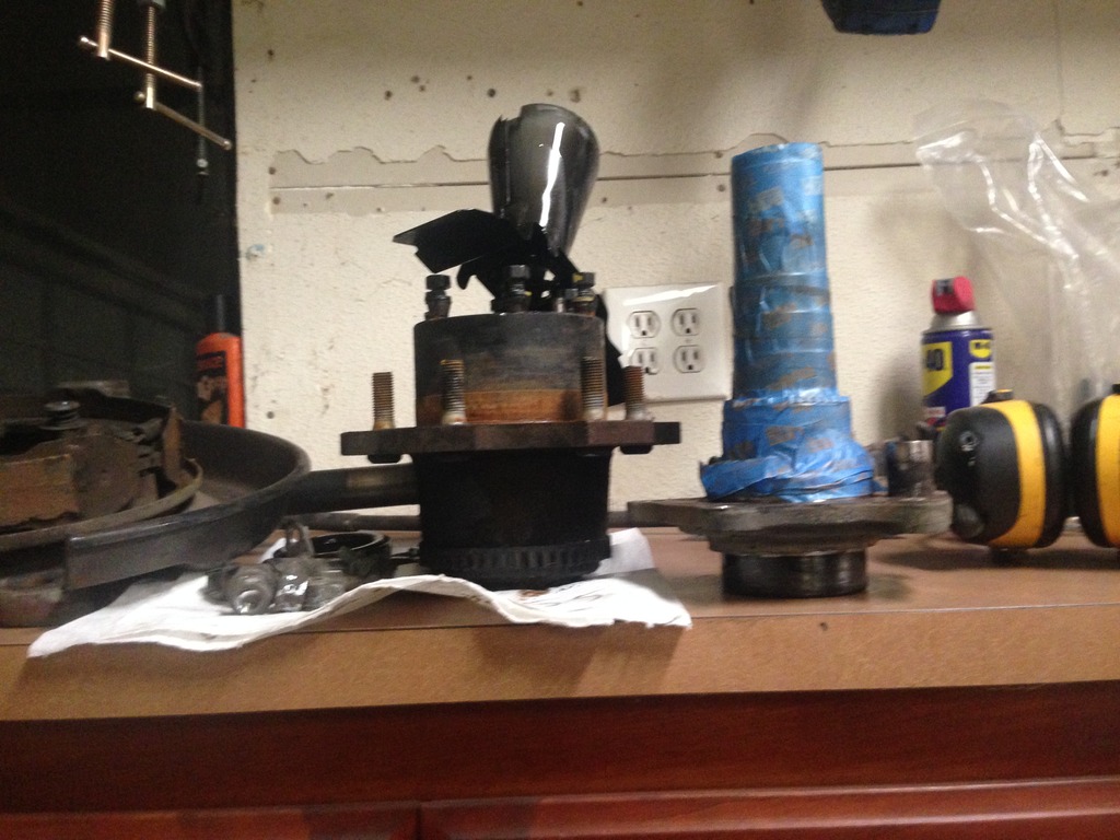

so this sunday night from midnight to 4am i tore into the rear axle to get her stripped down. still alot of grinding left to do but I got the short side spindle off so i can start building the widening spacer. I am planning on taking the 63" wide stock axle to 67.5" just about stock. this means i have to build a 4.5" spacer on the short side. the short side axle shaft measured 28-15/16" so with my nitro cut to length shaft i need to cut around 33-7/16". here are some pictures:

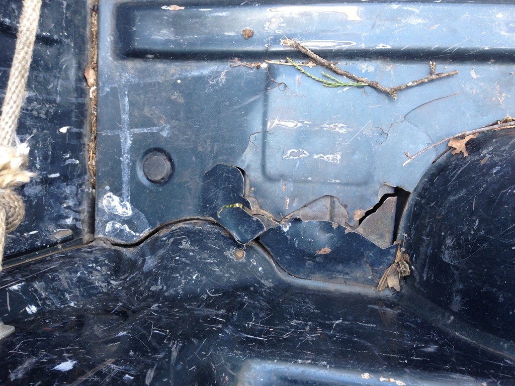

no real progress to report but i just wanted to document i went to the dump today and the truck empty with just me and a 1/2 tank of fuel weighed 4326. will be interesting to see the weight once i am done.

Got a little more work done monday night.
cut the diff cover off and assembled the knuckles and spindles to check the shafts spline engagement. i have to move the long side out about a 1/4". i also mocked up a quick tie rod to keep the knuckles strait. not the final configuration i dont think but makes it look more complete. I am going to throw the IFS hubs on after moving the long side out some to get a overall width measurement.
finally unwrapped these bad boys that have been sitting in my tool box for about 4 years,
also picked up these 31's so i could put some miles on the t100 while i keep building the axles:
