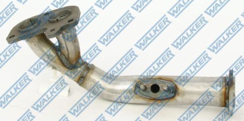

I want to put a wideband AFR sensor on my 97 T100 4x4. To do this you have to weld a bung in your exhaust ahead of your 02 sensor. I'd like to buy a second exhaust piece so I can work on getting it welded without having my truck disabled for a few days. Does anyone know where i can find one or even what the part number is? There are a few on ebay, but they all say 2wd only, or excludes 4wd or somethign like that. here's a picture of the 2wd version:

Do you have an auto or manual transmission?
Using www.toyodiy.com:
Part number fer the 4WD auto pipe is...
17410 PIPE ASSY, EXHAUST, FRONT
17410‑62140 1 $160.33
Part number fer the 2WD auto pipe is...
17410‑0W031 1 $176.40
I think yer best bet would be to check out www.car-part.com and contact one of the vendors on there with yer request. I'm sure there's enough 4WD T-100 in salvage that you could choose from. You could also see what's on yer local craigslist or even yer local TTORA chapter.
