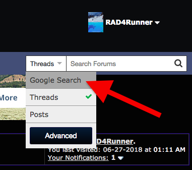

Tip for better searches, use the "google"s search on search menu. The other options are LAME.
