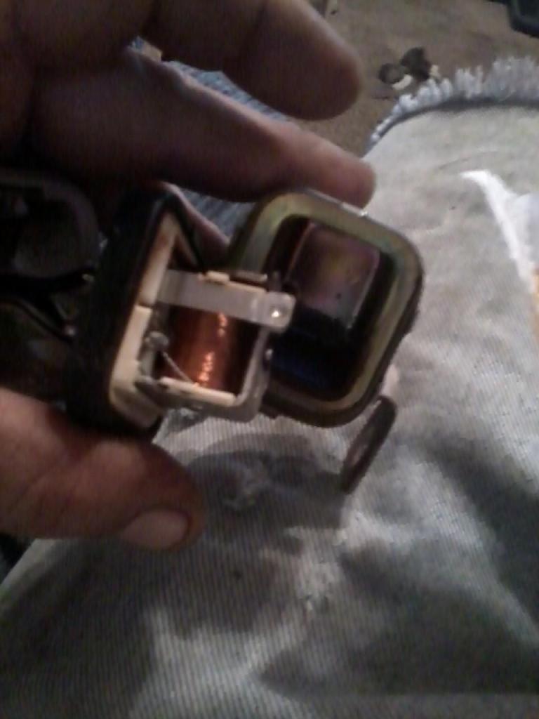

Here is how I clean my Starter Relay contacts. That helps.
Copied>>>
Cleaning the Starter Relay.
I followed RAD4Runners write up on the starter relay as I have had it to not hit on a first turn of the ignition. I cleaned the contacts like he said, only I used 600 grit sandpaper. It does hit the on the first try and is a more solid, quicker response. Thanks RAD4Runner.
Getting cover off, I used wire cutters to bend the tabs up on the cover. The rubber seal really makes it tough to get off. Luckily the wires are soldered on real well, I used a screw driver to work around the edges of the seal to help free the cover.

We got rain and I had this spare. Thought while I was at it I would clean it. It had rust in it. It cleaned up well and still works. I will take some electric contact cleaner to it and keep it as a spare.
