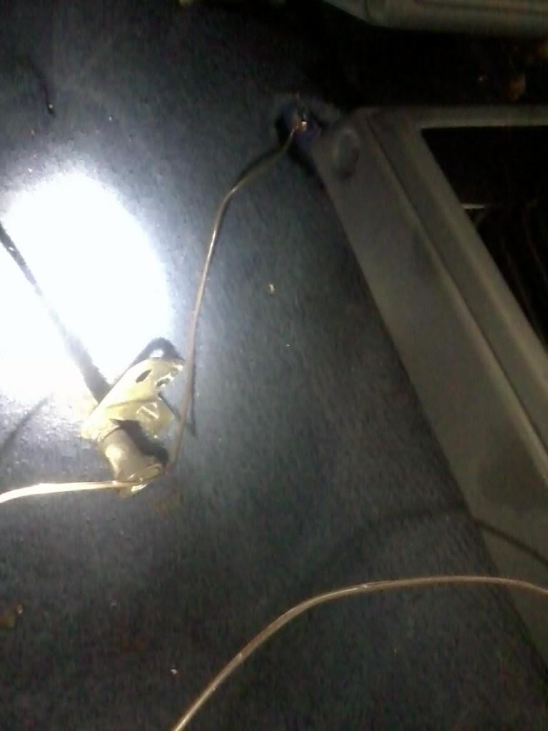

In the picture below is just for how I do mine. I did eventually solder, heat shrink and wrap with electrical tape and have no intentions of ever going back to the way the factory did it.
Copied...

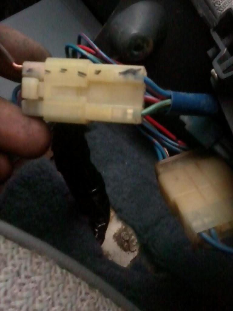

Running a ground wire from this wire on the plug, the blue wire to the place on the pic below elminates a lot of problems.

Ground to center consloe mounting tab.

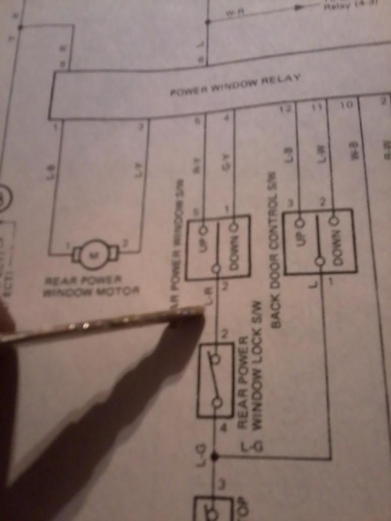

The ground wire bypasses the following safety switches. Cover Top and Door Lock Detections switch. Your window will roll up with top off. This is on Page 12-23 of the Haynes Manual where the key is to the botom of the page.
Haynes "L" for Blue, "R" for Red. Key is pointing to wire.

The reason the wire goes to the front bracket is the rear bracket is isolated on plastic and will not give a ground.
If your Relay Box, Motor, and Switch is good, most likely one or more of the safeties is causing a problem. The wiring harness is usually well protected.
