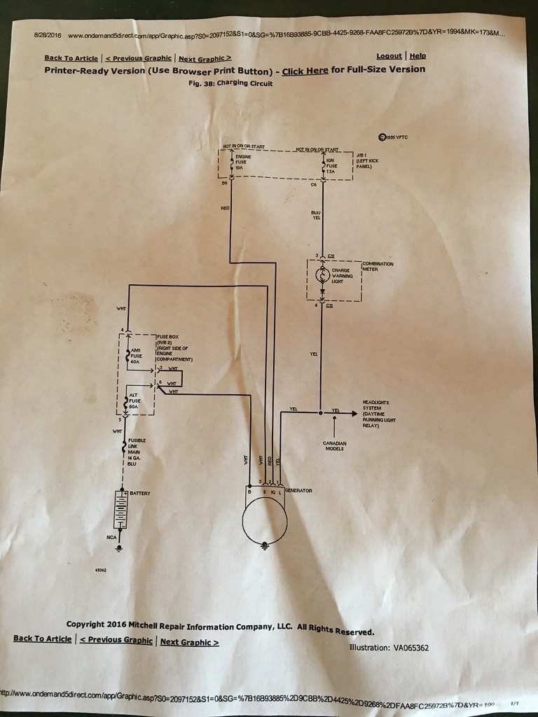

Ill post lat a couple pics of the paperwork and harness, which is in new condition.

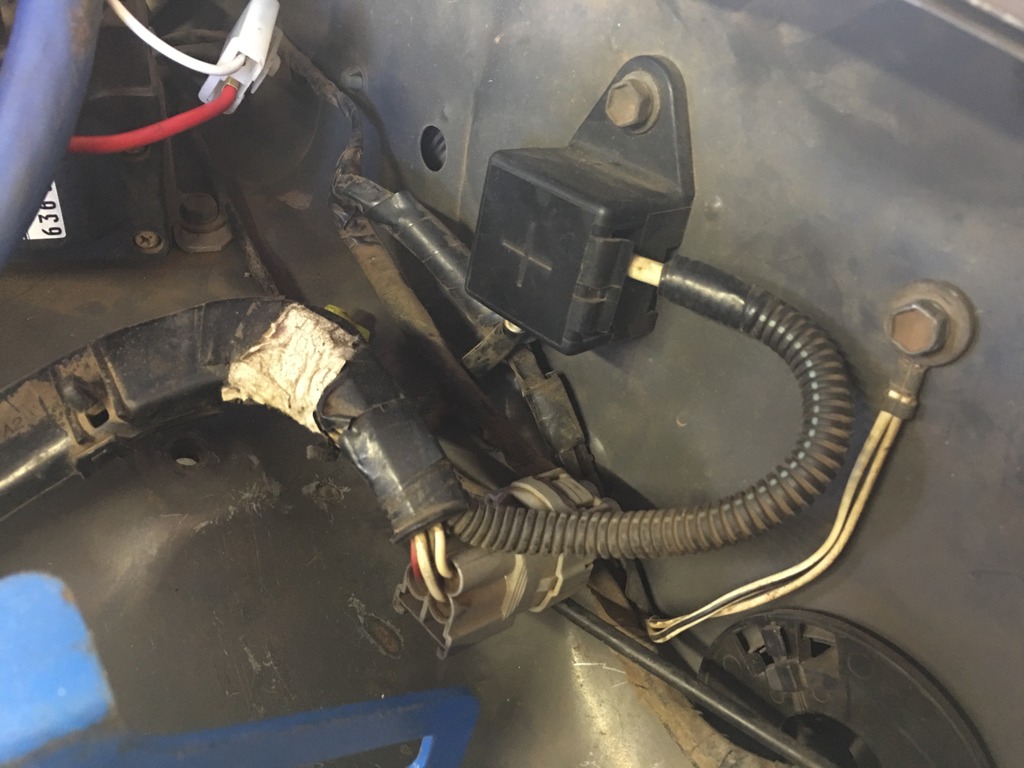

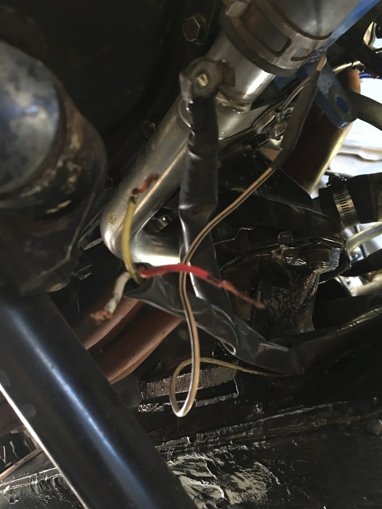

  • The old b+ line is not used after the Powermaster is installed. It has a ring terminal and can be seen below. In the install post I used it isn't mentioned.

  • This is the little box I mentioned. I still don't know what it's for.

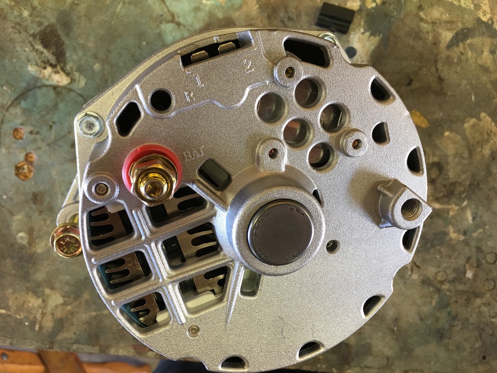

  • Heres a pic of the alternator that you get - not sure why OP's is chrome.

That black box is just a junction box
another place for things to corrode almost always over looked
It can be eliminated by running a new one piece wire the same gauge or bigger
