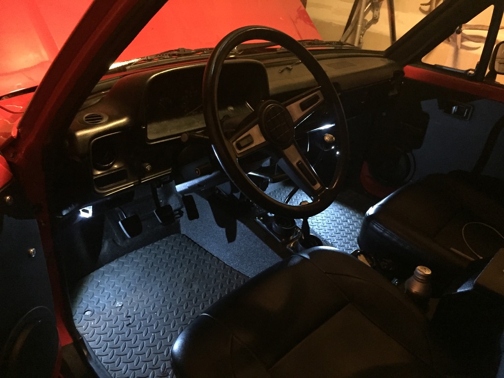

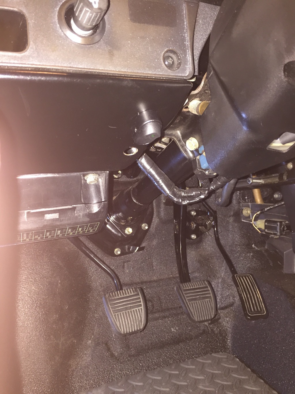

I wanted some floor board lights in my 83 so here's what I did:
-Mounted the lights on the kick panel
-Wired the lights directly into the dome light (ground to ground, positive to positive)
-Since the dome light operates on a ground interrupt circuit they have constant power going to the positive side, but when you open the door the ground circuit is completed thus turning on the light.
-I wanted to be able to turn on the lights without opening the door so I wired a regular rocker switch "backwards" so that when I turned on the switch (with the doors closed) the switch would complete the ground circuit and turn the lights on (regardless of whether the door is open or not). I wired a wire from a ground source to what would be the positive feed post on the switch and then a wire from the what would be the positive output post of the switch to the ground wire on the dome light/floor lights.
So here would be your schematic:
Body ground --> switch
Switch --> ground wire on dome light/floor light
Floor light ground --> ground wire on dome light
Floor light positive --> positive wire on dome light
*Note, on the 79-83 pickups, the dome light does not come on without the doors open. They can be turned off so that they will not come on when the door is opened, but they cannot be turned on by switch with the doors closed. This modification allows me to turn on the dome light with the doors closed as well as the new floor lights.
Here are some pics:
Switch for the dome/floor lights to the left of my steering column
LED floor lights
