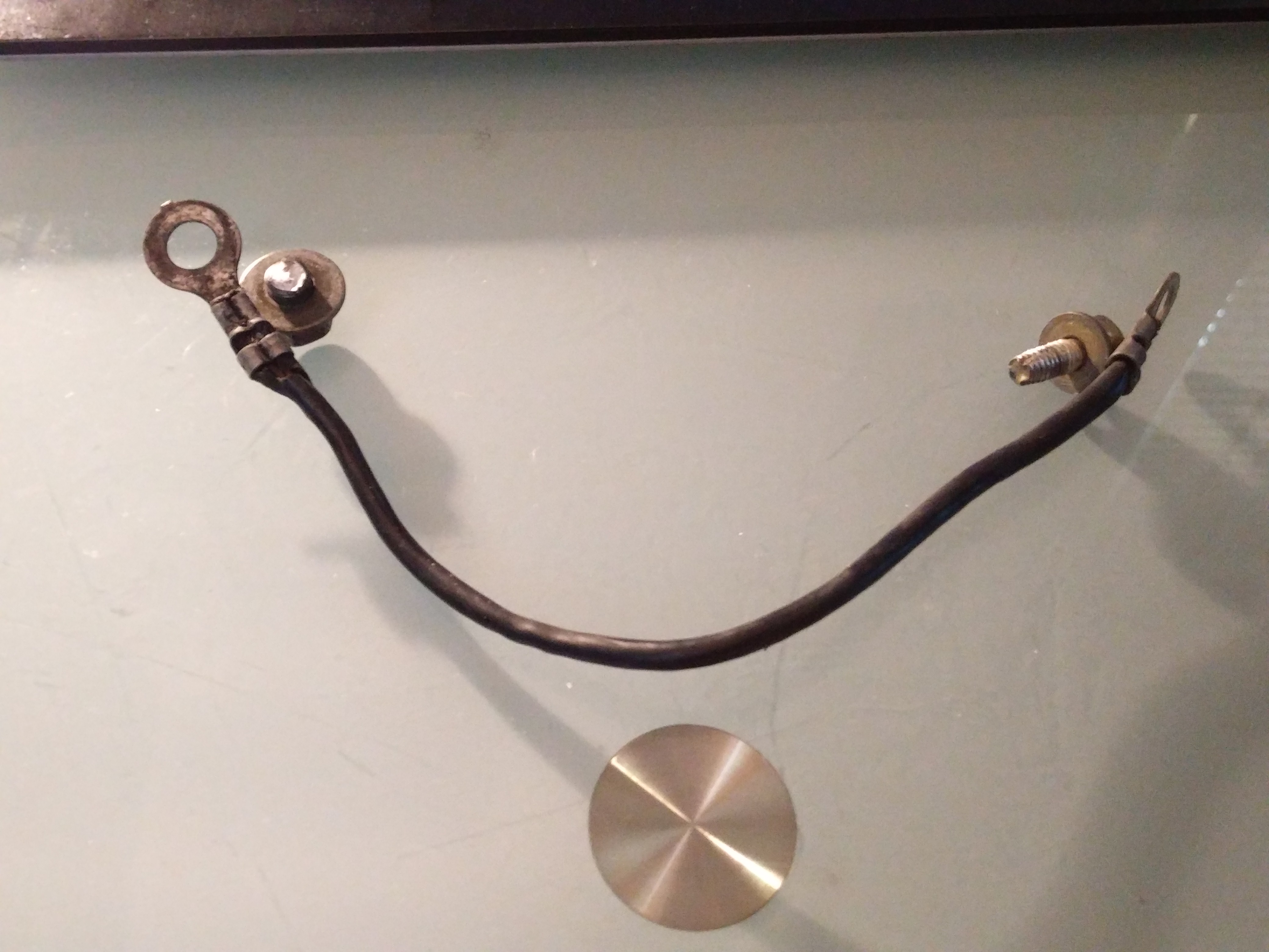

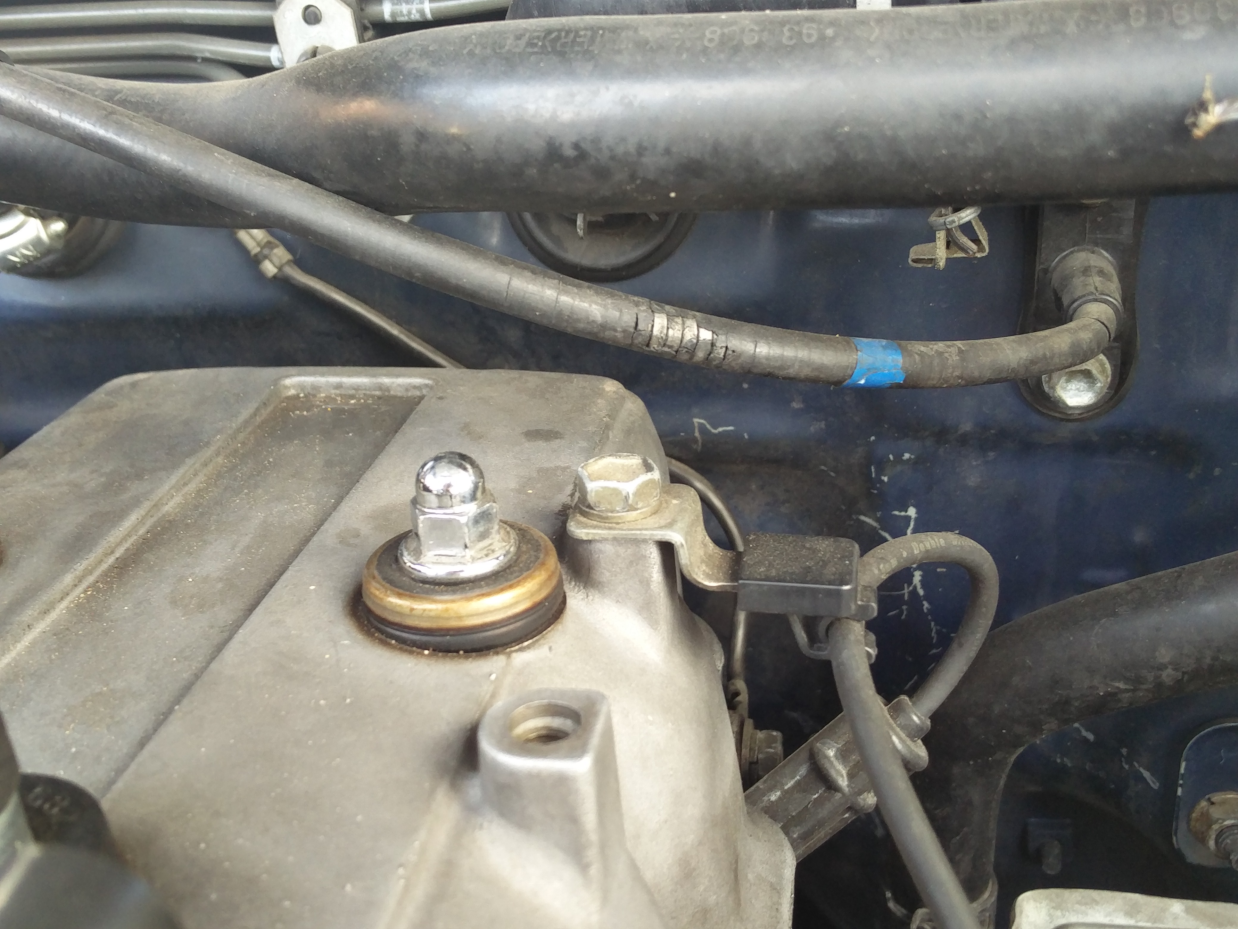

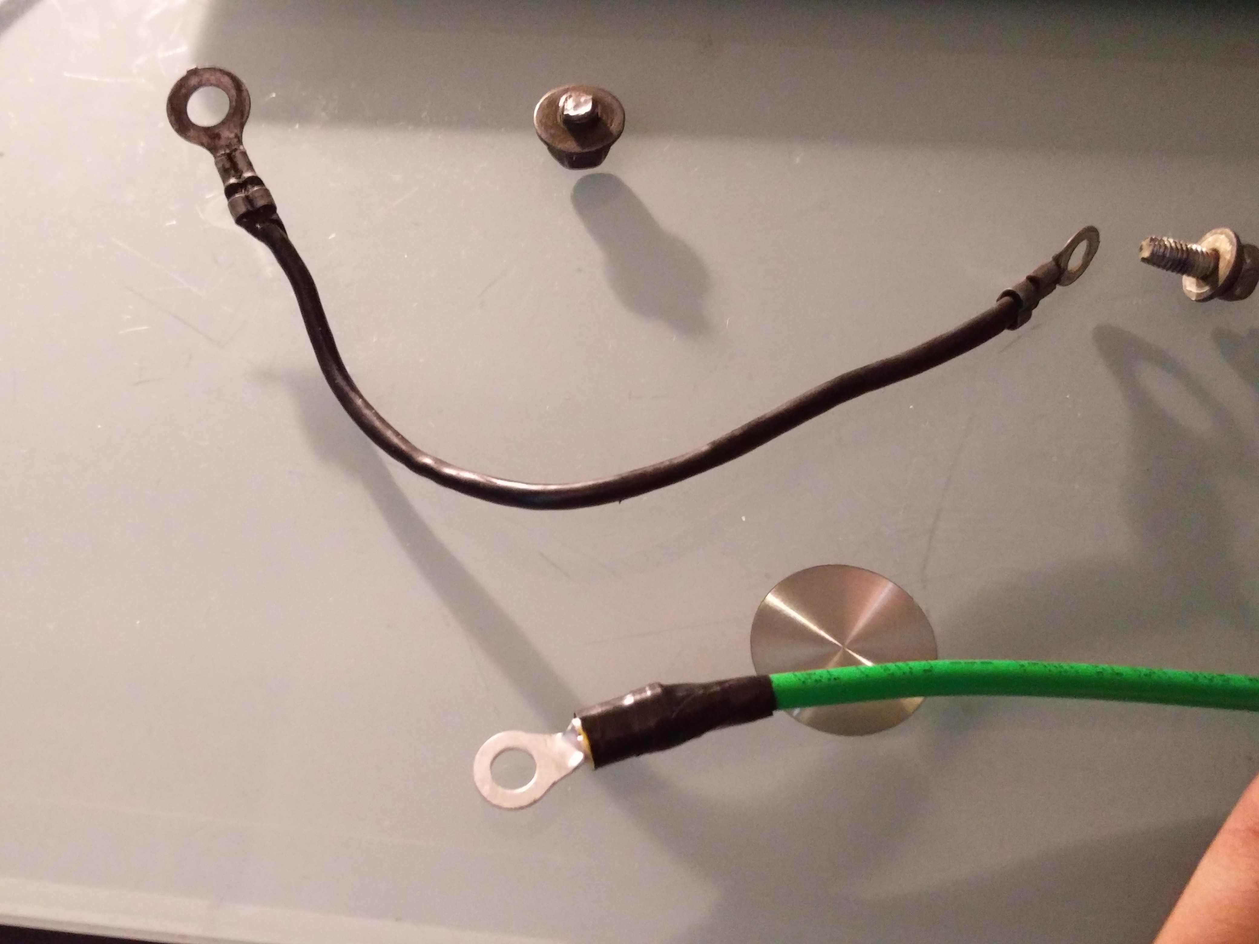

So today I was changing out my spark plugs and I read in a thread that says that changing out an old ground wire my help with a slight misfire I am having. so I decided to change it and the bolt connected to the head broke off. Any suggestions on how to fix it or if there is another spot on the head where i can bolt on the new Ground?

You can bolt up the ground just about anywhere on the head.
Grounding to the valve cover is probably the worst choice.
Go directly to the head or block.

for sures, just wasn't too sure if i could bolt it up on any spot on the engine (with the exclusion of the valve cover) or if it had to be in the original spot. looks pretty good.
