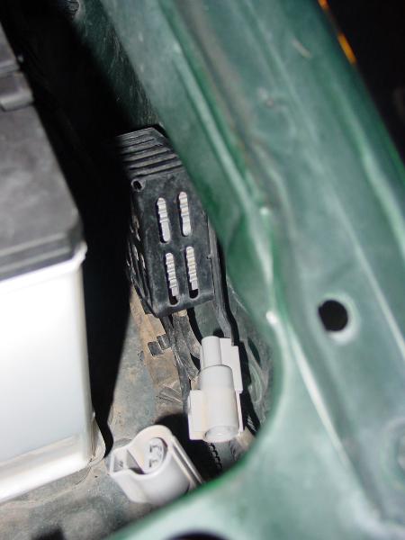

When i installed my hid on my 00 tacoma the DRL relay was by the battery on the drivers side up by the headlights its a little box that looks like it has a heat shield on it, just uplug the cable and no more DRL
