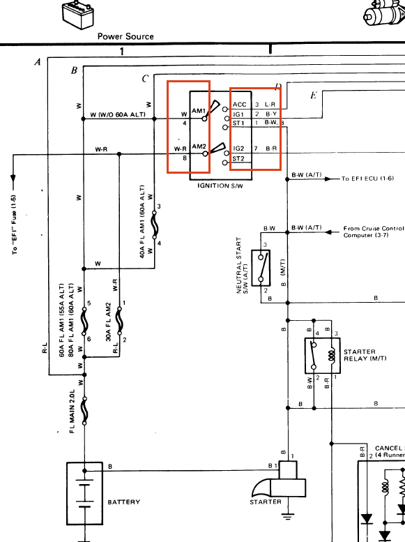

Do as Wyoming says above and ensure that your truck's power circuit is restored to stock as shown below. We could be thousands of miles away from you and we do not see what's right in front of you so we could not effectively troubleshoot a modified wiring. There is no point in "upgrading" a butchered wiring.
Make sure you have 12Volts at all times at points in red rectangle on left side of IGN switch, and 12V at points in red rectangle on right side WHEN corresponding contacts are closed.
