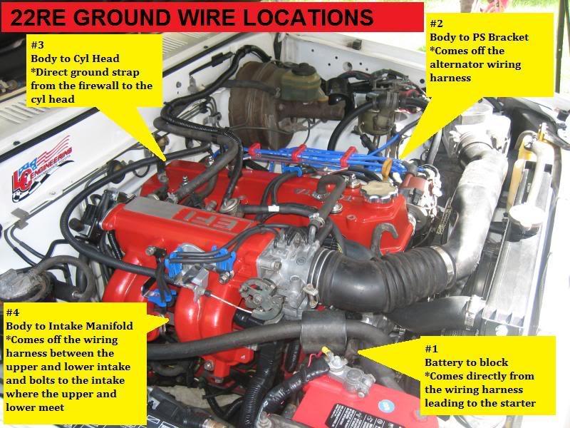

I would suggest checking your starter relay. RAD4Runner has a lot of good write ups in this area >>> https://www.yotatech.com/forums/f199...l#post51952166 Check his build thread for some more ideas.

sounds like you have more then one problem
The does nothing could be a bad ground.
Then the over all condition of the starting circuit also comes into play.
A loose or out of adjustment clutch cancel switch on the pedal will not cause the complete loss of power just a no crank condition.
The poor idle could be a bad vacuum hose or just in need of a good tune up.

thanks for the info. No doubt that the vehicle is in need of a tune up but the idle definetely became worse after i was unable to start it. Could a bad ground to for the efi cause no idle? i've had this vehicle for less than a year and i'm new t all of this so all this info is much appreciated thanks.

Pretty much a bad ground in the EFI circuit results in a no start condition.
Then it is possible.
A good full tune up will give you a good base to start from !!
